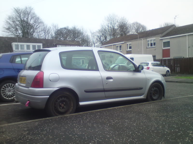

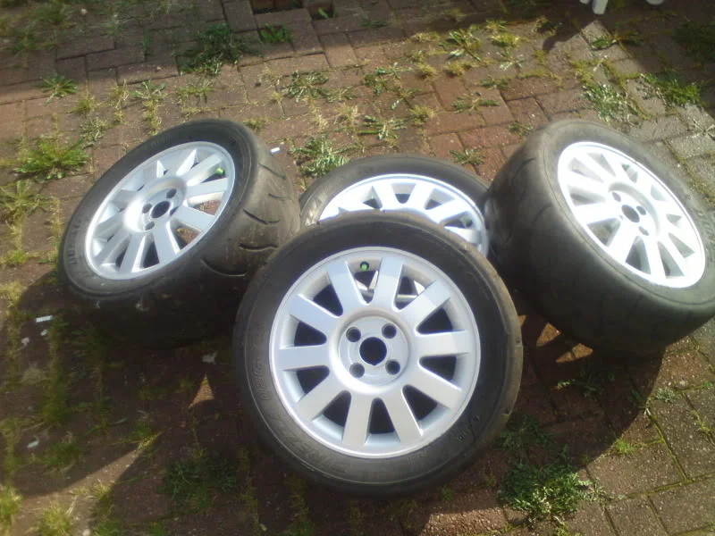

14" steels on the back. How i roll!

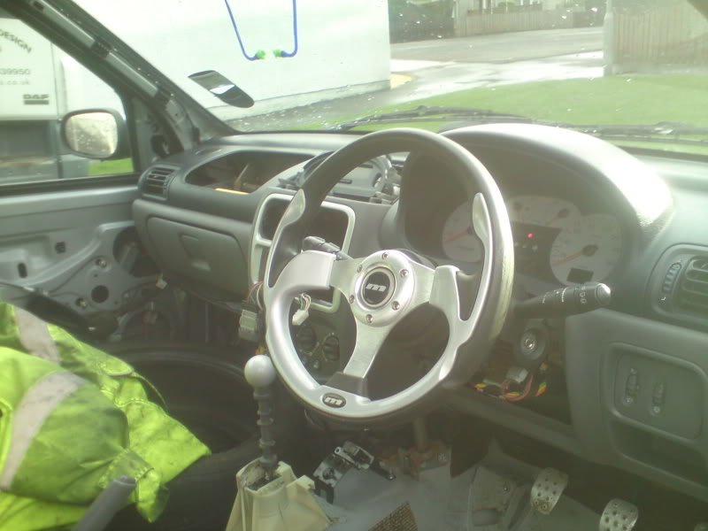

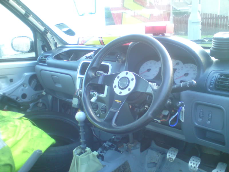

Forgot to post up some before and after pics of the steering wheel, bought off John for £40, it's slightly bigger than the one i got with it, but feels a lot nicer.
to
Much better.

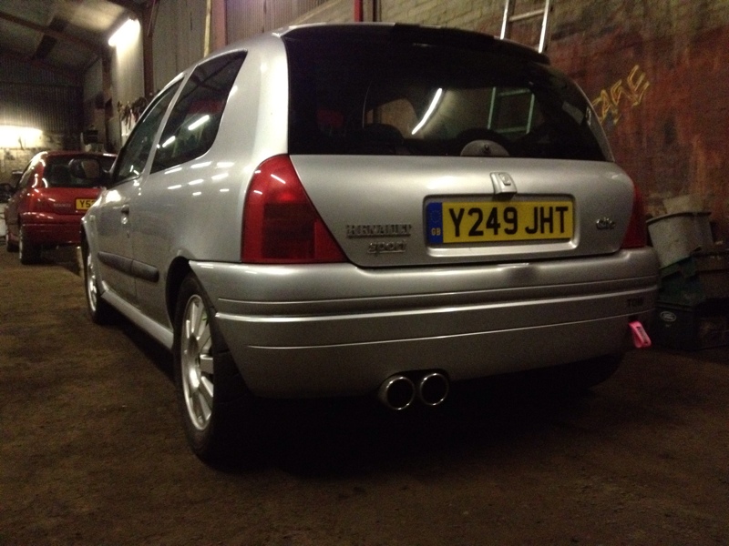

Since Knockhill have puy up the dates for trackdays this year We started to crack on with a few bits and bobs needing done to trackchav. I doubt if it'll ever be fully finished, but we'll keep at it.

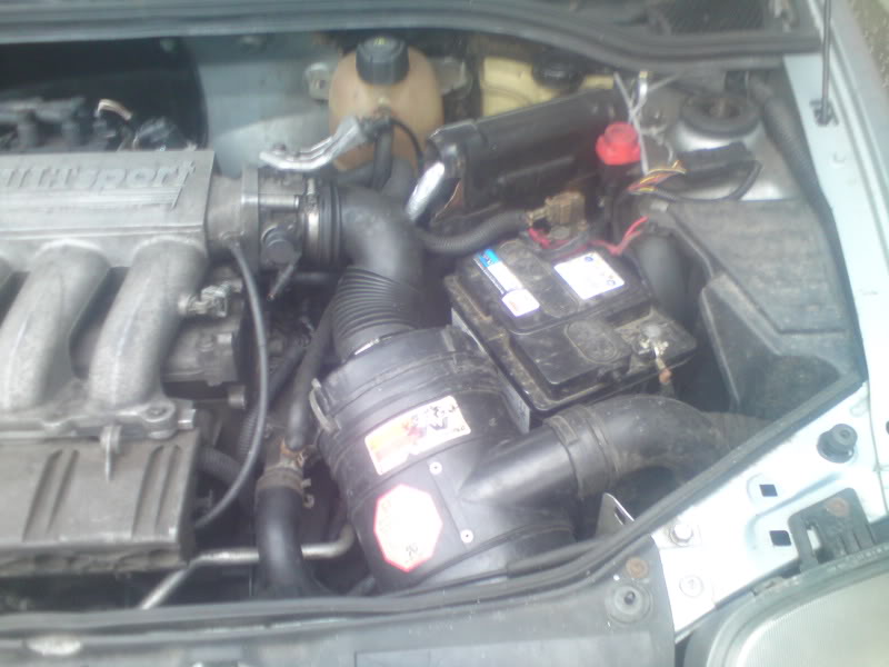

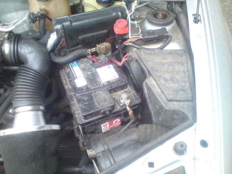

We removed the k and n and replaced it with a ph1 box with ITG panel filter, fitted a smaller battery (the one with the car was huge and held in by a ratchet strap) and made the fue box water tight. No cost as all these parts were taken from a 1.2 we scrapped a few weeks back.
from
to

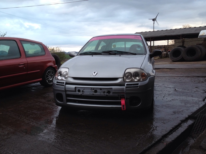

Track day sneaking up on us pretty quickly now. I've got a list of stuff to do before, so been going through them, nothing exciting: Moved a fuel pipe as it was wrongly connected from the last engine change (not by us i must point out), fixed the exhaust heatshields back into place, front tow strap fitted and track tyres put on track wheels. Not many pics but like to keep this update.
Can't make it any worse. Told you I'll look after it and save you finding storage space for it. Only take 10 minutes to swap it round at knockhill ;)
It defo cant make it worse your righ there, the cup fronts, 1.2 rear shocks and -60mm cobra springs are working well.

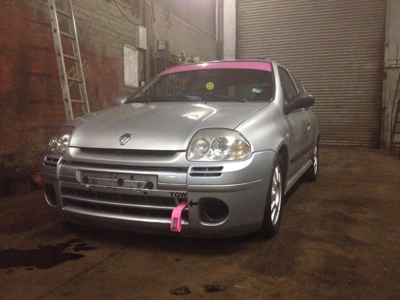

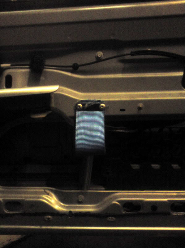

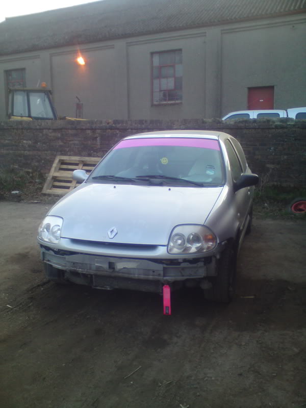

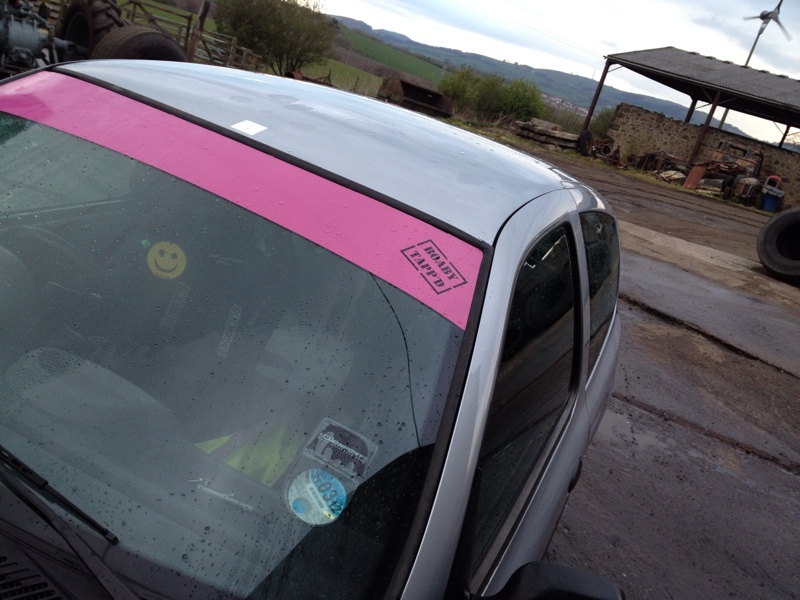

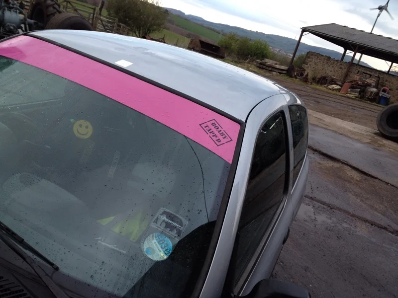

Managed to do a few other bits this evening, made up some door pullers to close the door from some bits lying around from a old trailer. Then fitted my big gay pink sunstrip. The car has no visors so it does kinda need it(TBH it was £1.75 and will probably be getting changed for a black one)

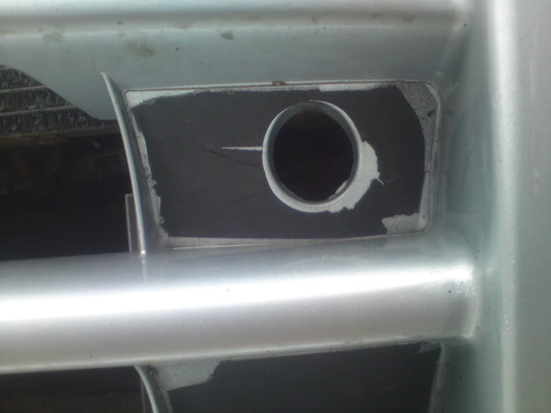

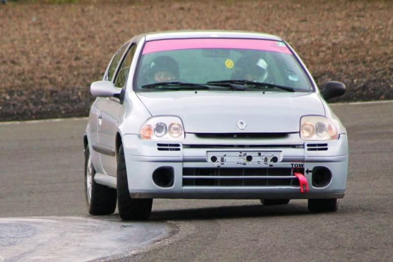

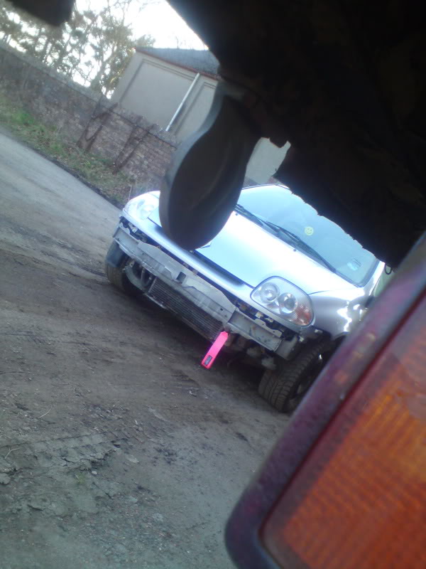

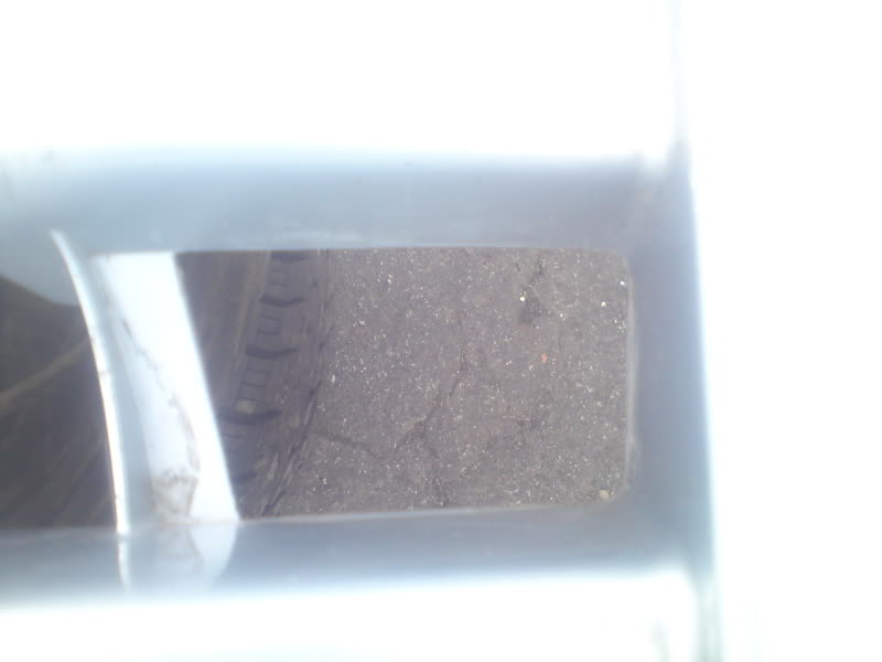

Little to no progress done on this. Took the front bumper down to my mate to cut out a nice hole for my tow strap. He's got a nice 2" grinder where as i would have just went at it with a hacksaw.
Before
after
Exciting huh!

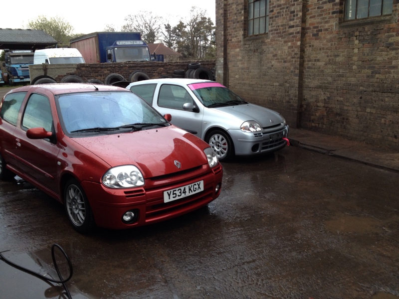

Na, doubt i will be either. I'll still be using your old one at weekends etc so would be nice to not rape it for all its good bits.
Glad to see you can resist temptation lol.

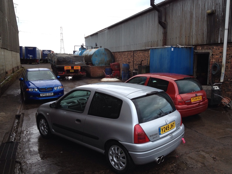

There has been a slight oil leak around the back of the sump since Dave bought it, obviously not ideal, especially when going on track. So the sump was cleaned up and resealed, seems to have worked well. Dave got his health and safety on to clean it all up.
Bled the brakes on Thursday night which was going nicely until a bleed nipple snapped at about 10pm :( So on Friday night we chucked another caliper on and finished bleeding them all, old fluid was minging so a nice worthwhile job.

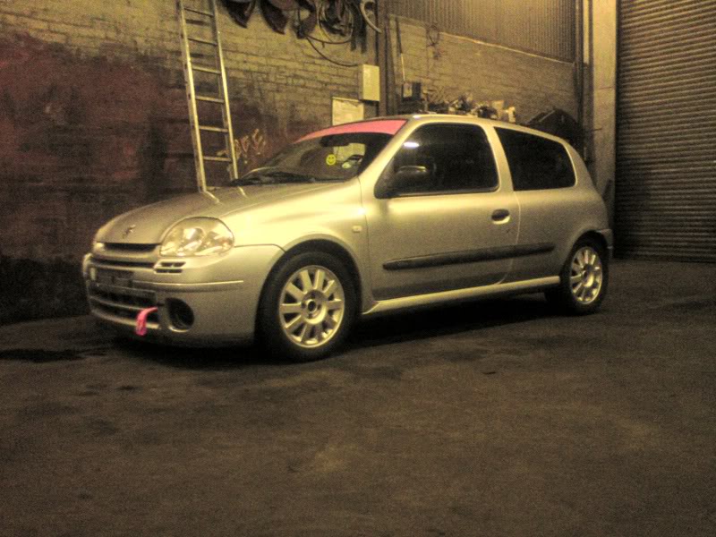

Looking a bit more, er interesting these days too,

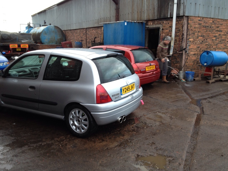

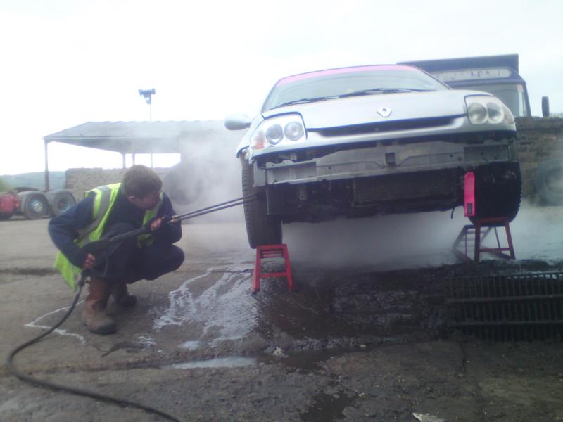

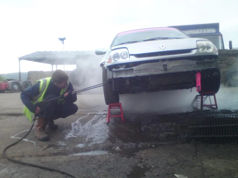

It even got "washed" We used the no bucket method and a steam genny that is more used to cleaning artics. Still, less dirt on it now than before so thats what counts!
And its all about the details/sponsership ;)

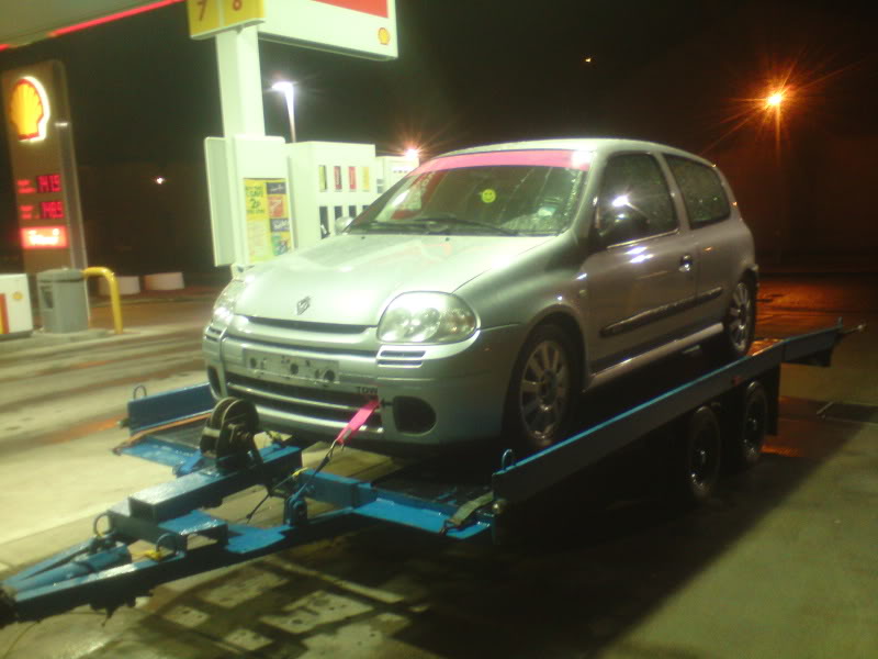

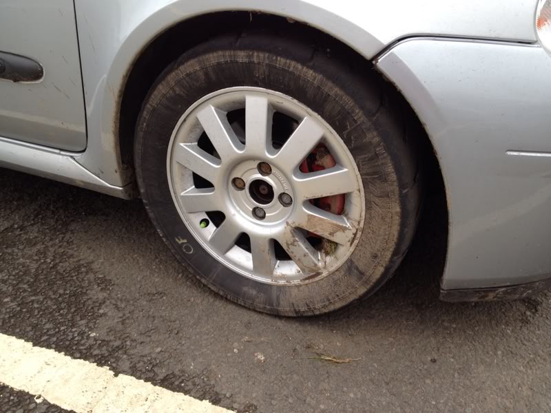

Attend the first track day with chav on Sunday. She did really well, surprising most people. I opted out of the very last session as i noticed a slight drip of oil (Looks like it's from the box) and not wanting to waste others days she retired, doing a total of 75 track miles.
The Track day went really well, i managed to spin on the very first corner on the very first lap, from pit lane to gravel pit in around 20 seconds, was red faced at that one. I really didn't think about warming up my aging Dunlop semi's but probably should have done more than drive it from the trailer to the holding area then onto the track.
I had another spin (same corner, but alot faster this time!!) it had started to rain and again didn't manage to get the tyres up to temp.
I have to say, totally hooked now. Having it on track has highlighted a few things that will need to improve but i'll continue to make it better as I go along. She's now being stored at a mates farm untill I can sell my Mk4 and mk2 Golf's and clear out the garage of random parts, untill this has happened she will be taking a back seat.
Back on track soon!!!
Night before and getting some fuel
Track pics
