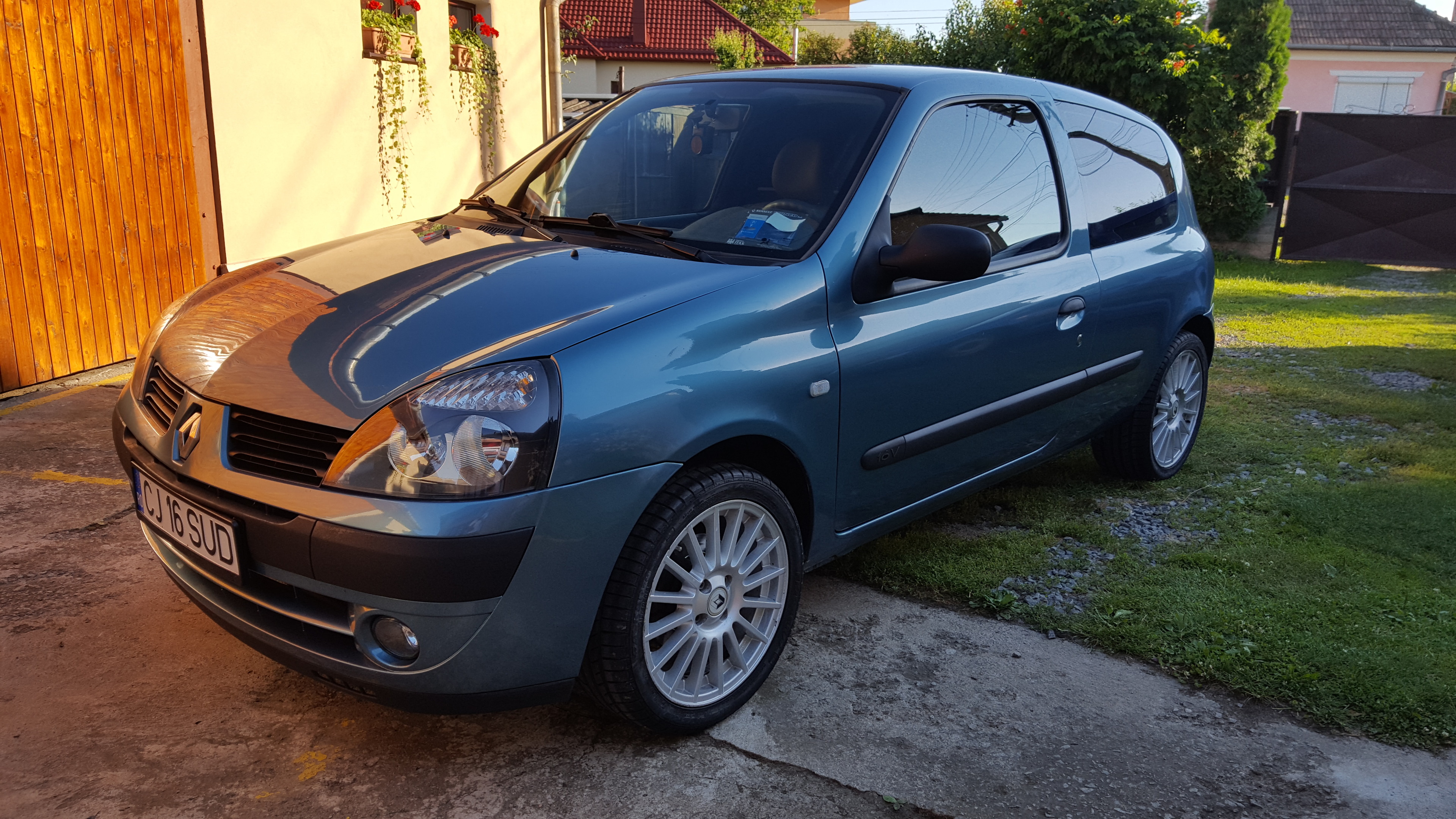

This is my Clio
What I want, is to get a Clio 182 at the end of this year. Maybe a fullfat one that have also the cup suspension and cup spoiler. And also I will paint the car in racing blue.
In around 2-3 weeks I will get a 182. Because I need to convert my standard clio into a 182, I would like to rebuild everything from bottom, starts with the engine.
