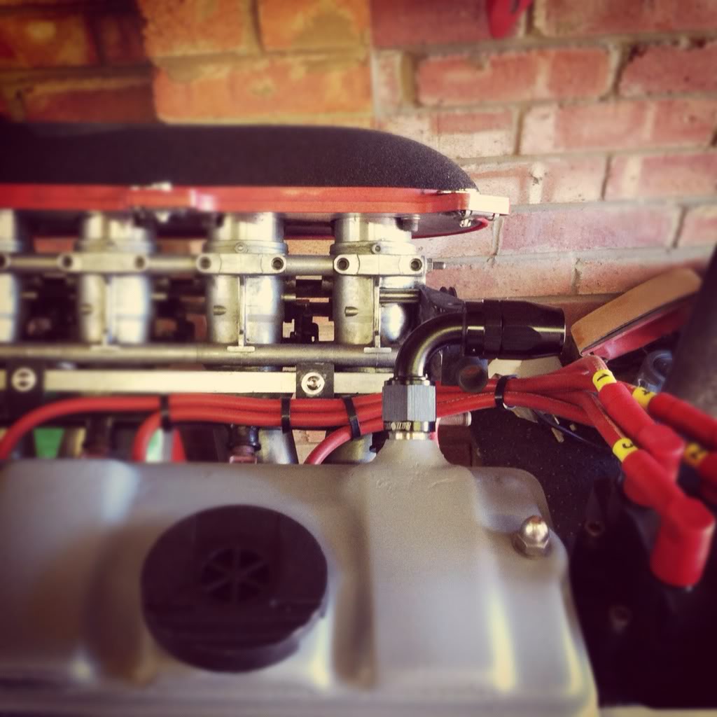

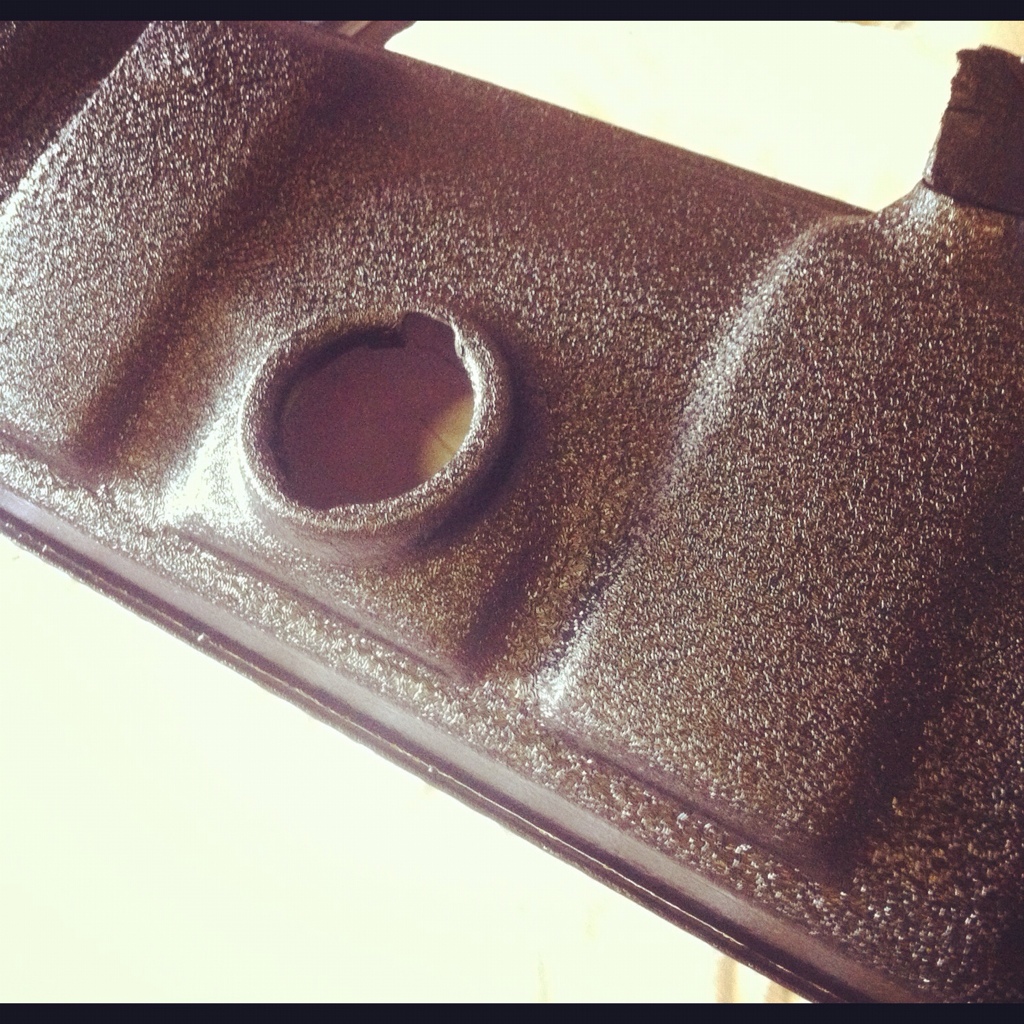

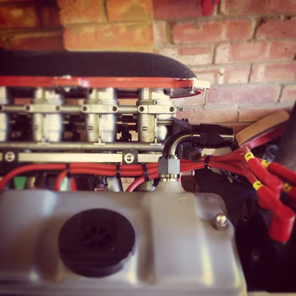

Put my amateur welding skills to the test and fitted my fittings from 'Torques' yesterday onto the rocker:
Pretty unique setup for an 8v engine but allows me to run a braided hose to a catch tank mounted to the right of the bay where the battery would sit. Using all black aeroquip fittings and braided hoses in the car.

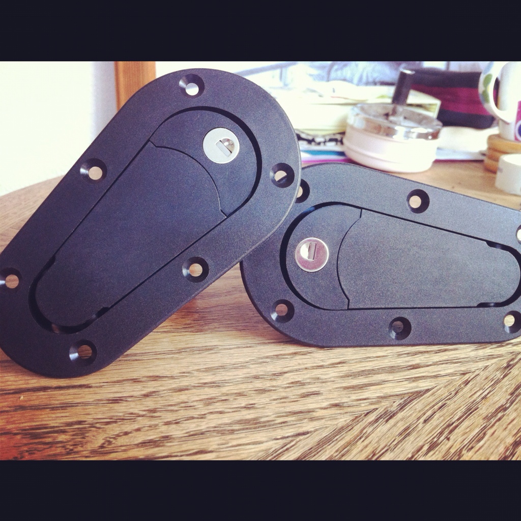

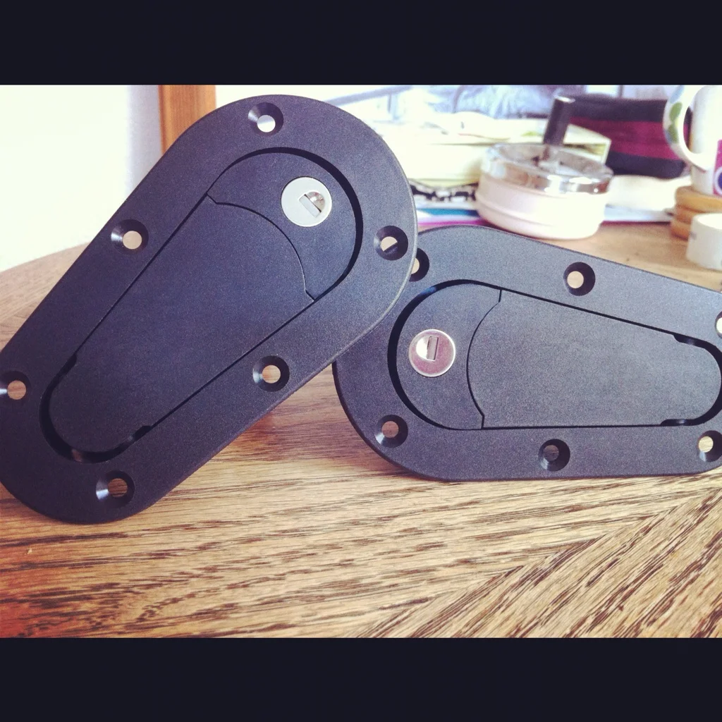

Cutting bonnet and boot inner skin's skin and fitting Aerocatches.

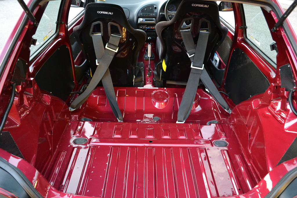

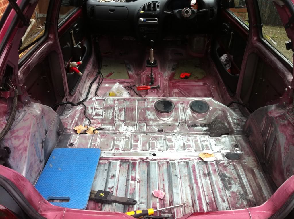

Over the last week I got bored:

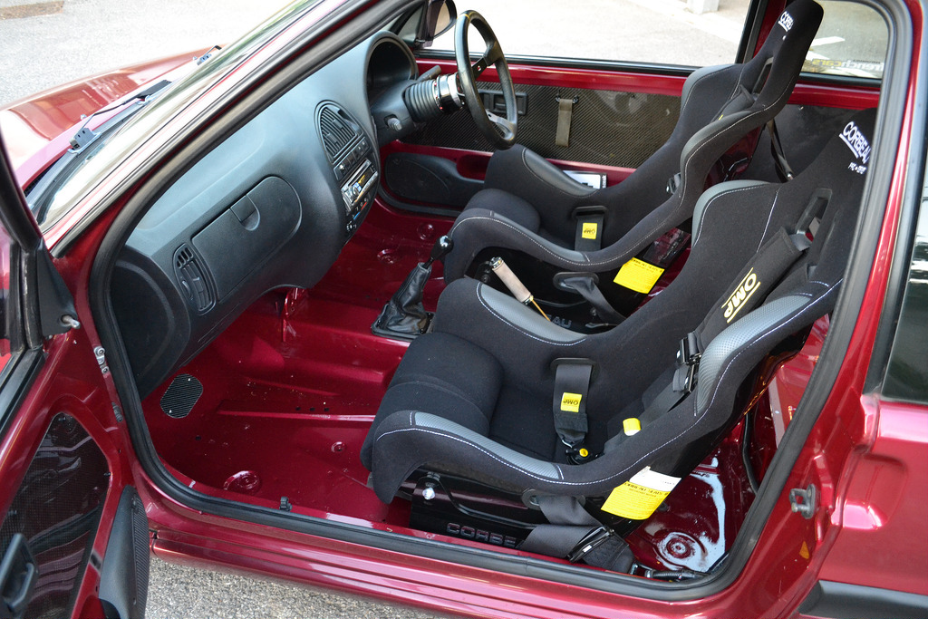

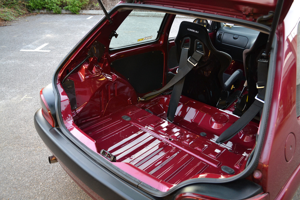

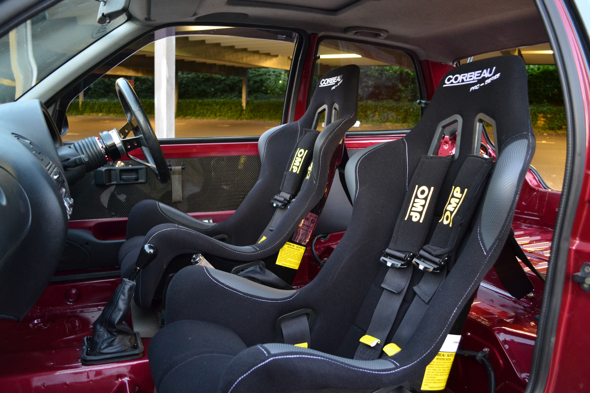

For those who dont know, many moons ago when the car was stripped i aerosol sprayed the interior black.
I dont want the 2pack paint im using to react so im stripping and sanding it all off and getting red of any imperfections. Im spraying the paint myself the same colour as the outside. Hopefully going to look good.
Got my paint through for the interior today. Was sceptical as to whether it would turn out to be the right colour as its a rare shade and was sent out within 24 hours. But turns out to be bang on;
Just need a better respirator now as two pack paint can be quite horrid stuff.

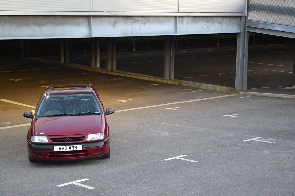

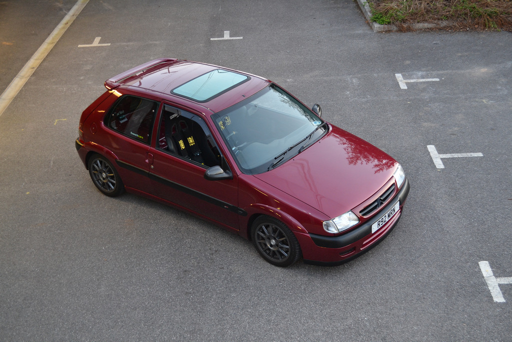

Little update as of late.

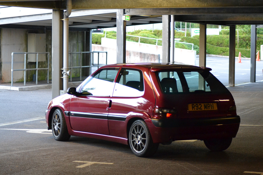

As we all know Trax has been and gone. Really good show and i enjoyed it alot. I won Saxperience Show & Shine runner up, so im mega chuffed with that. Alot of respect for Lea and the GTI taking first, really think it would give Simon a run for his money if they both competed.

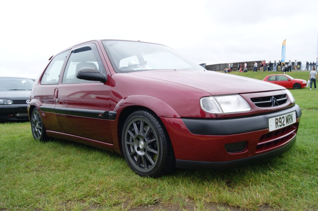

A few of mine at Trax:
And getting the award:

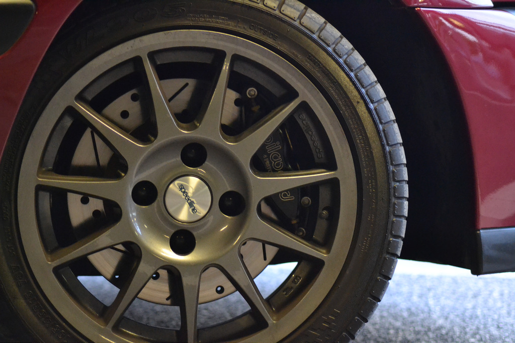

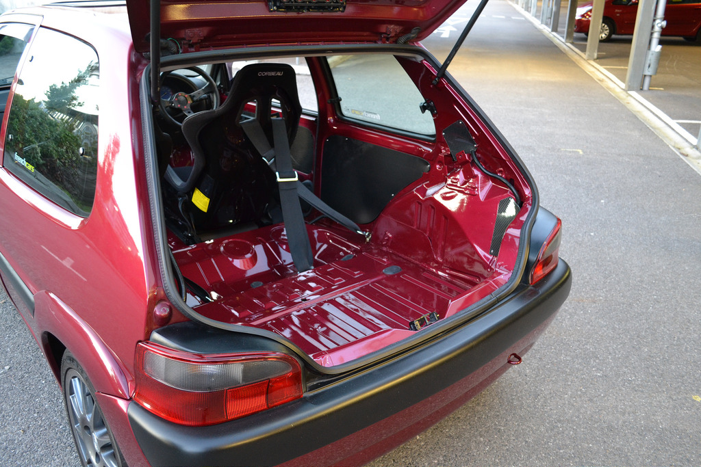

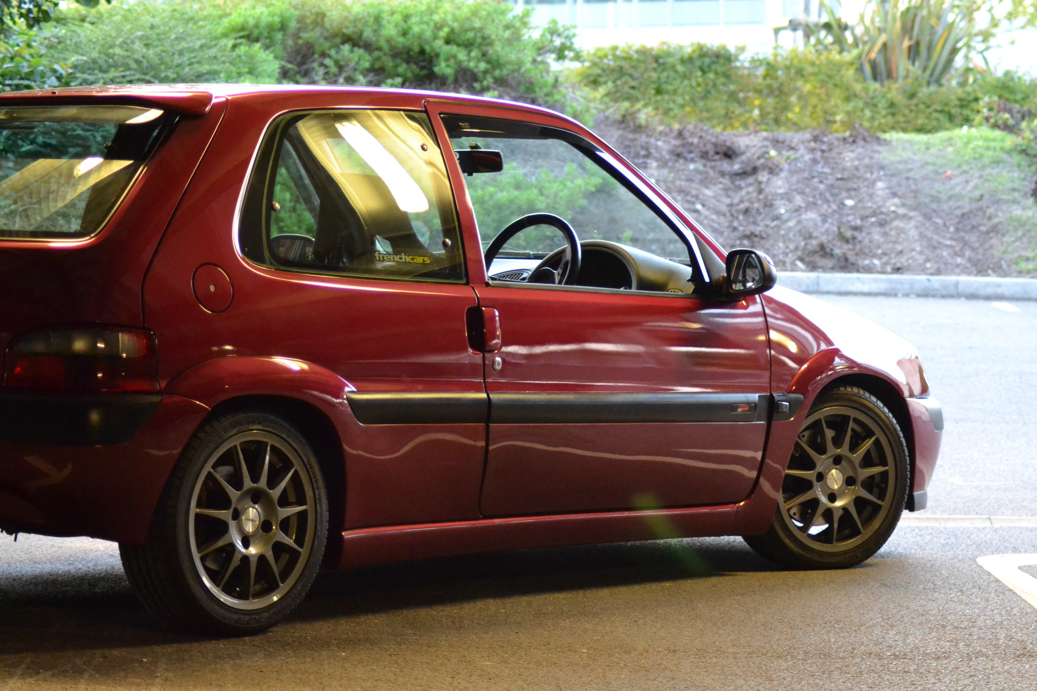

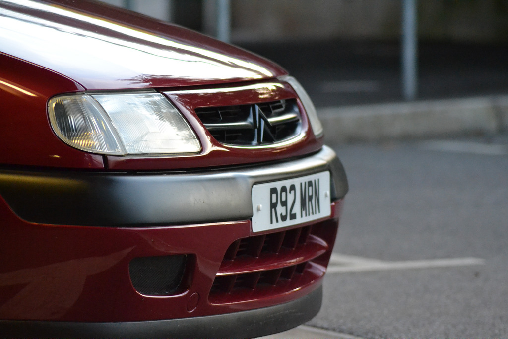

It's been a while since i had a go with an SLR camera, since mine is broken and i haven't been bothered to fix it. I borrowed a friends camera for a quick picture session to show what it's looking like currently, enjoy people.....

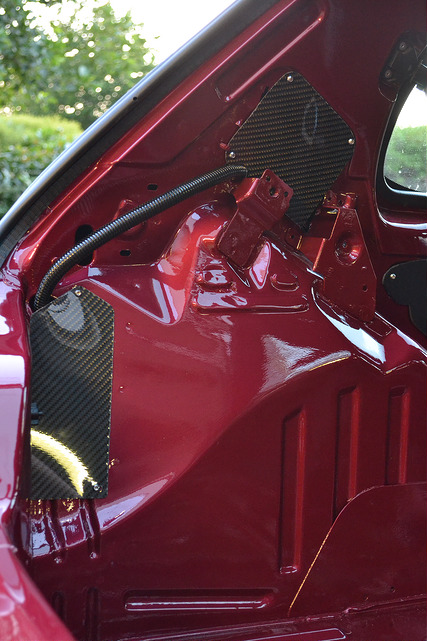

Carbon blanks made by myself:
Car will be SORN in a few weeks so expect some more major updates and engine updates....

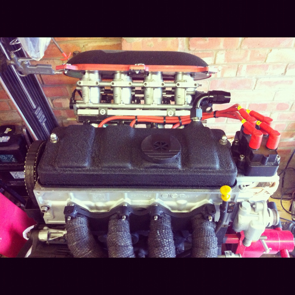

Engine is looking good now. All painted and got some nice bits for it. Just need and ecu, gearbox and flywheel and it'll be in

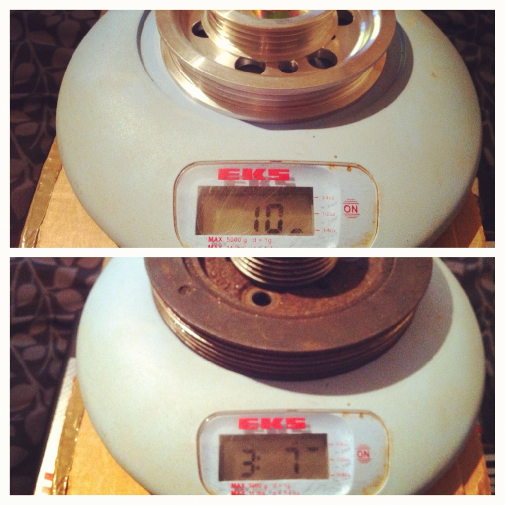

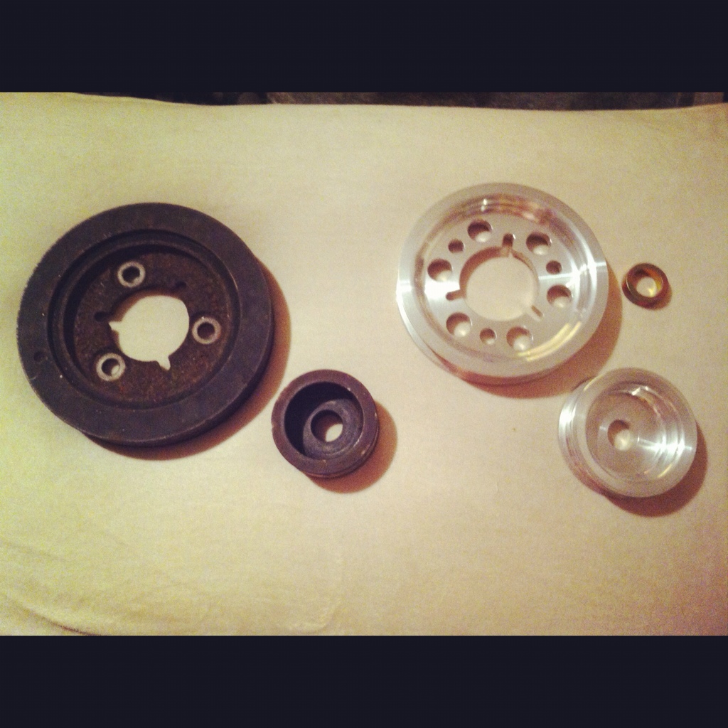

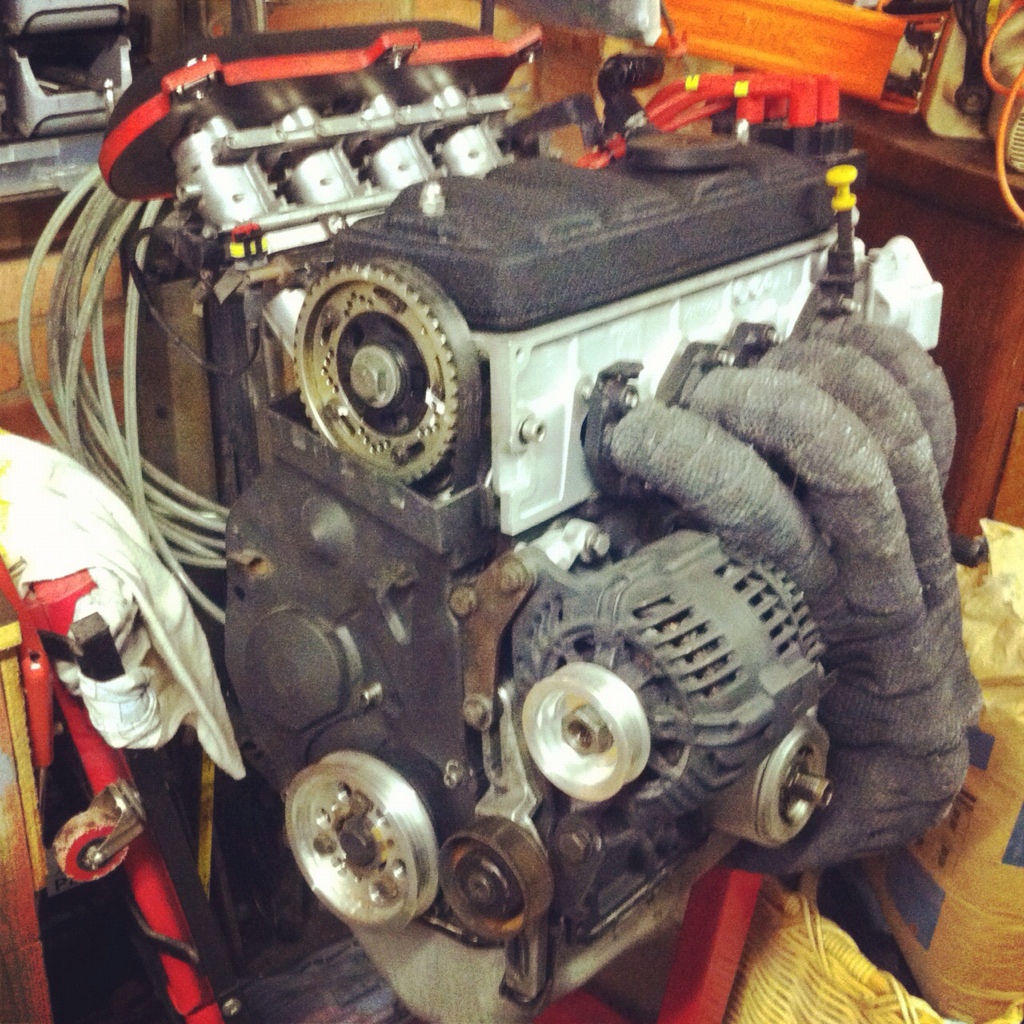

Lightweight pulleys here today from Atspeed. Great quality, and awesome weight saving.
The weight difference:
3lb 7oz before, 10oz now!

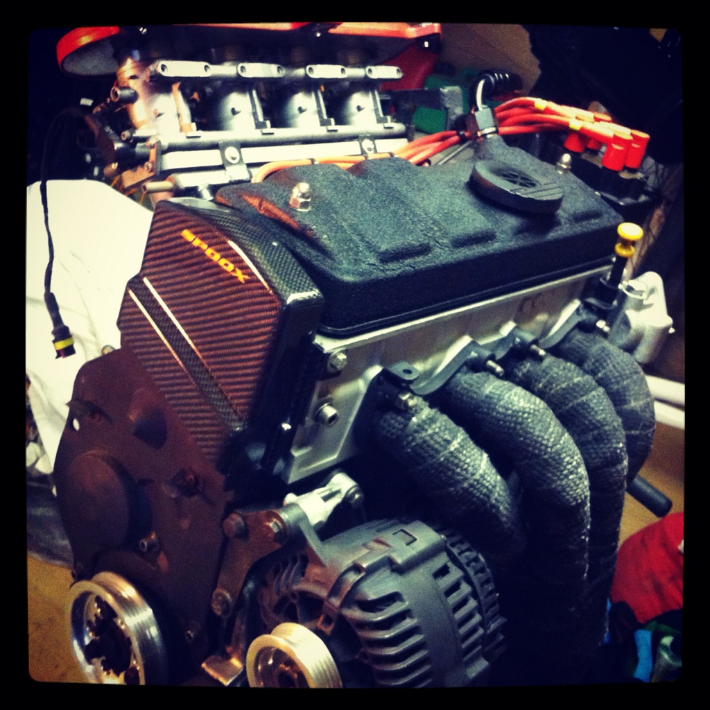

And on the engine:
Only issue is the alternator belt is too small, but i think its because the alternator set up is a 16v one. No issues though as the guys at Atspeed are swapping it over to my current 8v setup.

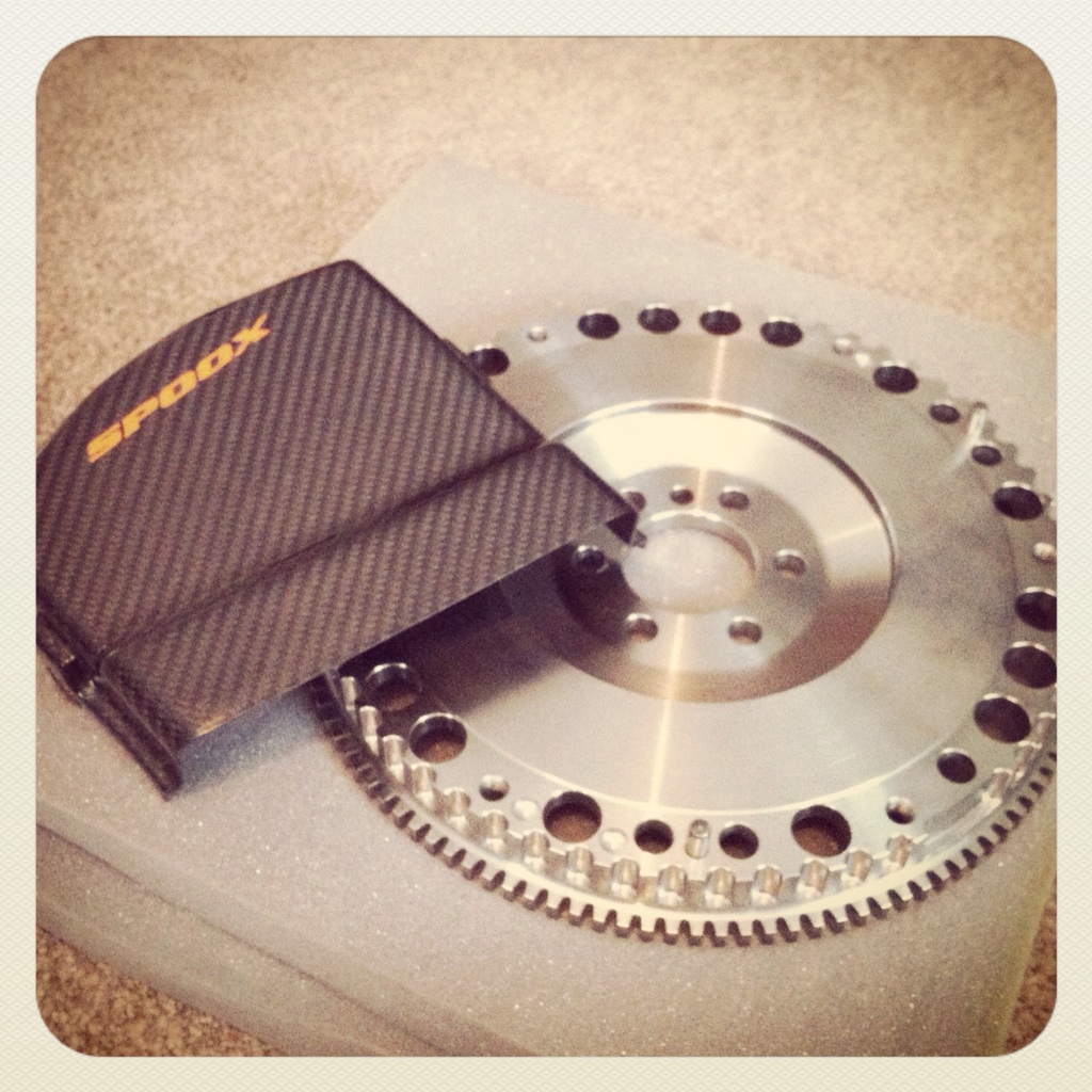

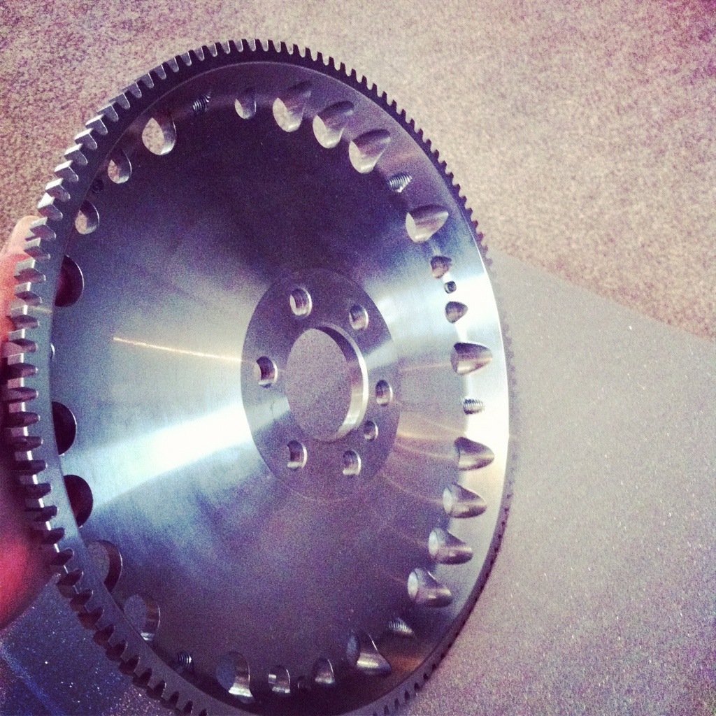

Spoox Carbon Pulley cover, & Atspeed Racing flywheel. I got the late type flywheel with equal bolt spacing on Colins advice as i haven't got a clutch yet and these flywheels are a slight bit stronger.

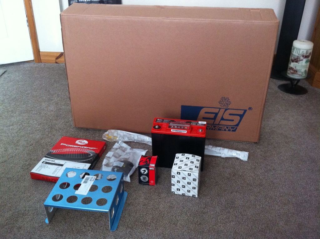

Its been a while, Thought id update with a seasonal update.Car bits i got:
New VTS Radiator
Service items ; Dipstick (lol, as old one is broken), New style oil cap, cam belt, tensioner, oil filter. Just need a water pump now.
Odyssey Battery
OBP Battery cage
Not alot but stuff that will really help get this engine in soon. Need to sort a catch tank and bracket out. Then off to Atspeed with a new gearbox.

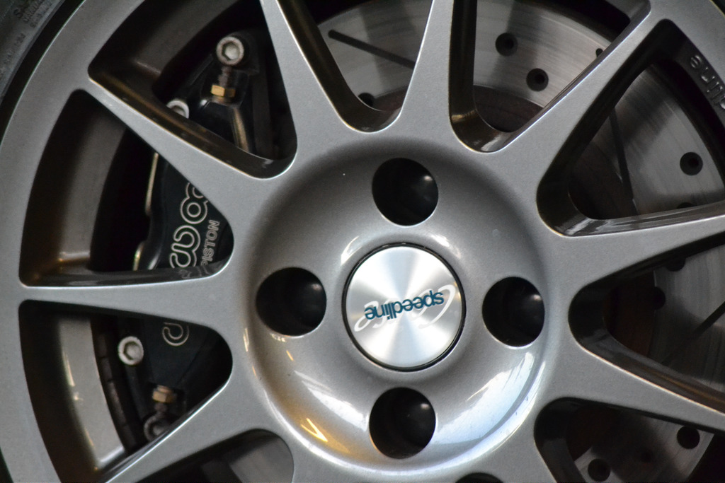

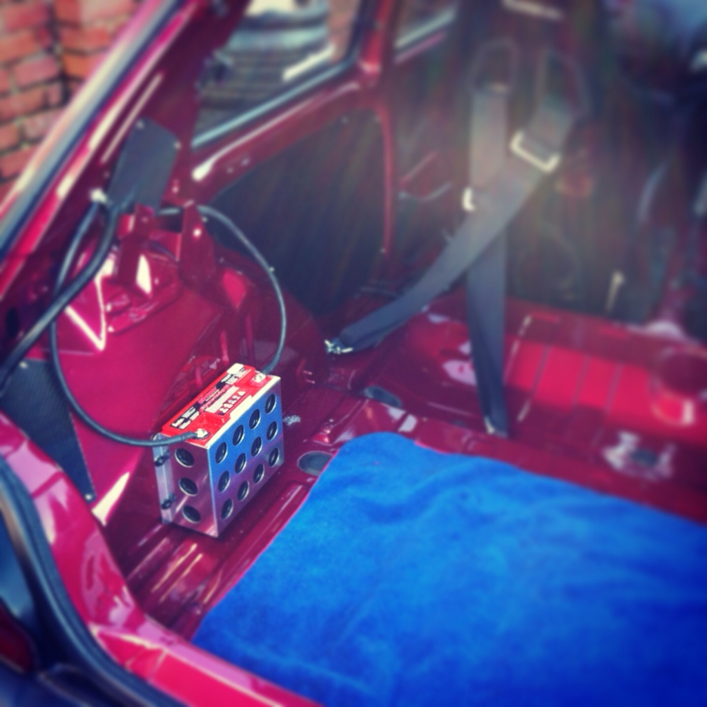

Got the battery in and wired today. Quite a simple job when you have all the bits. Not 100% on the cable routing yet, needs p-cliping down at the back still. Was great to start it up again, have not had it running for over 2 months! It's now back on all 4 Speedlines and sitting on the ground rather than axle stands. Forget how low it is.

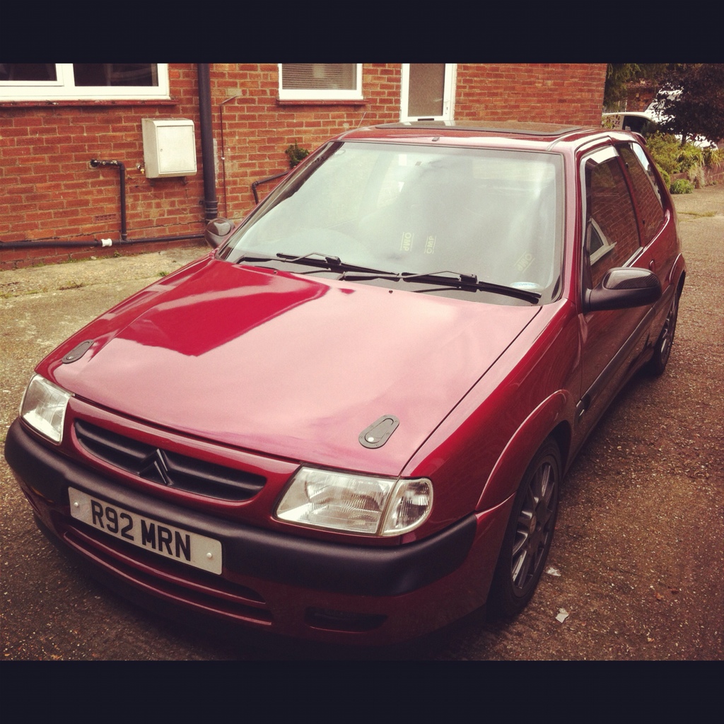

Teaser pic for now;
