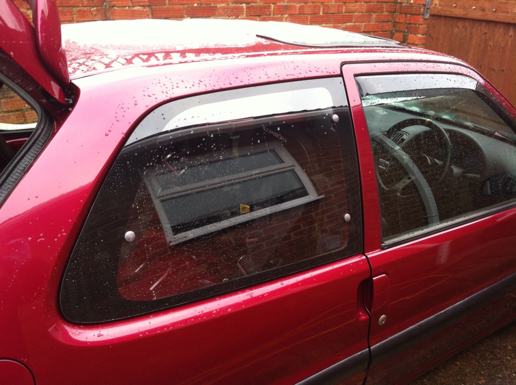

Forgot i had a thread here....... so Yep its still alive, now has a polycarb window. Here's a pointless picture as it looks the same as it did before (the black border looks better than before)

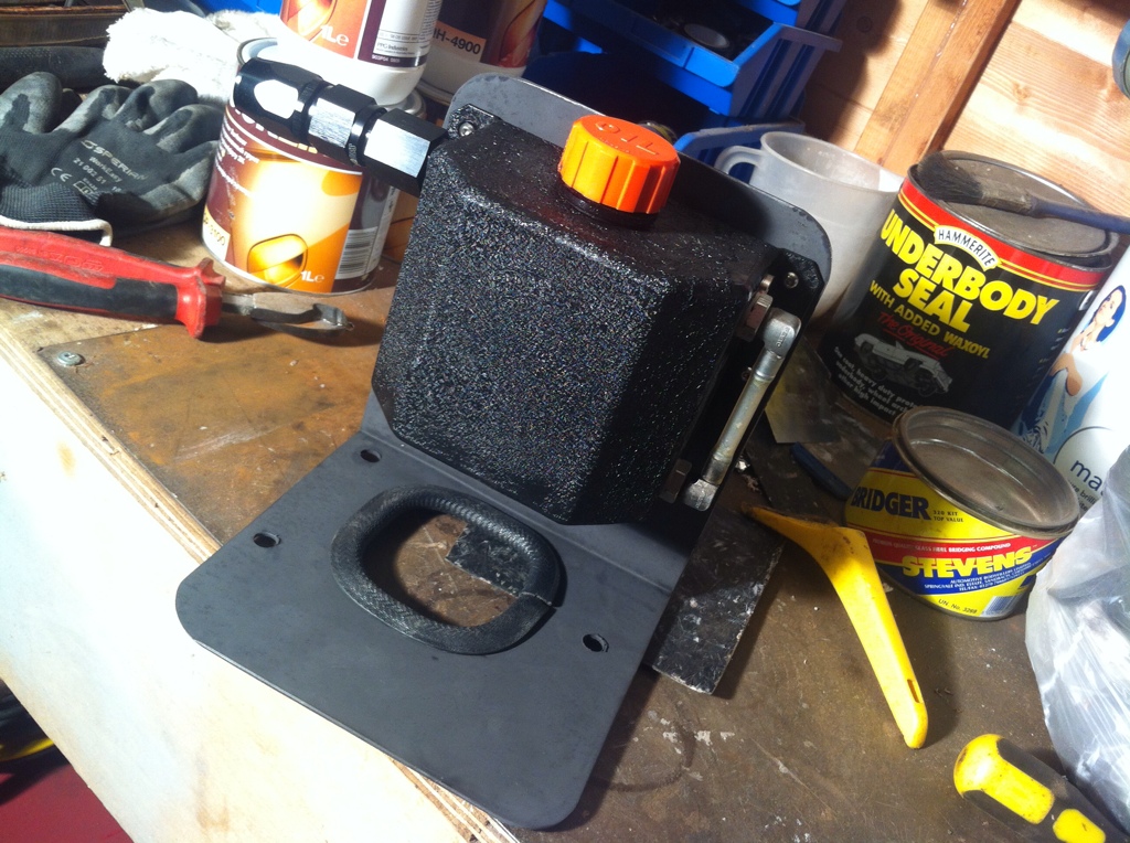

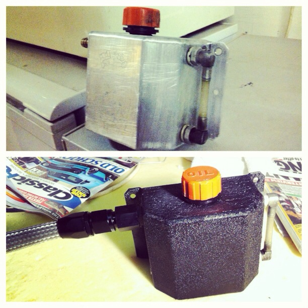

Bought a second hand Mocal catch tank from Spoox a few weeks back, Was a bit beaten up but i have spent some time, paint and pimp fitting on it and this is the result:
Wrinkle paint to match the rocker cover, looks alot better than the pic shows. Fittings are 1/4 BSP - -AN8 - -AN10.

Thanks mate, wanted it to look as oem as possible. Had to run a bead of sealant around it to keep it water tight but uses original fixing points. A friend at work reminded me today that i need to update this thread anyway.

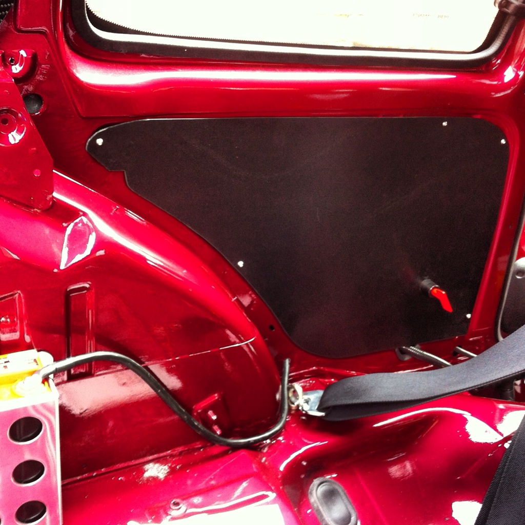

I never was 100% happy with how I wired the battery in the boot. Also had a problem, as the car is sat for long periods of time, the battery is disconnected to save it draining away. But to get to the battery and re-connect it, i had to climb over the buckets into the back as i have no way of opening the boot form the outside. (smoothed lock etc)
So i wired in a little kill switch in a discreet place behind the passenger seat, now i can leave the battery connected and only have to reach to the rear quarter to connect / disconnect the power.
Tidied up the wires a bit too.

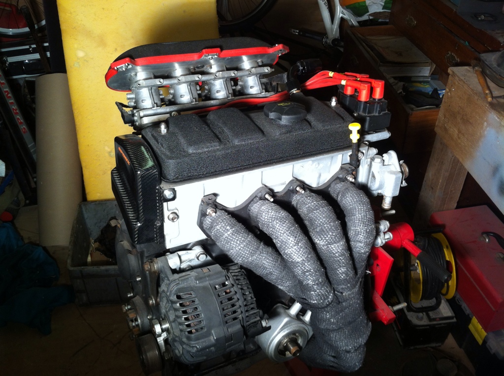

Thanks for the comments people. The lads on Sax-p wanted an engine shot again so i thought it rude to not update this thread too:
And to prove its still alive and shiny:
