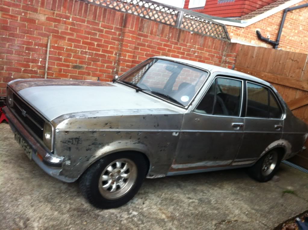

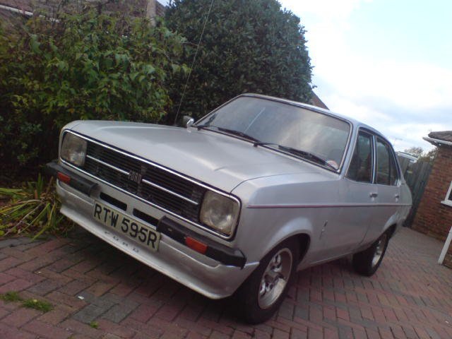

When we got it;

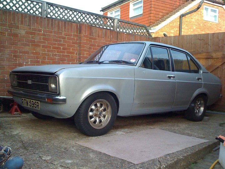

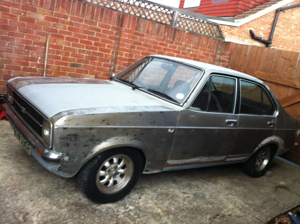

You can't tell by the photo's but the paint was completely shot, someone had tried to rattle can over the original paint and it was cracked everywhere with no clear coat, real mess. Plus the home made 1/4 bumpers and thermos flask exhaust tip (yes it was a thermos flask!)
All in all a bit crap.
At this point we knew we would have to respray it but it would be a bare metal job if we were to do it right.

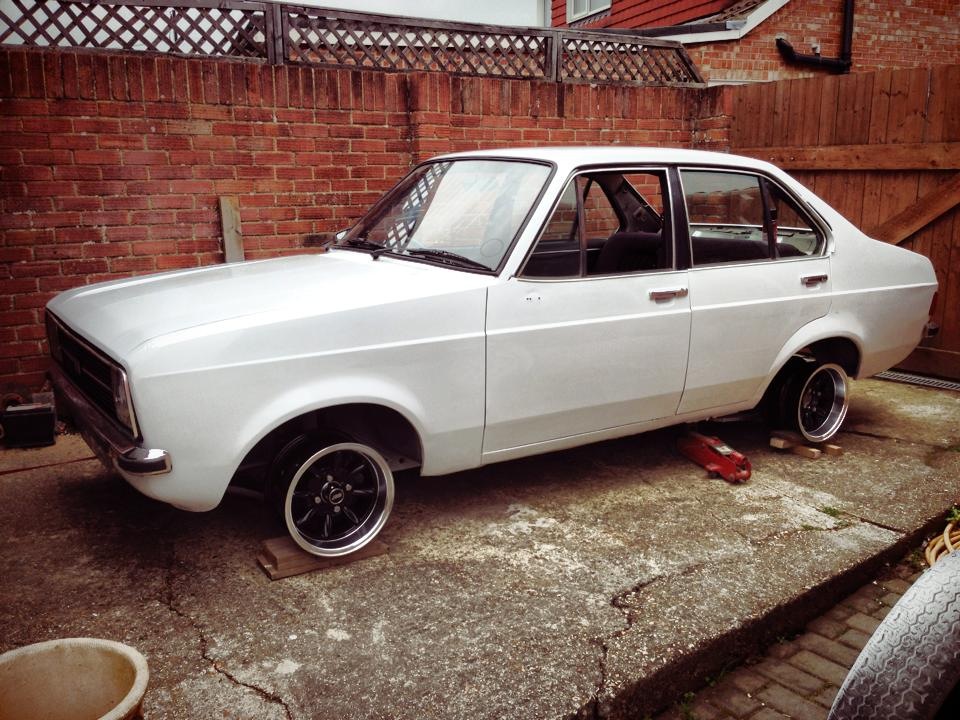

Lowered it 2" on blocks and springs (remember it's a low cost build this, saxo takes up the big bucks), we also have some poly bushed lower arms to fit.
After a few months of sitting around we stripped the paint off and set about fixing all the rust and dodgy filler jobs it had from its previous life.
We set about getting quotes to spray the car and couldn't really justify spending the money with the saxo still here.

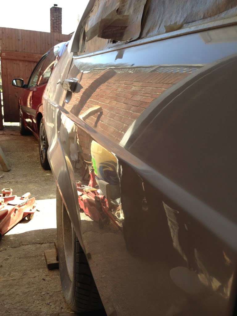

So for a few months (about a year!) The escort was tucked up in the garage untill a few months ago we bit the bullet and painted it ourselves, so we set about finishing all the body work.
After sourcing the paint, thinners and hardener we set to work.

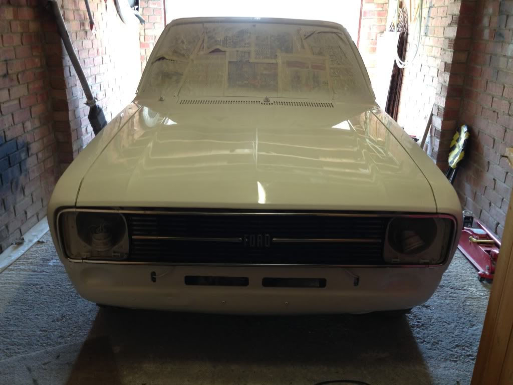

The car was given a going over in the garage, we are planning on doing it again next year as we could of put alot more coats on than we did.
The car was wet sanded and polished by myself and came out well:
The colour is genuine 2012 Focus RS Frozen white.

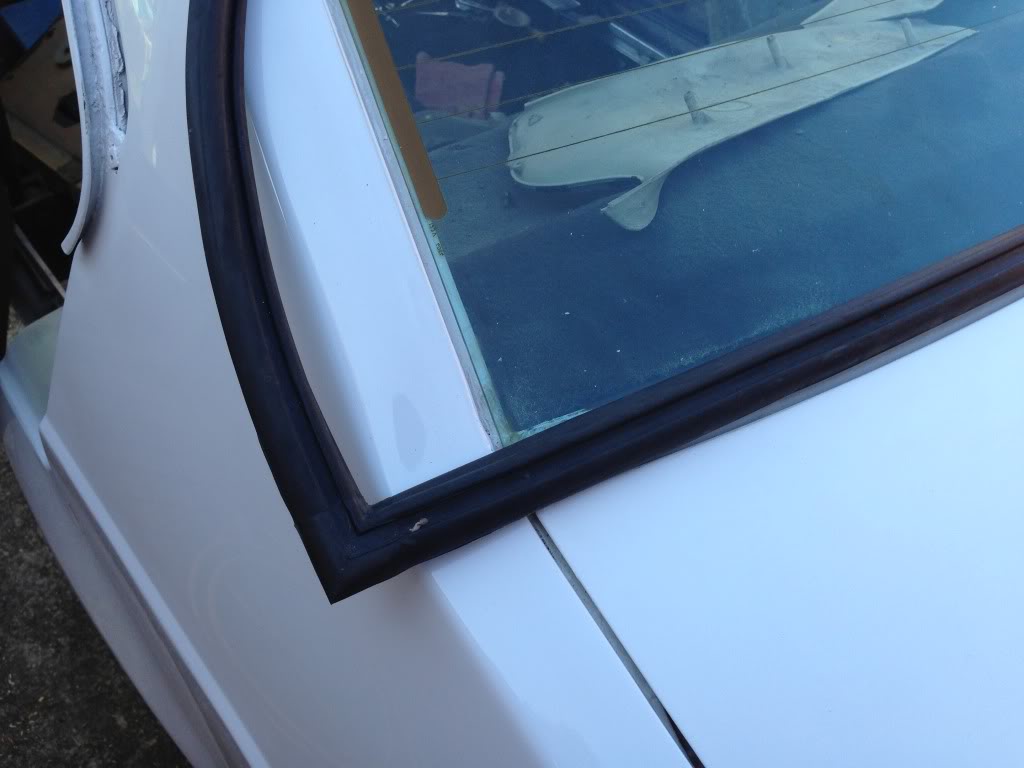

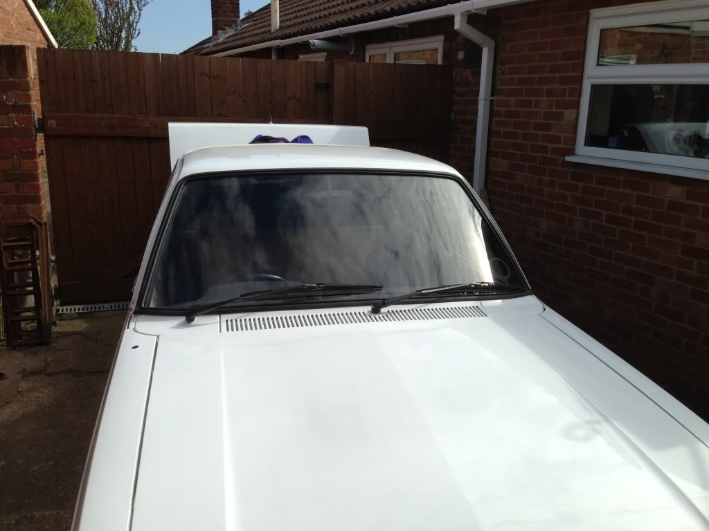

We fitted the screen's ourselves:

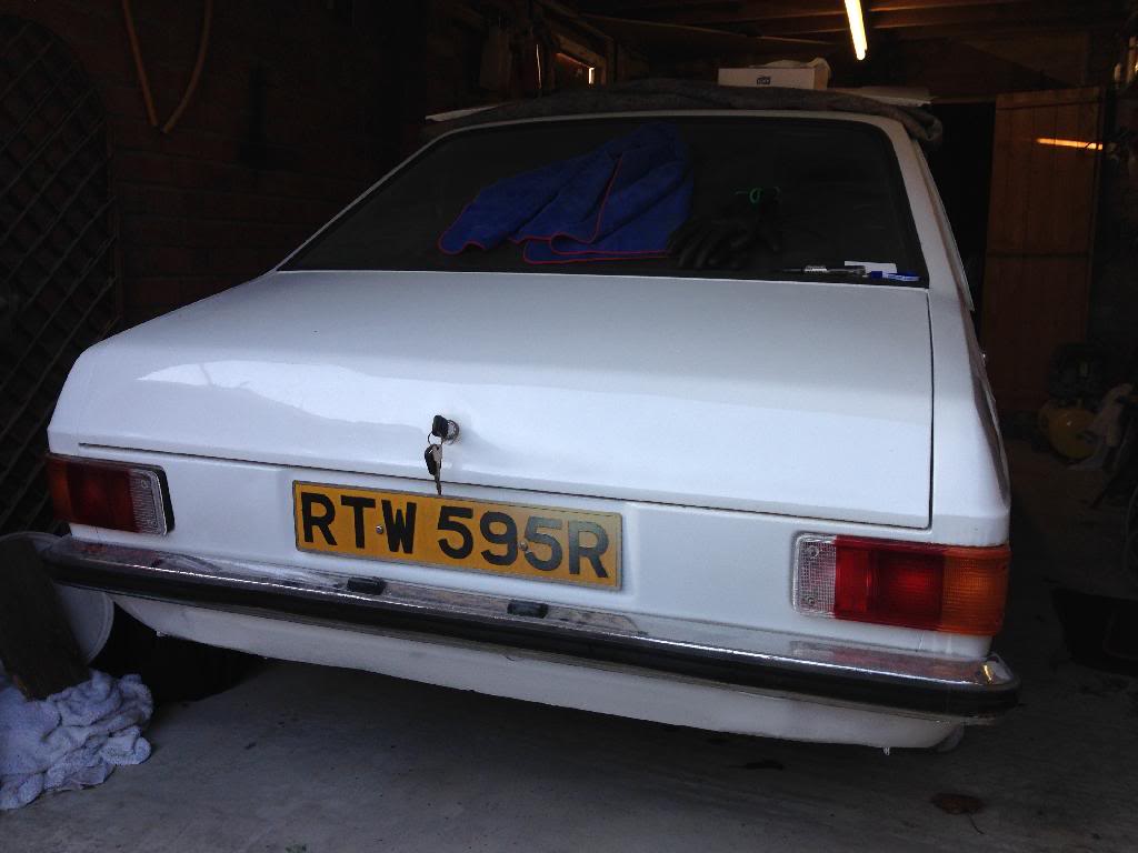

Also got new rear lens's
Apart from the rear one where Burton Power sent us two front rubbers :wall:
After 3 month wait for them to get it in stock, i'm waiting again to for them to get the right one! Total ball ache. This is how wrong it is, hangs over the edge of the car!;

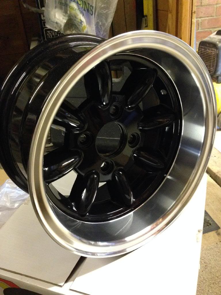

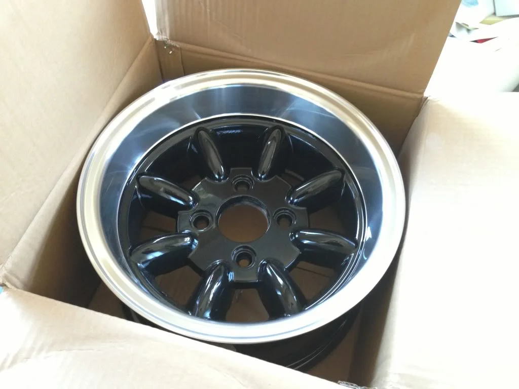

We also decided on the wheels, 8J minilights, black with a polished rim. Currently need tyres but they really look the part:

Superb mate, those wheels are lovley!
The wheels are great, only got them in black by luck, did order all silver but they didn't have any in stock so got these instead. Glad we did now. May have to roll the arches to aid clearance with the 2inch drop but will be worth it for the look. Proper low and wide.

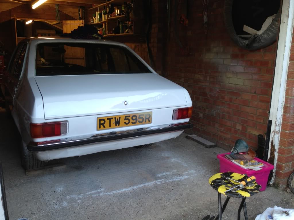

​Little bit of an update,
Got the correct rear screen seal from Burton so will have the fitted and the car 'water tight' tonight.

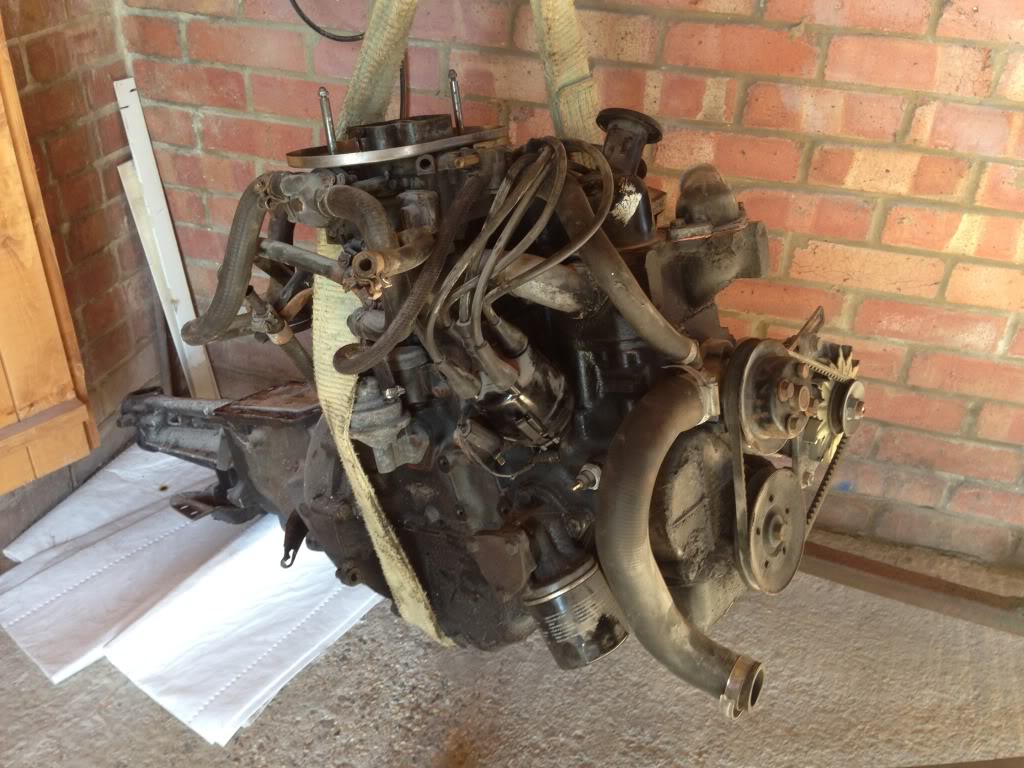

We wanted to get the engine bay sprayed and smoothed so the only thing for it was to remove the engine and box. Simple enough job and came out quite quickly.
It is a right state though, very neglected, so it's time for a spruce up:

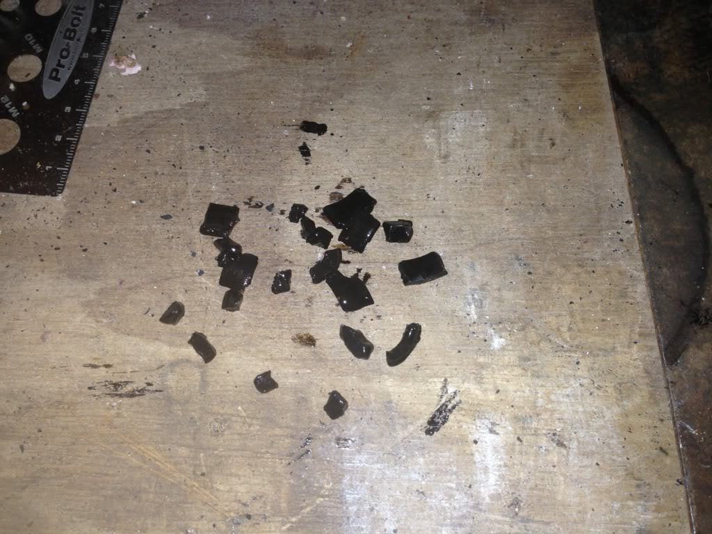

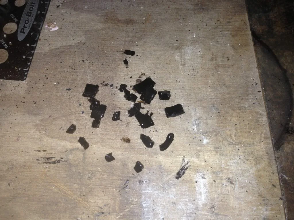

Dad will be doing the bay while i clean the engine. Well that was the plan up untill last night when i removed the rocker and found this:
:wall:
Looks like it has eaten its valve oil seals. You can see in the springs that they have bits missing and broken. Not happy at all!
What was supposed to be a quick job of cleaning and painting is now turning into a full head rebuild.
Could well be down to the previous owner running it on unleaded fuel.
At this point id love to say im sending the whole engine away to Harris Performance for a bore to 1700, 45 webbers and a full rebuild. But with the saxo at Atspeed i can't justify the cost. Yet
So for now we will be fitting all new unleaded valves, oil seals, etc.

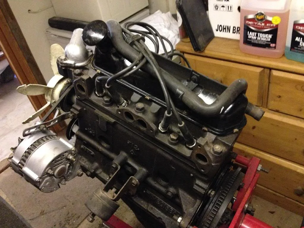

Engine has been rebuilt. New gaskets, valve shims etc. I gave it a little clean and lick of paint. Nothing major, don't want to go OTT:
Looks alot better than it did (see above)

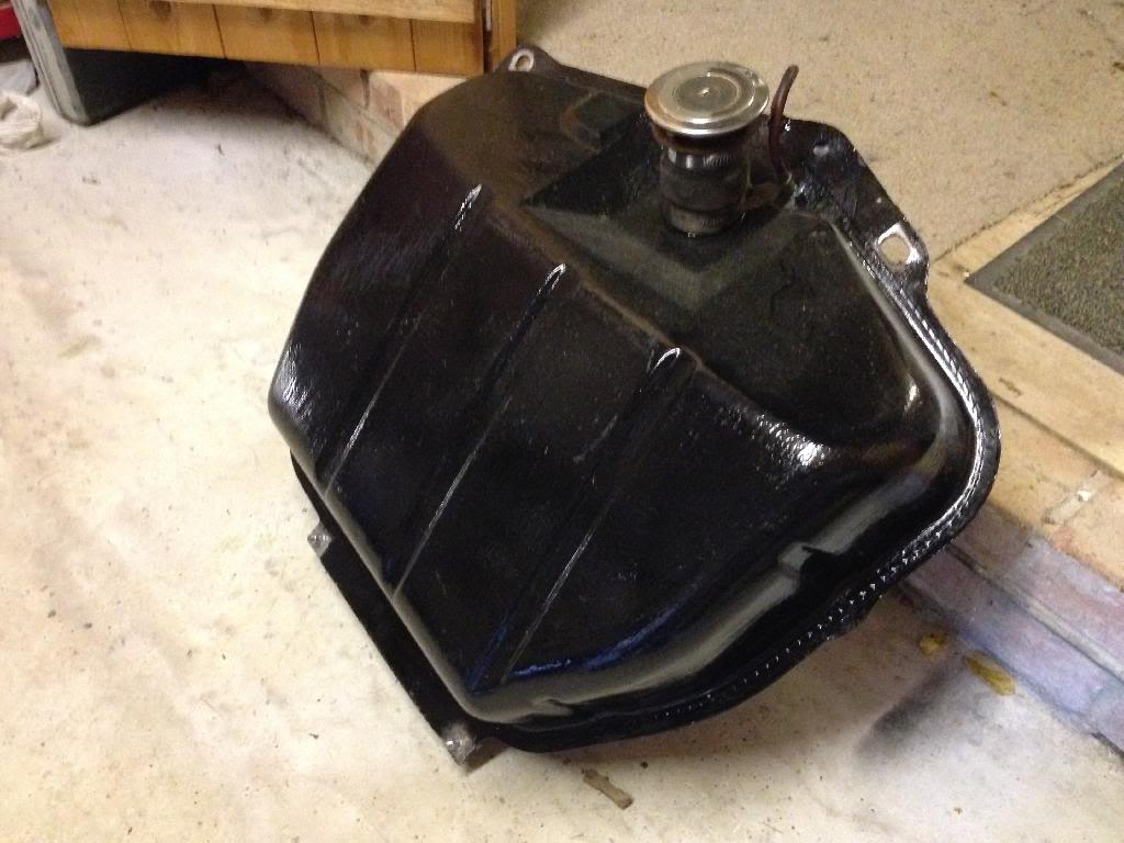

Fuel tank re sealed and treated:

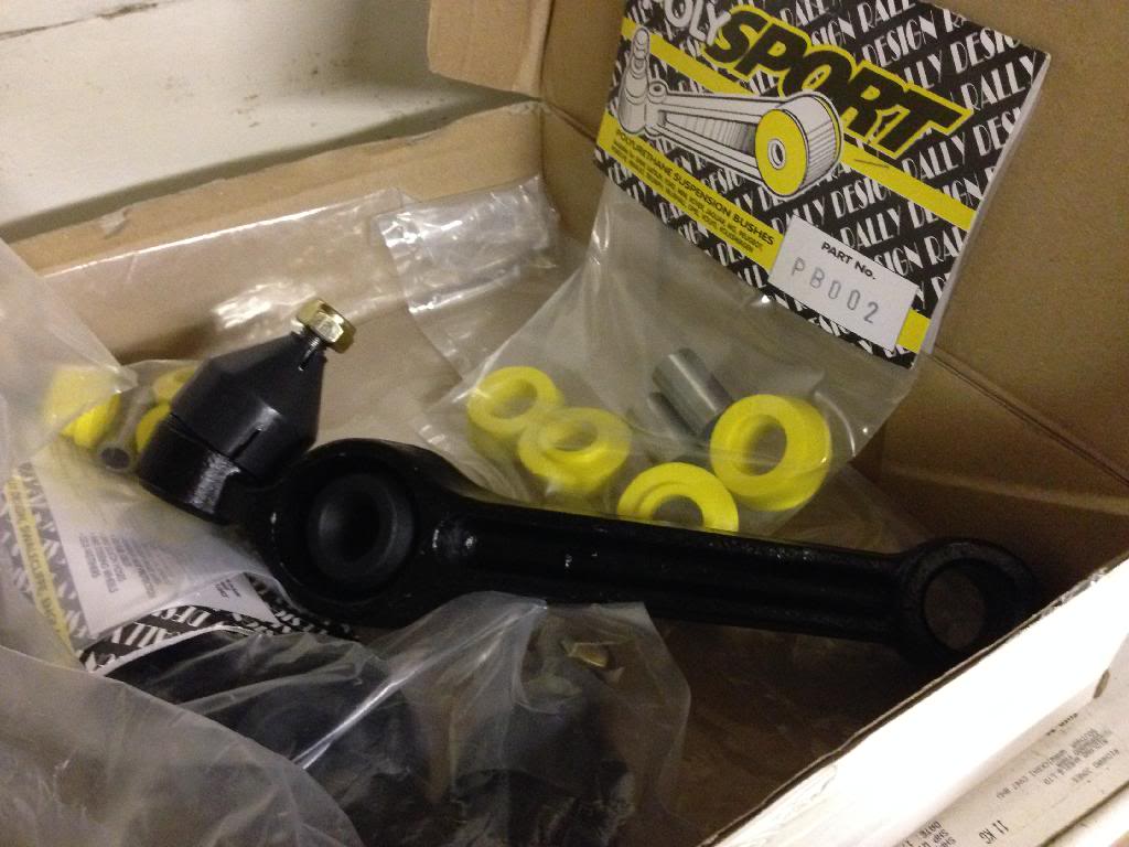

Lower arms and poly bushes:

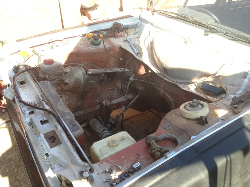

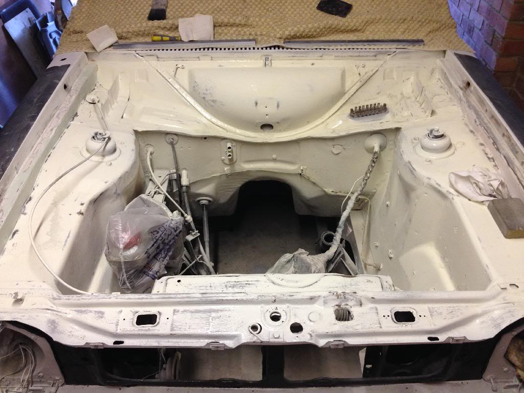

This is how the bay looks currently:
Just a quick base layer, currently smoothing some bits out. Dad did spray everything without masking up :mad: So now we need to remove all that, bloody impatient.
Finally got the rear glass in too:

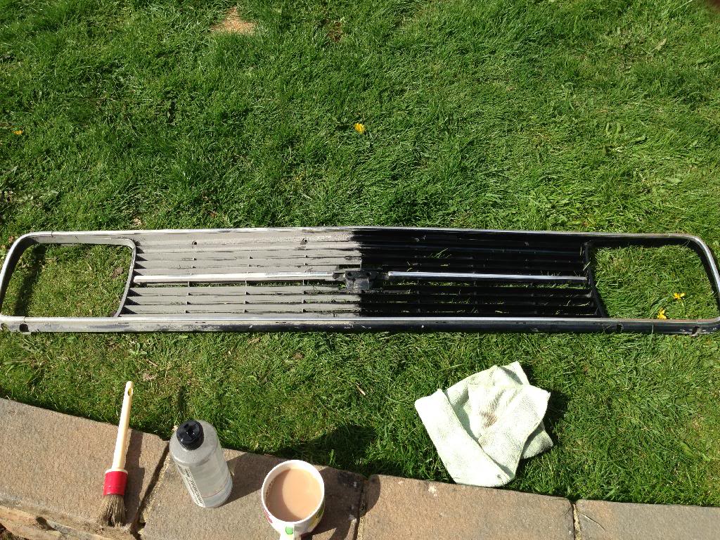

Managed to restore the original grille too, 50:50;
