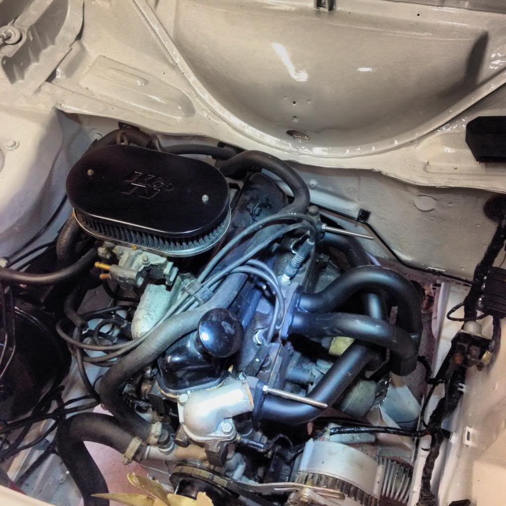

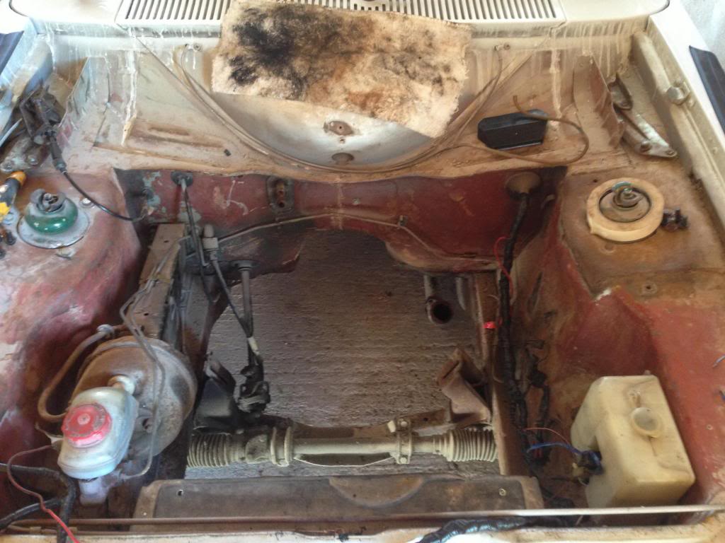

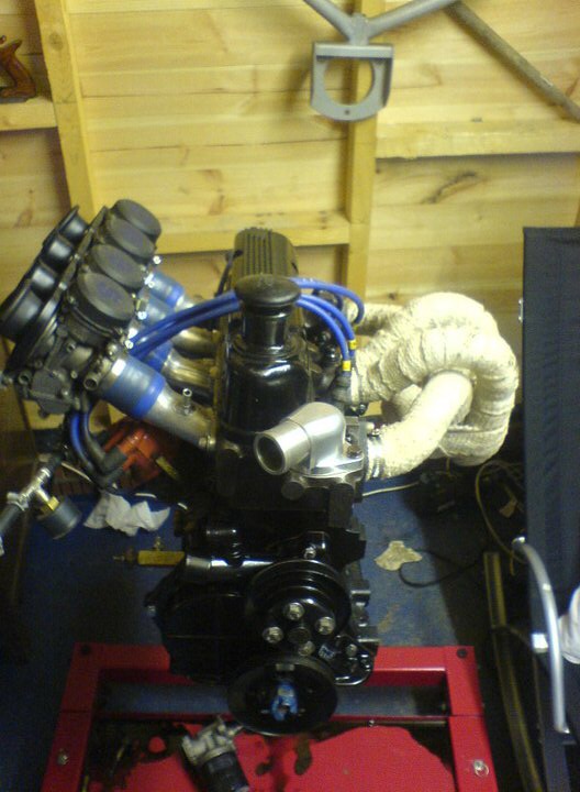

Believe it or not, progress has been made!
The engine has had the head rebuilt, and the bay has been sprayed.

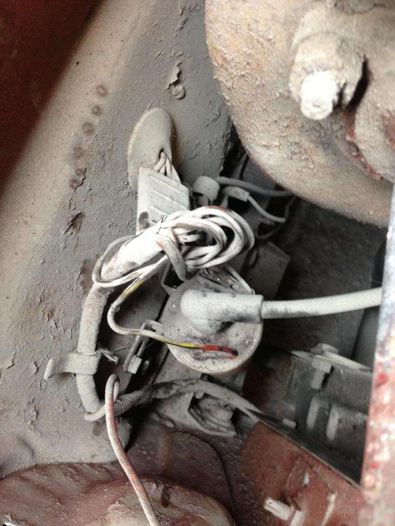

Ive redone the engine loom and ran the wires low down in the bay as they usualy are high up.
We have a new manifold and pipe
Engine, clutch and box are back in.
Weve wired it up and it turns over so thats a big worry gone.
Battery is in the boot
Fuel tank is back in

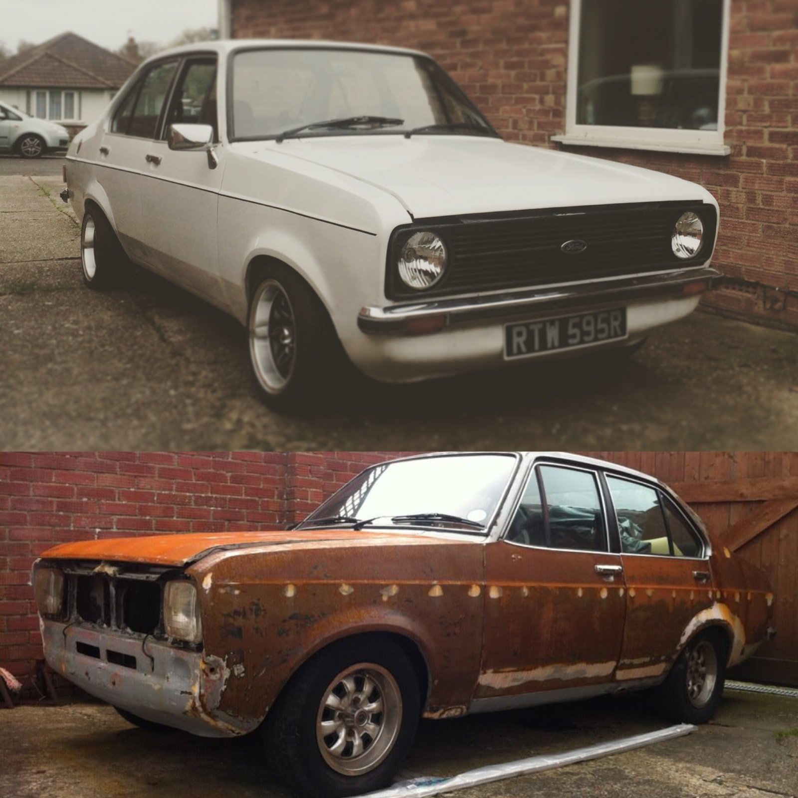

Its gone from this state;
To this;
The inlet and manifold are just resting in place as i still need to paint more bits black.
After they are back on the todo list isnt that big;
Fit and secure battery cable and fuel lines
Fire up and tune engine (fit electronic ign)
Fit propshaft
Fit tyres to wheels
Re fit all lights etc and make sure they work
Refit grille and bonnet
Then a much needed wash and it near enough done.
The suspension will need dropping at some point to replace the top mounts but thats nothing major.
Hope you like, id like to have dropped a zetec in but its a cost that cant be justified yet. However it may happen in the future, for now its just been to restore the car and sort that stance.

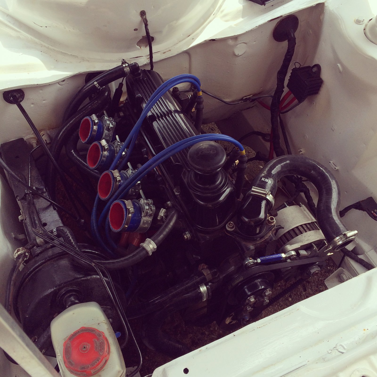

I'll keep it short. Old engine, seized.
New engine, cammed, bigger capacity, trick head, bike carbs. 130bhp
Gaz suspension all round.
Other bits you can see.
Soon to have a blow over, bumpers, brakes, diff and seats.

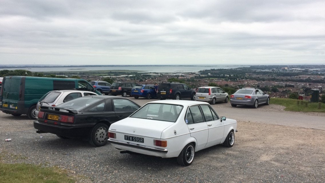

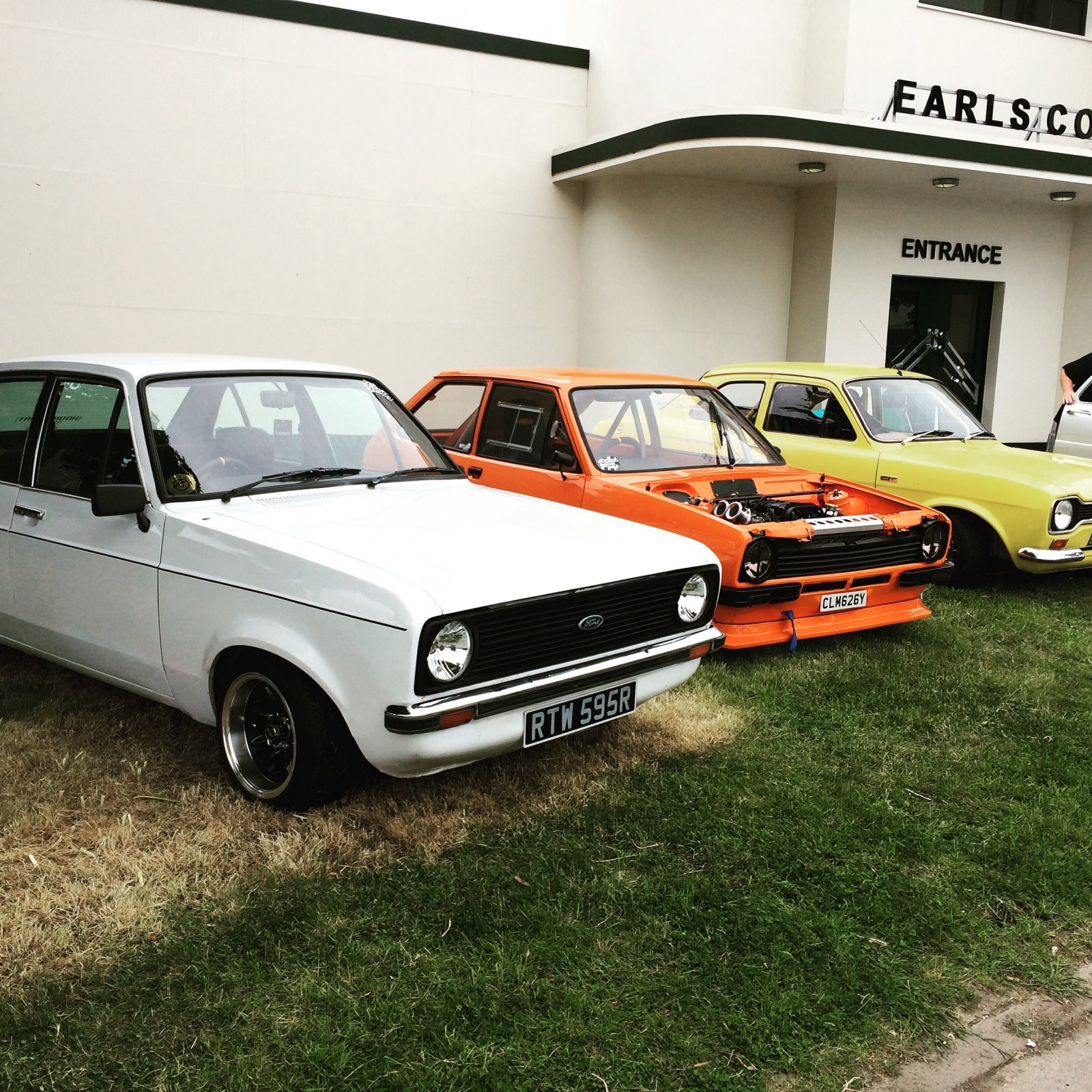

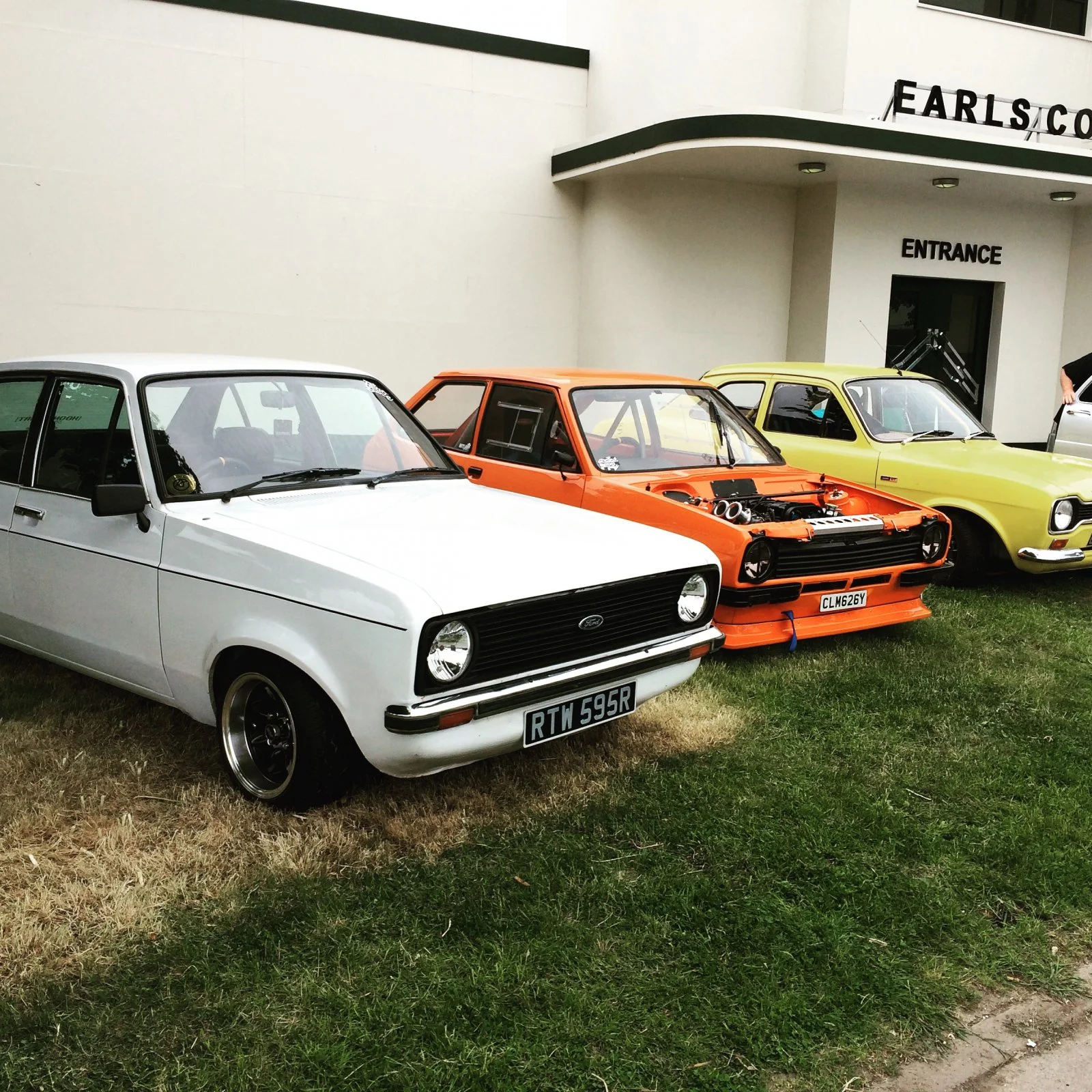

From a local meet. Snapped the throttle cable leaving though, it was to tight in the carbs and wasnt turning freely, after an embaressing tow home it's all sorted now.

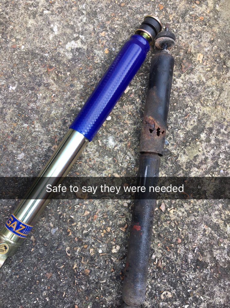

Spent yesterday fitting all new gaz dampers, single leaf springs, front coilovers and a few new polyrace bushes. Safe to say it was needed.
Next I need to get all the parts to overhaul the brakes, all new lines, pedal box, wilwoods etc. But I may chuck a set of roll top seats in there to keep me busy. Once thats all sorted I can get the axle diffed up and get some smokey burnouts on the go. Then maybe ill look into a respray.... Maybe
