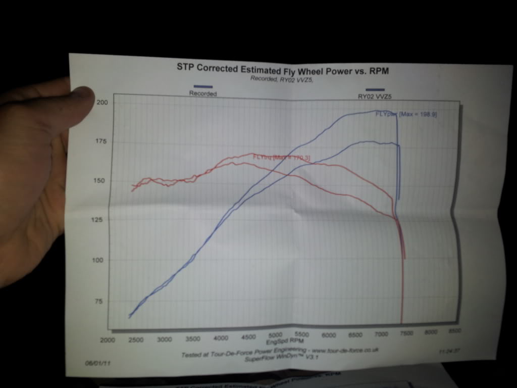

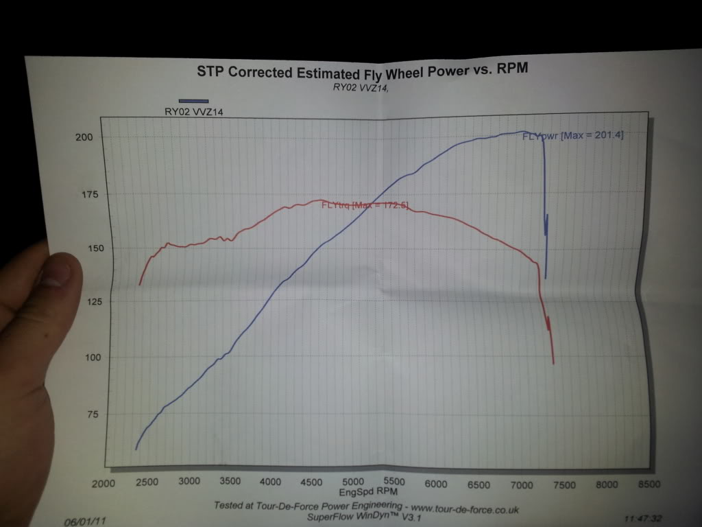

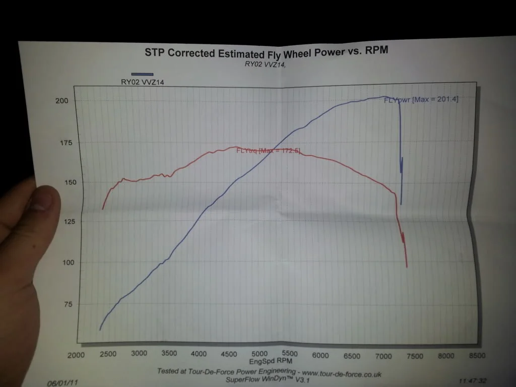

well knew i had problems so off to tdf i went! roaded the car and oh dear!

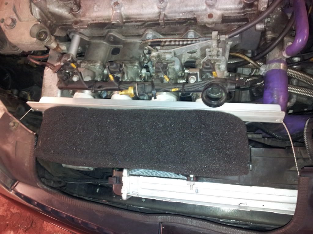

of course bottom one is the befor power and torque... so compression test was done.. that was fine 13.5 across all 4 cylinders! then we looked at the k-tech filter... it was basically pulling back onto the trumpets and killing the cars power! que me being a pikey!
that little bit of L shapped ally made all the diffrence! :D and here are final power firures for you all!
quite happy with that torque! :D

Happy days, surprising how a little bit of bodgenering can go a long way. Shame you've had so much trouble before by the looks of it!

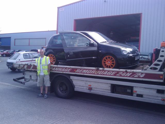

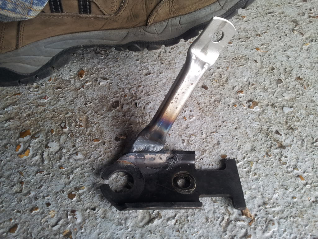

well what fun i had the day i had to leave for germany! the bell housing on the gearbox decided to crack and car wasnt going into gear.. soooo off to work we went!

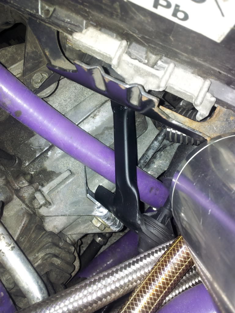

new mount made up
box tig welded up with a plate to strengthen it and the new mount installed :)
