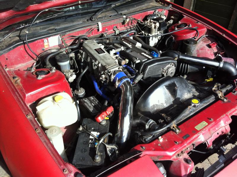

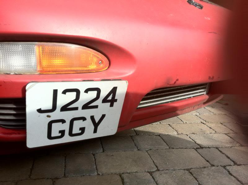

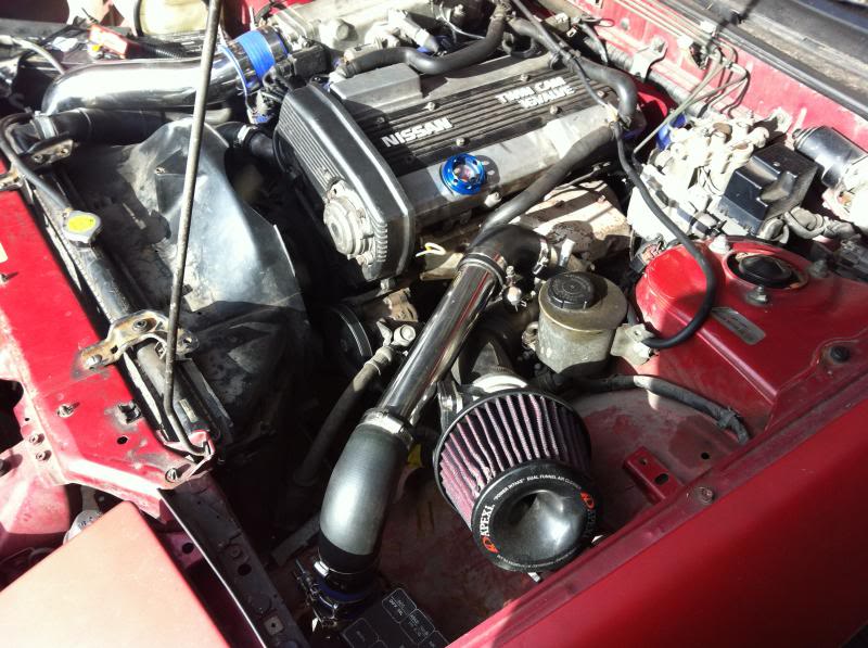

As promised, some photo's... You'll notice that its been neglected for many many years haha. Lets start with the new heart though, new CA18DET with FMIC, T28, Apex'i Induction Kit, Apex Boost Controller, Apex cat back exhaust and a stage 2 chip:
Its still a work in motion, first of all the car was spiking as previously stated. A quick trip to DCMS and he noticed the the actuator was connected correct so he hooked up some vacuum hosing and problem solved. He also told me to disconnect the vacuum hosing and then I can add in a boost controller and feed it to the actuator. 1st time round it was a £15 boost controller off of ebay, this was spiking so I went to Apex in Bradford and grabbed one of their boost valves. When I got home it was scratched and looked like it had previously been fitted however if it worked ok then this wouldn't matter... I fitted this last weekend and went to try and set the boost up in the week when the intercooler pipe on the hot side decided to blow loose. In retrospect this explains the ticking noise and possibly the boost spike...

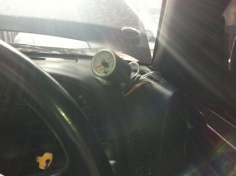

I have reconnected the boost pipes today but now the boost gauge isn't reading so I think the boost valve might be used and returned to them as it is connected according to the instructions, great. I'll give them a ring tomorrow. Getting this thing running right at stage 2 is becoming a right ball ache!

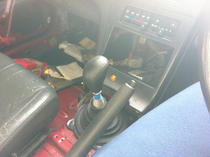

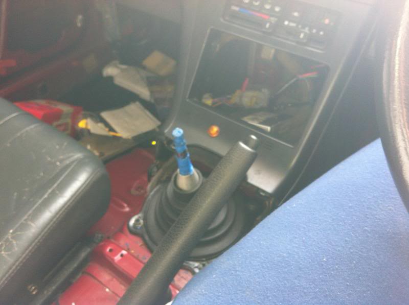

The interior... well I used it as a storage bin for crap and also took the gear knob for my celica and the radio out for another car etc. As a result it looks a bit like this
Boost gauge is only placed for the time being, I keep on disconnecting and reconnecting to make sure its not me putting it in wrong that stops it from working :S

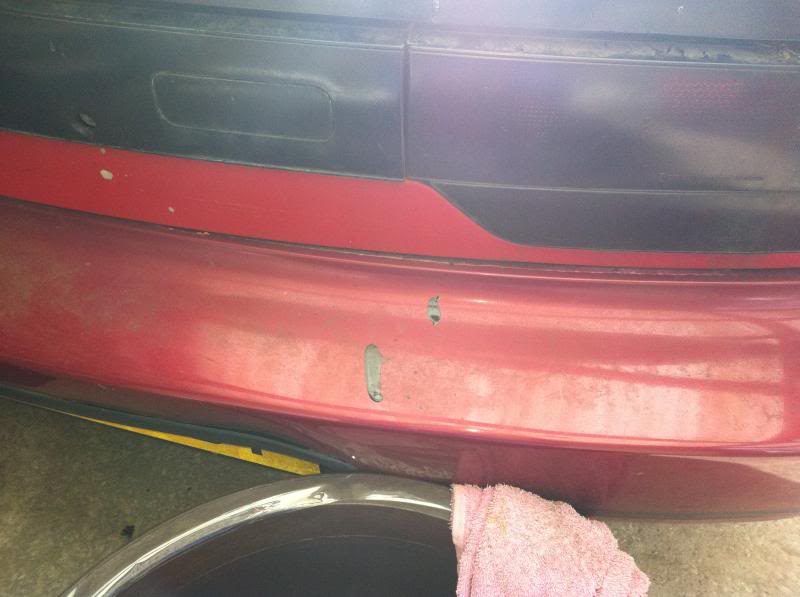

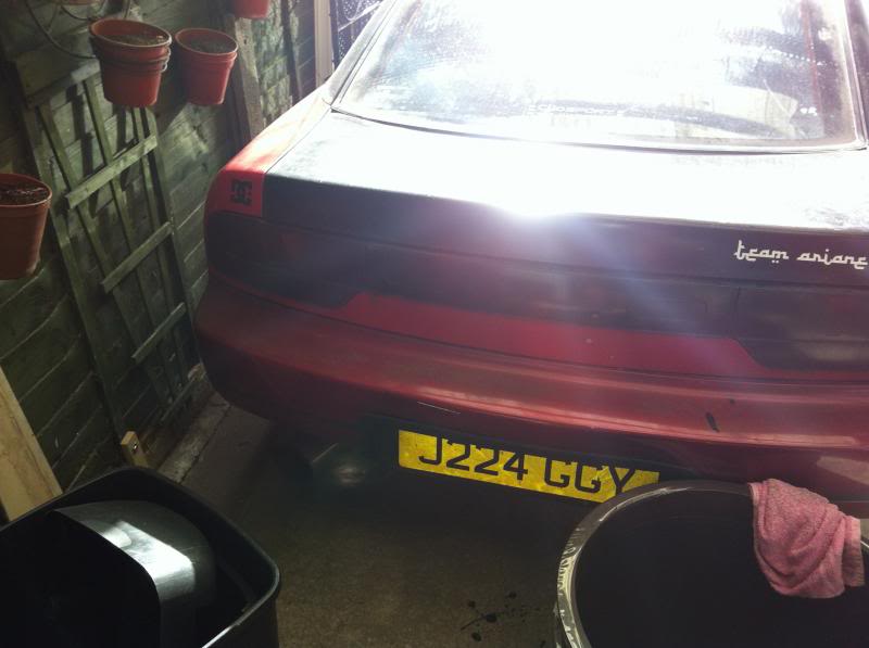

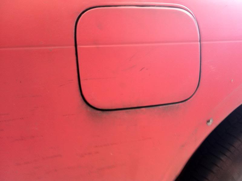

And then theres the outside, the paint (although it was never 'good') is fcuked. There are extra blobs of paint here and there and missing bits of paint and plenty of moss dirt and general crap too

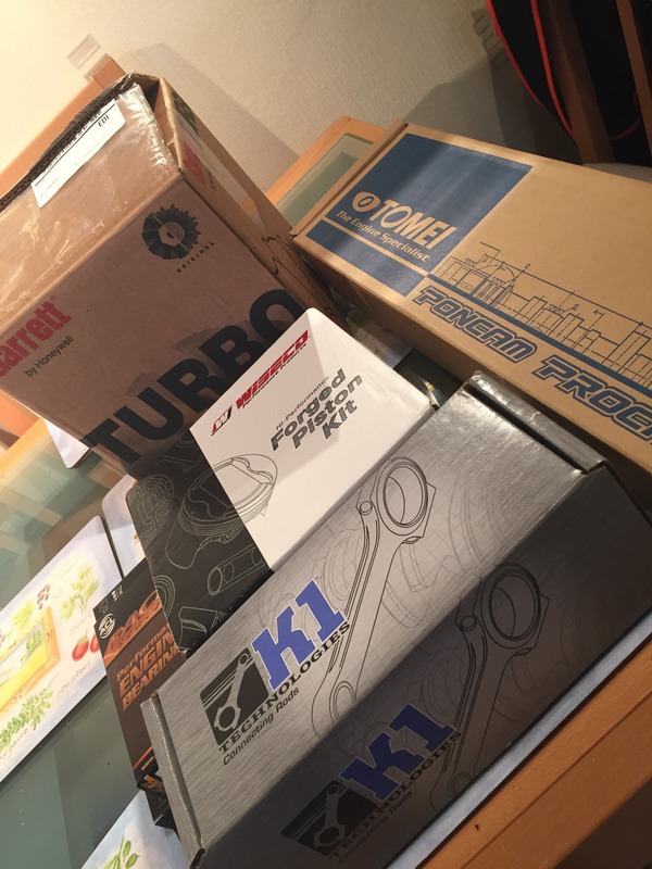

So... The cars still at DCMS. His engine builder was apparently swamped and finally can get around to my CA18 now he's finished the supra they had. I was contemplating re-shelling the engine for a 'nice' s13, but appreciation has happened and nice ones are well expensive. I guess I'll just have to try and make mine nice then (I am getting older...)
In anticipation of my finally professionally rebuilt engine. I have some bits. The next update will involve tears and hopefully be less than 3 years away, although its out of my hands and as you can see speed of work is an issue.
