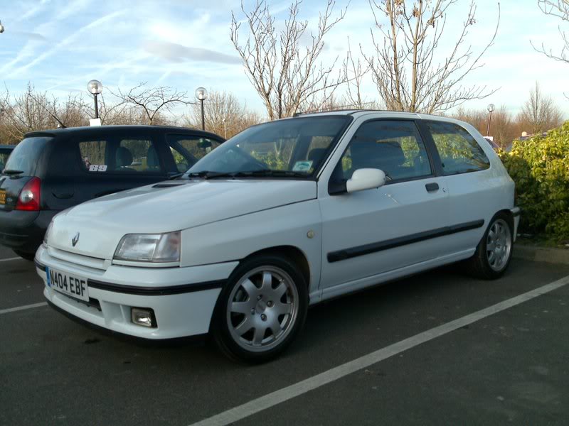

i found a white hybrid for sale from a nice chap called andy on here was a decent spec and looked perfect for what i wanted.
so me and a mate set off to go have a look on a real nice what felt like sumers day, anyway after having a look around we agreed on a rpice and it was mine, clio number 5 lol.
a pic from the stop off at burger king on the way back
looked quite nice but i didnt like the white as much as i did the black but its defo growing on me and most seem to agree.

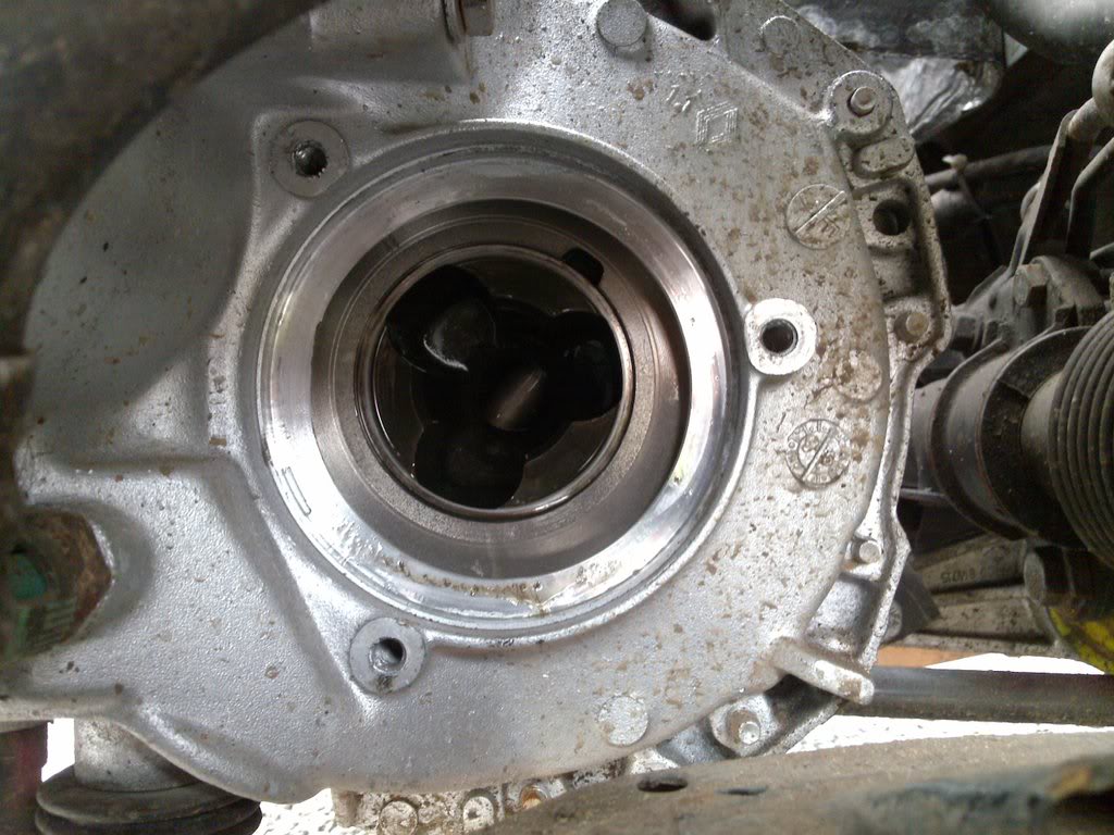

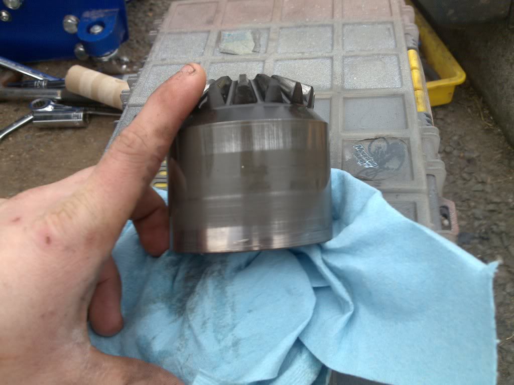

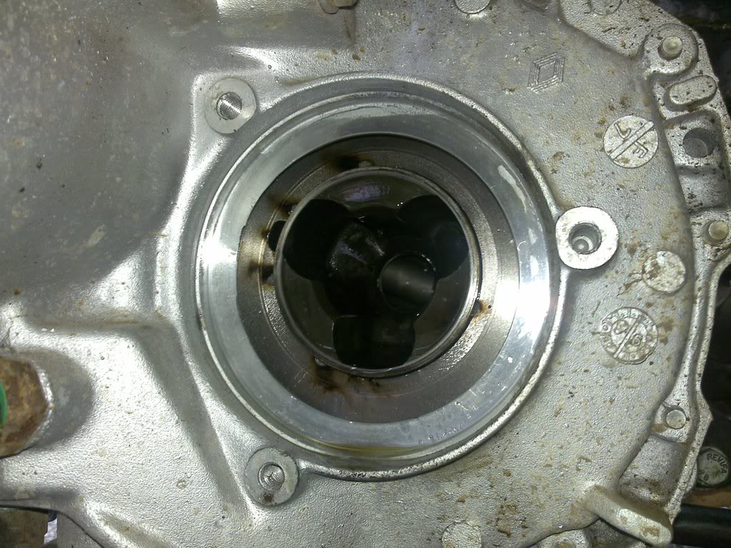

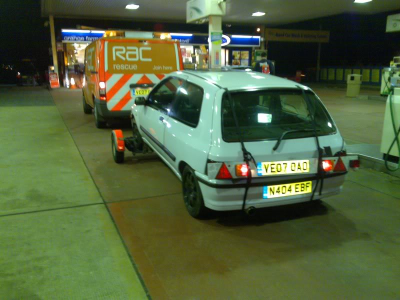

anyway harvey came and rescued me found the fault and it was the circlip in the gearbox bah bugger tits w**k over 100 miles from home and the car didnt move lol.
so after a hour or two trying our luck with the aa with chris's membership it turned out he wasnt coverd for it but turned out andyrg was and said if he could sort a fan belt then he would use his for me.
ended up wating until around 7 for the rac to come get us from the pizza hut in the next town, blagged it by saying it was andys car and to make it easyer for the rac to drop it off at mine. i gotta say a massive massive thanks to andy for this saved me alot of hastle mate cheers.
car on the rac trailor just my luck

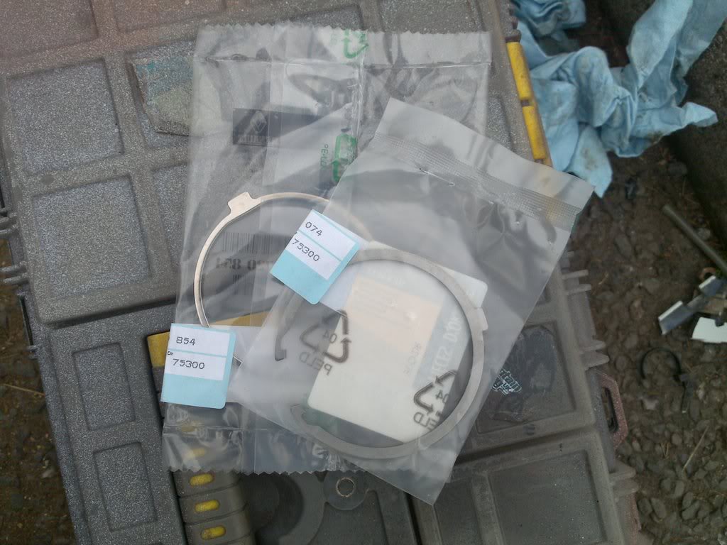

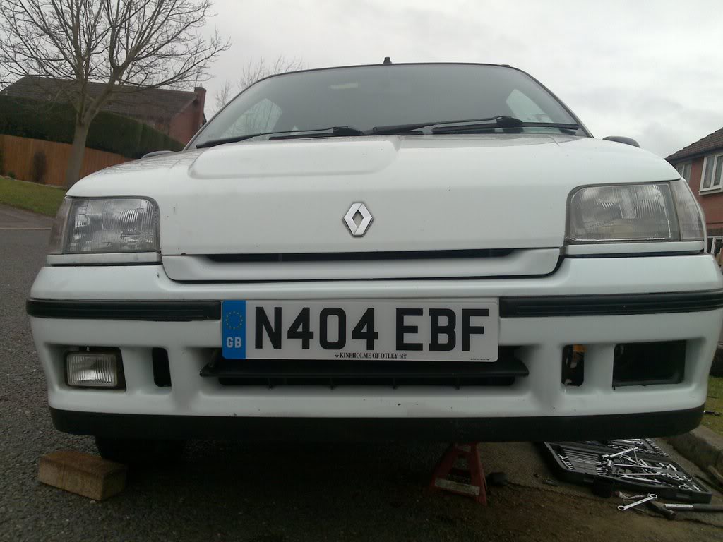

i woke up and orderd the circlip and washer from renault and as its not in stock i got to wait till tomorrow for it so set about sorting other bits on the car as theres lots to do.

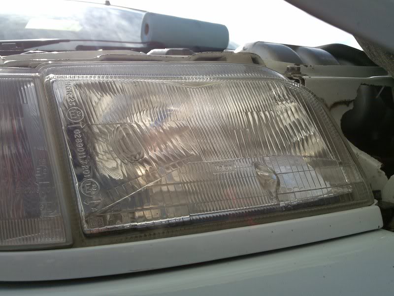

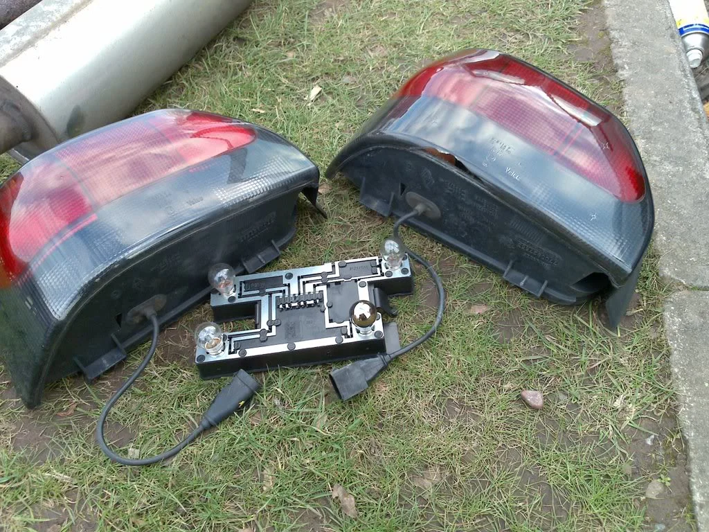

a few days before i got a couple headlights from scrappy they was brand new on a valver they was scrapping so i had them cheap was lucky as one of the lights on the new car had a crack and hole in it

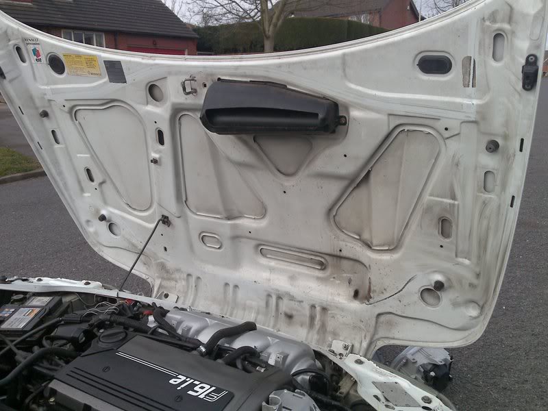

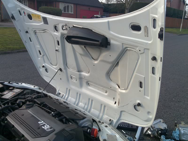

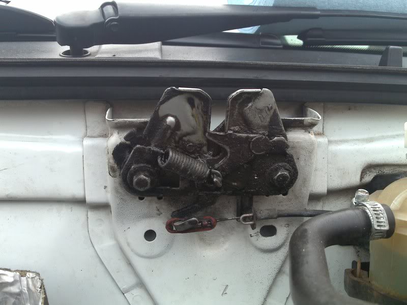

so got that swapped for a new one, next was to clean the bonnet was a right mess
abit cleaner not as good as id like but itll do for now, only used fairy liquid lol i also gave the bonnet catch a good clean and adjusted it as it wasnt inline

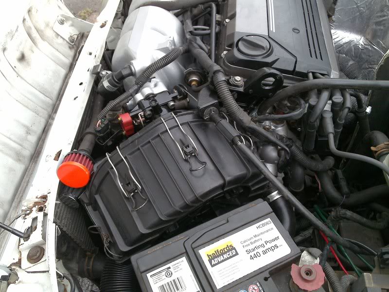

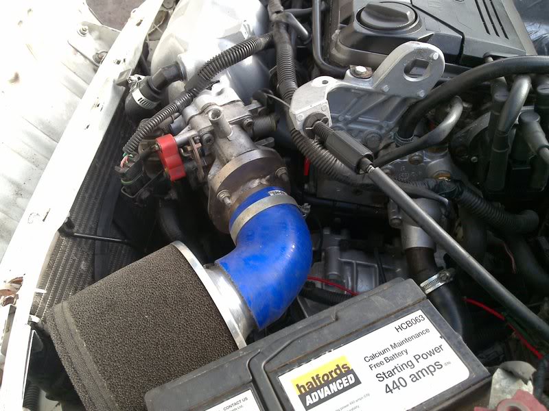

the car came with a opin itg filter samco bend and k tak throttle bodie adaptor and it didnt feel like it was doing any good so on went the air box and itg panel filter, i also swapped the throttle bodie over and engine huck thingy as i had already painted them black on the last hybrid.
before
after

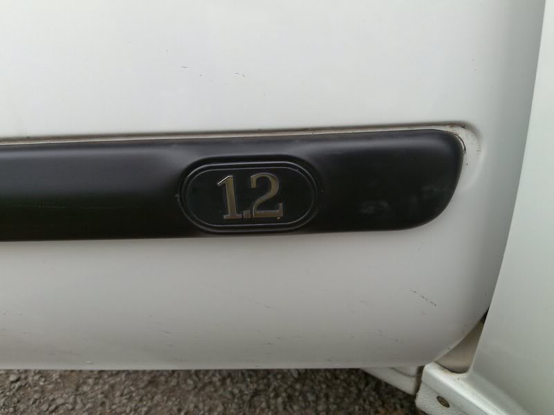

next up was the 1.2 badges a definate for any hybrid owner

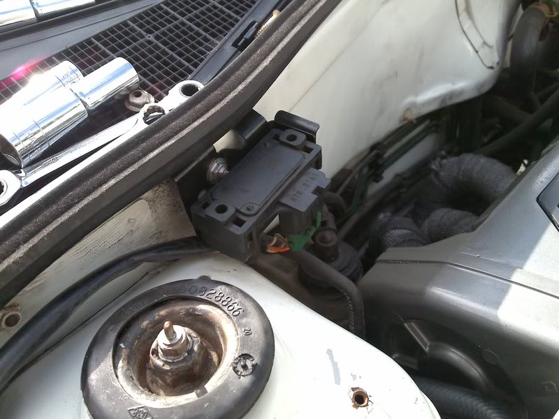

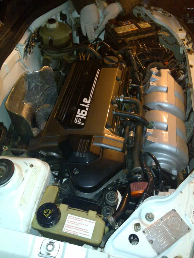

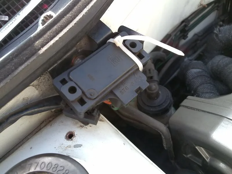

i then swapped over the bracket for my map sensor as it was zip tied on

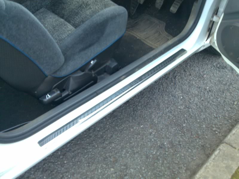

then it was onto the widow sealer surround thing, the one on the car was bubbleing so got the old one of the black hybrid as that was fine and swapped them over, also did the wing mirror covers as the white ones had a crack and scuff on them, not sure what to think of them really.
tomorrow ill be trying to take these off, really not a fan myself abit maxpower tbh
i also took the brackets that hold the radiator up and put them on as the radiator was zip tied up :S so thats on properly.
i also added 2 manifold bolts as they was missing lol

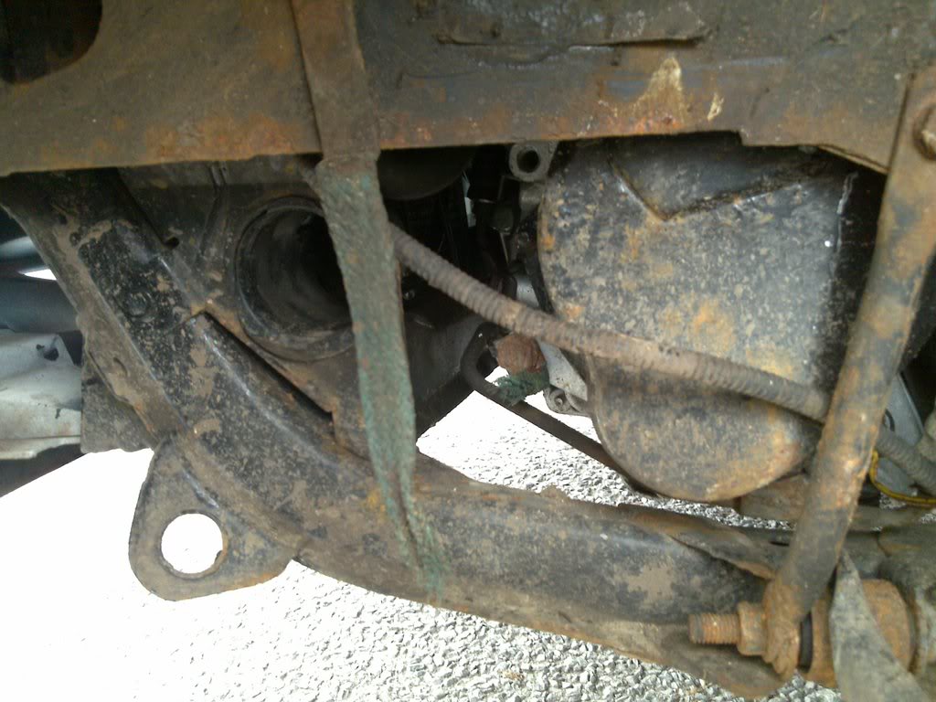

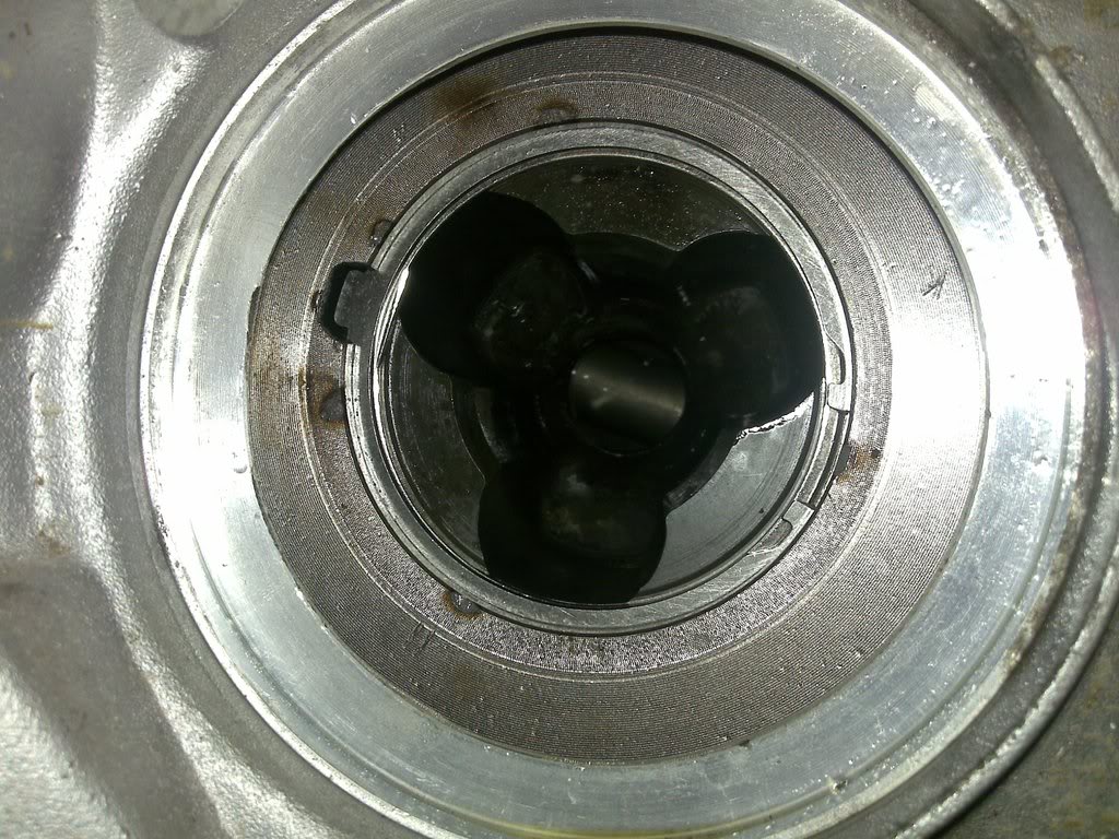

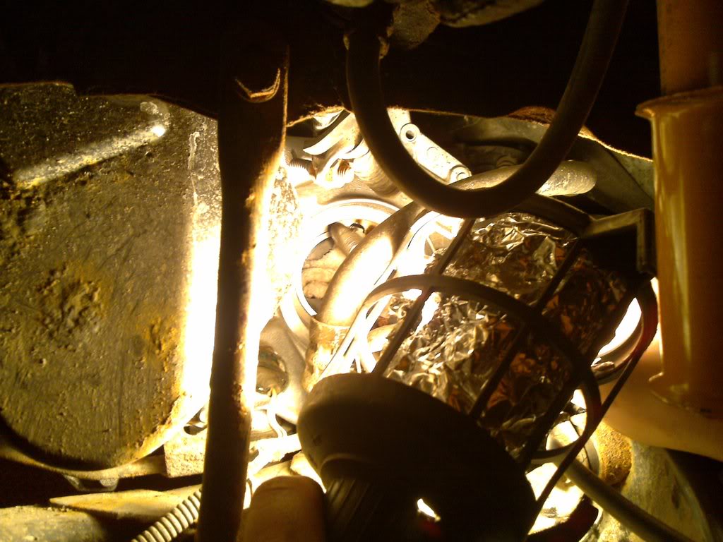

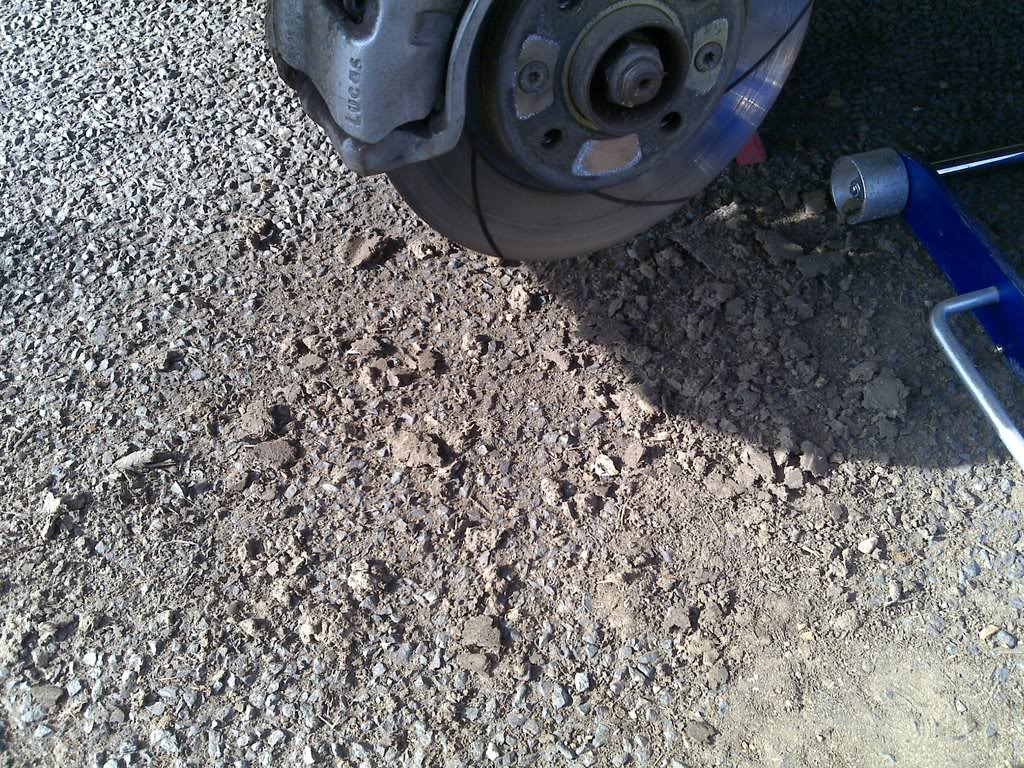

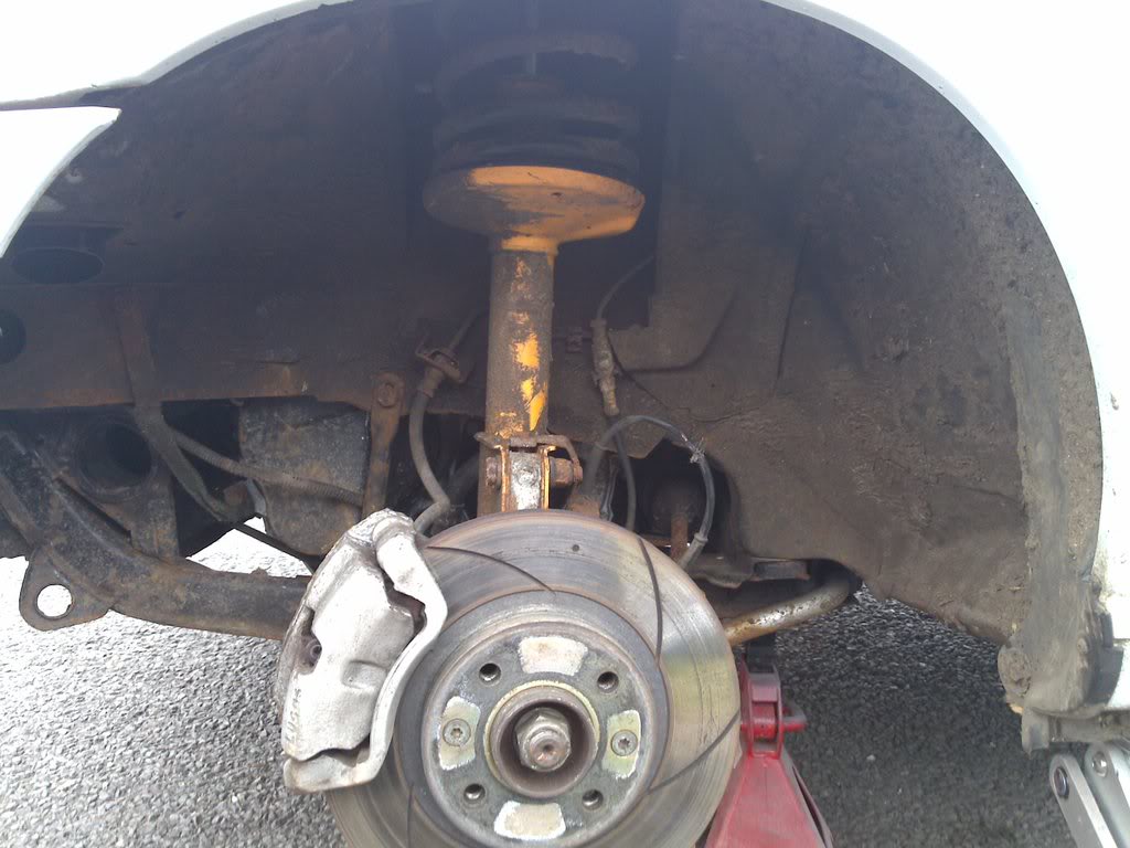

then it was onto getting the driveshaft out under the arches it was a right mess lumps of dirt everywhere so had to scrape it all off
really doesnt show the ammount that was there as i had brushed most away but it gives a idea lol

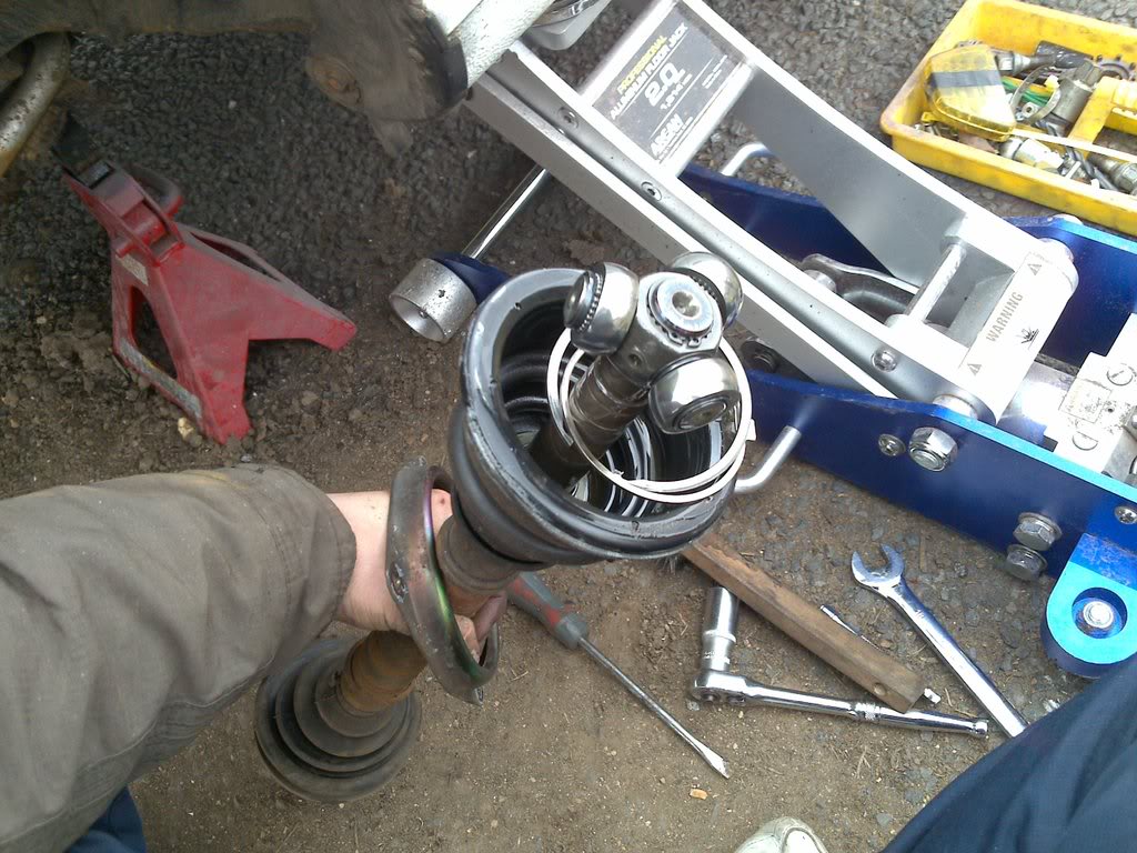

so anyway on with getting the driveshaft out was all straight forward thankfully heres how it came out..
circlip and washer still attatched lol
no washer or circlip
circlip and washer in

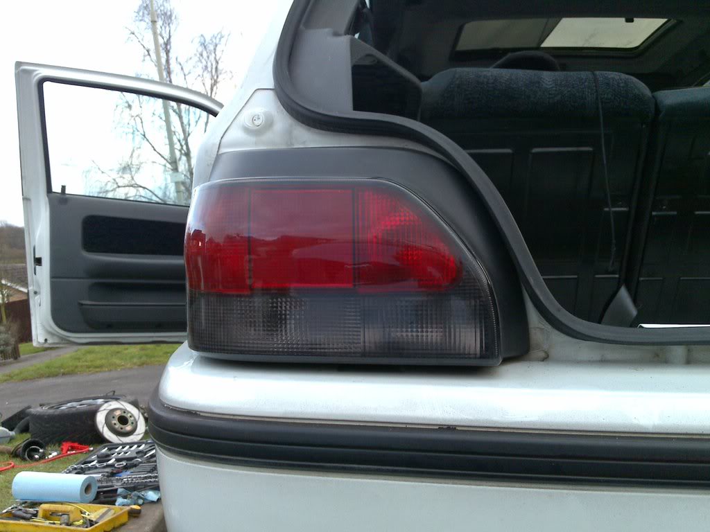

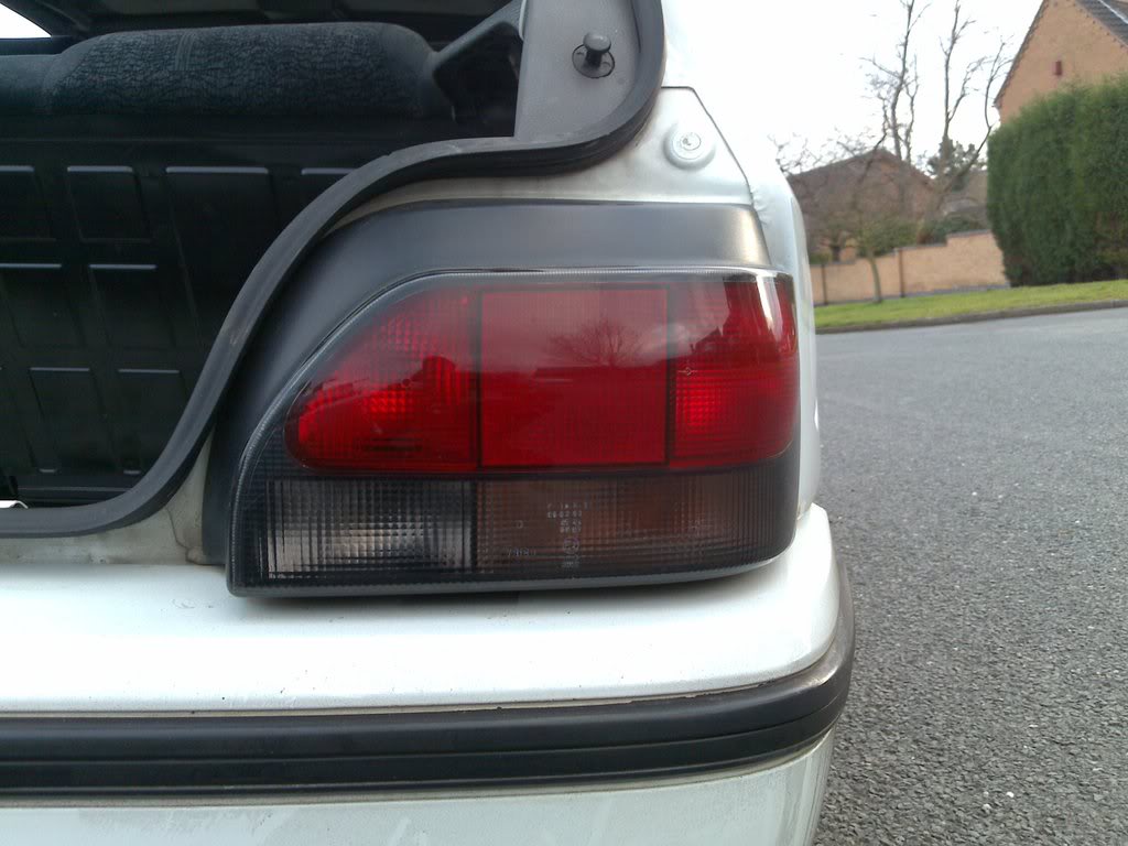

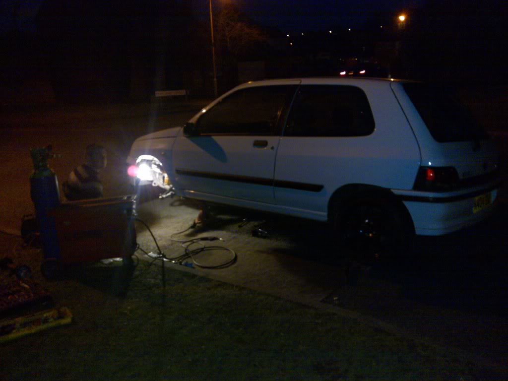

had to wait for my mate to finish work and bring his dads welder around so i got on with other bits i changed a rear light over as i found one had a crack at the bottom, also used the silvertec bulbs and got rid of the orange of the rear lights.
cracked light new light and the new silvertec bulb attatched.
pre silvertec bulb
after

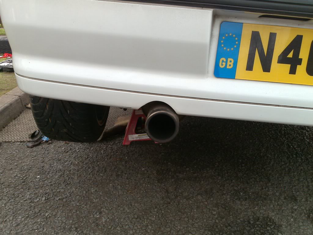

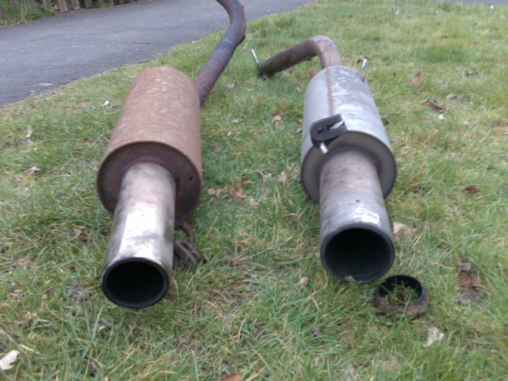

next thing i wanted to do was the exhaust, now i must stress with whiplash and a chest that kills when i get out of bed doing this wasnt easy lol i wanted my old one on as it was slightly bigger tailpipe and it sounded much nicer and was better condition.
one to come off obviously this was with it undone and on no hangers lol
left old right new

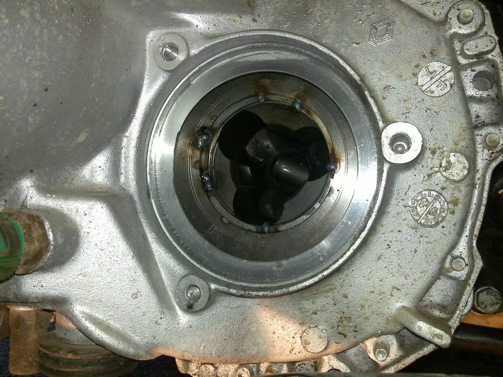

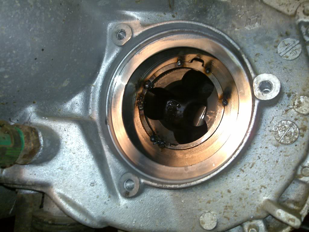

didnt get the exhaust on as my mate turned up so we got to work welding the circlip in i even had ago myself :D

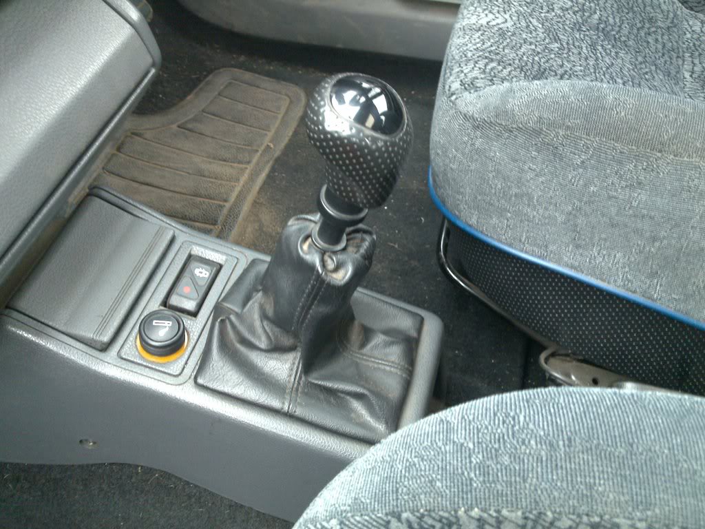

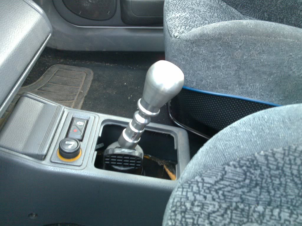

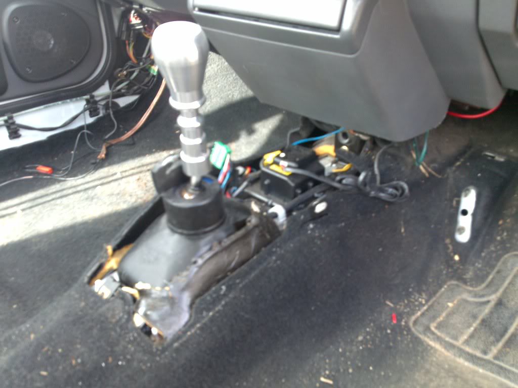

then i decided the ditch the immensly shite standard shifter in favour for my b&m, old...
b&m in and all adjusted up ready to roll
didnt bother putting suround in as interiors coming out.

ok so another update been quite a first week thats for sure lol so i thought i had sorted the gearbox out put it back together and still no drive, to say i was pissed off was a understatement i hadnt put the diff in enough so that the circlip filled its slot and after my recent problems with it i about hit boiling point lol.

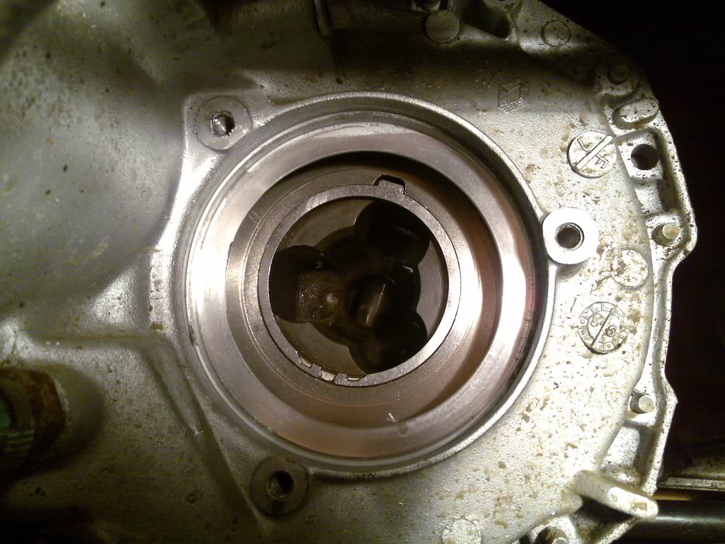

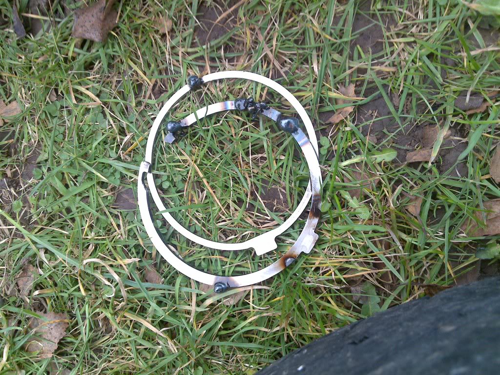

heres the dead circlip that effortlessly popped straight back off
what the box looked like
ah well on with fixing it did as i was told put the diff in and hammerd it back took some welly didnt think it would of took that much force as looking at it it looks a simple in out jobby with no complications but yeah took some force.
second circlip and washer ready to go on lucky i orderd one from renault and jamie got me one or i would of had another days wait.
circlip sitting in properly, you can see how much it was out from the other pics lol woopsy
welded in properly

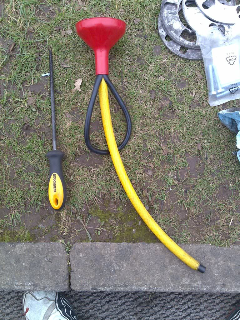

i got it back together but bout a massive tub of gearbox oil and had no way of getting it into the box so made my own device lol
now heres another kick in the teeth the hose wouldnt fit in the box so used a little bit of plastic on the end that fitted in nice and snug and was pressed into hose put it in to fill it up did a little bit of oil and went to pull it out to see how it was going.
as i pulled it out the little bit of plastic fell into the box OMG i was pissed off ive been so close to kicking this car hard and this was very close so picked hammer up and went and beat the s**t outa the black clios bonnet lol major temper issues lol.
so couldnt get it out and thats still in there, just pray it dont do no damage :S
also got on with the exhaust another job that pissed me off went on ok and adjusted fine just a compleate c**t that the joints aint sealed i got some paste but its blowing again arrrgggghh still need that sorted ill do it tomorrow.

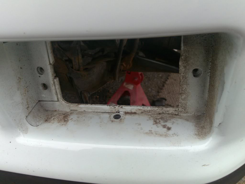

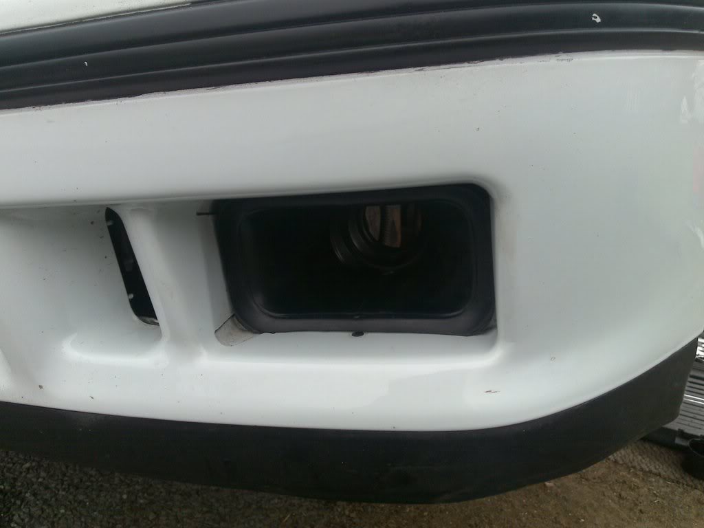

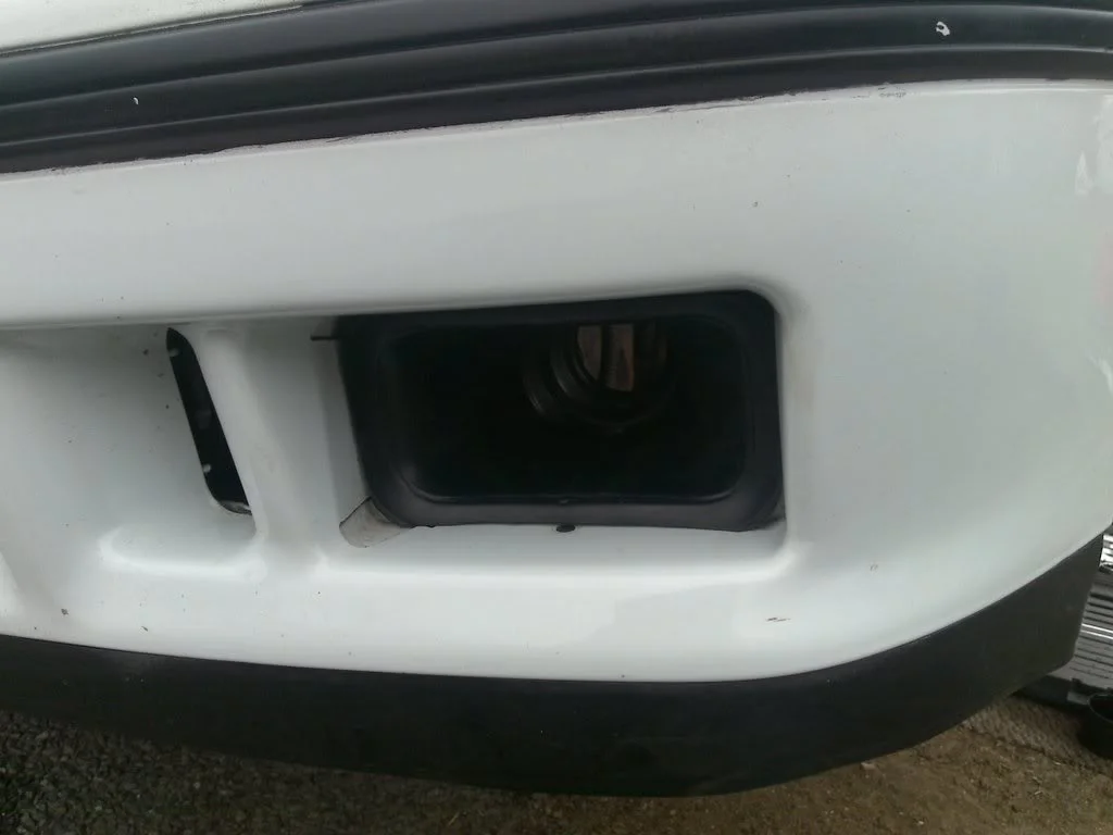

next up was the fog lights, i dont think them so replaced one of them with the air feeds i had from the last car. the fogs wasnt the standard ones.
a before and after
unfortunatly the last fogs needed a hole drilling for them to fit and here you can see it
but luckily its about coverd and with some silicone sealent i hope it will look like its not there, a job i need to do tomorrow if im up to it

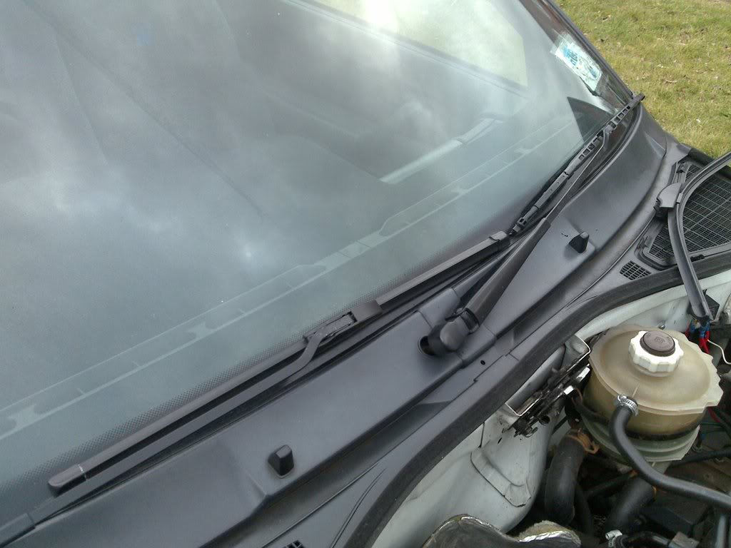

next up was the wiper blades nice and easy old shitters for the decent aero blades well worth the 8 quid from ebay

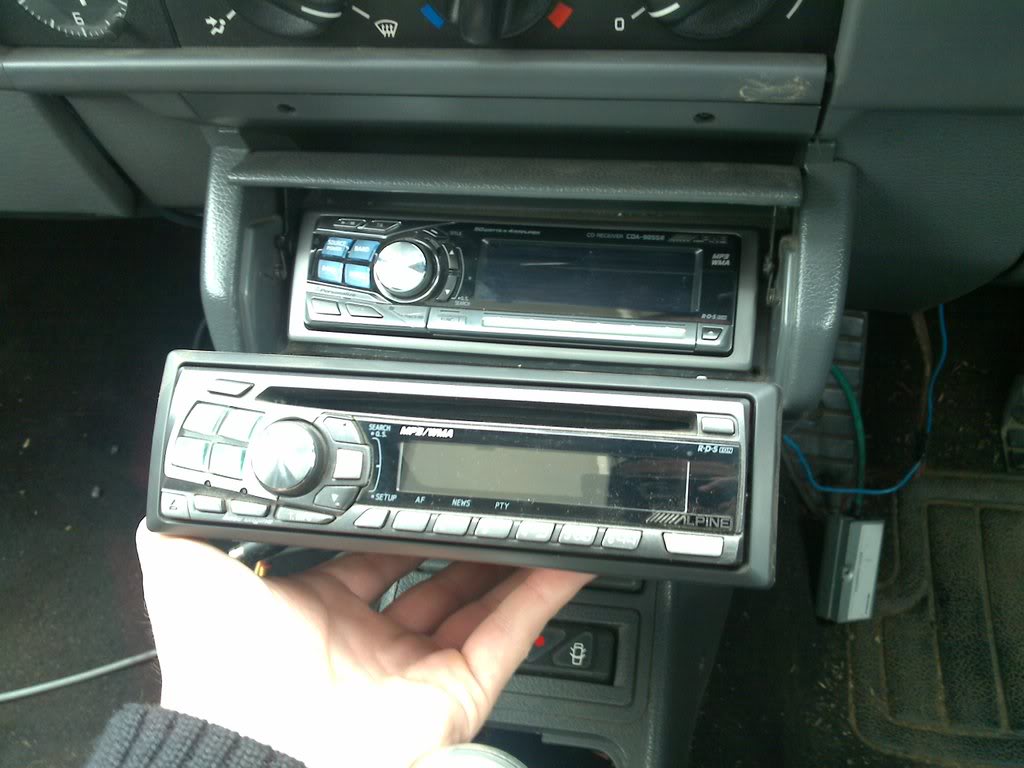

little update nothing major been on a right downer today so not been doing much as i aint been arsed.
out with the old in with the new, nice to be able to huck the ipod up so many wires to get rid off the cars got wires for subs 6by9s ect so getting excited for stripping it.

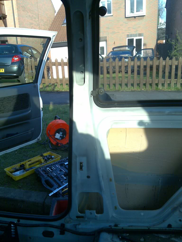

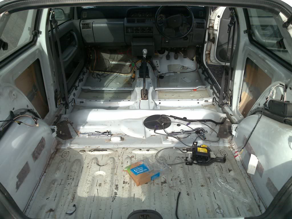

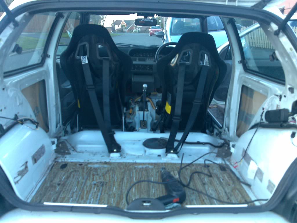

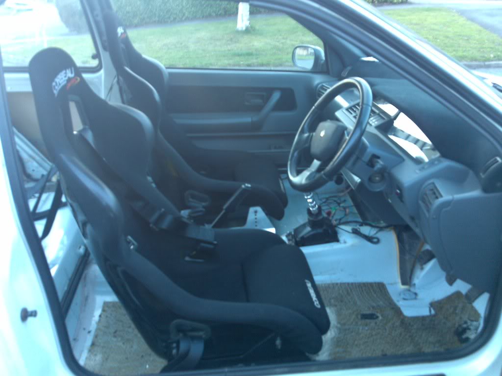

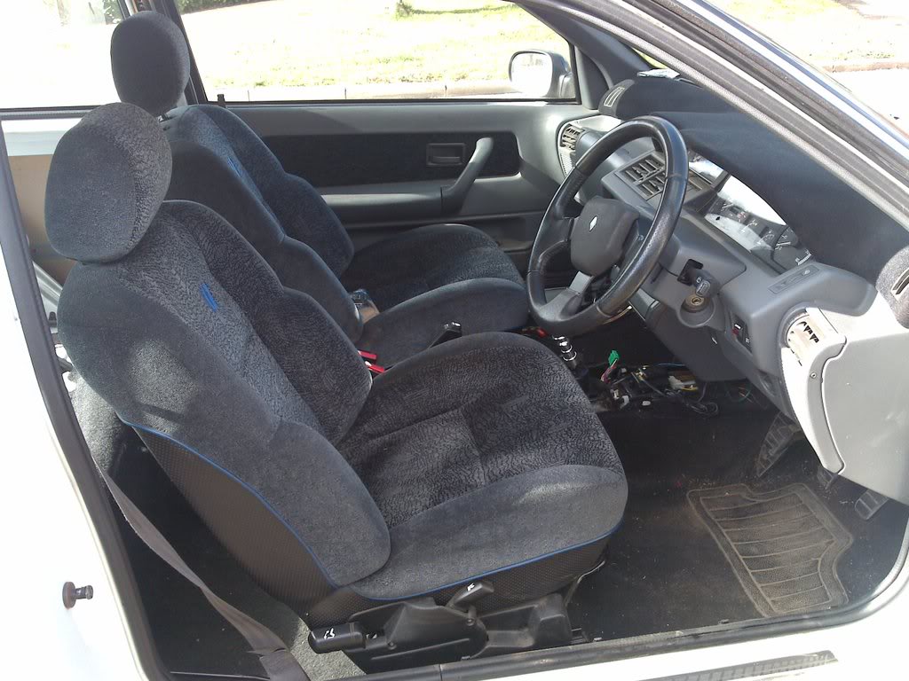

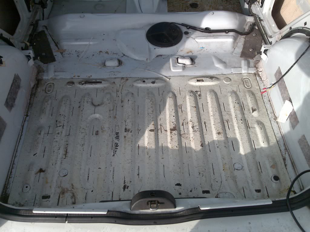

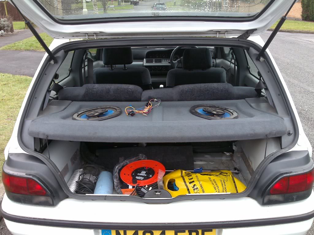

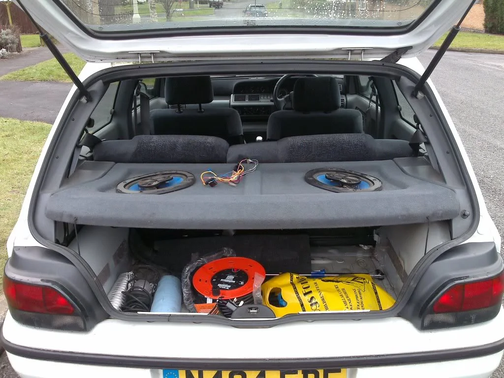

well with the car proving super reliable (3 days without breaking) i decided to crack on with the work i needed the carpet and door cards for the car going to the insurace so they cant see the weld marks from the cage lol.
if im honest i hated having a interior it sounded boring car handled poor and it was so obvious when driving it was there, so it needed going.
started late the other day so only maneged to get the rear bits out only took 30 mins to get it all out and into my other car (knowing every bolt FTW lol)
before
after

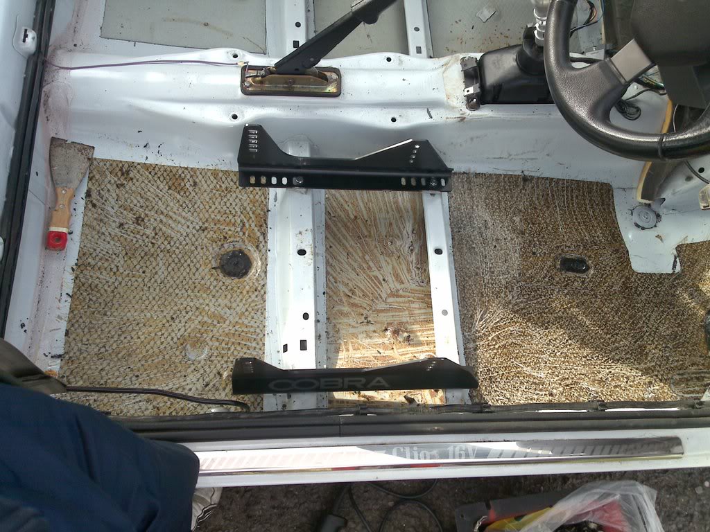

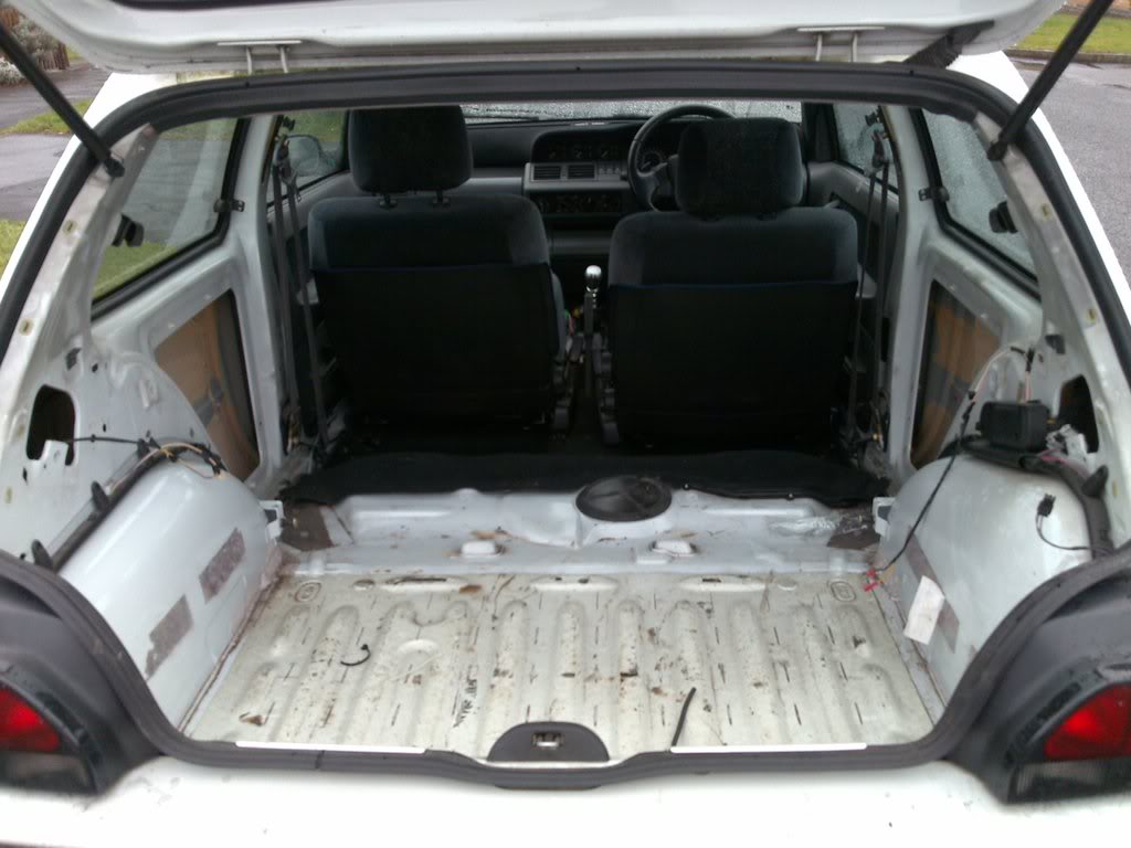

then the next day it was on with the front, i had a mate wanting the interior for his 1.2 daily he missed the williams interior from his last willy 2 so i gave it him for 30 as he had gave me a nfew bits he had left over.
seats and carpets out left with the tar, bleh

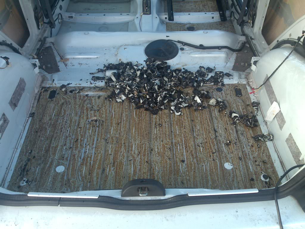

first off i got the seat mounts sorted then cracked on with getting the tar out, boring work this is.
before
after, theres quite alot of weight to this so get it out if your stripping the interior

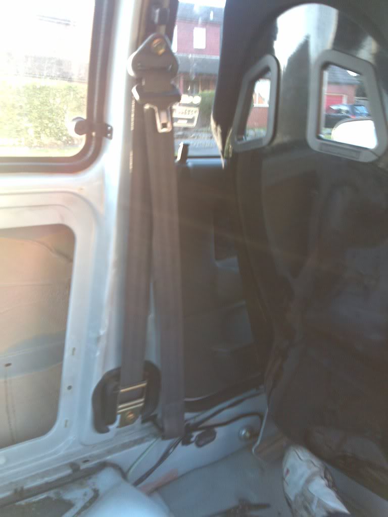

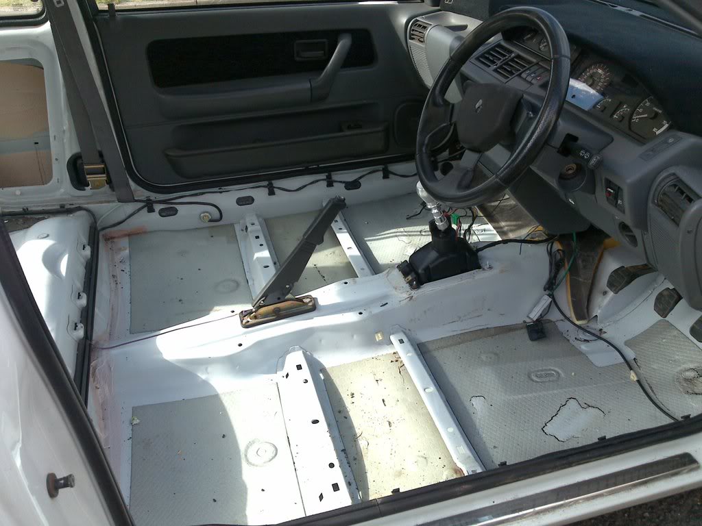

then got the belts out
gone
seats in
harnesses in.
thats how it was left yesterday, back on with tar removal today and mainly sort the black one out so its ready for insurance to take it away :(
