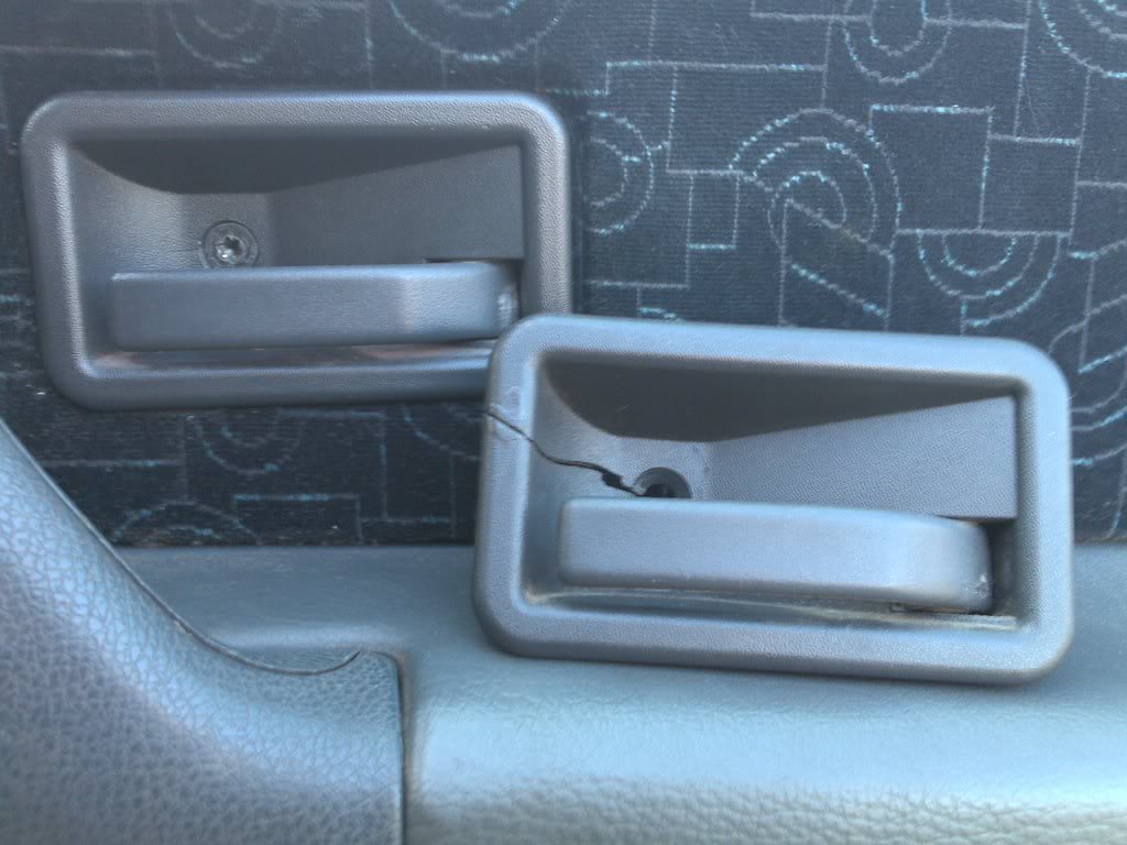

started off by swapping the door handles over the white one had 2 cracked handles.

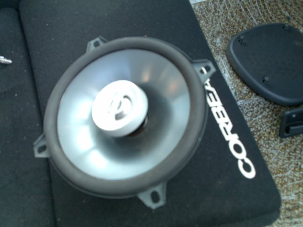

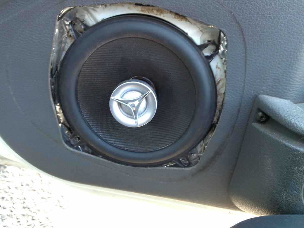

then swapped speakers over as the infinitys arnt as good as my jbls
old..
new

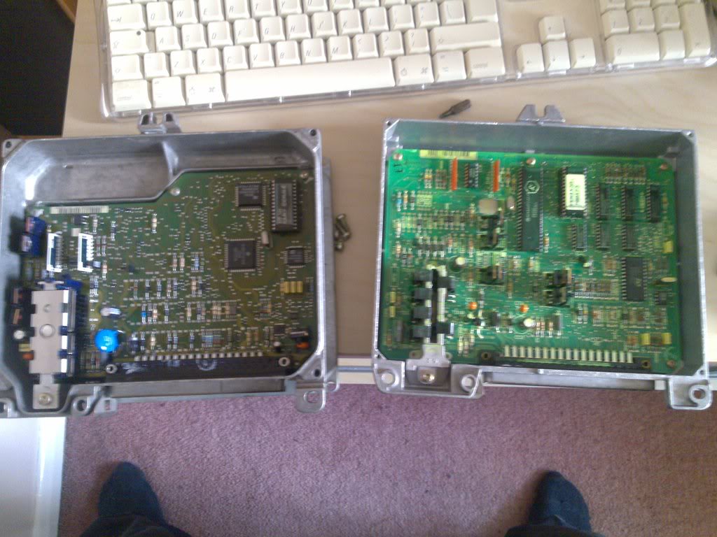

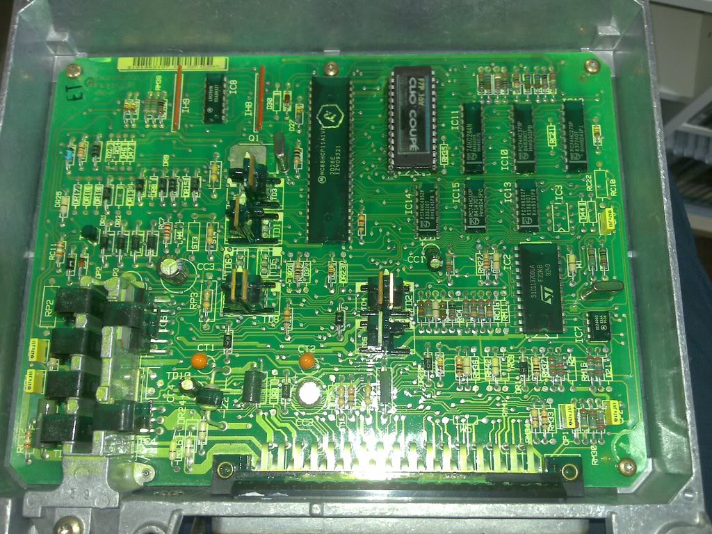

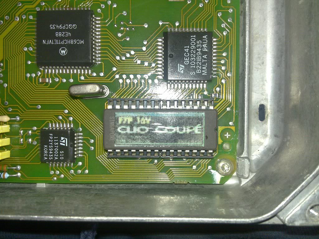

then i tried to swap over the ecus to see if i could get rid of the immobiliser, i was going to swap the ecus from each car and just change the chips over, i found both ecus where different
also found that neither should have a immobiliser :S
also found the chip on my car says clio coupe f7p but its a 2.0 and not a coupe :S
put the chip in the one out the old hybrid to see if that would stop the immobiliser as that didnt have one
chip in, i bosh it on and the car wont start :S
now i have no idea about what ecu does what and what chip goes where all i know is it didnt work lol anyone have any clues?

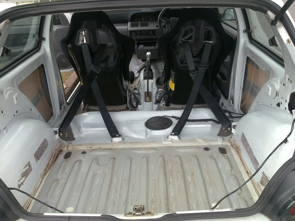

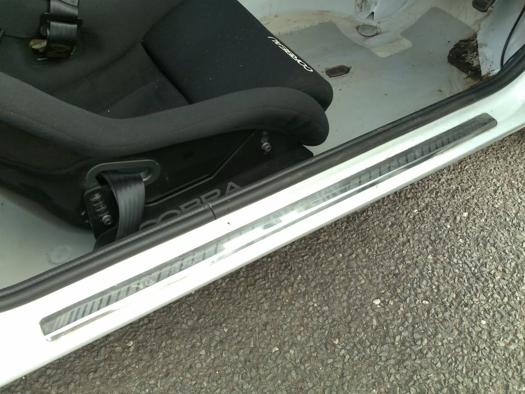

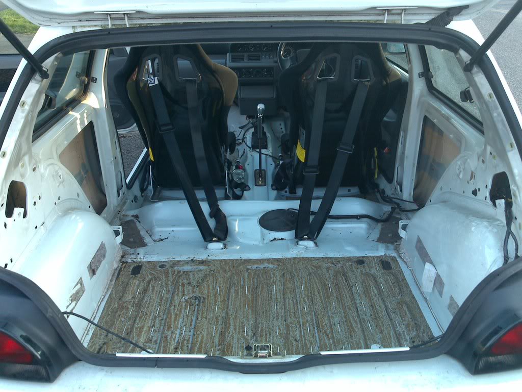

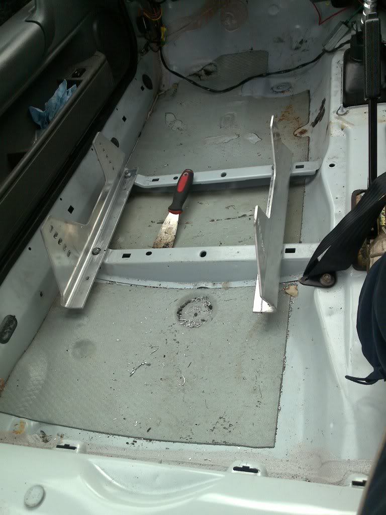

its only my opinion mate but i wouldnt have mounted those seats like that,them strips youve bolted to are quite weak and could rip through
Did you use a heat gun and chisel to remove tar?
indeed best method that and a scraper with like a inch tip is best any bigger and its gets abit hard to get it up.
worked in the last car with a 50mph head on smash :P but yeah im getting proper mounts done soon enough when the cage goes in ect.

I woulda used a chip holder when soldering in the chip. It's not the chip that has the immobiliser, it's somewhere else in the ECU isnt it?
Is your immobiliser light on the dash flashing during cranking?
yeah it flashs i know it wasnt the chip that had it the chip was used cus the engine has cams and the chip in my old one wasnt for cams so switched them over. and theyre all using a chip holder no chips are actually soldered in.

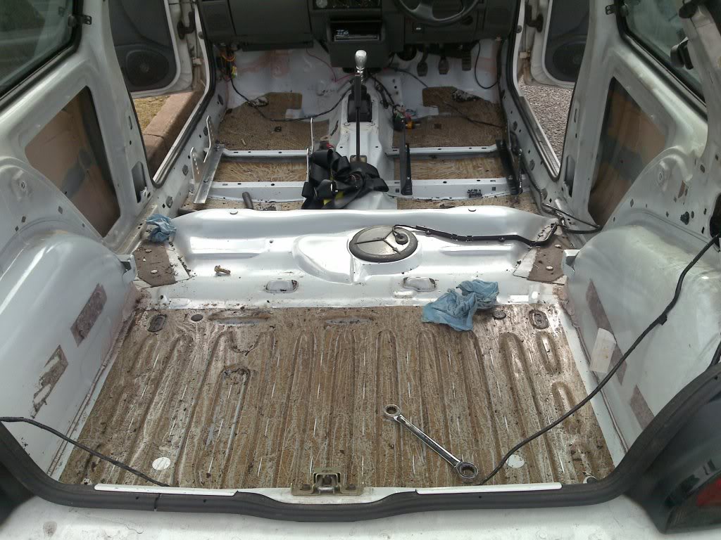

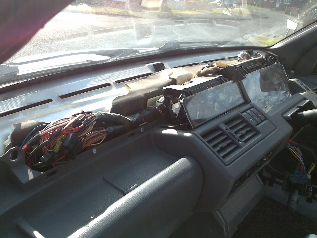

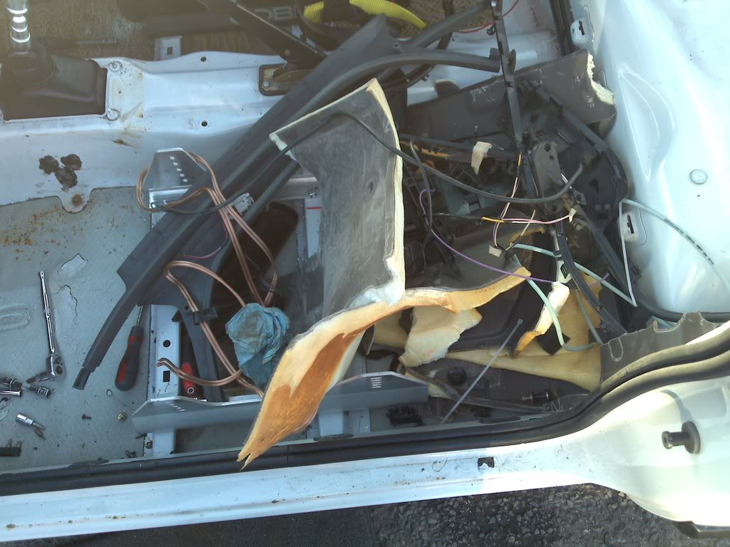

started with all this shite behind the dash so on with that
takin the dash off took a while compared to my last car could have all that off in 10 mins lol. all the crap behind the dashtop.
got it all out didnt get many pics cus phone battery was dieing and didnt want to be on it when it was dark so got a move on.

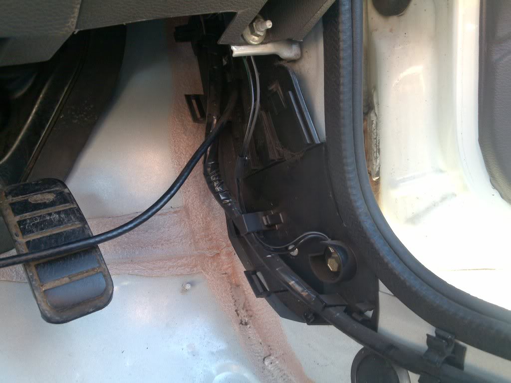

with the carpets and plastics gone it leaves wires on show so i got rid of them.
got loads of it out took all the clips off that go from front to back of the car re routed the abs wires so wires only go up ones side of the car. also took all the plastic bits that guide the rear part of the loom up the car and routed it up in the body shell and it pops out the rear seatbelt hole and across the back of the car.
how today finished
still plenty more cleaning and crap to be getting rid of.

yeah cheers they aint staying like it i have a cage to go in and ill be mounting them on that this is just temp till that goes in.
you mean to have them crossed over? they have to be mounted higher like shoulder level for them to be mounted right.
Sorry - it was a bit difficult for me to understand your text. I mean that you have to cross over the belts - have a look at the picture above. Your are right, the belts don't have to be crossed over higher like the shoulder level. I hope you understand what I mean, it's also diffcult for me to explain those technical things in English.
ah i get you, ive always thought they had to be mounted higher so you dont get crushed into the seat?
its ok with the english i get the jist :)

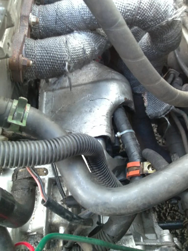

anyway luckily i had one on the black one but blimy what a task it was getting the old one off with the engine being up against the bulkhead. ah well better to save myself 120 quid and get this one off, at first i wasnt sure if they would be a straight swap as as you can see in the pic below its a megane bottom end 714 and my last one was a 700 williams bottom end.

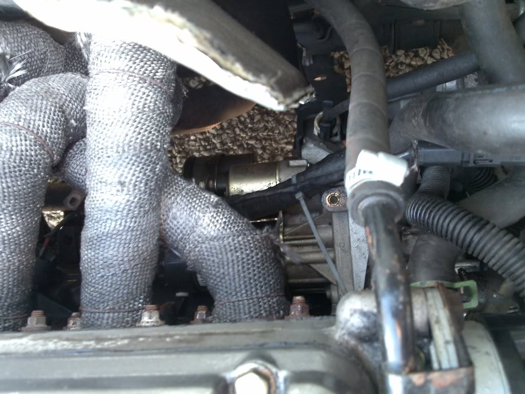

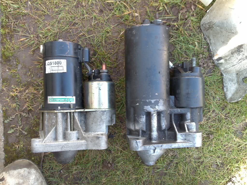

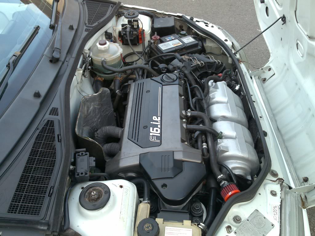

turns out its the best one to have :D also the startermotor was different on both cars but ah well ill try my luck.
you can see the size difference in them both obviously the one on the white one was replaced with a cheaper one at somepoint.
before
after (with heatshield i saved off the black one)

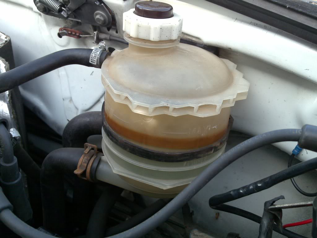

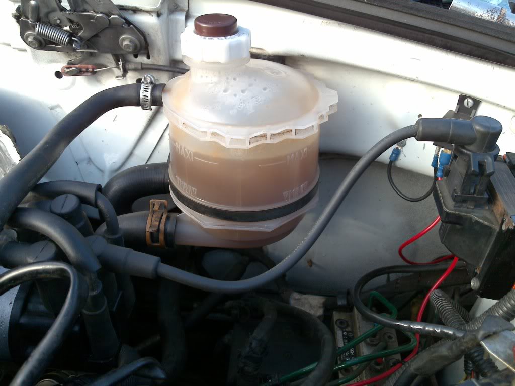

as i was doing all this i thought id replace the header tank as the one off the black one was only a few months old and the one on the white one looked a little worse for wear.
that pics with some rad weld in the system, hopefully thatll cure the leak i have from the front end.

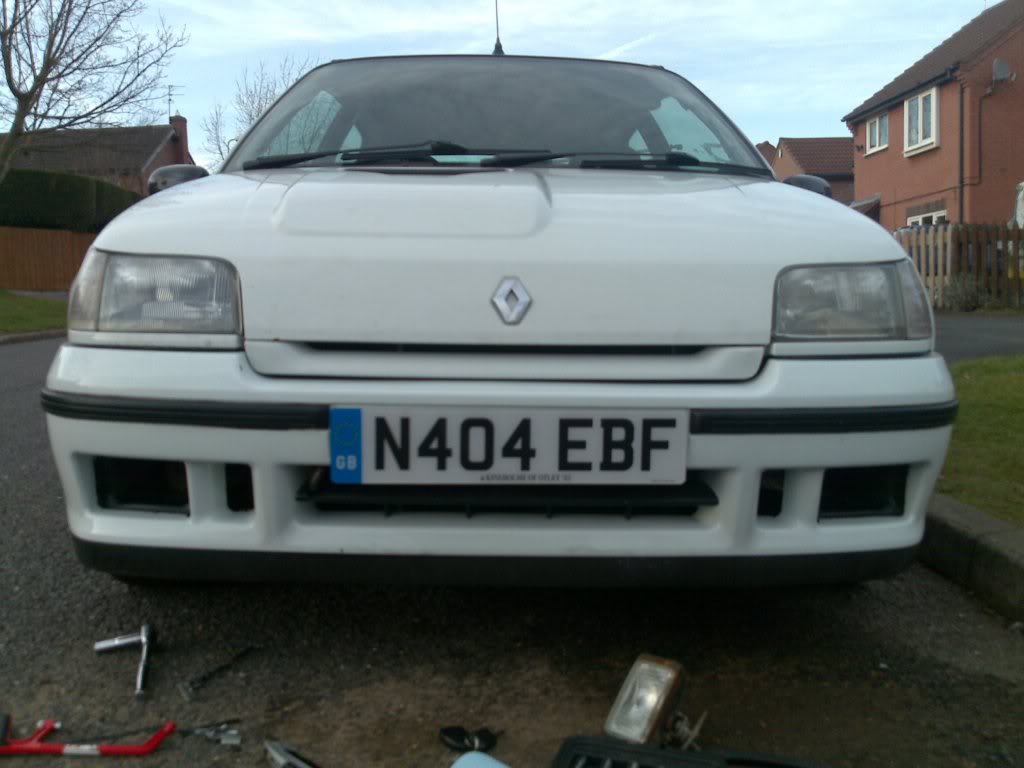

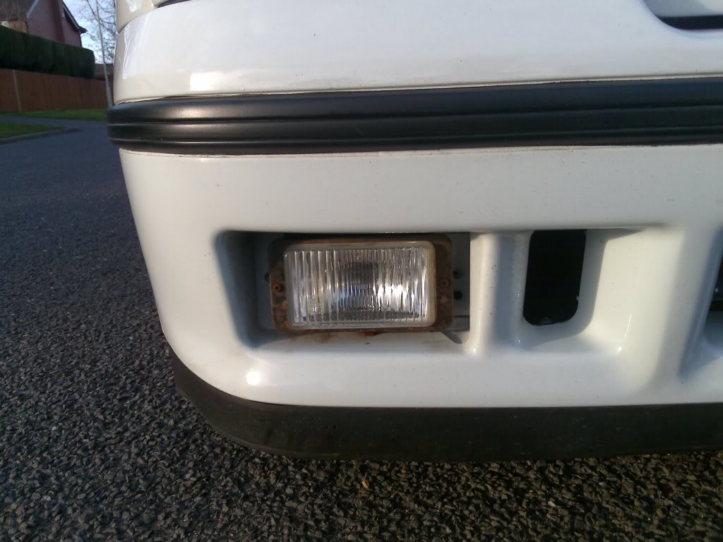

as it was getting dark and that was done i thought id do the little job of removing the fog light from the other side and stick the demontweeks fog light feed that somehow survived the crash on the last car lol.
before
after, a s**t pic but gives you a idea, alot better that shitty foglights imo.

today i started by flushing the shitty rad weld out, seems its done its job tho no leaks lol.

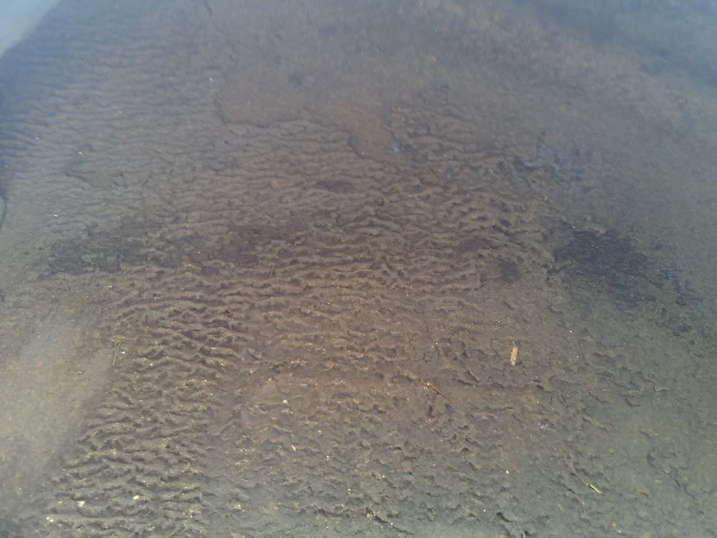

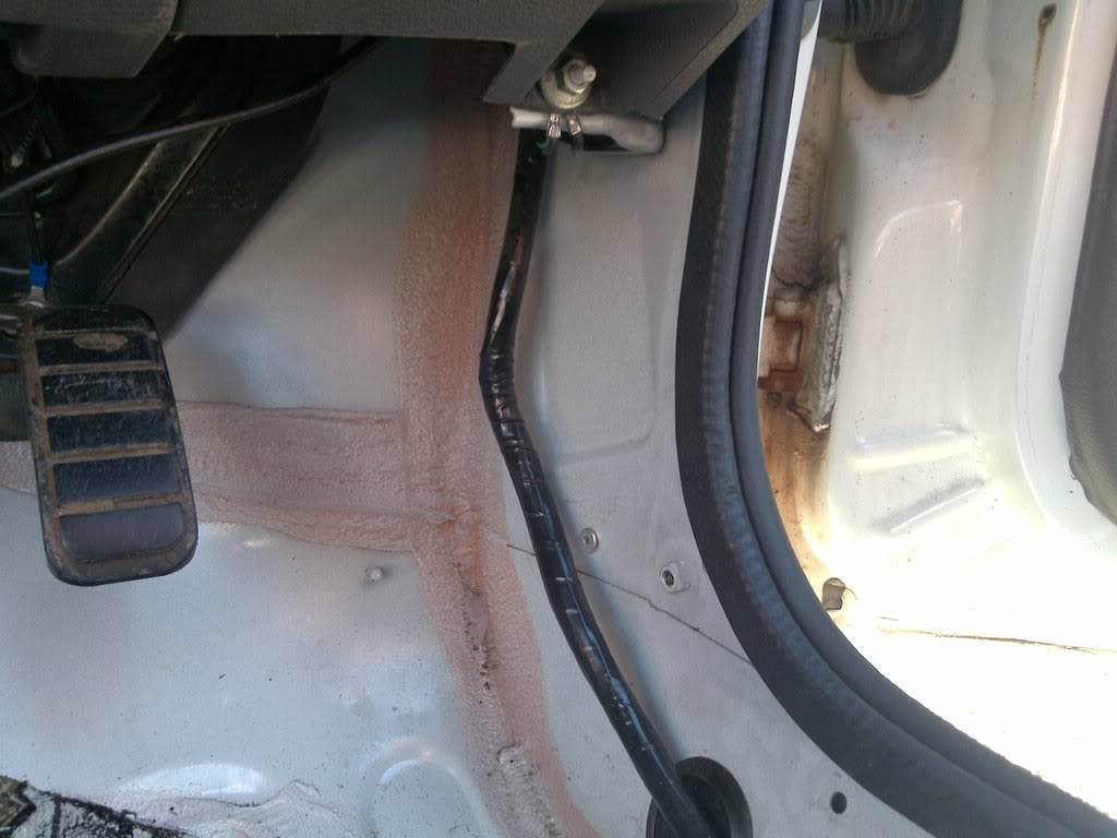

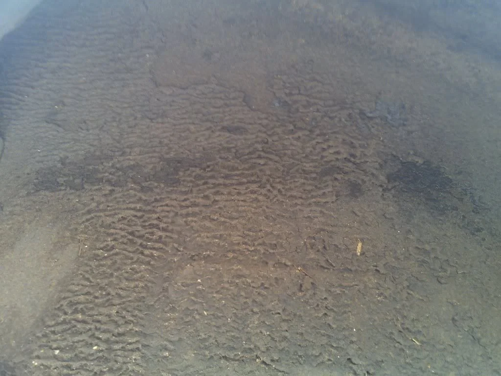

then it was onto the last of the tar inside only had these bits to do.
didnt take long to whip that up, then it was onto cleaning what was left up
bit of a grim job and dirty but armed with my auto glym intense tar removal i cleaned most of it up and was just left with it needing a hoover.

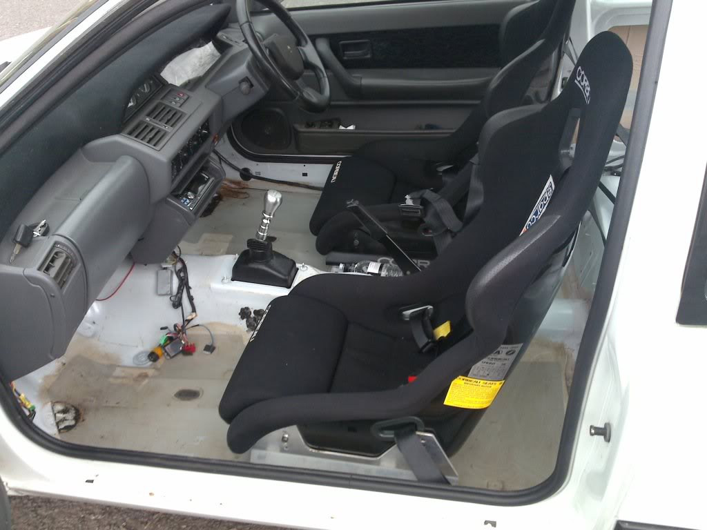

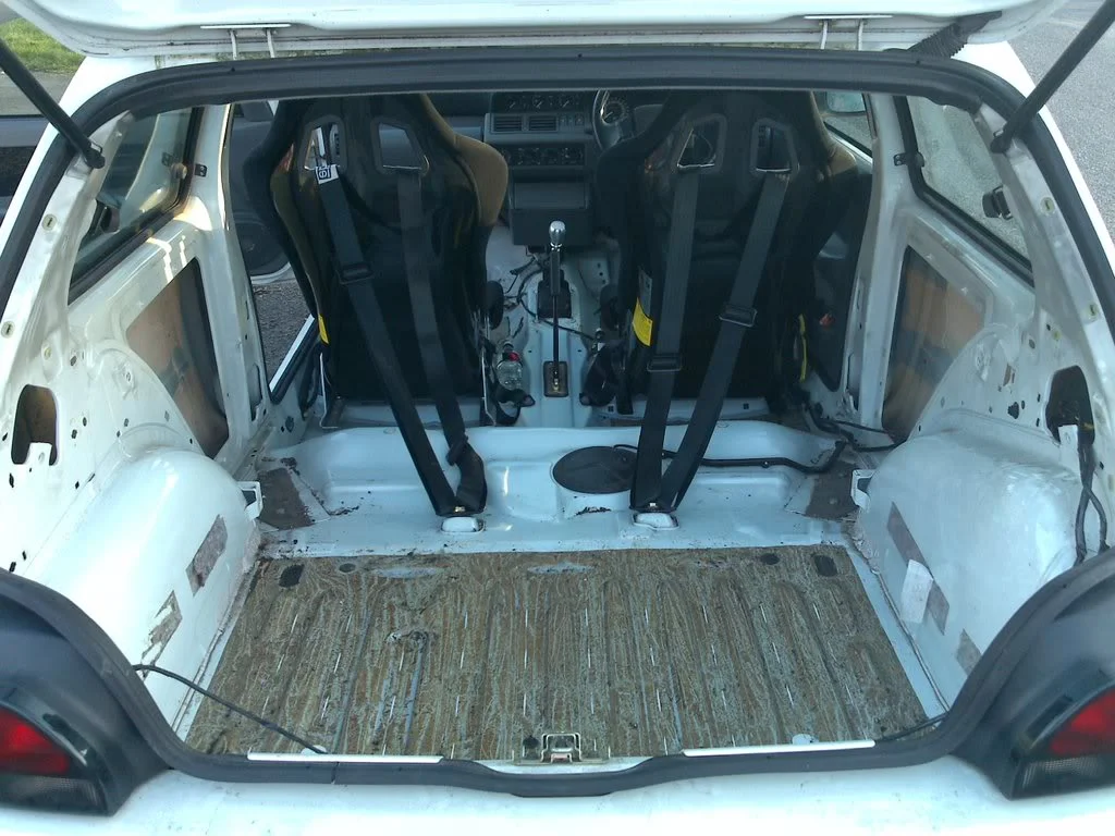

i put the seats back in and did the harnesses how i had been advised to, so ill see how that works out till i get the cage in.
didnt leave it to clean but im not going to be to anal about it just yet as more works needed before it needs to be clean for painting.
was left with quite abit of tar, does way abit like a heavy bag of shopping :P

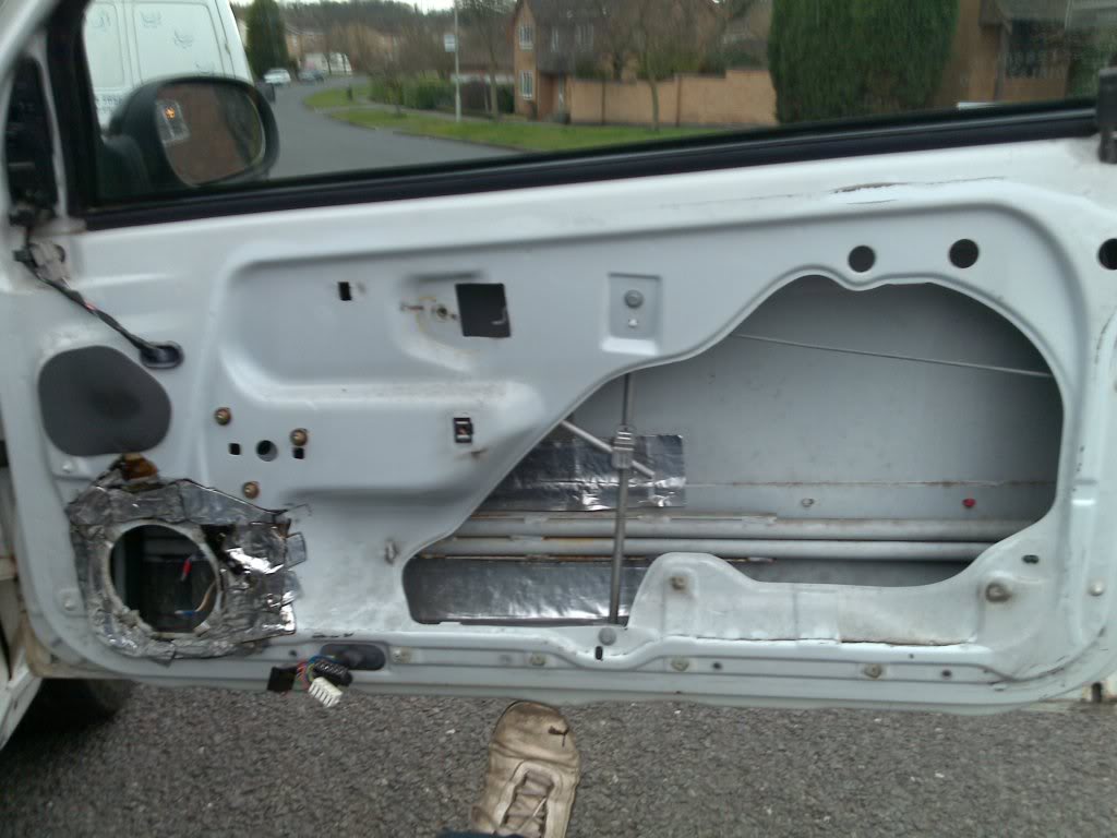

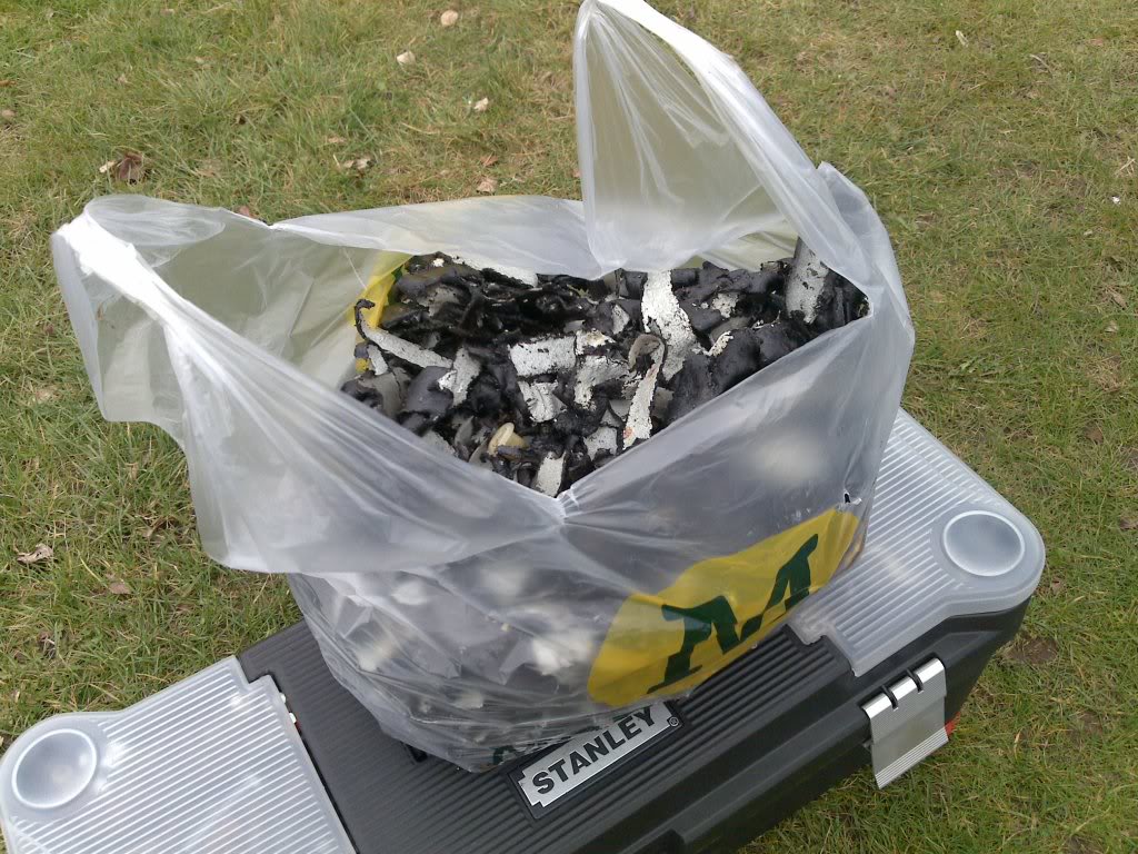

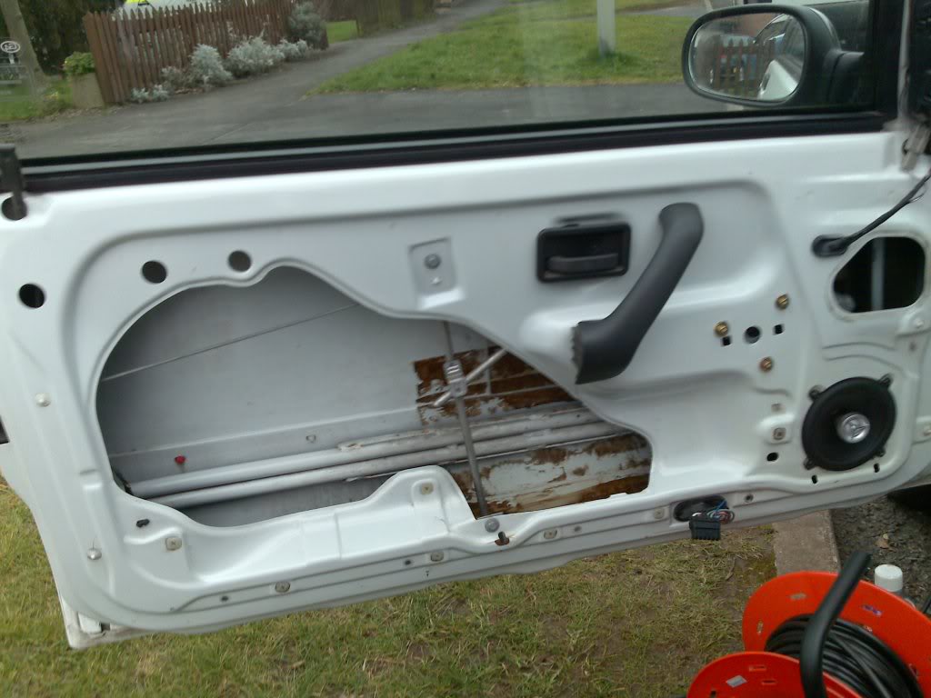

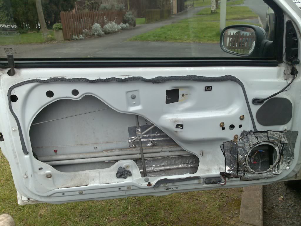

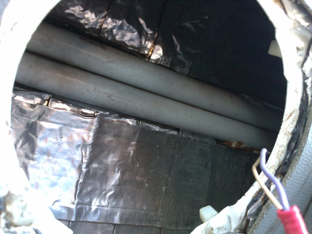

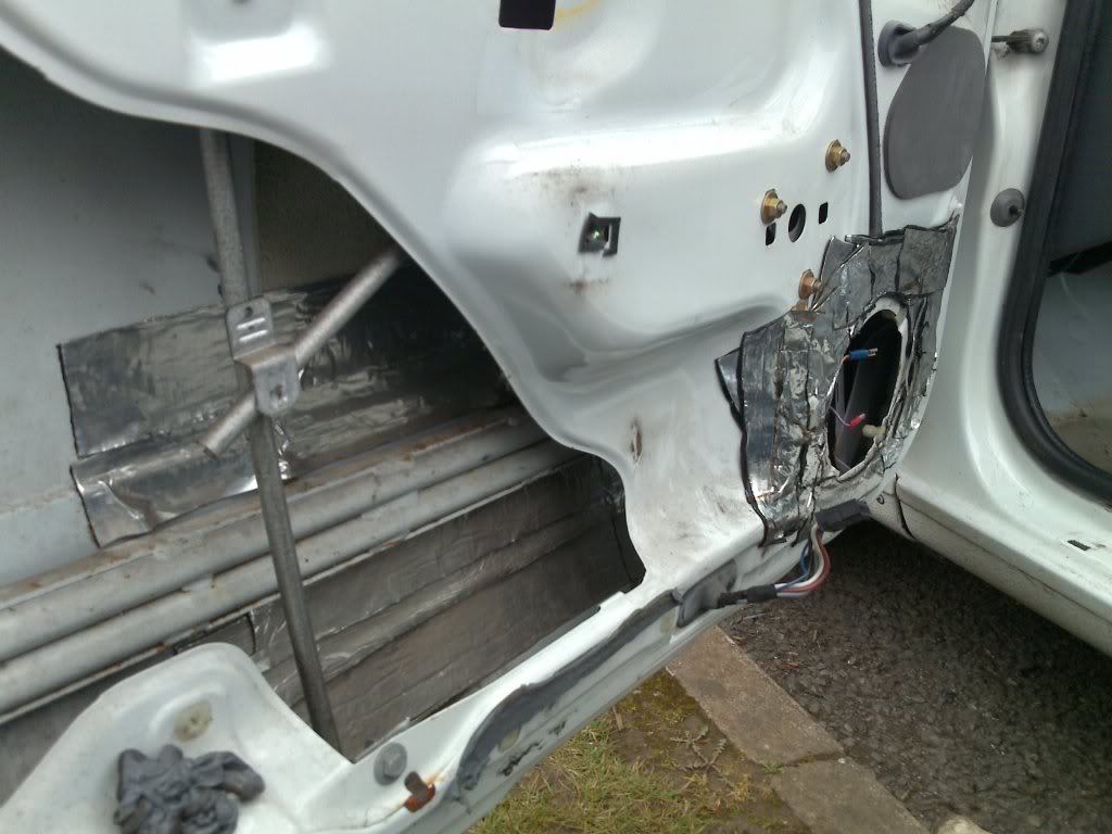

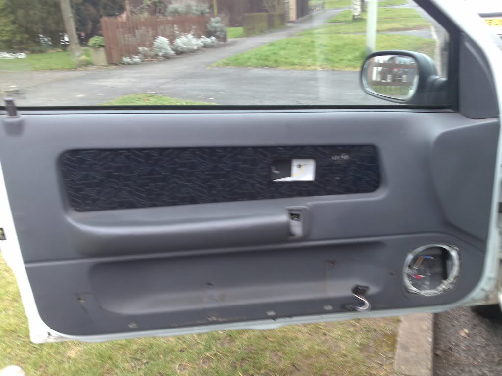

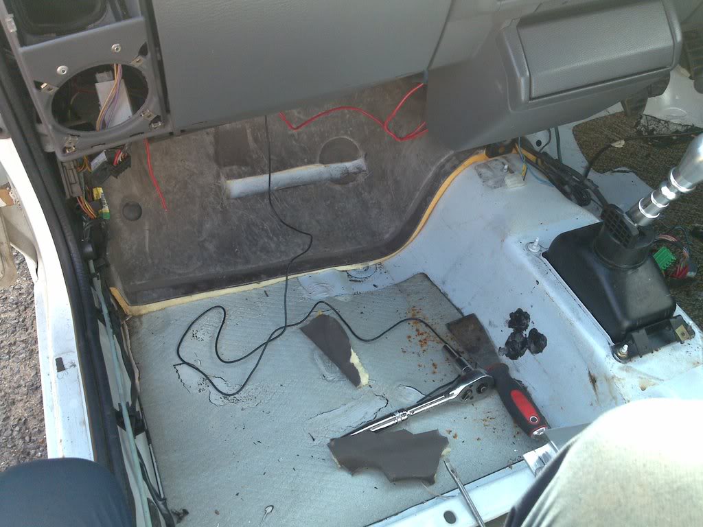

then it was onto the doors as i had some of that dyno mat s**t in there i thought id crack on with them and after getting them off i thought feck it ill leave them off as when the cage goes in there wont be any room for them because of the door bars.
bish
bash
bosh
other side
didnt get all the shite out was getting darker so got a move on and put it back together so i could tackle it another day.

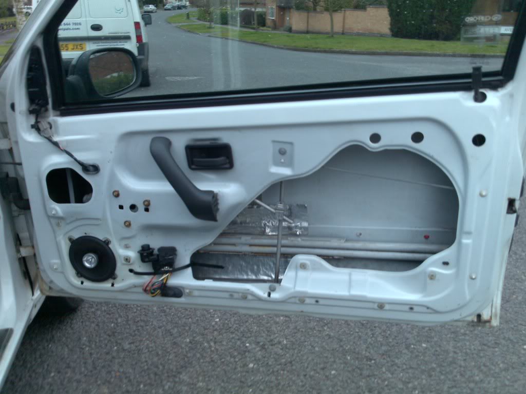

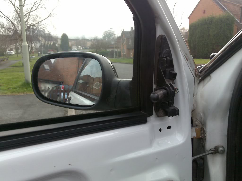

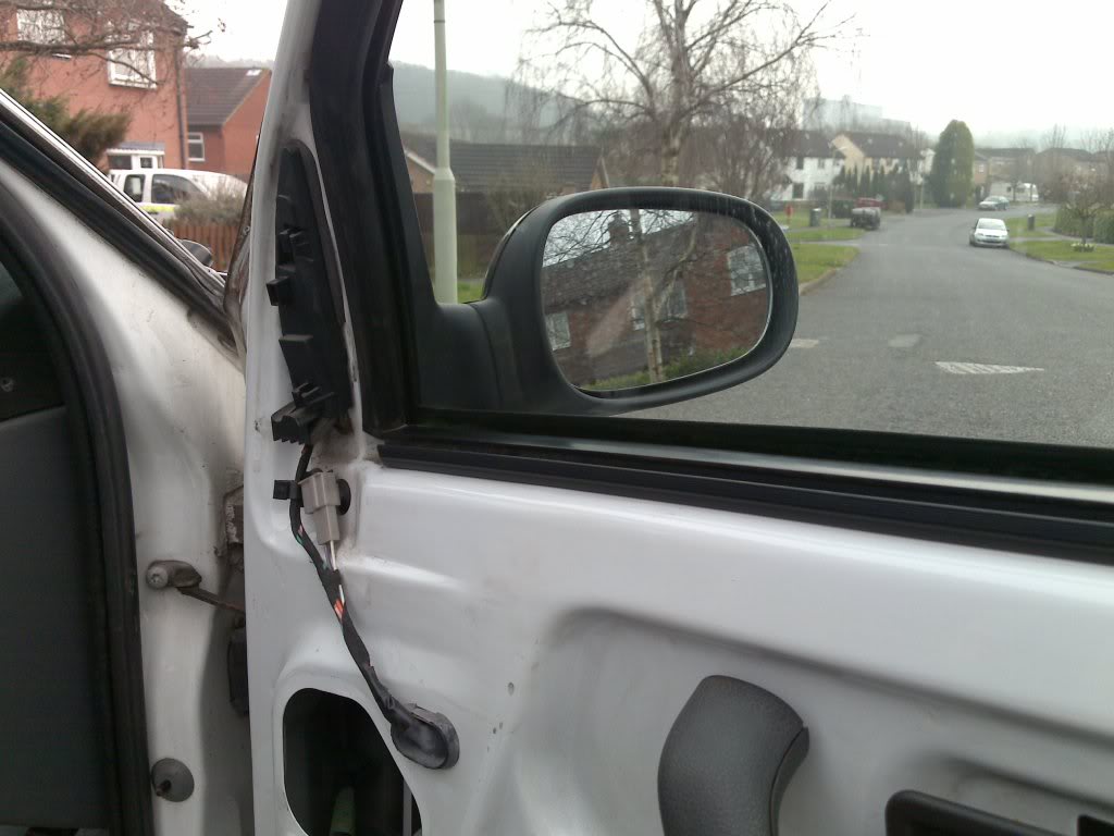

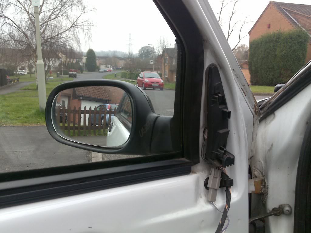

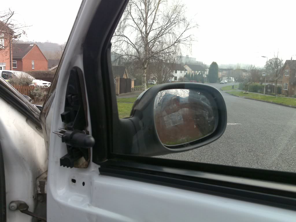

went to the scrap yard yesterday got some manual mirrors so i could get rid of some of the wores on show and as i was making door cards up in the future it would of been a pain to keep the leccy ones. and hopefully its saved some weight and it looks neater.
before
after
other side before
after
should of got some pics of more of the door so you could see how much neater it is without the wires.

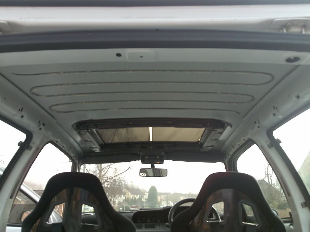

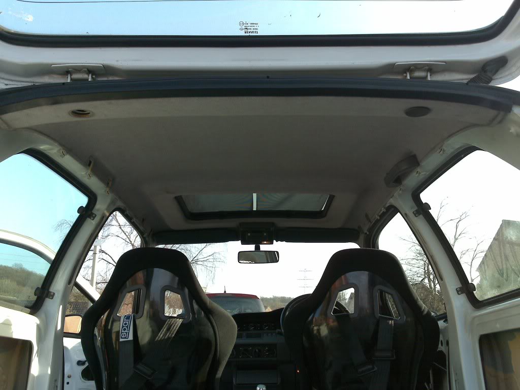

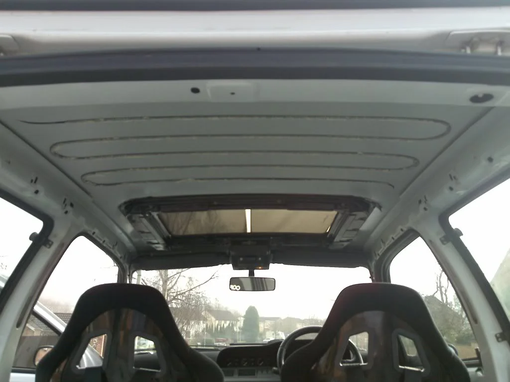

then got onto the roof lining as that was about the last of the interior that needed coming out
before
after
wanna get rid of the sunroof but i dont wanna have to rivet a plate on as it looks s**t so got to come up with a neater better looking way thinking a carbon fiber sheet like i was going to do on the last one.

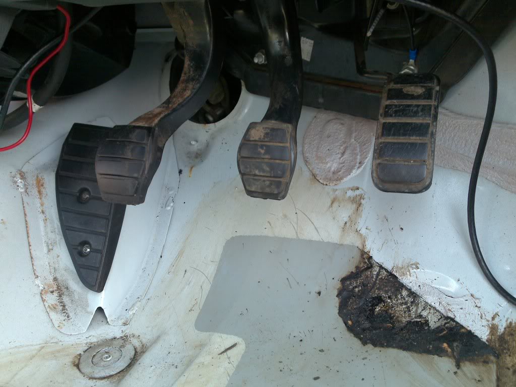

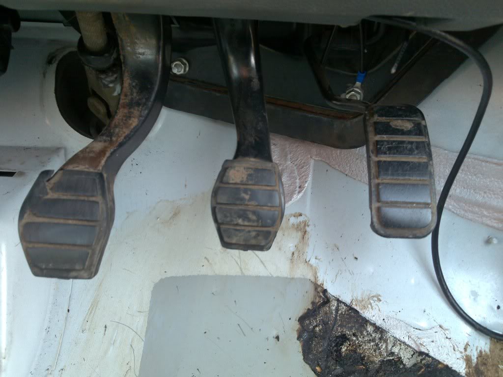

then looking over the car thought id change the pedal rubber as it was looking tatty and the ones on the black hybrid where nice and new looking
before
after also stuck the foot rest in

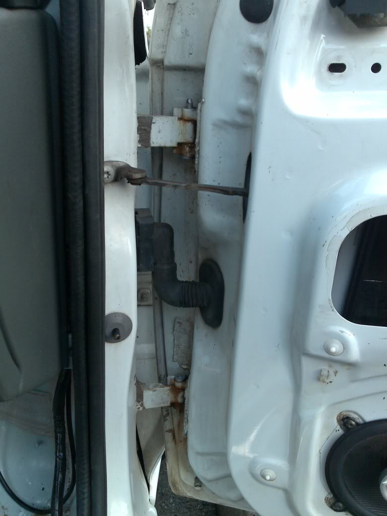

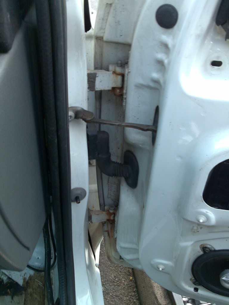

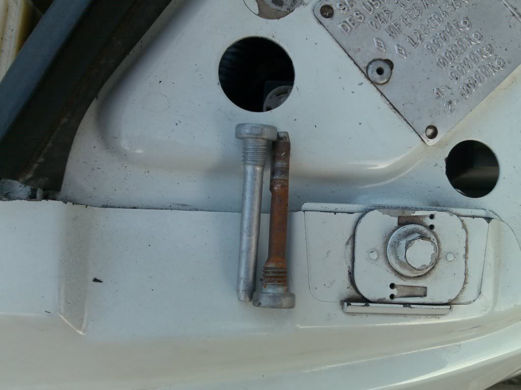

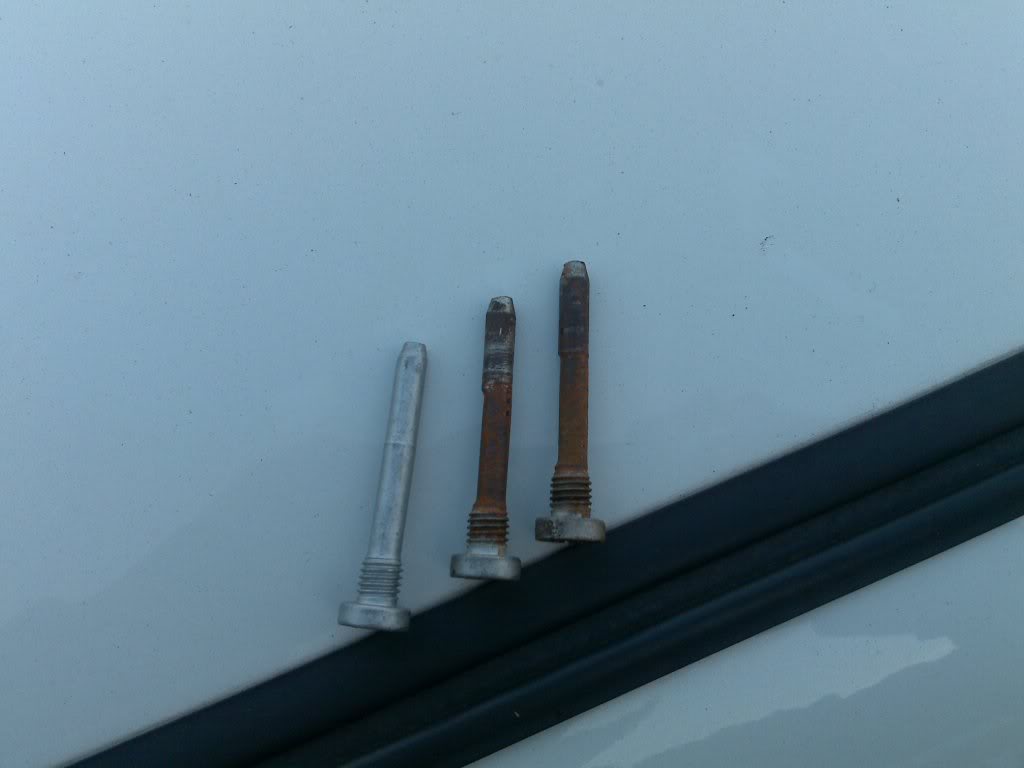

a quick one from the other day, my drivers door had fucked pins and was a right pain in the arse pretty much had to lift the door to shut it proper shuting it from sitting in the car you had to slam it and more often than not id be driving down the road with the door half open lol.
so after reading peoples problems ect ive been putting it off for a full day just incase it took a while any drilling was needed ect but it turned out to be piss easy me and a mate did it and when i was doing the strut brace and trying to find a damn bolt i dropped that holded the coilpack on my mate had done the drivers door, wtf i was expecting it to take a while haha.
before
after
not that you can any difference haha
heres the pins from drivers door alot of wear on them things.
can see more wear on this pic

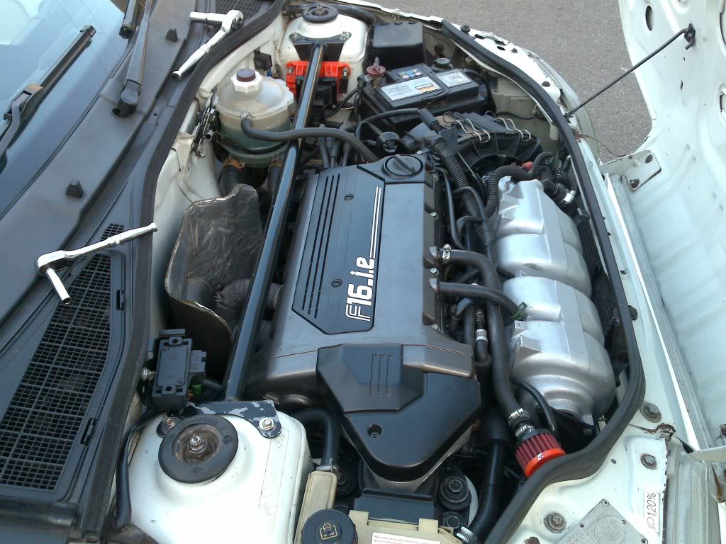

also thought as i had the strut brace and holes pre drilled id stick it on

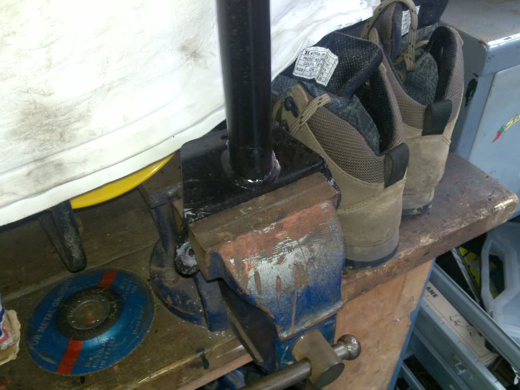

as it was on the last car witch sufferd some bending the brace had bent a little but some vice action soon sorted that
before
in the vice in a few positions
after

need to swap the hose that goes to the top of the header tank from the black one to this as its alot smaller and quite tight on the strut brace, it dont really matter just would be nice to have more give.

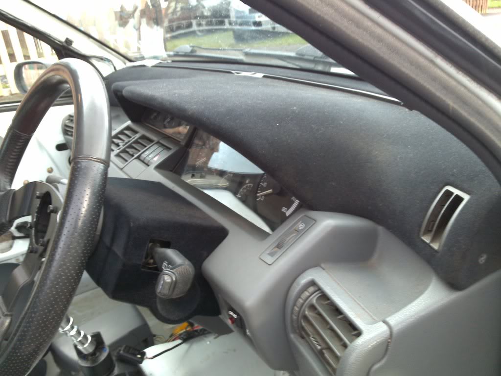

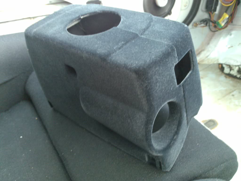

update for today, had my colon flocked today by a old mate thats just bought a flocking machine. thought as the dash top was done it would be rude not to lol

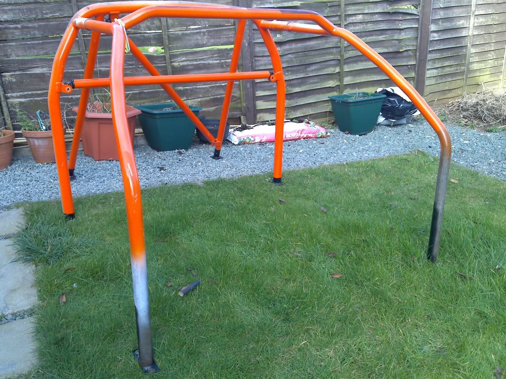

got the cage out to do some measuring for poweder coating. looks fecking shite looks like the job i did painting it in car was terrible but when it was in it looked awsome haha
going to get door bars welded in the harness bar lowerd as it was to high last time. then take it for powder coating. going for the simple black and white theme.

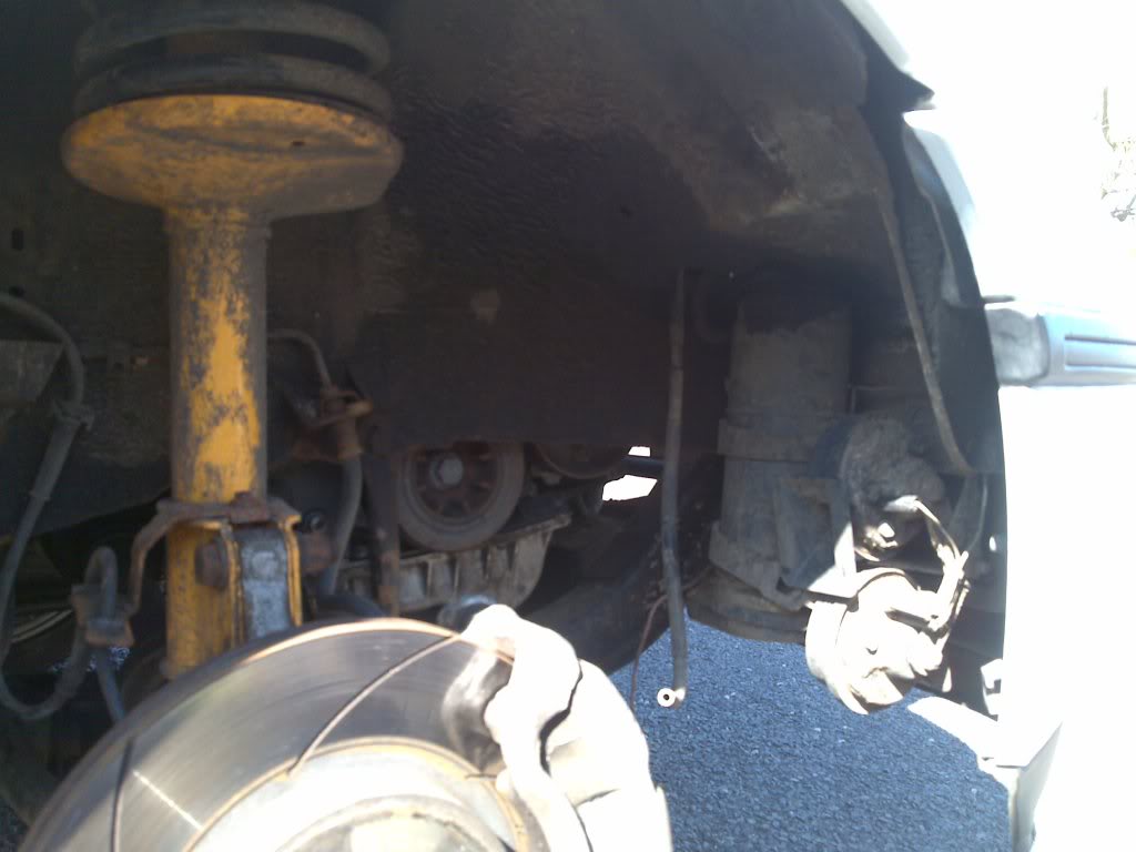

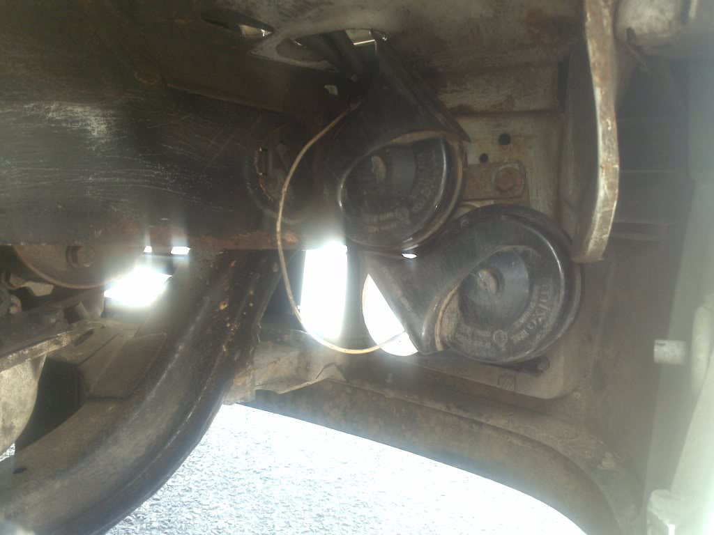

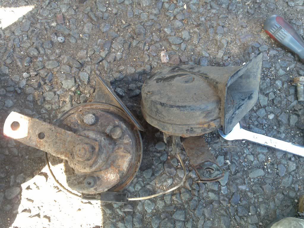

first thing i thought id do was remove the carbon canister and give the drivers side wheel arch a clean as i hadnt had the wheel off that side yet.
as you can see really quite caked up in s**t. dirty horns
got rid of carbon canister and the bracket and bolted the honkers to the cages original place.

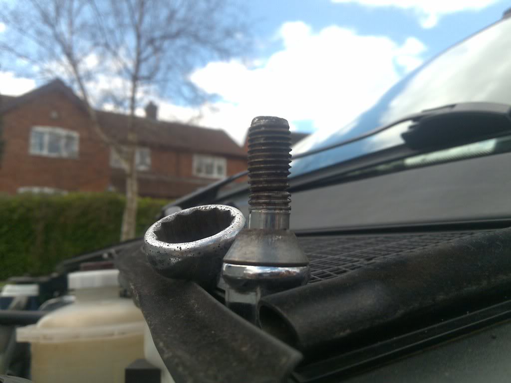

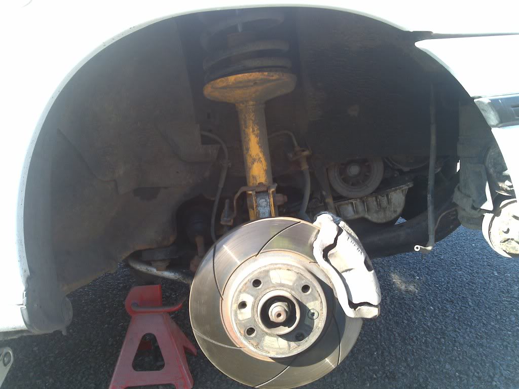

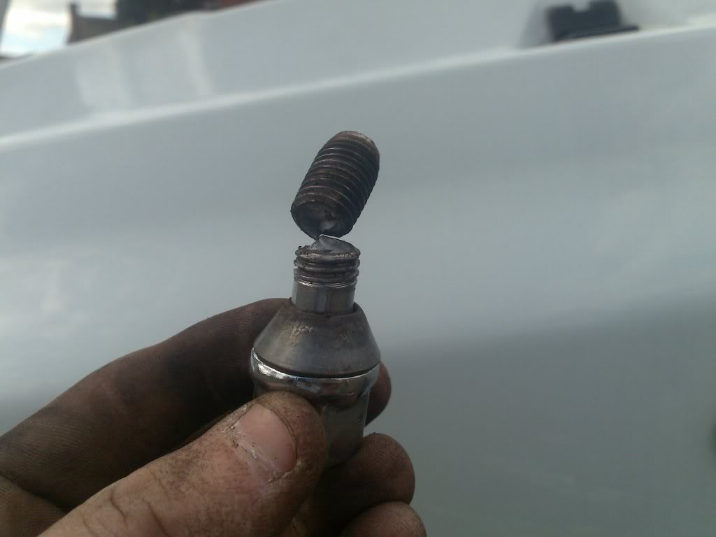

putting the wheel on had abit of a shock when tightening the wheel nut up it felt like i had snapped a wheel bolt.
luckily the bolt came straight out and didnt snap in the hub.

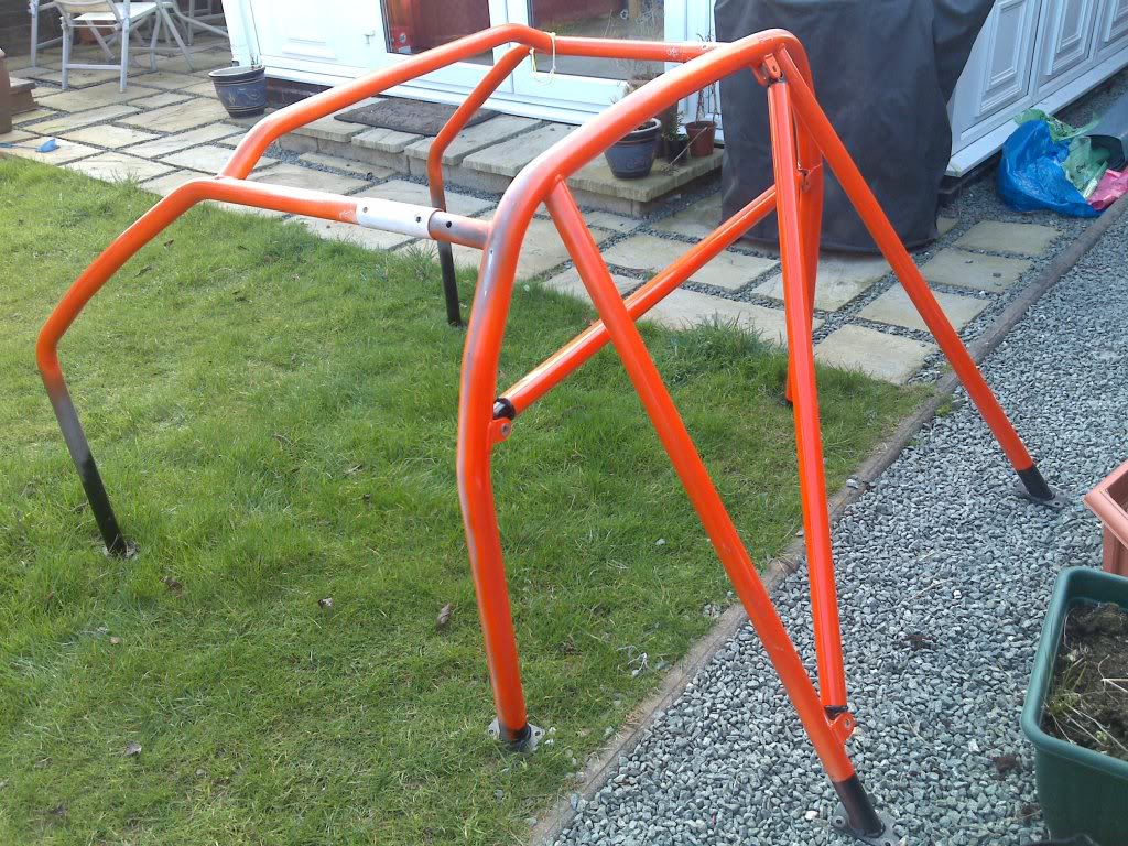

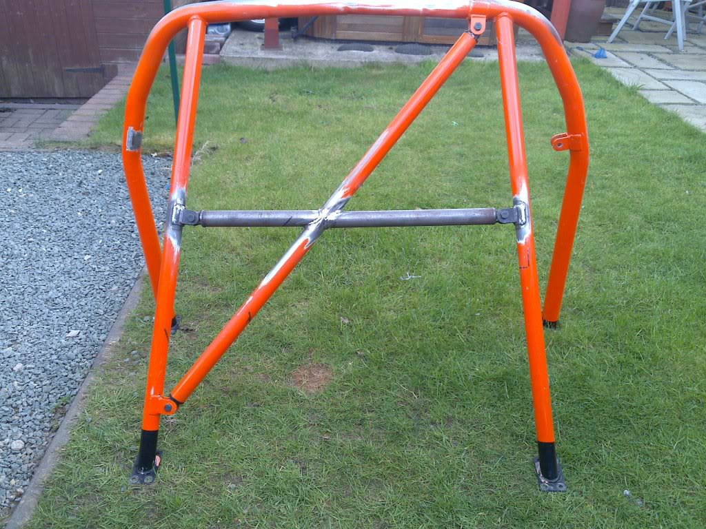

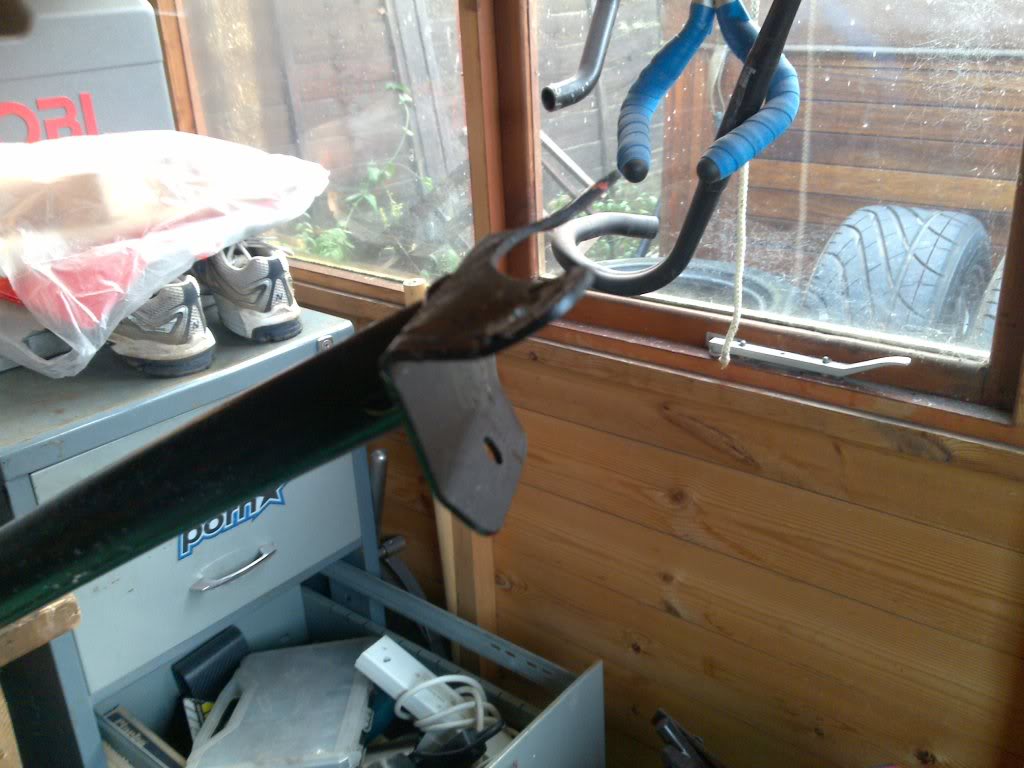

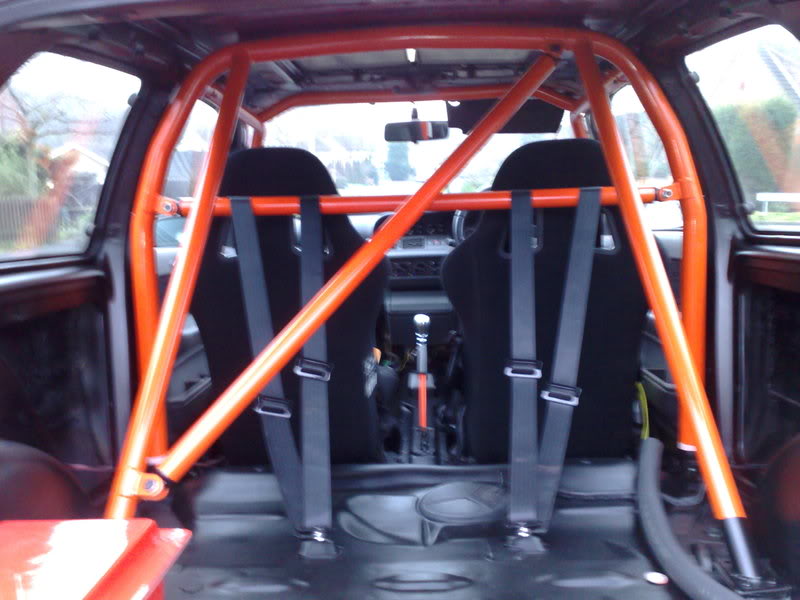

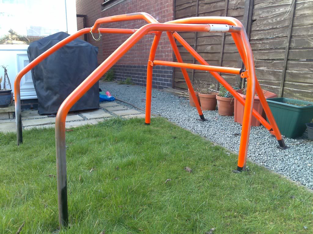

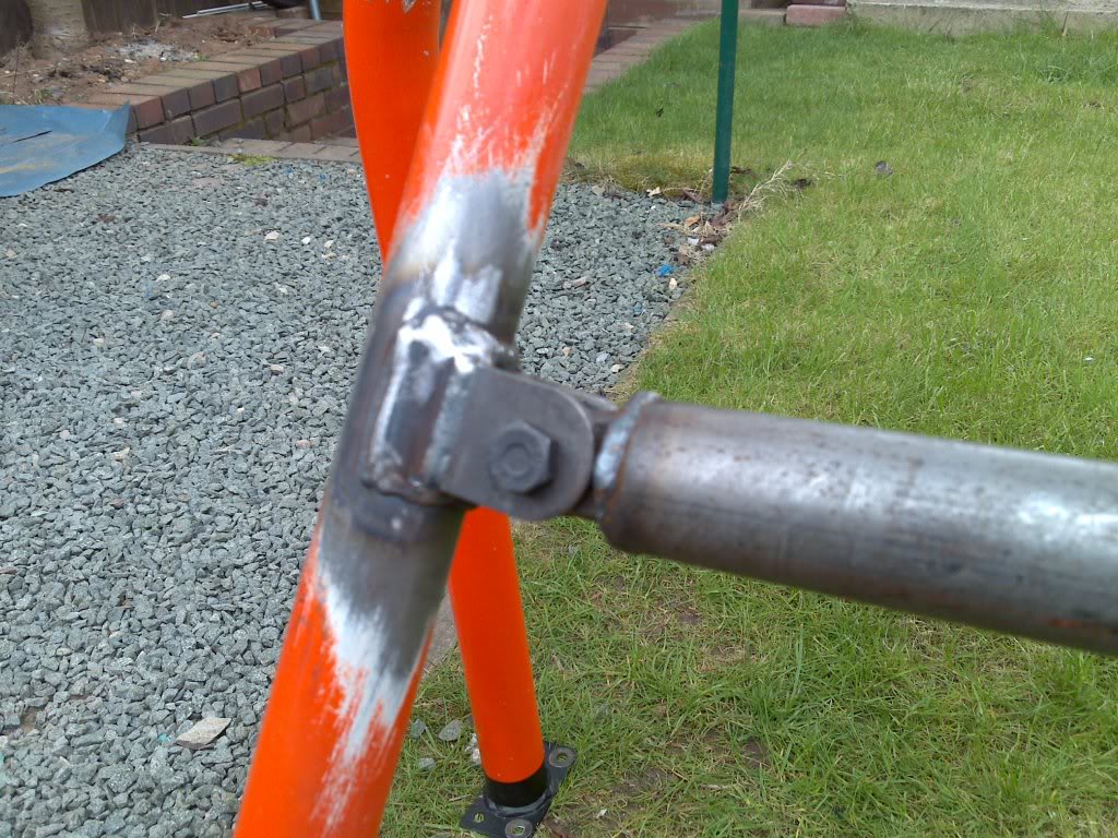

then it was time to start the prepping of the cage so i can get everything powder coated (free of charge :D)

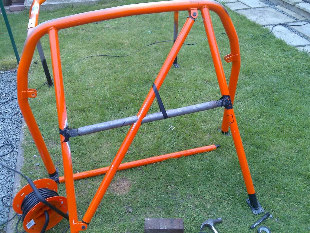

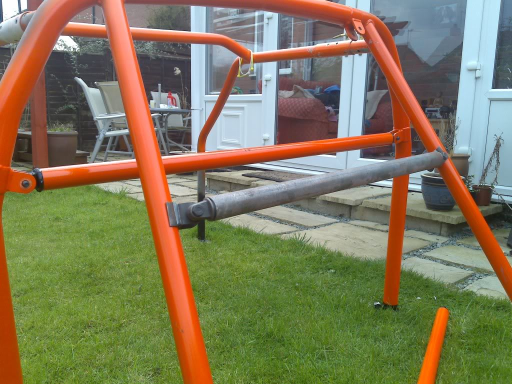

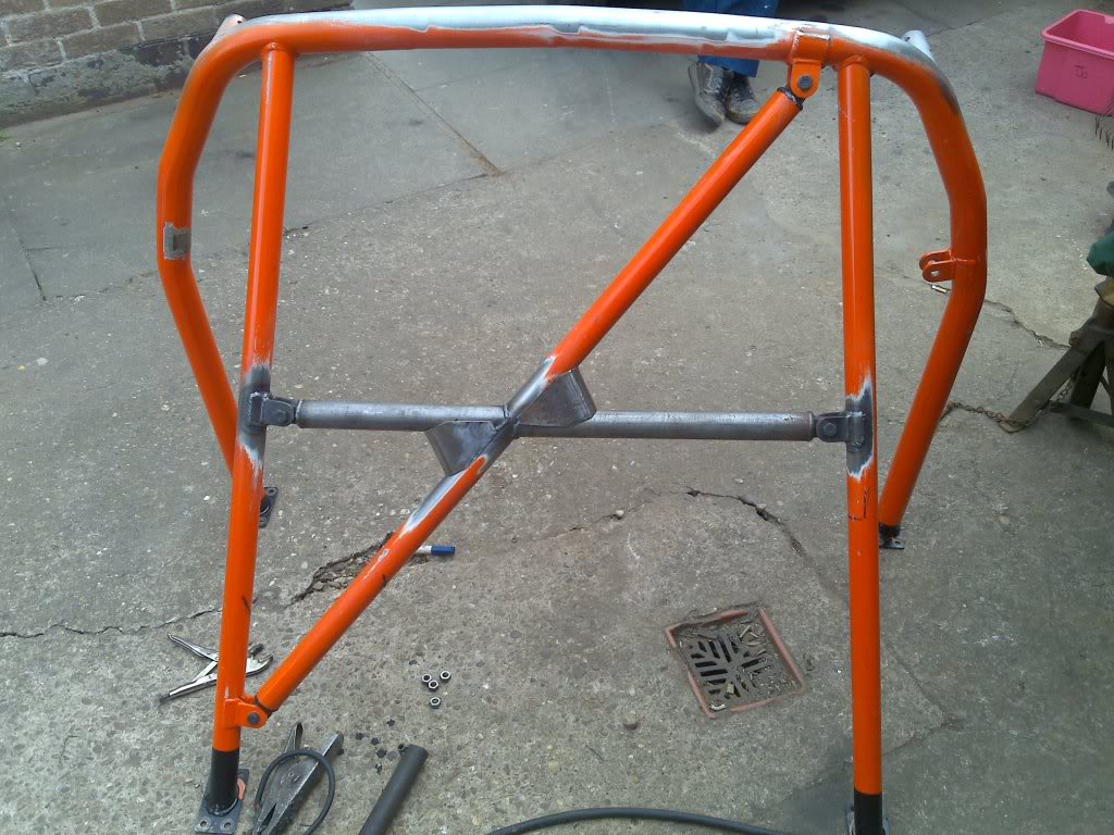

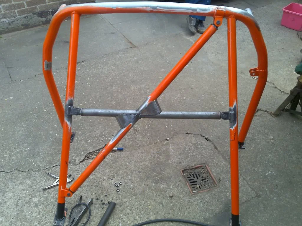

last time i put the cage in i did a harness bar so i could loop the harnesses over it and bolt them to the floor like this
but with my new seats they sit further back with more of a lean so it had to go plus i didnt really like it like that.

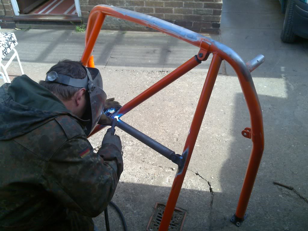

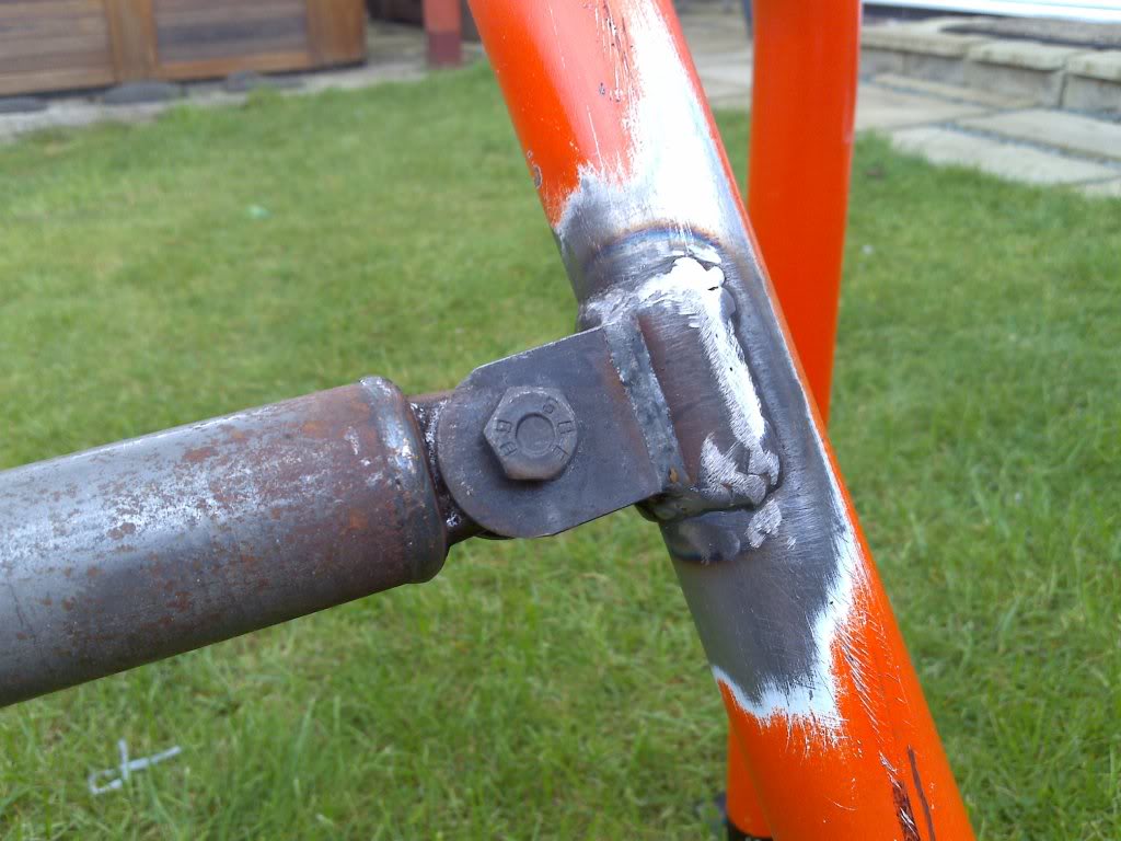

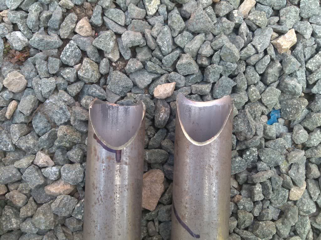

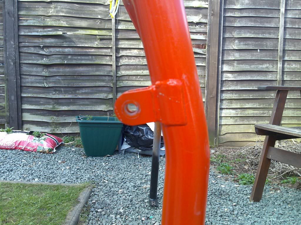

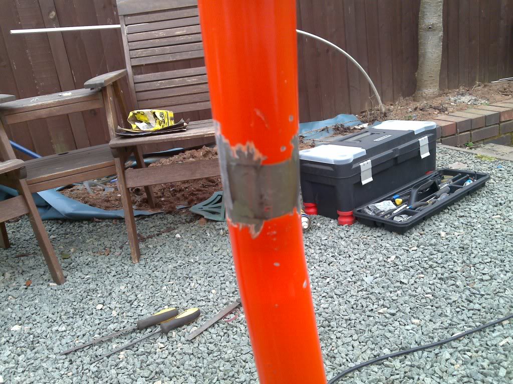

i used a offcut of metal to start marking up where i wanted the new bar to go it was going there with the other bar i made them so it came in a kind of x shape like below, this was a test run and the bars still needed trimming so they sat more level.

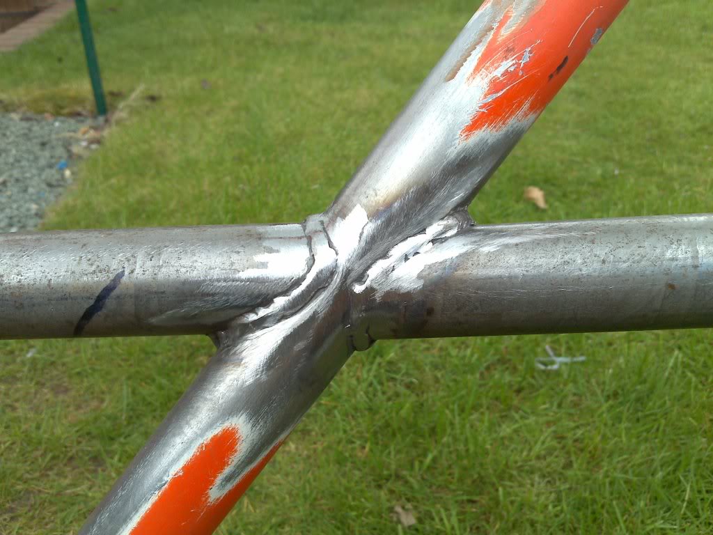

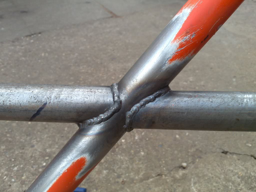

these are the cross bars trimmed up and filled down with my own hands quite proud as the sat on the bar perfectly didnt take me long either.

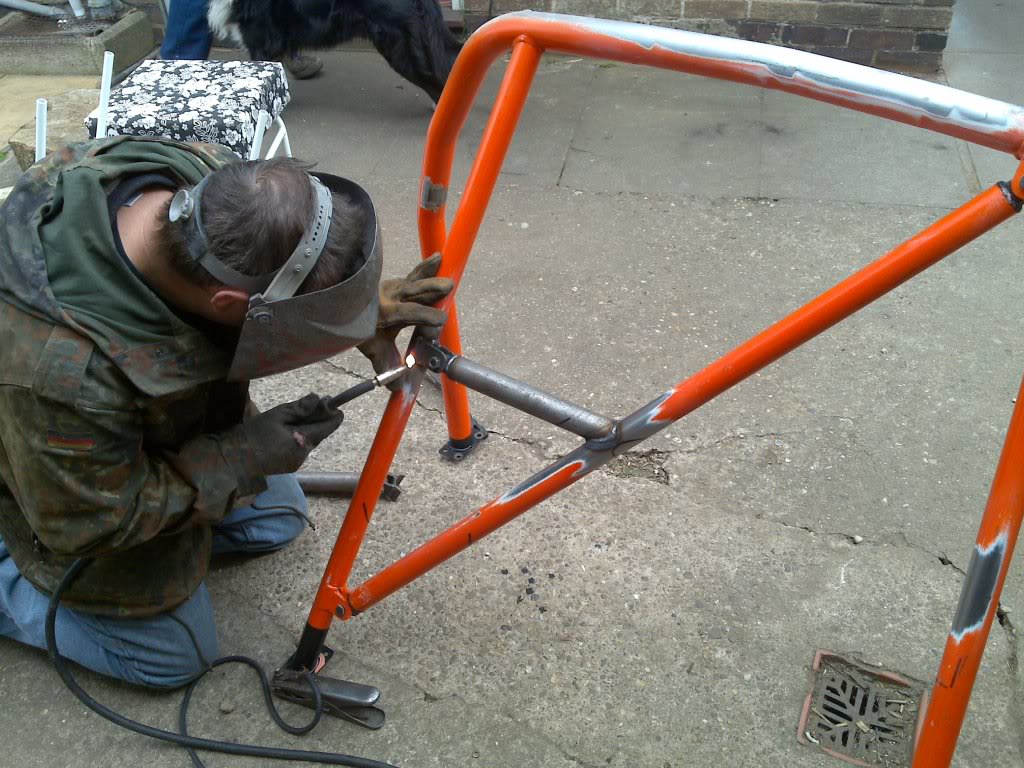

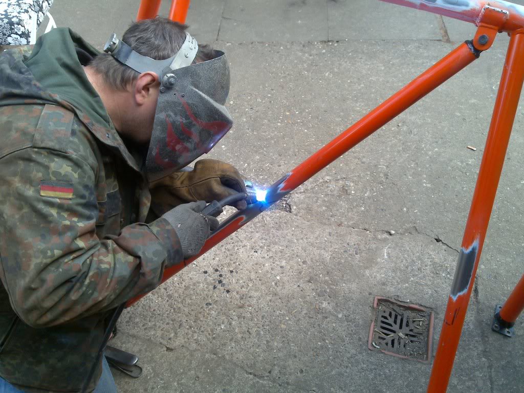

so with the bars trimmed it was ready to take it to a mates for welding.
started off welding the bell kinda shaped bit into the bar
then the mount onto the main down bar
then joined that end up to the middle cross bar
then the same the other side
bosh
toyed with the idea of gussets but decided not to as i didnt think it looked right.
gave the welds a little sand down to neaten the look up
end result, dont think the 2 bars are compleatly level but you have to look to see its not i think but no doubt the egal eyed will notice.

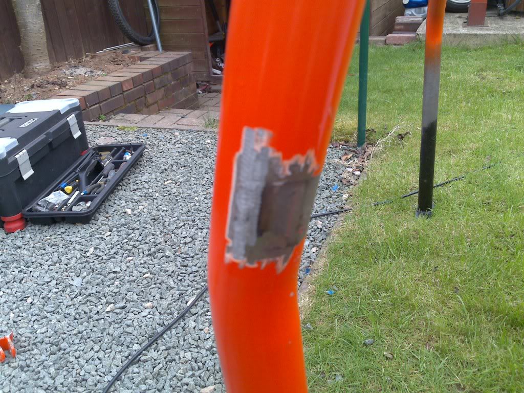

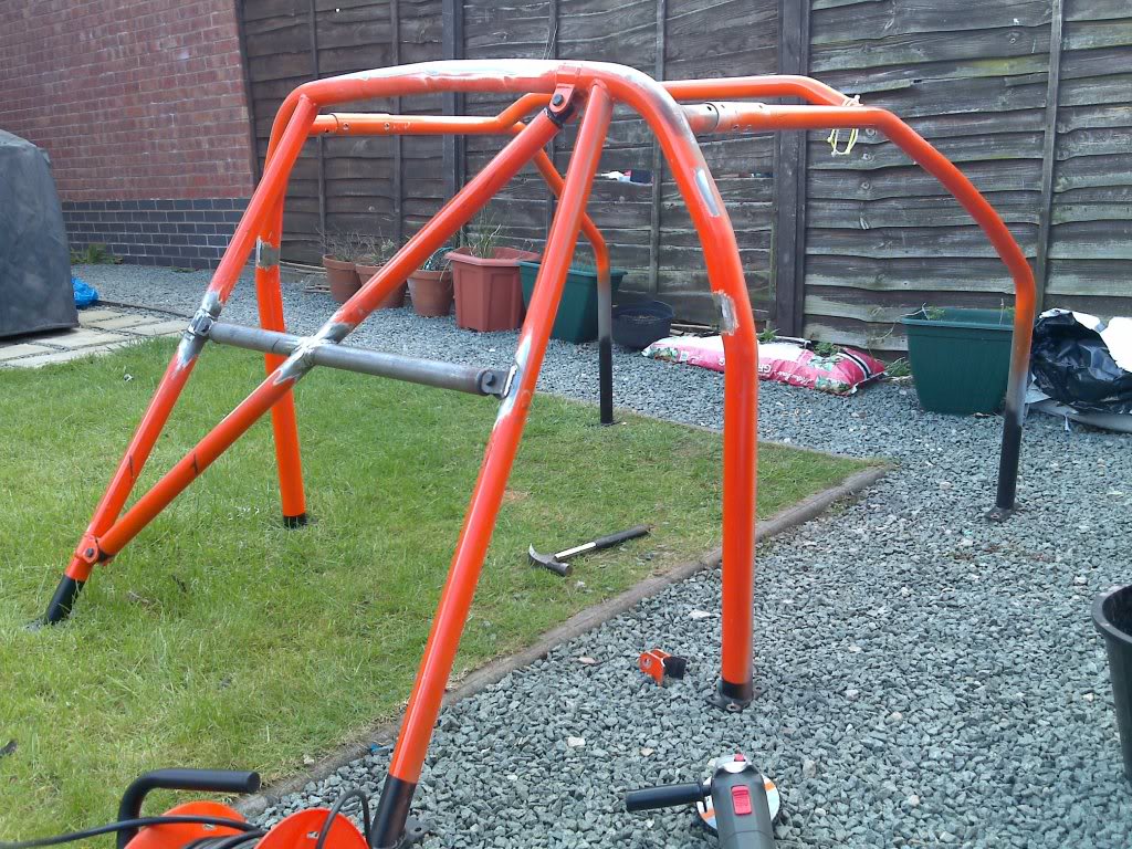

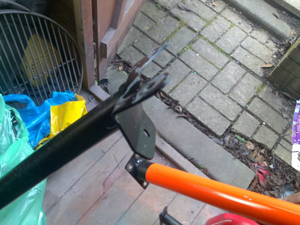

old tabs had to be grinded off
bosh
now it just needs sanding down, spend a fiver on a paint removing sanding disk and it lasted all of 2 mins grrr more pics of the cage to follow.

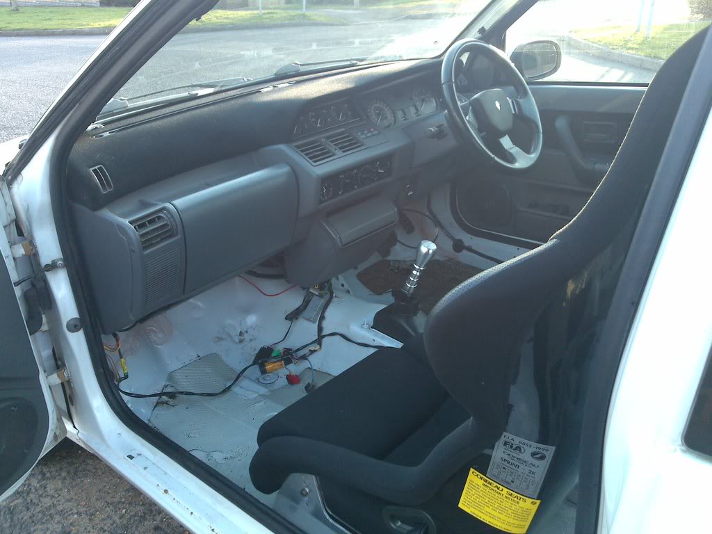

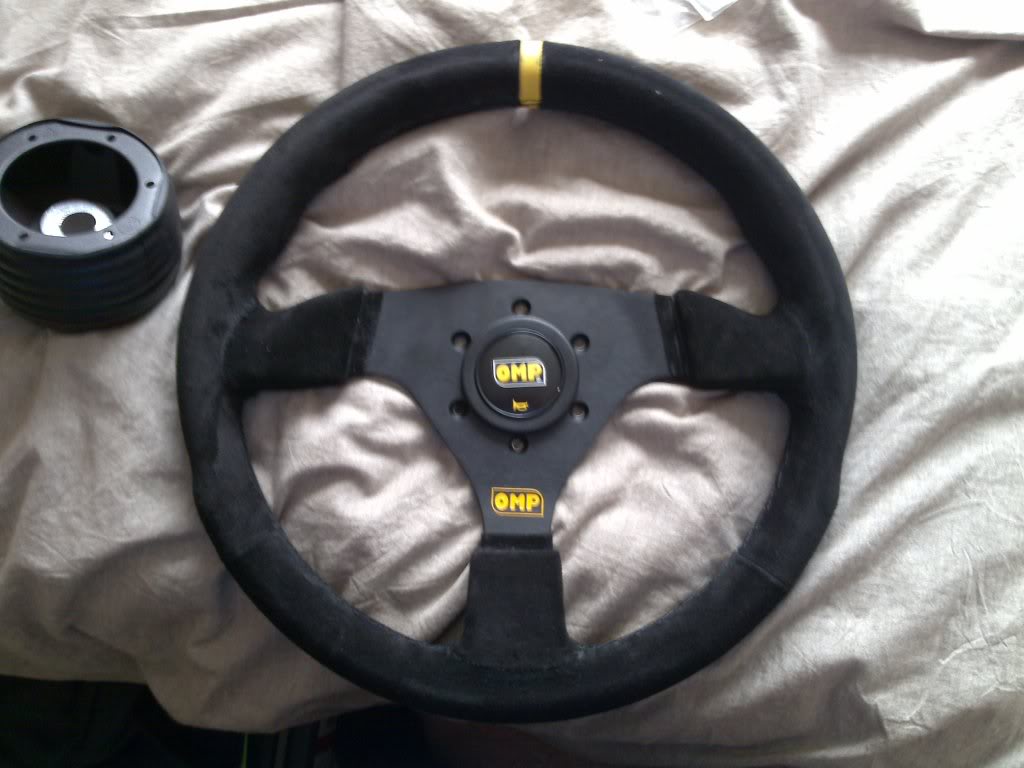

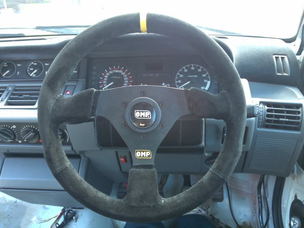

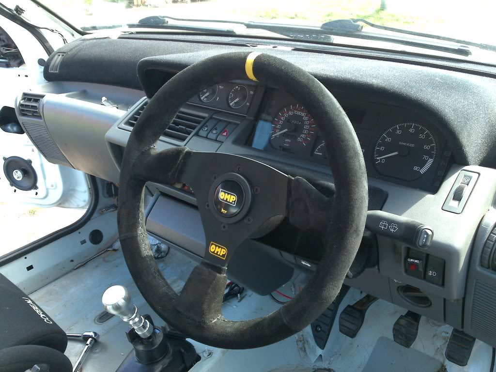

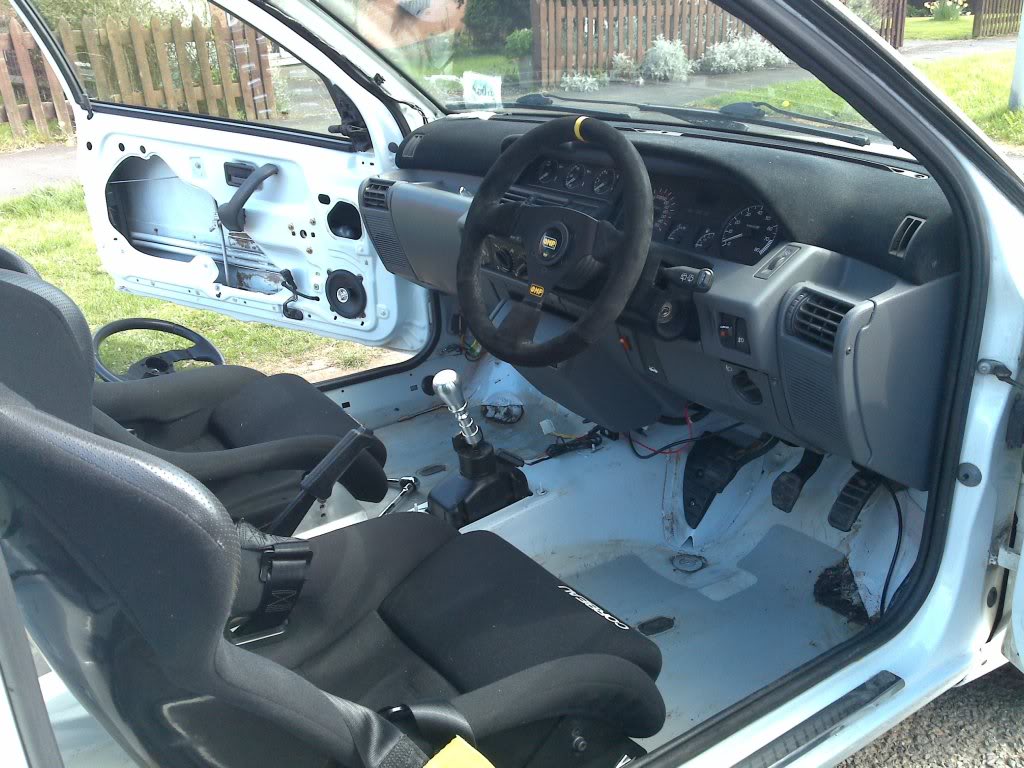

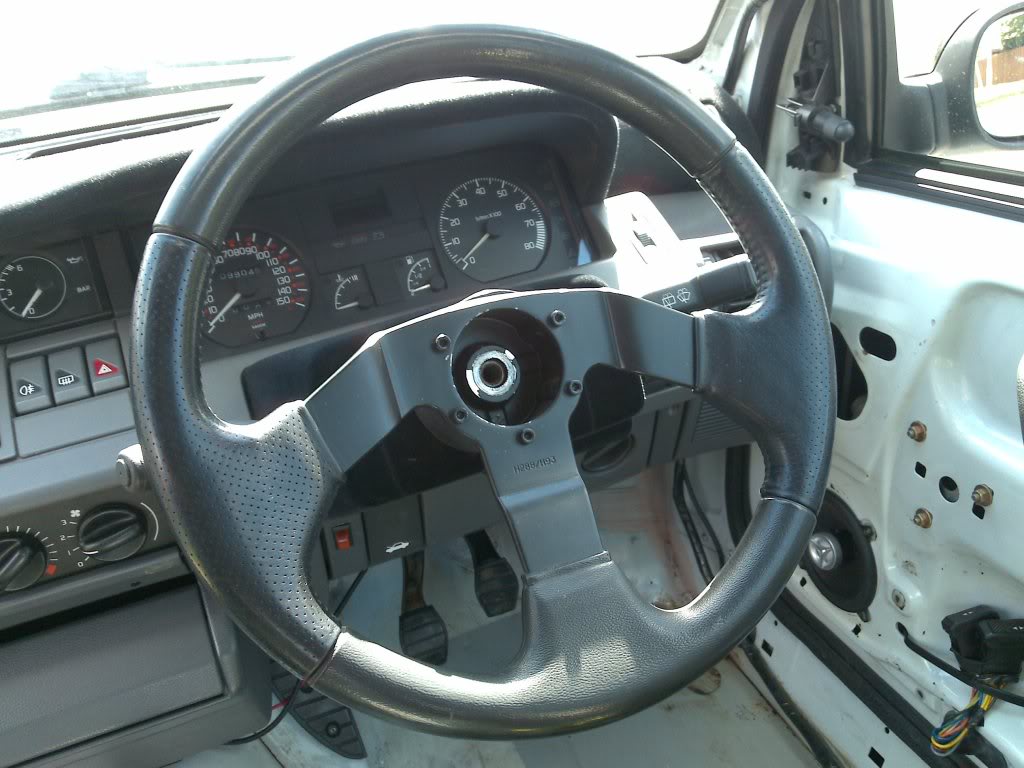

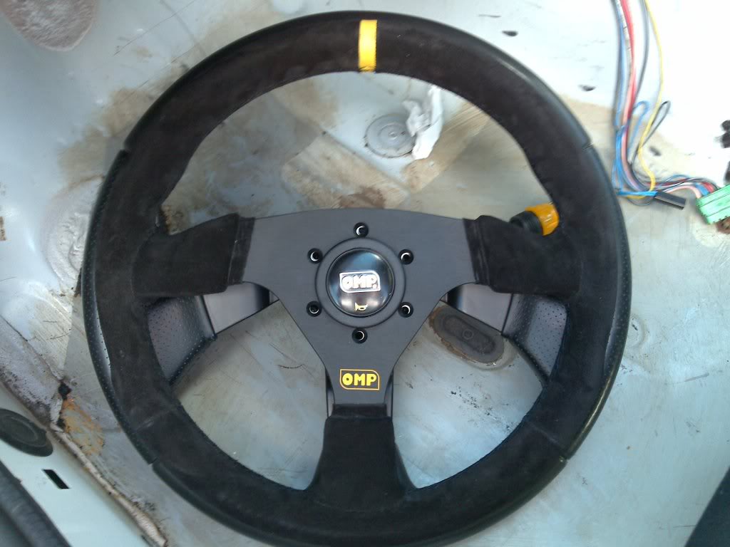

today my new present to myself turned up wanted a steering wheel for fecking ages as the original is to big imo. its a omp targa 330mm with omp boss kit cost 140 deliverd off ebay from ybracing bargain imo much cheaper than sparcos ect.
a comparison to the original
before
after
goes bloody well with my flocked dash and cowlin :D cant wait to get the cage in and battery box in the back to pretty much finish the inside up.
