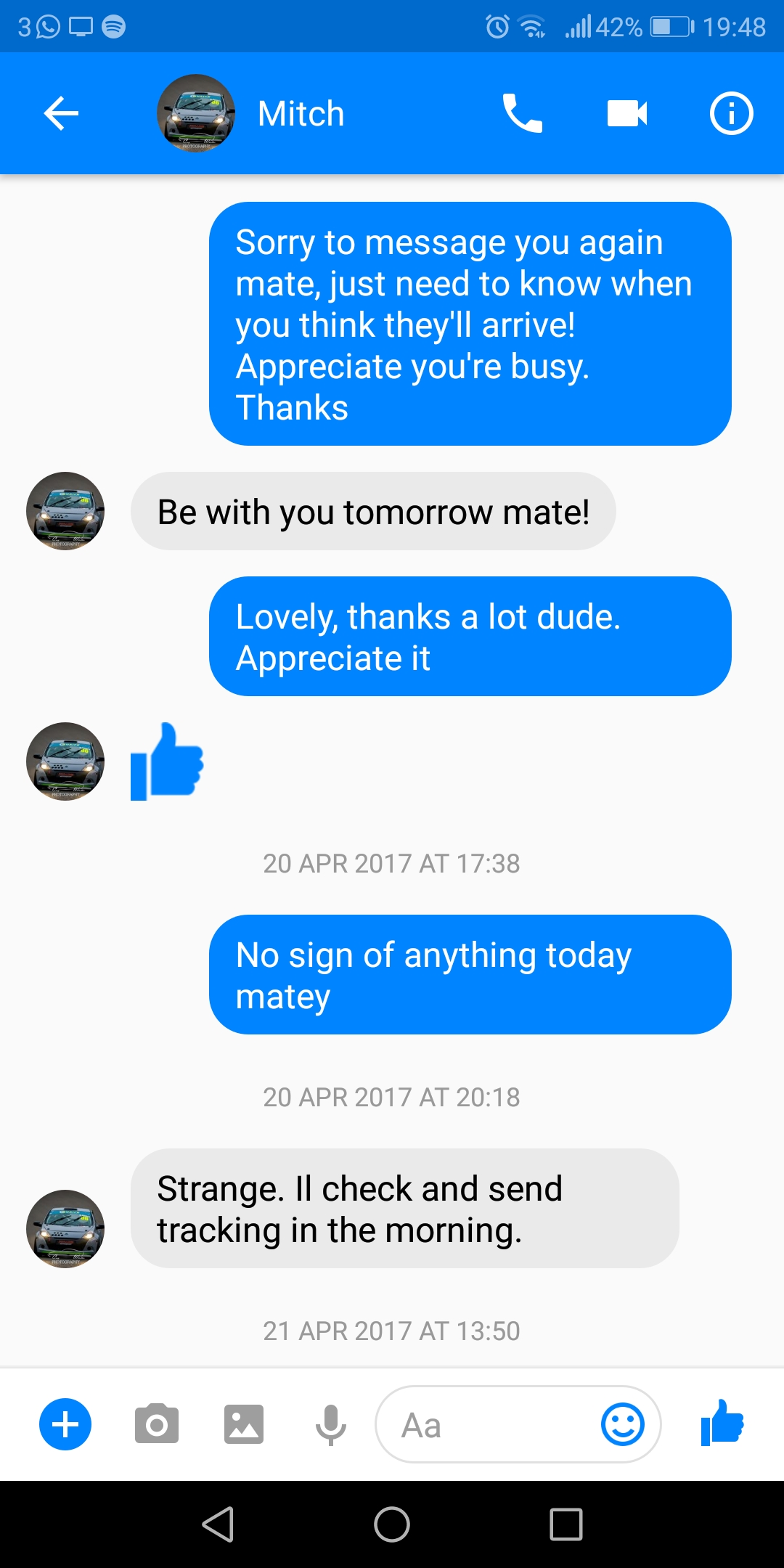

Just to have another rant at Pro Line motorsport.
Bought the internal bulkhead 172 set from them. Took nearly a month to arrive after me constantly chasing Mitch to where they were.
Apparently had sent a set through the post that got lost..... Whenever i asked for a tracking number he never gave me it. Constant excuses....
After "sending" the right hoses I ordered that got lost he claimed he no longer had the blue colour that I ordered. So it had to be carbon or black which I didn't particularly want. Settled with the carbon ones that look great when the finally arrived a few days later, Ive nearly fitted the full set and no problems so far.
Its such a shame that Mitch has a great product to sell and seems to make some really nice quality stuff. The unfortunate thing is that he needs to seriously sort out his game with sending products out to customers.

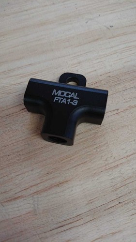

@VenomUK cup (non abs) mc is 4 ports, standard 1*2 abs mc is 2 ports. If I were you Id just use a 2 port and T the lines, its less fittings to work with and easier to deal with when on the car
I got one of these nice mocal Ts for mine.

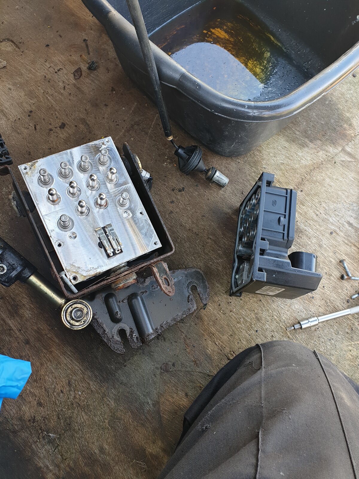

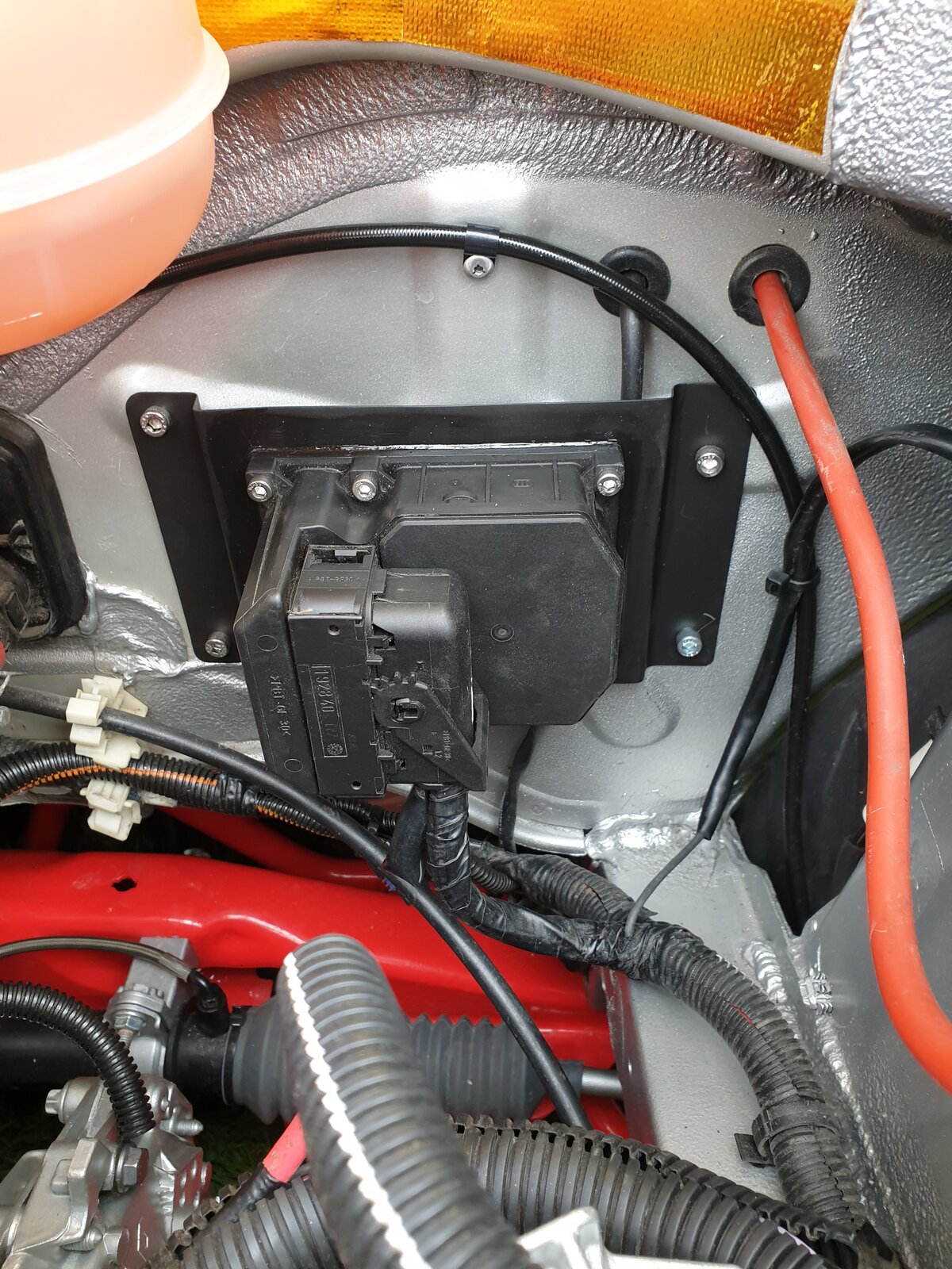

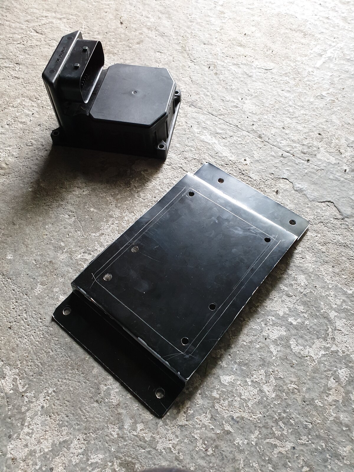

If you are removing the abs unit, split the ecu part from it with the 6 small bolts as you need this part to keep your speedo working. You need to keep both from abs sensors aswell.
I was under the impression you only needed 1 but having driven down the road and the speed only registering half what it should be it put the other side in and then it worked perfectly.
I was under the impression you only needed 1 but having driven down the road and the speed only registering half what it should be it put the other side in and then it worked perfectly.View attachment 1433872View attachment 1433873View attachment 1433874
That’s a tidy little setup there
