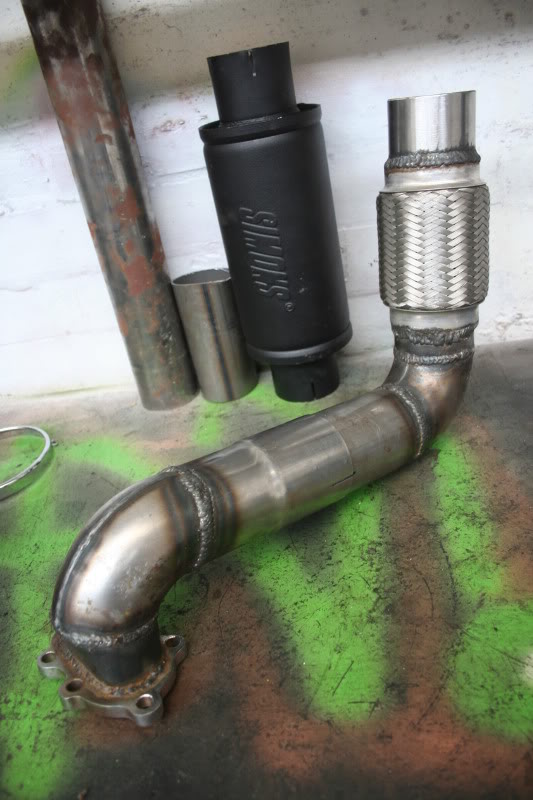

I was going to heat wrap my downpipe but after reading into it there was alot of warnings about fires and it eating mild steel.
If I wrapped and sealed the downpipe would it still be eaten by rust?
Is there anything else I can use to protect it? I know there is ceramic coating but I have a feeling it costs more than my whole exhaust cost to make haha.
Cheers

Yeah you know how hotan exhuast gets so you know how good the paint needs to be.
I'd wrap it or buy a decent mani.
My one is getting pretty bad but nowhere near holing yet.
TBF it was more manifolds that I read it was burning off.. The internetz never lies tho?
So then fred.. Could I spray it inside and out with a good quality VHT paint?

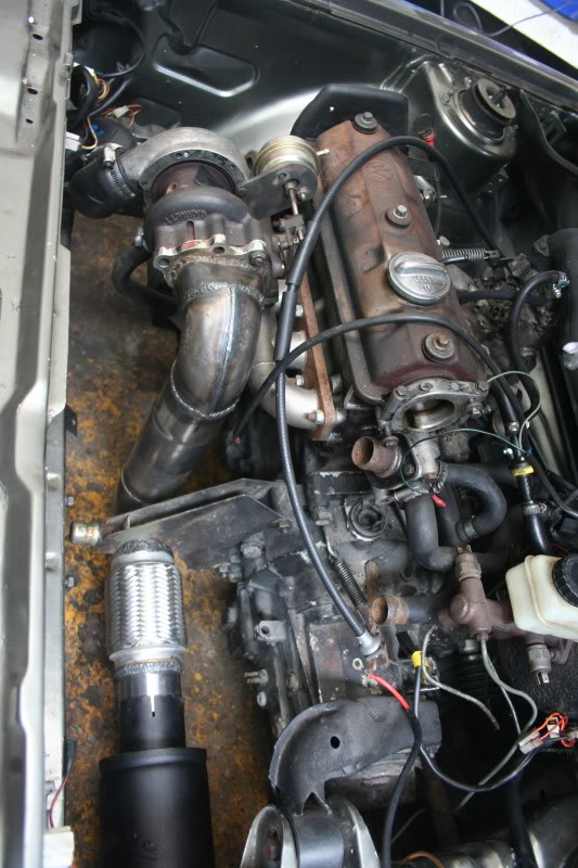

This is on a turbo. I forgot to mention that...

Downpipe wont tend to rust as quick as the rest of gthe system anyway..
But can you not just get one copied in S/s ?
My whole exhaust including downpipe & flange cost £150.. The stainless quotes I was getting were more than double that.
We used mild steel because we didn't have a tig welder and mild just kept it simple and cheap.
Sorry its not clio... Its Polo G40 engine with a turbo conversion and a 5 GT turbo carb instead of the injection.
Cheers fred I will look into aluminumising. If iirc thats what the pipe work came coated with from jetex?
