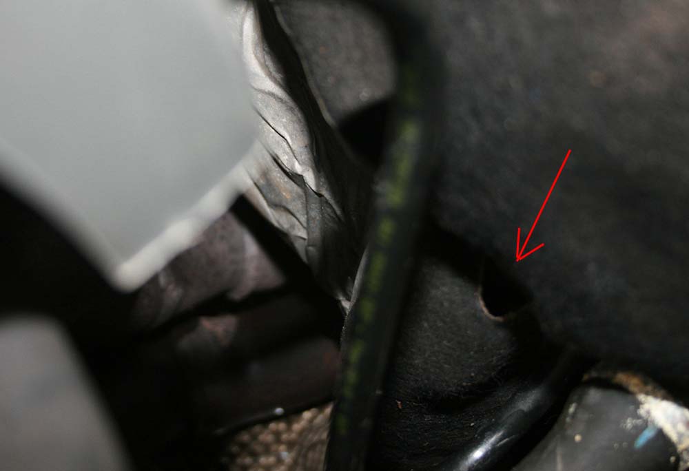

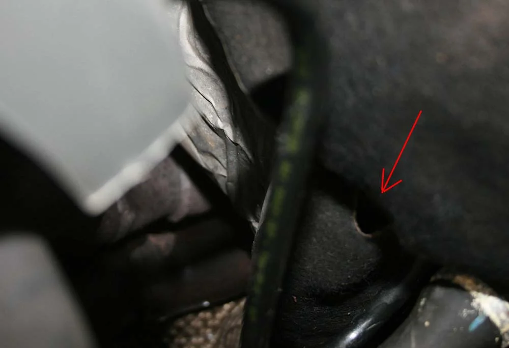

Often a quick fix without removing the scuttle.......
The central scuttle drain comes out at the bottom of the bulkhead, a common problem - at the end of the drain pipe is small rubbery flappy bit, not sure why it's there, but it is usually gets blocked with debris over time.
You can find this outlet by getting your arm down between back of the engine and bulkhead, running your hand down approximately in the centre of the bulkhead just before where the heat shield starts, there is a little hole in the sound deadening, you have to feel for it, just poke you finger in there and give the rubbery flappy bit a good seeing too, this is where the outlet ends, if this is your problem you should see the water coming out.
Is this near the exhaust?
  clio 182
Yeah thanks for that, it turns out the scuttle was the problem, gave it a good fingering and like magic water came out everywhere ✌️ ha thanks for the reply tho.
