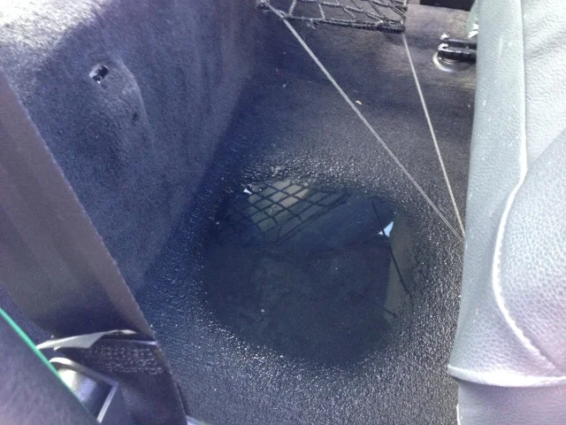

Secondly, I've just gave the Clio a quick exterior clean and when I opened the drivers door I was met with a large puddle of water behind the drivers seat...
I have noticed the last few nights the front window having a lot of condensation ( mainly because of the poor weather I thought ) but obviously it was due to this. Car being parked on the drive due to us moving items around.
Any ideas why / how this has happened?
Checked door seals, they seem O.K? There not perished and still look good.
Entire carpet is wet. Mainly behind and under seats.

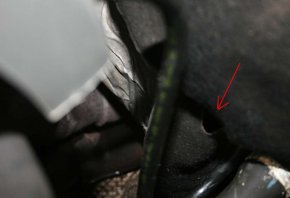

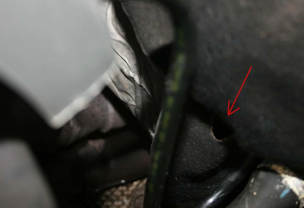

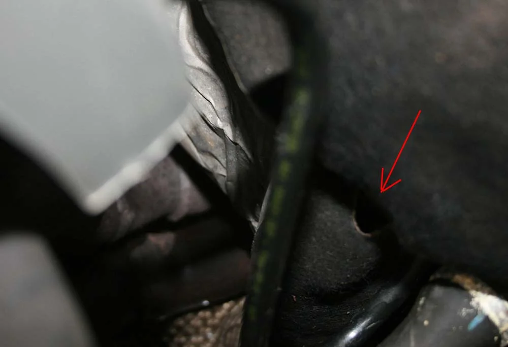

The central scuttle drain comes out at the bottom of the bulkhead, a common problem - at the end of the drain pipe is small rubbery flappy bit, not sure why it's there, but it is usually gets blocked with debris over time.
You can find this outlet by getting your arm down between back of the engine and bulkhead, running your hand down approximately in the centre of the bulkhead just before where the heat shield starts, there is a little hole in the sound deadening, you have to feel for it, just poke you finger in there and give the rubbery flappy bit a good seeing too, this is where the outlet ends, if this is your problem you should see the water coming out.
