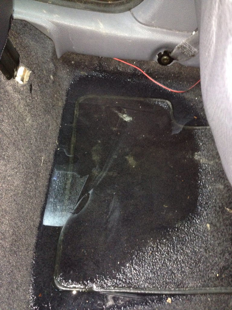

Every time it rains I go out and find there is 1cm deep puddles in my rear footwells... especially the offside (drivers side) rear footwell.
Could someone tell me what seal is letting this water in and where it's draining. I'm desperate to stop this before it causes too much damage.

My 172 would have puddles there also. Cleaned drainage holes in the front sill and changed my boot rubber seal and bone dry ever since.
  Mx5
This is how bad mine got at one point. Try clearing the drains behind the scuttle panel as already suggested. (The drain holes are in the bottom of the wings as well. If this doesn't work then remove your carpet and the underlay stuff. You can then dry them and whilst they're out get someone else to spray the car with a hose and see where the water is getting in
