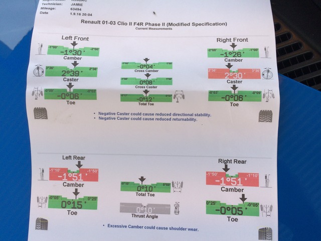

Did all that and there were no abnormalities so I got a hunter allignment check done after checking everything over on the ramp.
I have attached the results.
Does any of that look bad enough to cause a pull to the left?

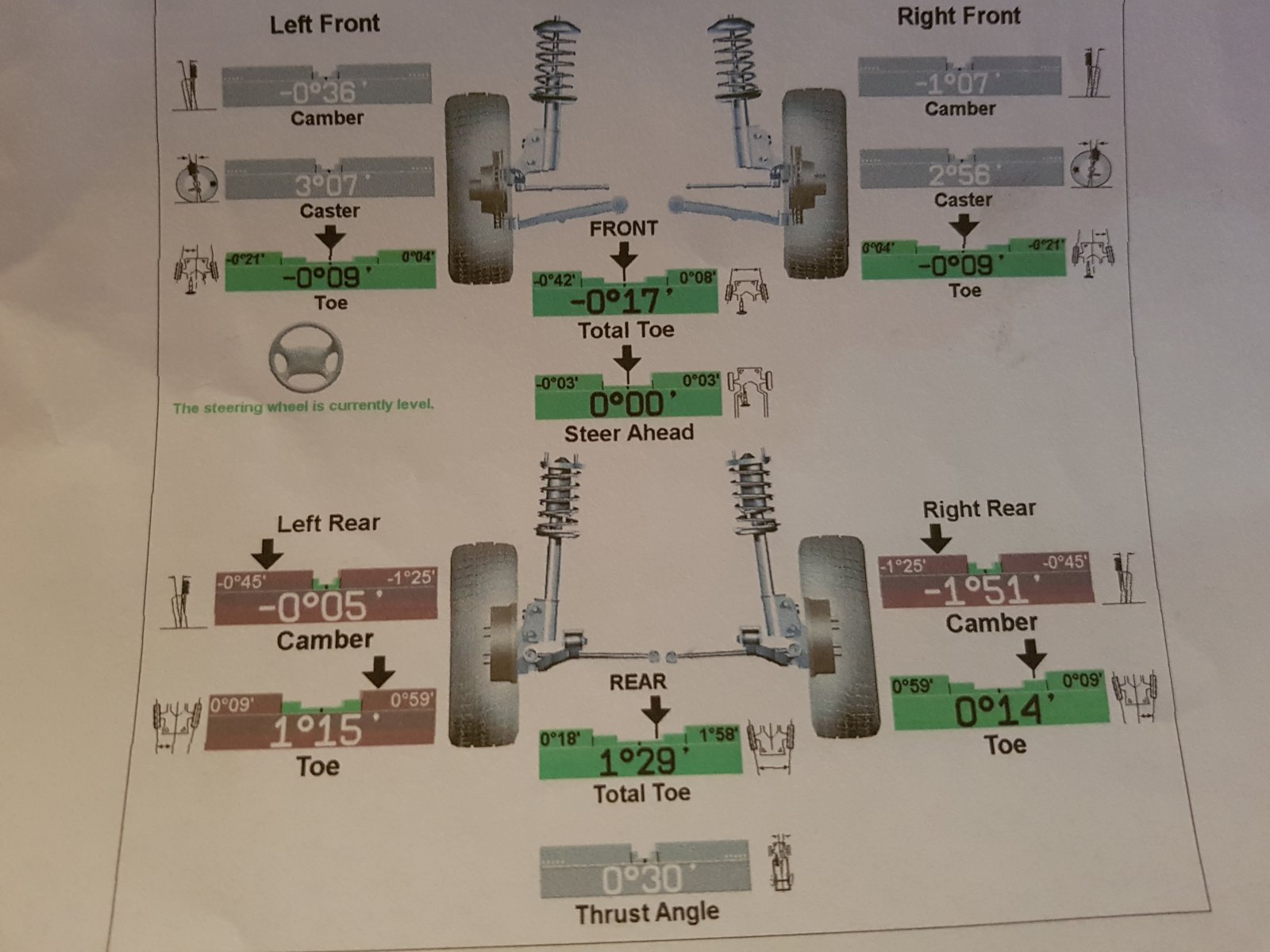

Yep issue with rear toe and camber, that will cause it to increase tyre wear and pull as one tyre will wear quicker etc. Mine as an example
Yeh as I though.
Would there be enough movement to try and correct it if I slackened the rear axle and try to re centre it and nip back up?
Do those reading suggest a bent axle or stub axle?
What's the chance of it been corrected with a set of these?
http://www.pure-motorsport.co.uk/details.php?itemid=128
One on the right for the camber and one on the left to fix the toe?
Looking at these,all holes are the same size,so they can fitted anyway round.
Could your car already have a set of these,but fitted incorrectly?
The problem is the left hand rear,the right looks fine.
These shims are what you need,but you need 1.5 degrees in total each to correct both toe & camber.

Bent beam would say 75% sure after seing that tracking unless as above some plonker has put shims in upside down but i doubt it tbh
