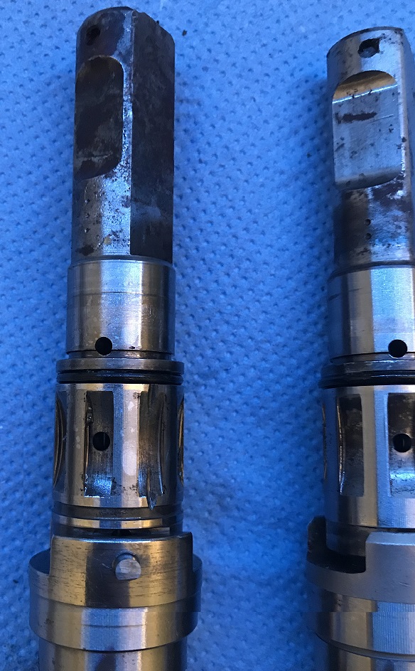

There are differences with the racks as well. There is a channel on the left one but not the right. How much a channel like this would change the steering feel Im not sure, there could be differences with the valve design but minute changes arnt possible to see. Although I doubt they would go to the lengths of changing something like that.
They have different numbered dots, 3 and 2, some have 1 or no dots. But that could mean nothing, just like the rack shafts have different letters engraved on the end, I had 4 1*2 shafts lined up but all different lettering.
