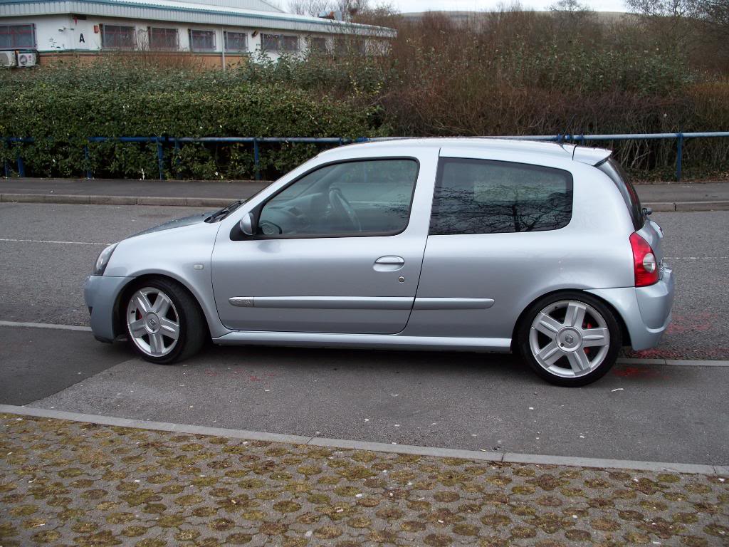

Car  coiled 'berg
car currently sitting like:
want to lower the front another 10-15mm
all the geometery has been set up, as it is now.would it really need doing again after a 10mm drop or would the geo still be pretty much the same??
