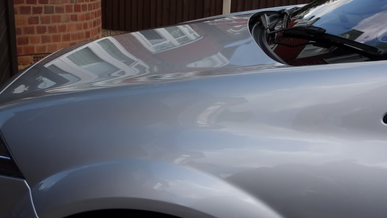

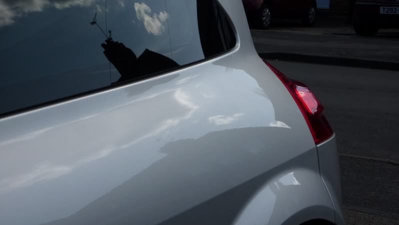

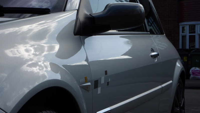

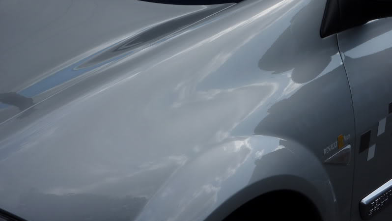

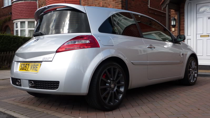

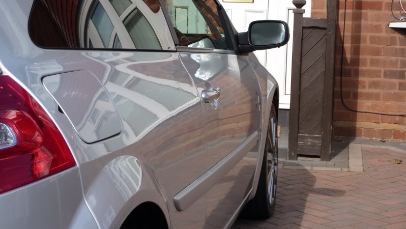

Okay, so after a chaotic morning at work, I spent the past couple of hours de-stressing, giving my car a quick detail, so that I could use my new pot of Zymol Glasur, which I received from Monza yesterday (thanks again Eamonn!)
I was also keen to try out two other new products - Clearkote Vanilla Mousse Hand Glaze and Pinnacle Black Onyx Tyre Dressing.
So, I:
- Cleaned tyres and arches with G101 and various brushes
- Wheels with Duragloss 901 and Dodo Juice Captain Crevice
- Bodywork cleaned with Duragloss 901
- Dried with CG MD
I then set about cleansing the paintwork ready for a new wax. I'd clayed my car recently, so there was no need to re-clay so soon, but I did have a few tar spots, which Tardis dealt with effortlessly.
I then went on to Lime Prime via Rotary and Sonus SFX2 pad to cleanse the paint thoroughly. I followed this up with CK VMHG by hand on a CK MF Applicator, then finially topped this with 1 layer of Zymol Glasur.

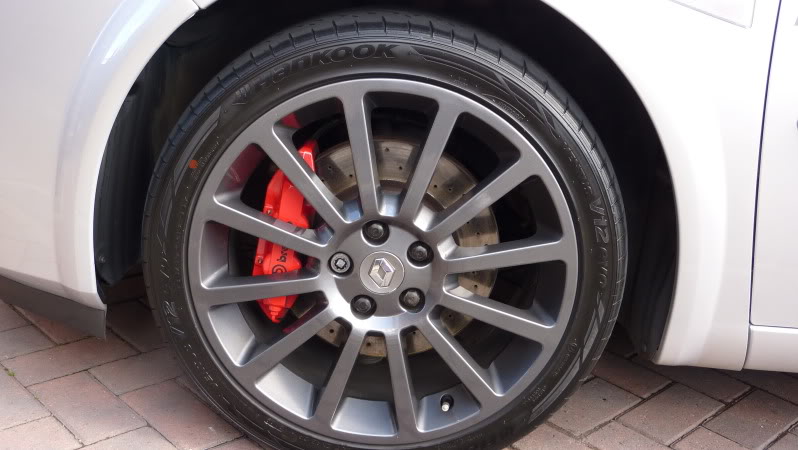

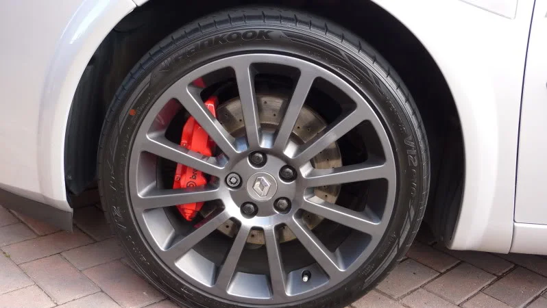

I applied Planet Polish WS&S to my alloys, and used the Pinnacle Onyx on my tyres. I then finished with a Field Glaze wipedown.
Some finished pics:
Overall, I was very pleased with the finish - my personal best yet on my own Silver car. I'd forgotten what a pleasure Glasur was to use. I think I'm finally happy with a wheel combination too - I've tried EVERY tyre dressing now, and this gives me the best look, and if it lasts, it will be my main dressing. I've also tested a LOT of wheel sealants recently, and none match the PP WS&S for looks, and with a couple of layers it lasts very well too.
It still needs properly correcting, but that will have to wait for another day when I have more time!
