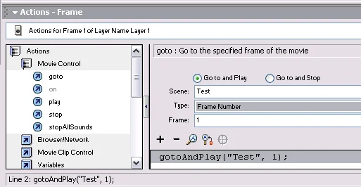

Its probably too late now (Quick macromedia flash problem) but i think this is what you need.
gotoAndPlay(FrameNumber)
or
if the frame you're jumping to is in a different scene
gotoAndPlay(SceneName,FrameNumber)
Hope this helps

Wa version of flash is that mate? Because I cant get what you have on the right side to appear... I just get code.
Yea I cant find disable expert mode.. cos im trying to get it to normal mode... im using Flash 8 pro btw
oh its working now btw as well :)
code was:
on (release) {
gotoAndPlay(31);
I'm using Flash Version 6.
To quickly switch modes on this version you use
CTRL + Shift + E for Expert Mode
CTRL + Shift + N for Normal Mode
this only seems to work when you're focus is on the Actions frame.
