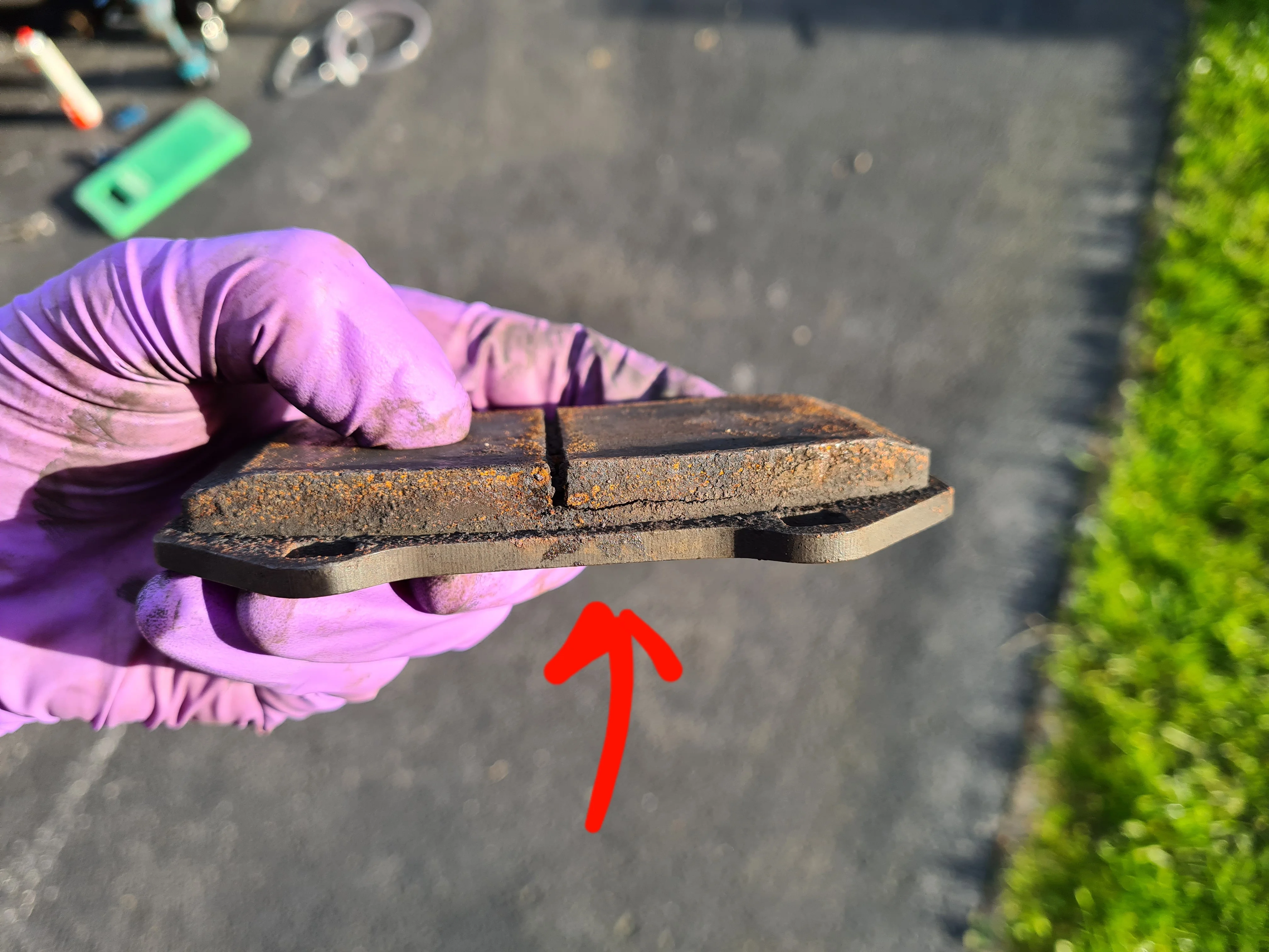

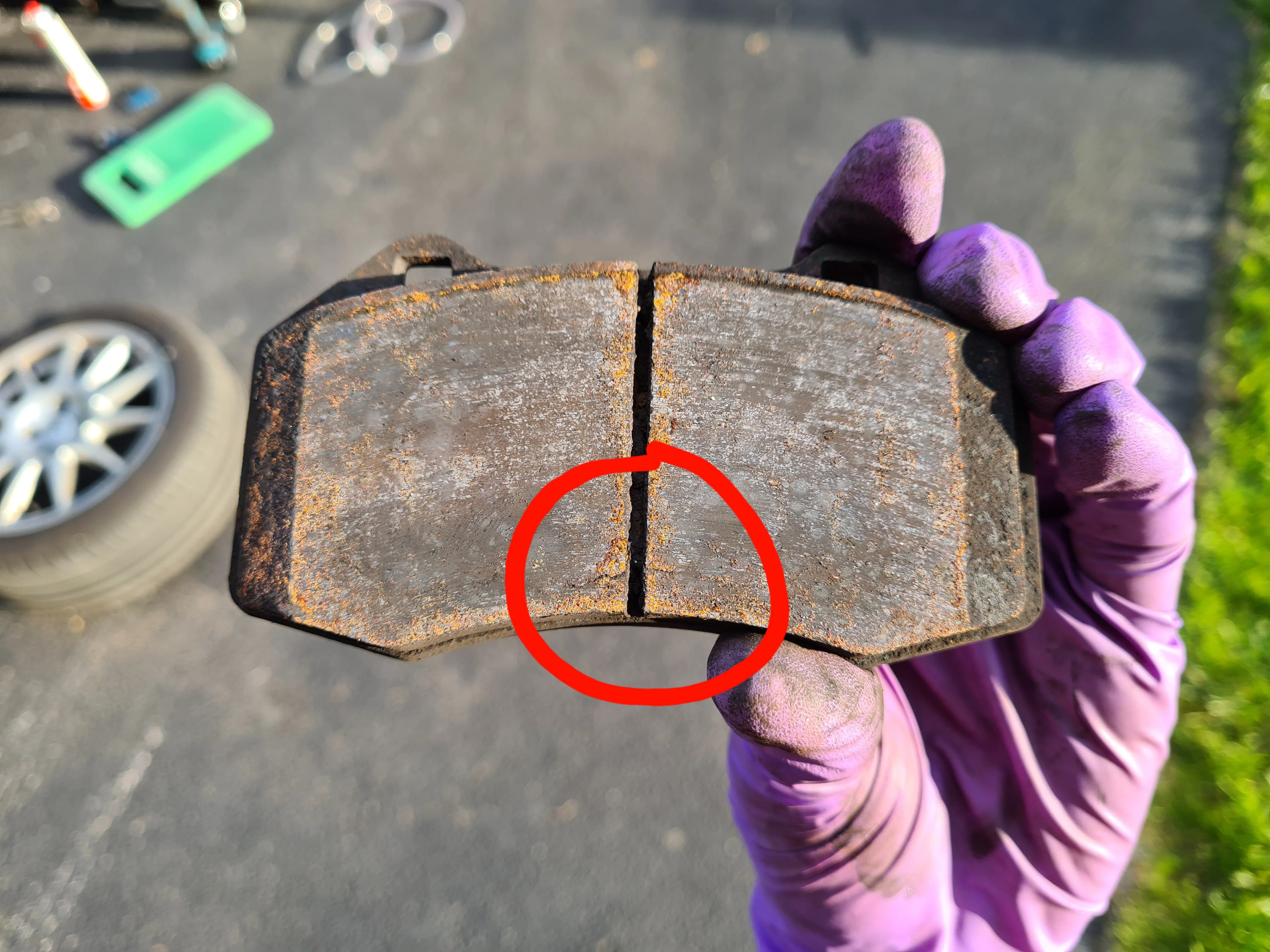

Just fitting my pbs pads for Donington tomorrow and noticed a slight crack in one of the pads.
Took these out after my last track day at Anglesey and they performed fine then but unsure if these will stand up to an afternoon in the wet tomorrow?
Or better to scrap them and put a new set in?

MLB
Nice one, they've been put to good use! At least I don't have to bin the PBS pads then!
I've put ds1.11s in now anyway so should be all good!

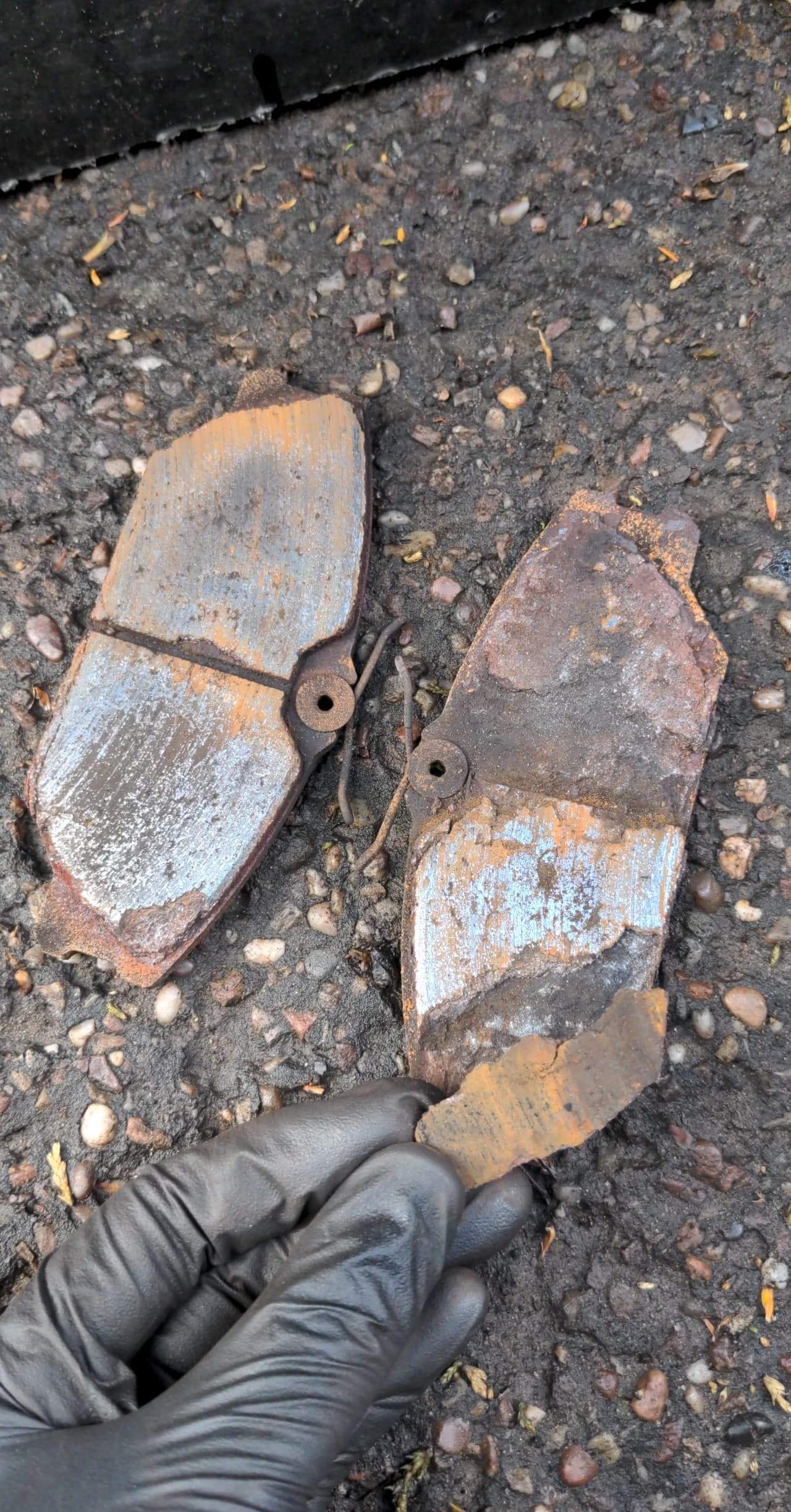

  182 Trophy
I'd probably put new pads in, even though you have so much material you may have already put the pads past their heat range meaning the material is severely fatigued. This will increase the risk of brake failure significantly.
