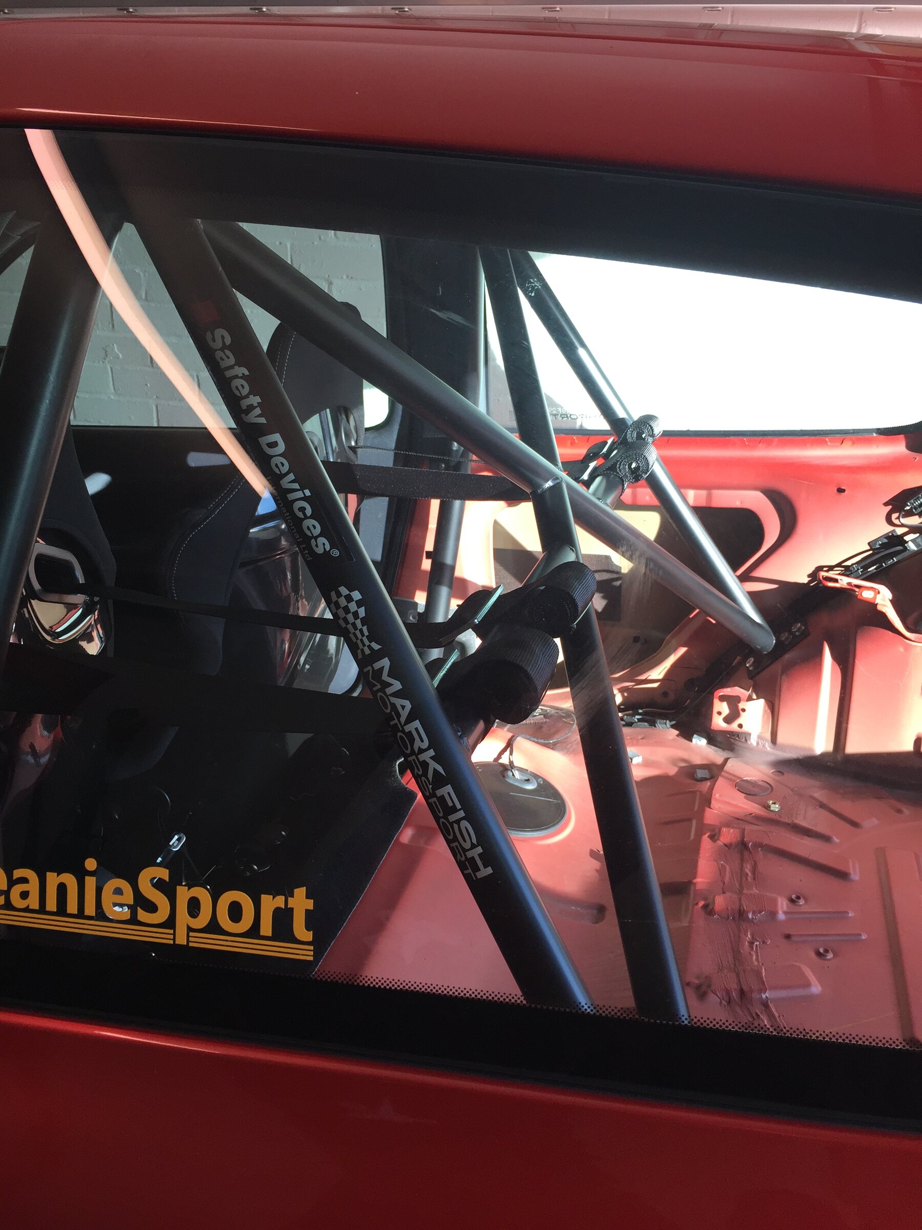

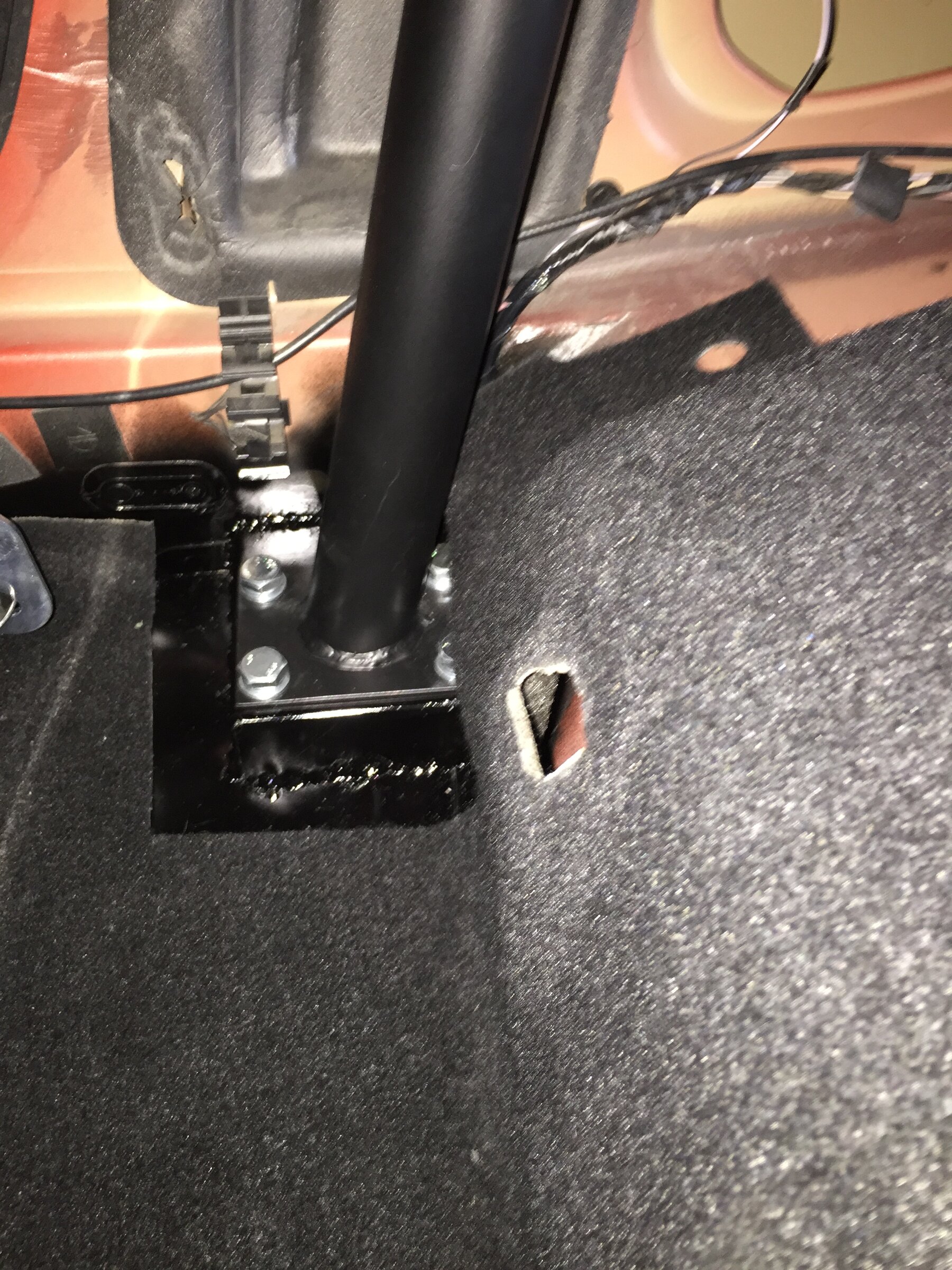

Hey guys, people with the ro17 cage was the rear plates welded inside or in the wheel arch?
If inside what size hole did you drill for the nuts to go through?
Welded spreader plates into the floor of the rear footwell.
It also bolts through the rear arches, 3 each side but can’t remember the size
