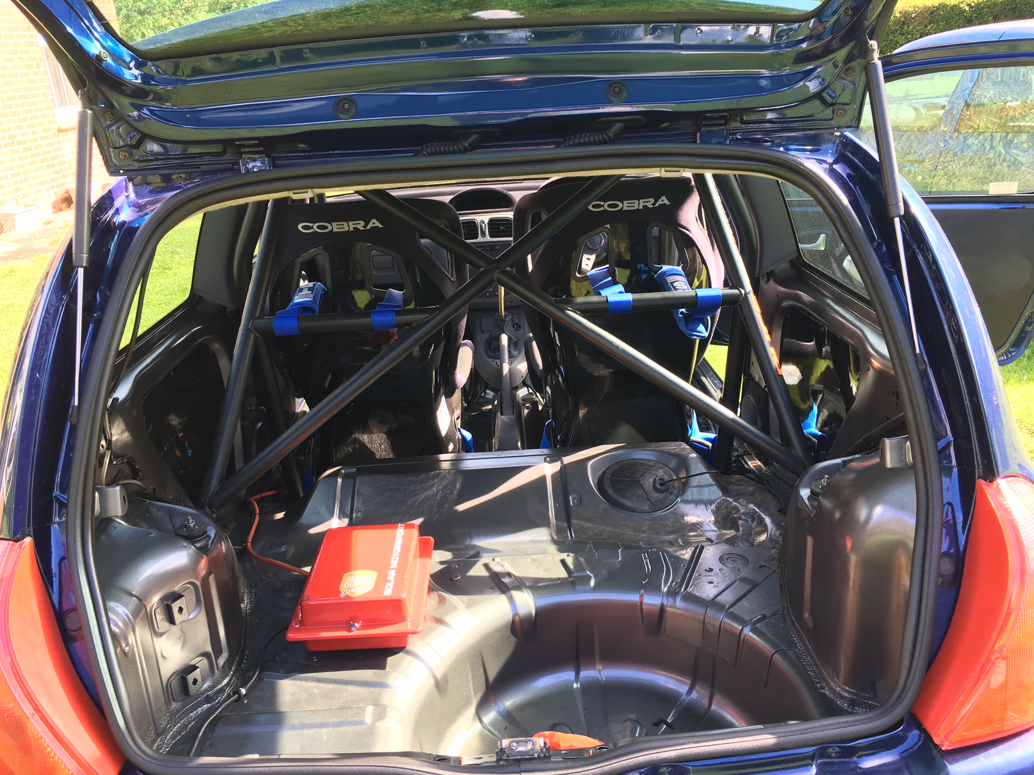

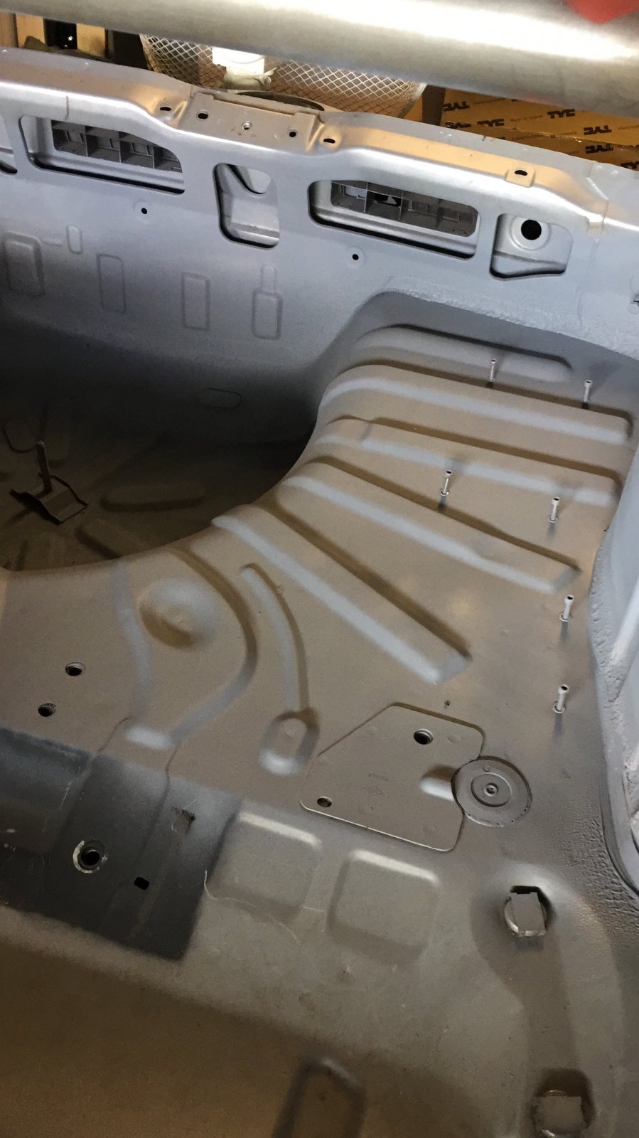

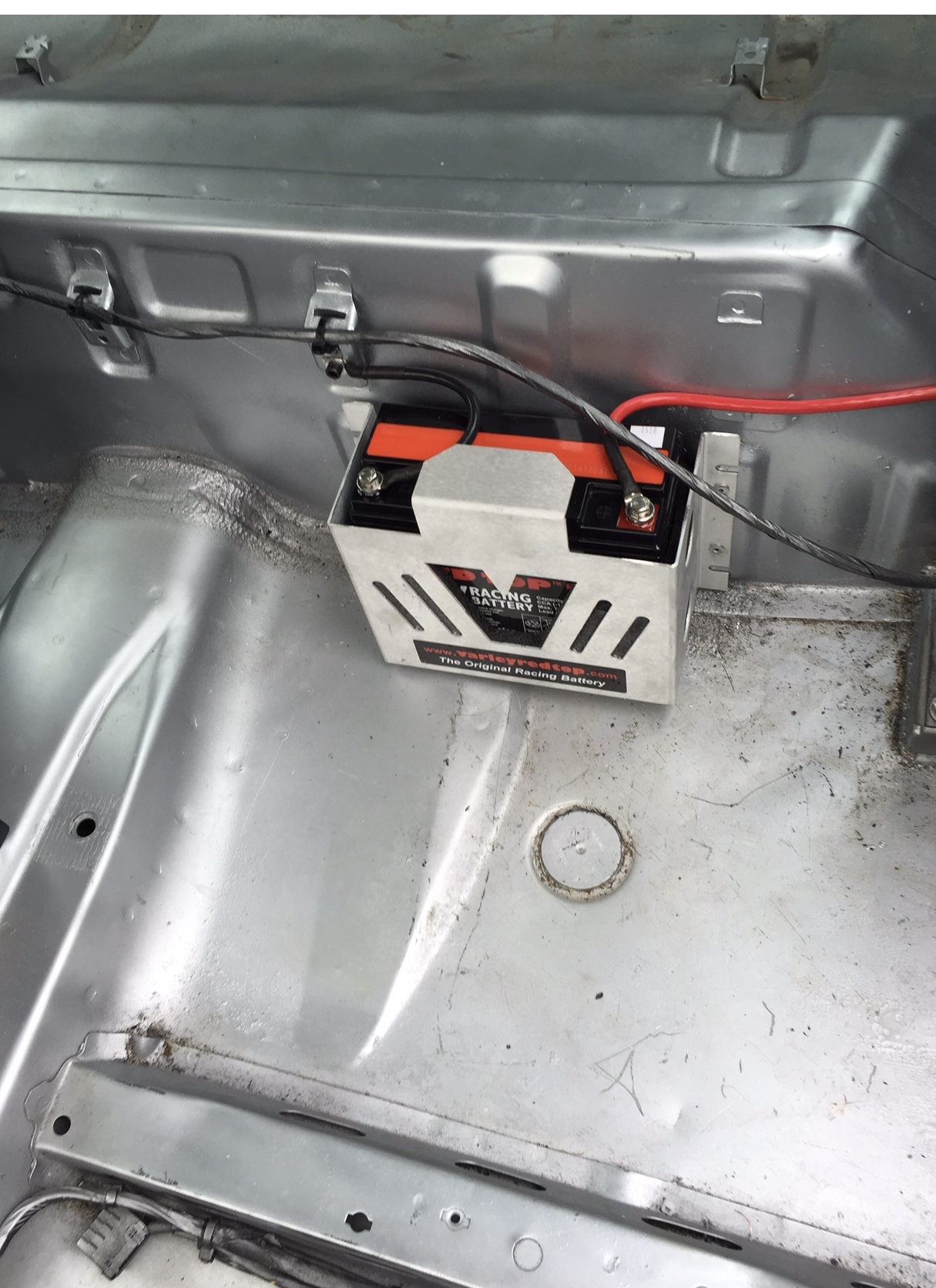

I know mine's a 172, but mine is where the 4 bolts are at the back of the boot.
It's on it's side in a cage.

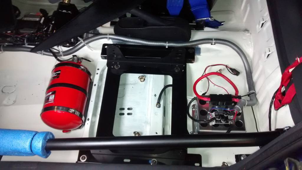

  182 trackcar, XC60t6

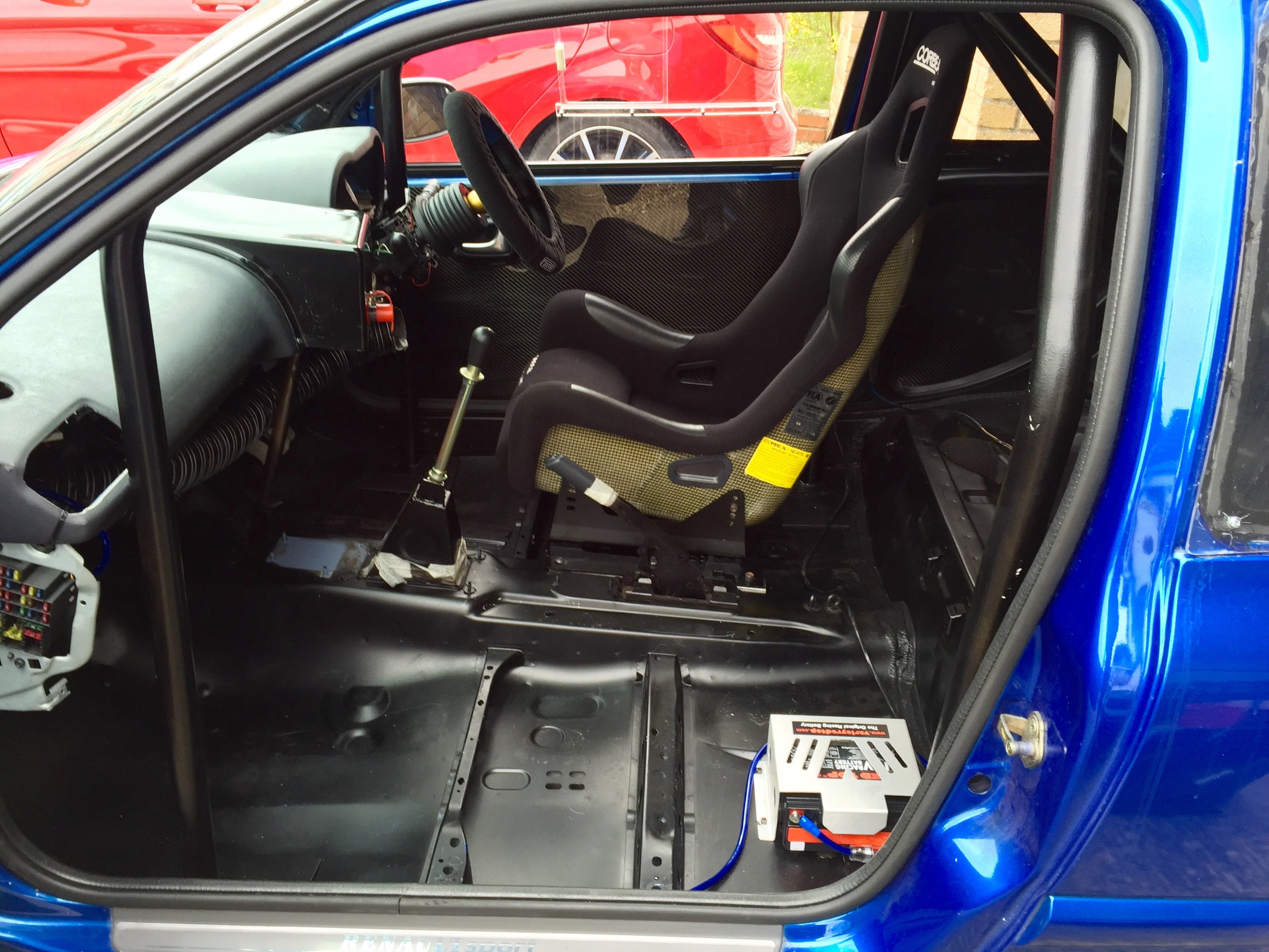

Between the passenger seat rails flat on the floor. Put some closed cell foam down. Bolts some steel strap straight through the floor.
  Clio 172 (CUP)

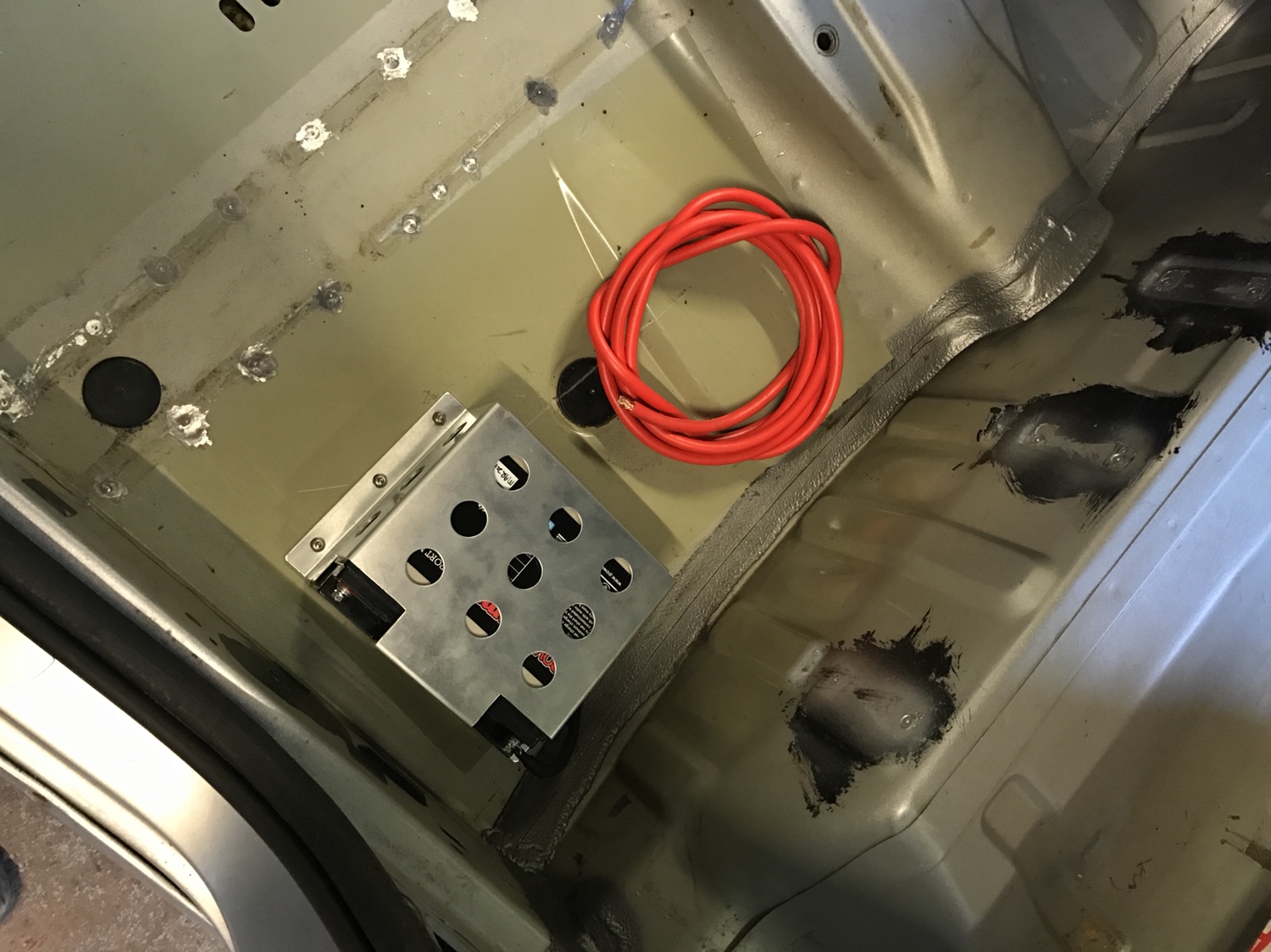

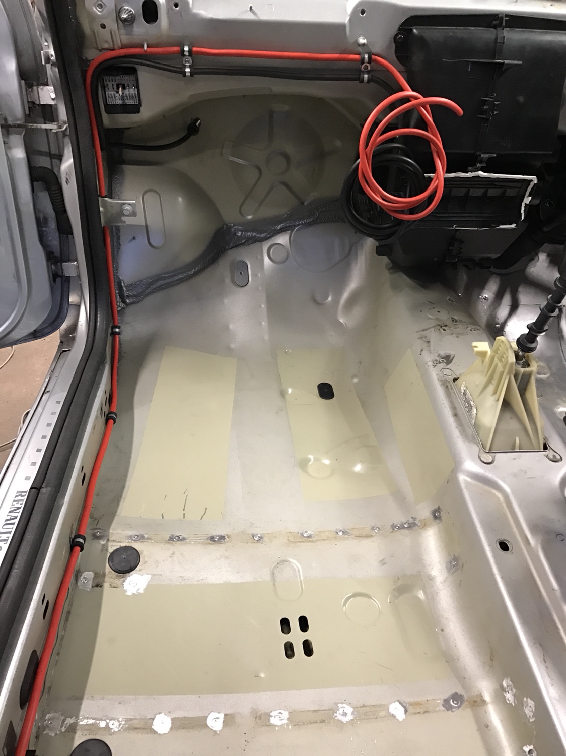

Thanks for all the suggestions. I'm going to mount it like @John Lindsay and @eon172 have done it :up:
Just remembered, that's an old photo of mine, as later on I modified it to move it as far back in that foot well as possible, similar to John's. Reason being - to allow me to get the passenger seat as low and as far back as possible.
