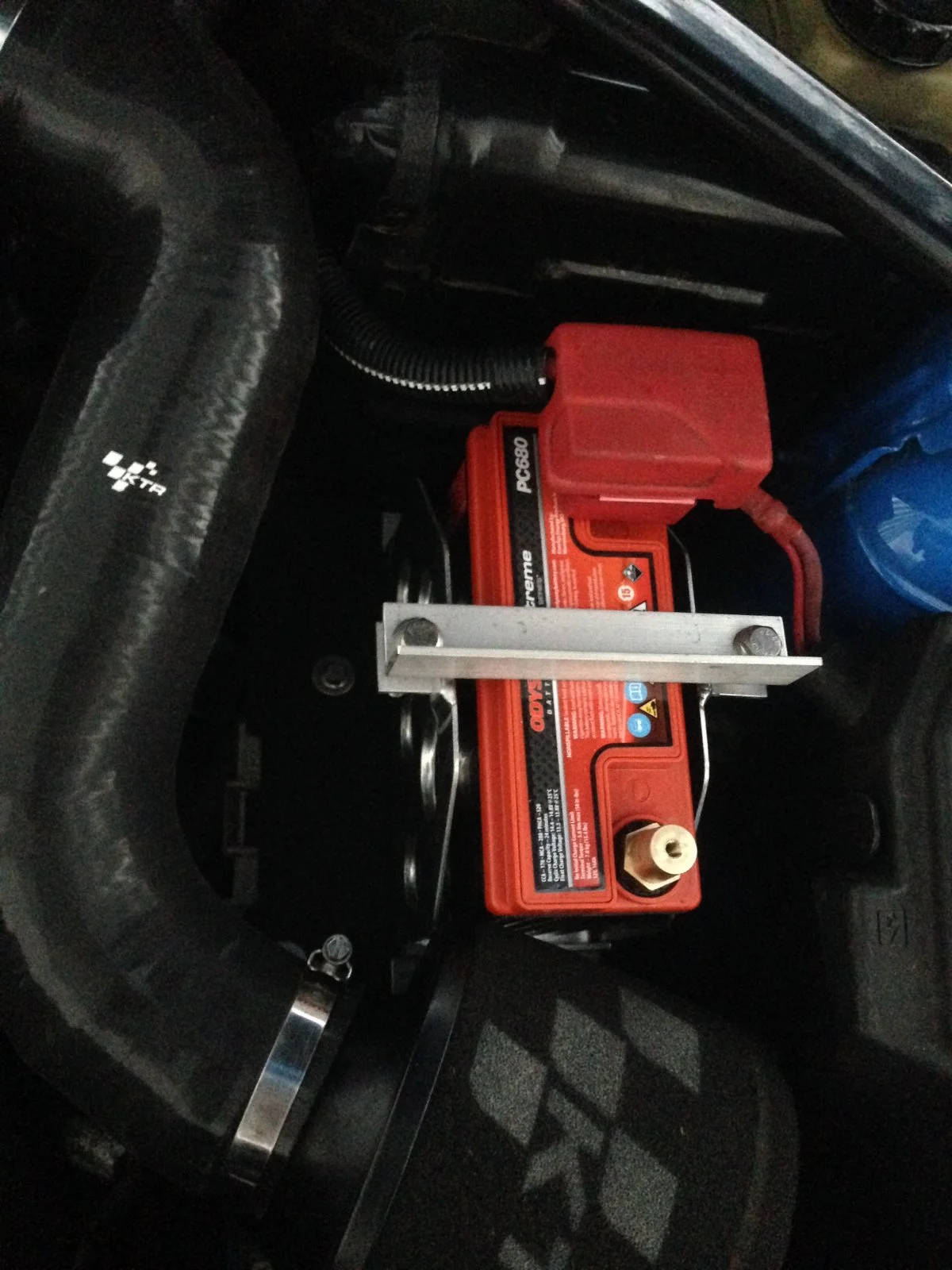

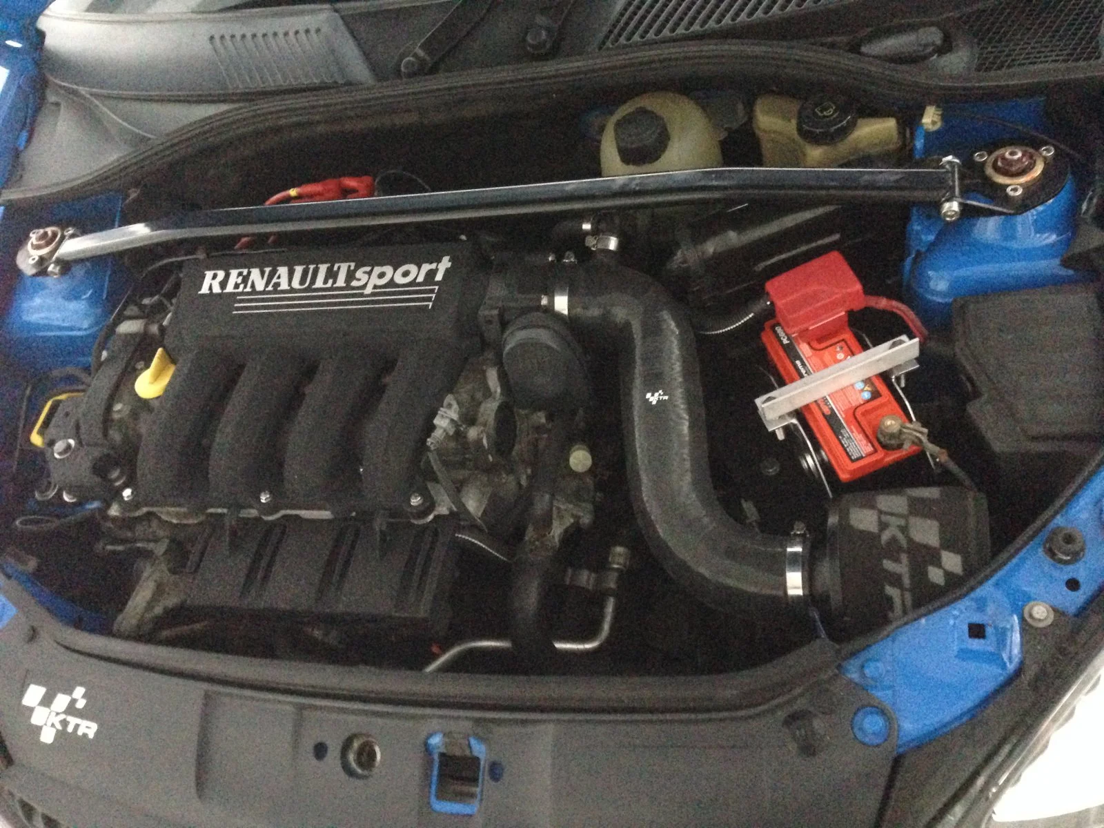

Oddesy 25 for me :)

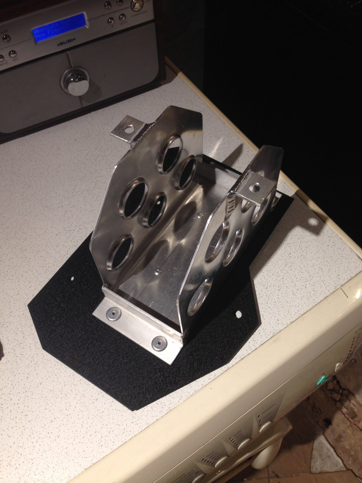

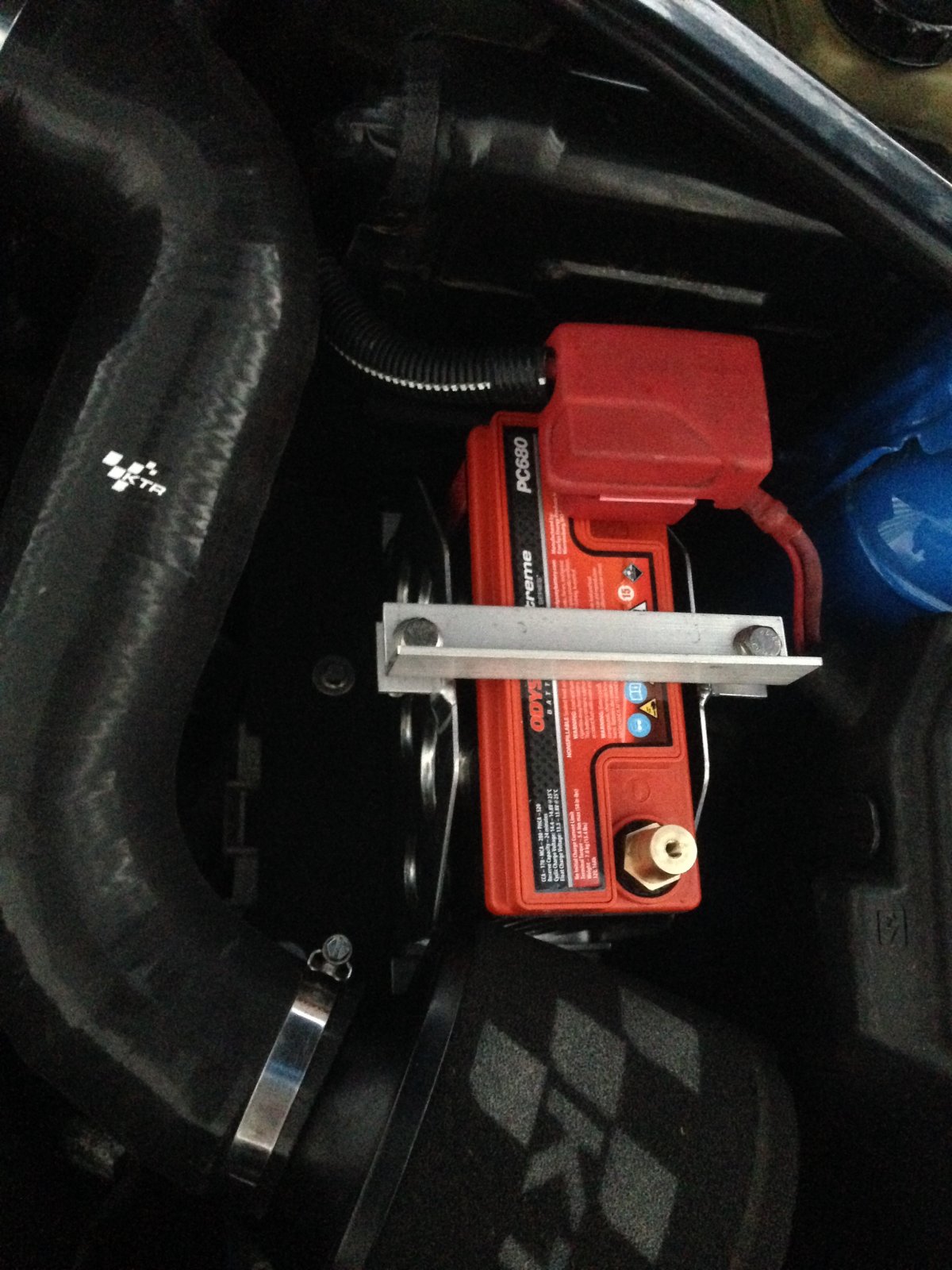

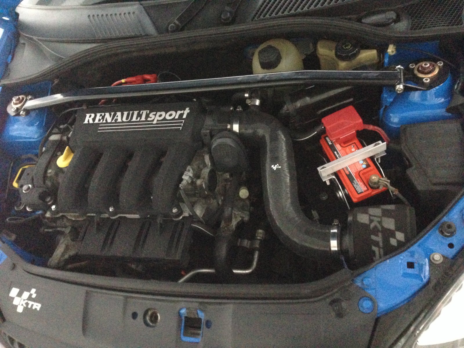

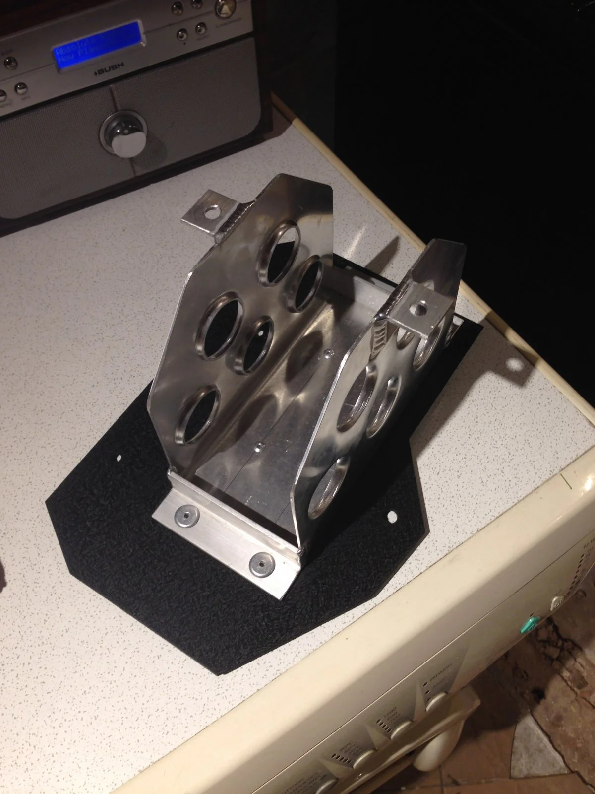

I made a plate for the bottom to match the shape where the old battery goes out off 3mm aluminium from eBay, and I bought a cage to fit the battery from a company online ill see if I can find what company later, then I pop riveted the cage to the plate, all in cost bout 40 notes for that set up but looks stock so I'm happy with that
I've got the same to mount, did you use the odyssey terminals to connect to standard wiring? and what cage did you use? i'm keeping o/e location too for ease of fitment tbh
I used fittings I bought from demon tweeks, think they had a m6 thread bolt and then they just screwed into that, have a look on there web site they only do the one kind and that's the ones I had
Pure Motorsport I mean how much cable do I need to relocate to behind passenger seat ?

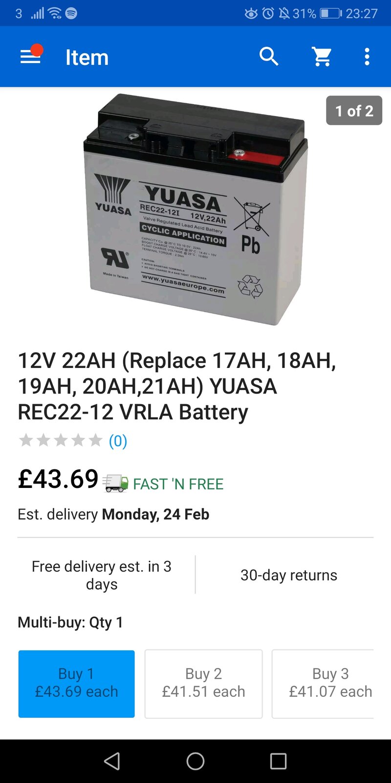

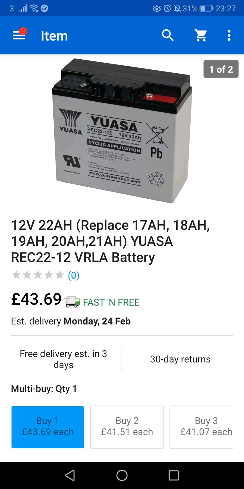

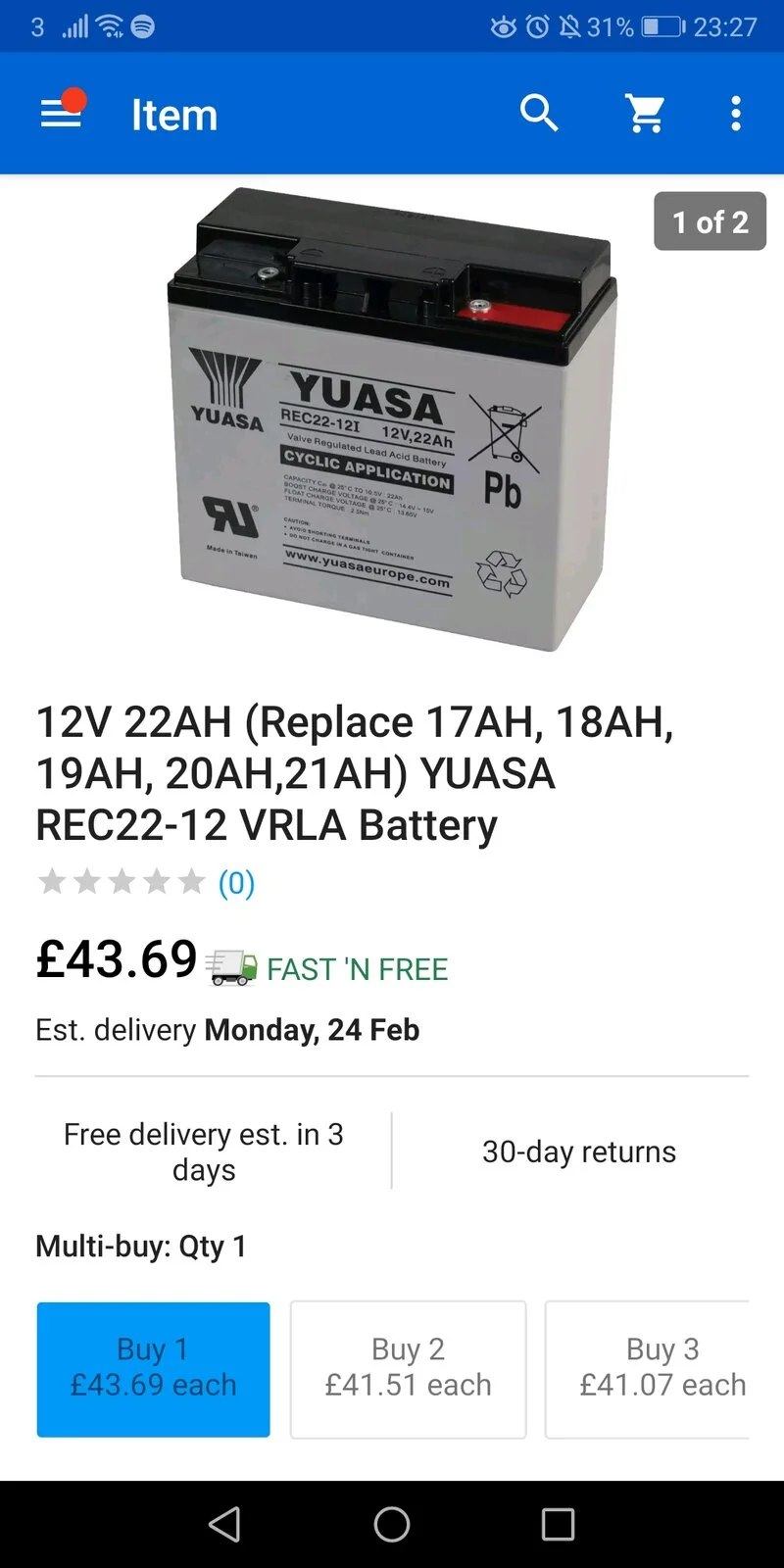

I'm using this mobility scooter battery in my type r engined mr2. Cranks the engine over ridiculously fast, is nice and cheap but I can't confirm what it's like over time as I haven't run the car on the road yet.
YUASA make some good batteries so longevity should be acceptable,I have used both myself and the odyssey is superior I'm still on the same odyssey battery now for the last 5 years, the trick is to charge them when required with a proper AGM charger or trickle charge them and they will last.SJ.
