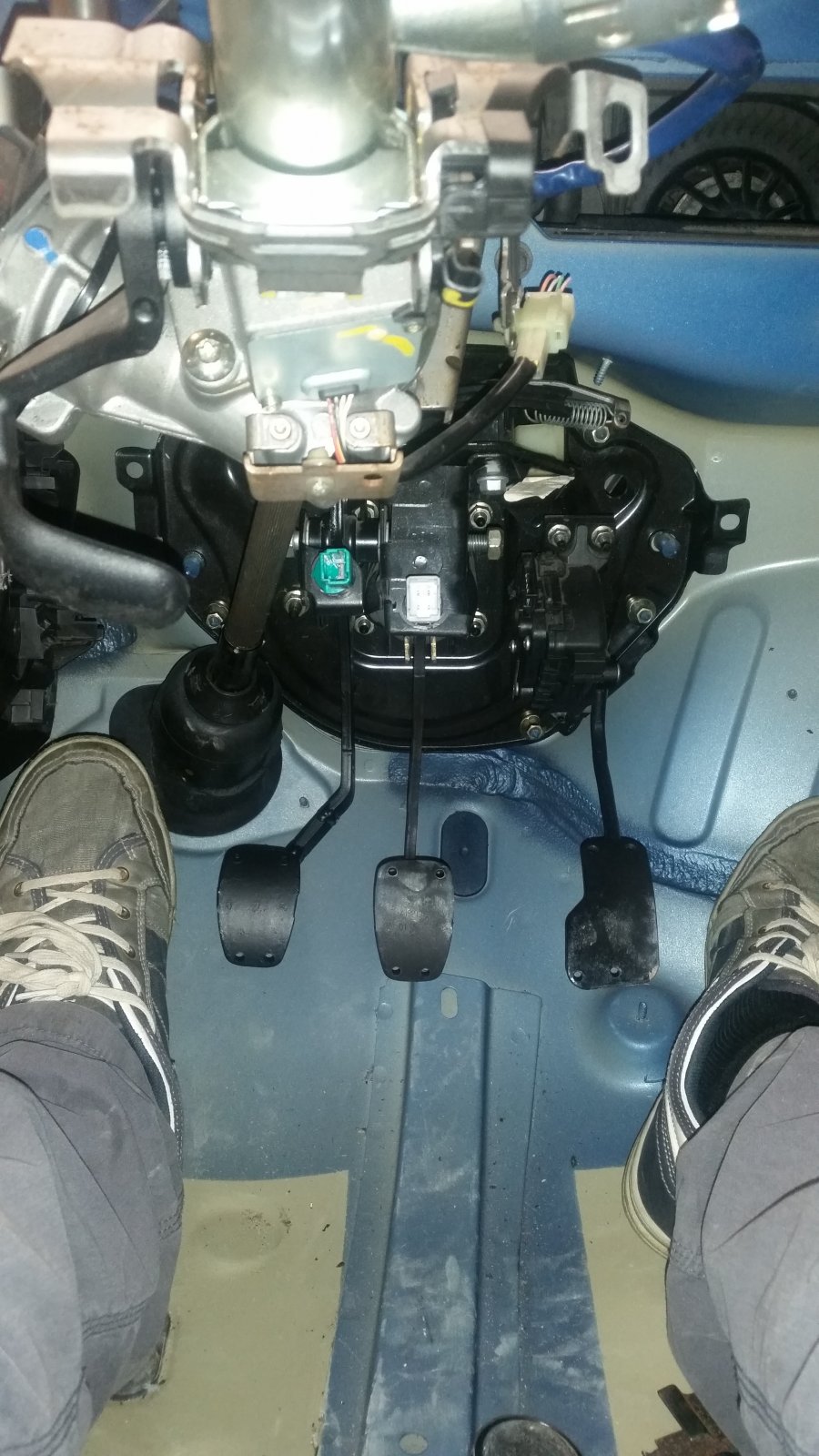

I have welded in seat bars and a fixed bucket seat, the seat is central to the steering wheel. The Clio's pedal box is offset to the right about 50mm, Renault designed the car to be LH drive and never bothered sorting the pedal box position to suit RH drive cars.
Just need to learn to deal with the pedals being off centre

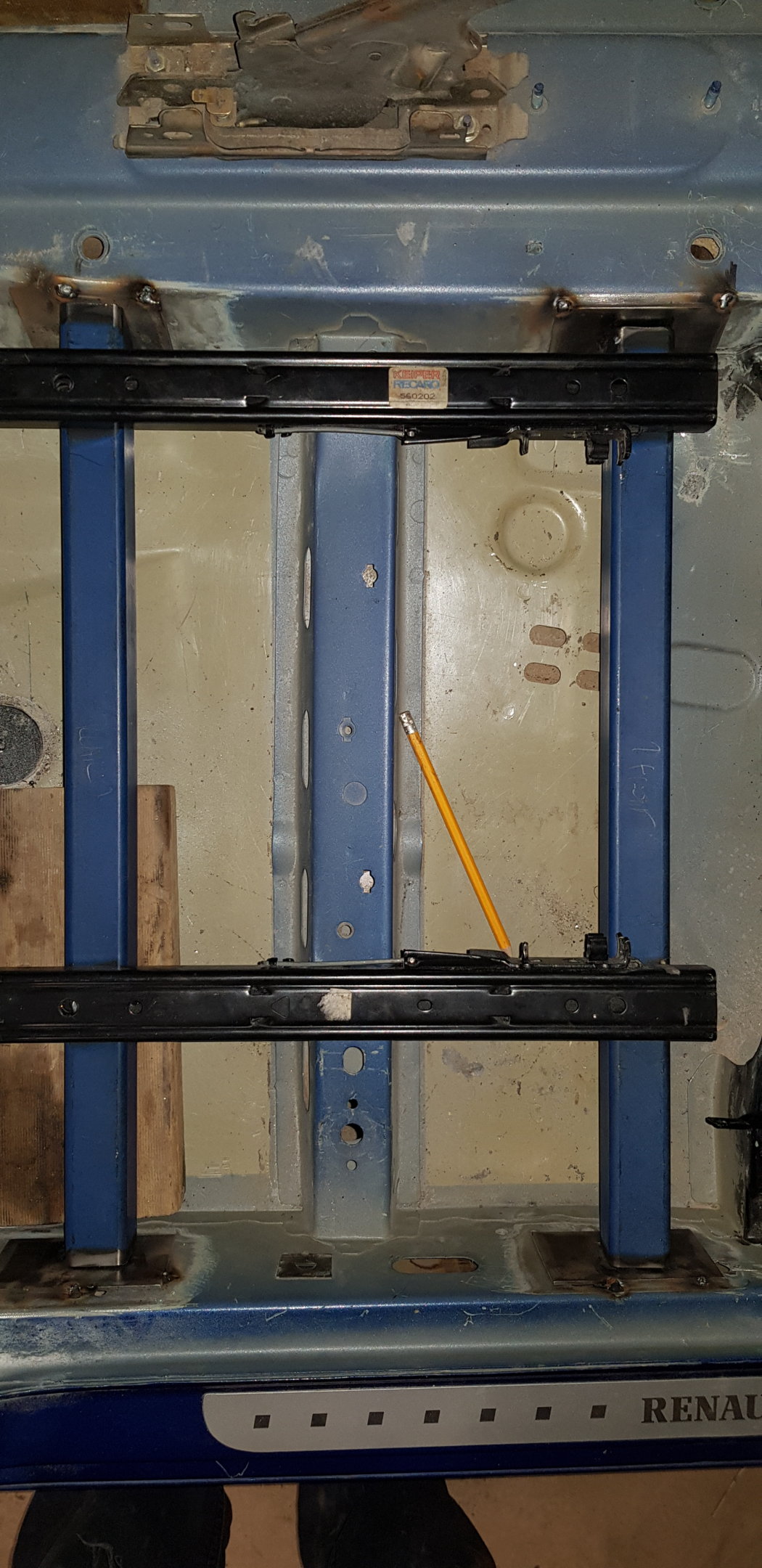

Heres how offset the rails will be to centre the seat to the wheel. The blue bars arn't welded and only roughly in position. My right leg when straight is between throttle and brake and my left sits naturally between clutch and rest. So feels comfortable but its a long way over to left foot brake. Ive had to use adjustable rails as my son races the car and is only 13. Whats the opinion
Set the seat up central to the steering wheel and live with the pedals being offset. Or you can remove the pedals from the pedal box an modify them to sit central to the wheel
That looks great. I've welded my mounts to suit centre of wheel and will look into sorting the pedals out afterwards.
