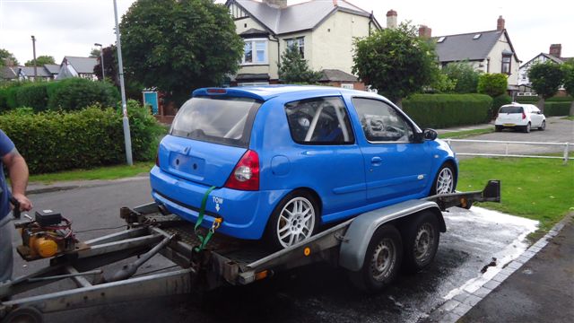

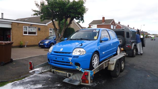

After 2 years the car is finally moved!
The car is going to Fred's to sort out the leaking bottom end and for a check over and then hopefully it should be on the track again next year.
  RB 182
just as I was pulling up at Freds today I knew who's car this was straight away :) Like so many on here, will be nice to see this finally finished and back on the track!

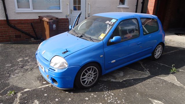

we had it in the air yesterday, oil leaking from both crank seals and the rocker cover, this engine has done 266miles, well built then!! Engine out, but not for a while yet

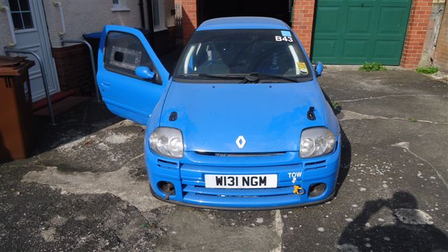

Where to Start with this then...As the Thread title says 2010 updates, well that was a long time a go, and its taken till 2014 to sort this out.
Im not going to go back through everything in detail, you are more than welcome to read the thread.
In simple terms, we had a perfectly good 200bhp + ITB'd clio, but then got bored and decided to build a fully forged ITB'd clio.
The engine was built had some issues, the car was mapped and never ran that well.
Back in 2010 we were set to do a track day at croft in the car, did some pre checks found some oil leaks so parked the car up in the garage and there it stayed for over 2 years.
The opportunity came some time last year to get the car to Fred to have a look at the issues.
Fred has ha the car for the last year working on it on and off in quiet times to fix the leaks.
I picked the car up from Fred last month and although their was no leaks the mapping was miles out and the car hardly ran. So i had the car taken up to Paul at RS Tuning, when the car arrived the car was running on 3 cylinders so after a compression test the engine seems to have low compression on cylinders 2 and 4. Paul did a great job mapping the car for us and its running better than it ever has before, it even idles on cold which it has never really done.
Having spoke to Paul we are going to run the car as is see if the compression gets any better with some miles on the car, if it does not we will have a new bottom end rebuilt over the winter time and then hopefully the engine will be solid.
We still have a lot of electrical bits to sort out and lots of bits to make nice and do better especially on the inside, but to have this car back on the road is brilliant, it is very fast.
