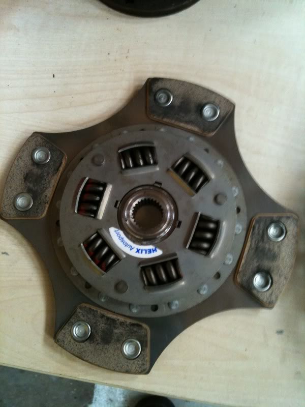

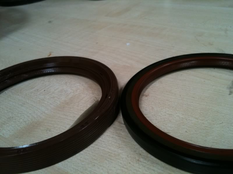

I provided Craig with a genuine renault seal kit.
This is the seal he removed compared to a correct one (correct seal on right)
and the clutch
As said, Craig looks like he has got his act together so credit goes to him. Not singing his praises yet as the car is still in Wales but so far he has surprised me.

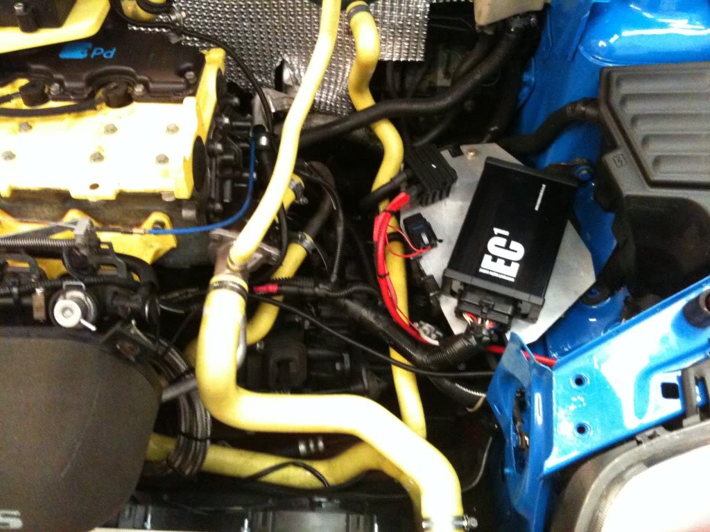

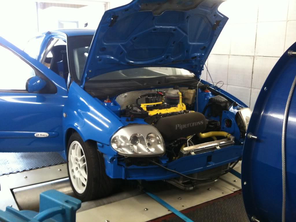

The work by Tour-De-Force has been completed. Its had a new EC1 ecu + cal, Renault ecu removed, engine bay loom separated and removed what wasn't needed, control box wired up, DASH2 fitted and calibrated, heated windscreen wired up and much much more.

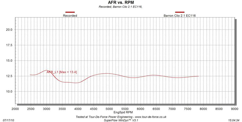

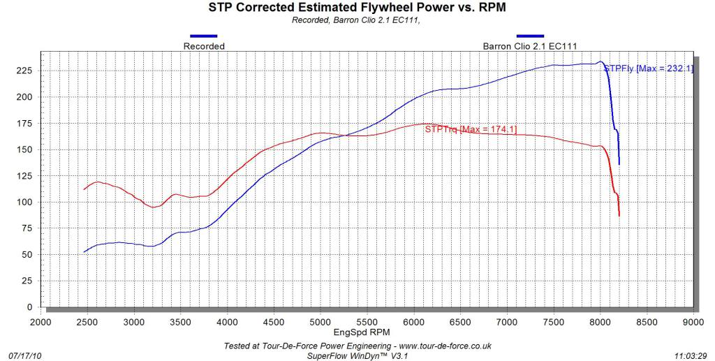

The car made 232bhp and 174ftlb

torque is impressive over 150 from 4-8k!
suprised it didnt make more power tho tbh... and how come they didnt take the filter off when mapping?

My thoughts on mapping with the filter off was that the fans can only spin a 40mph wind so mapping the car with the filter off was helping the high speed mapping. Could have completly made that up i'm not sure lol
why?
well if mine was being mapped i would want it mapped as it will be run, bit stupid taking them off for mapping then running them with on for all the track days?
bit like putting a straight through exhaust on for mapping then, fitting the normal exhaust on?
both would stupid ideas
IMO :D
Bang on correct.
Filters affect delivered air mass and as such the filter setup the car will run 'in action' wants to be present during calibration.

260bhp/ton makes the car 890ish KG
I would have thought it would be been a bit lighter than that?

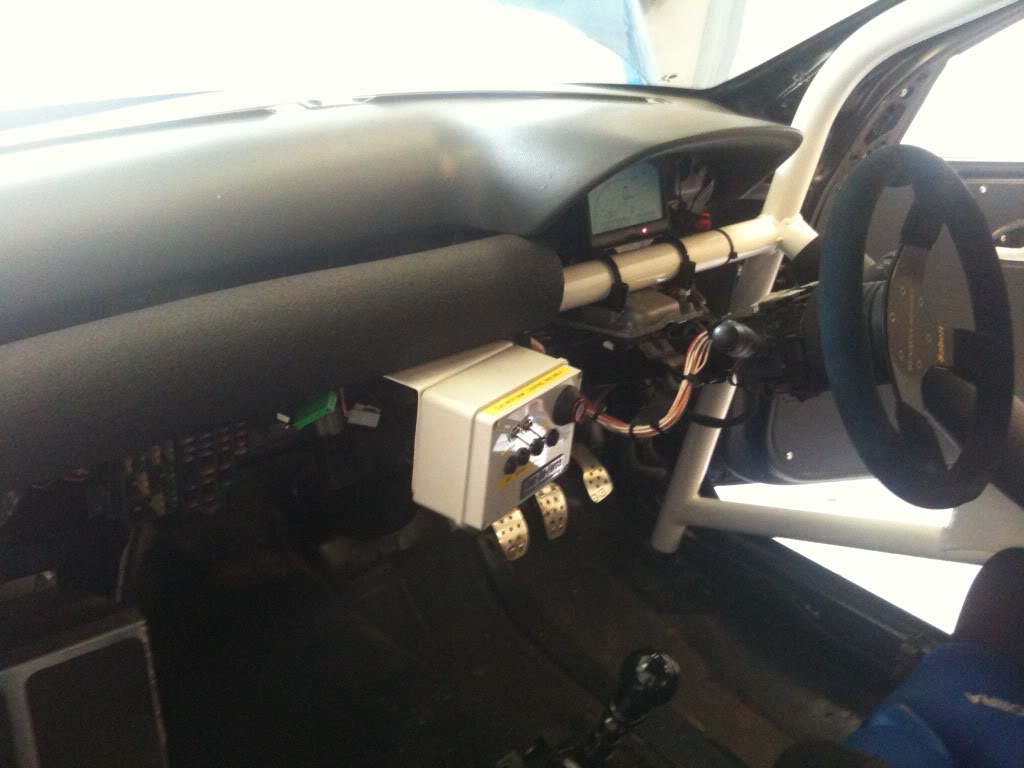

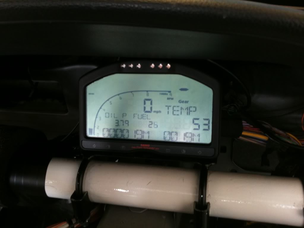

hi guys, can you please tell me what dash that is? it looks like a lower spec mark 1 dash
if so can you give me some details on how hard / easy it was to fit etc.
thankyou
Barron
  Turbo S,Exige,R5,182
Yep, as f0xy said its from a low spec mk1. only cost £9 on ebay :)
Fits well actually, had to make a couple of brackets but fairly easy fit
Barron
Not at all mate. I'm surprised more people haven't started using the mk1 dash in mk2's. If you need any other info either post in here or PM me.
