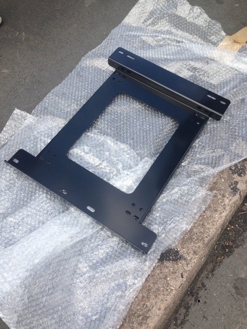

I can supply you with my VBD Clio X-Low subframes.
Jon
Are these compatible for racing ?
Also do you have any pictures and prices please ?

Take a look in the " group buy " section in parts for sale at my thread.
A few members have put pics up showing them fitted.
They are as low as you can possibly go.
Price is £130 for two subframes collected or £16 postage.
Any fees to be covered.

Thank you very much I shall have a look on the group buy now they look a real nice piece of kit

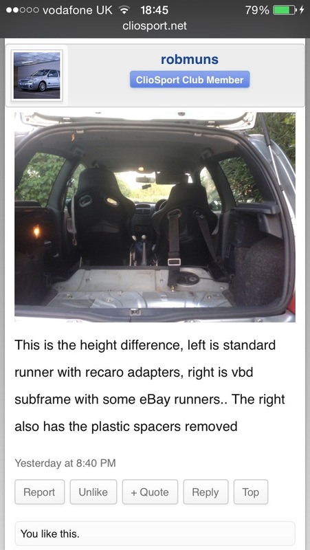

My VBD X-Liw subframes are actually as low if not lower than the weld in tubes pictured here.
There is only so far down you can go after all.

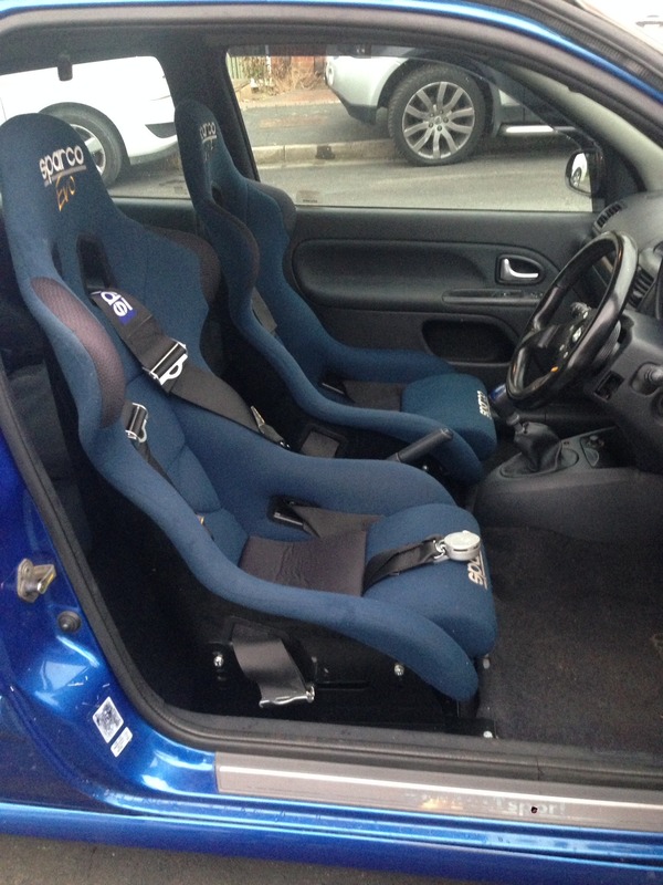

I've got the normal OMP frames and I'm happy with the height they sit at. I got them from ybracing with a discount code on their site for about £85 or something.
On the left is a base mount seat bolted directly to the subframe. The right has a slider and is a sidemount seat. I actually found that if they were any lower as Sonny suggested you might have to lower the steering column.

The problem I have is I am pretty tall and the standard seating position I was nearly touching the roof with my helmet on so I was thinking how low can I go lol. But the omp drops you down more than I thought
