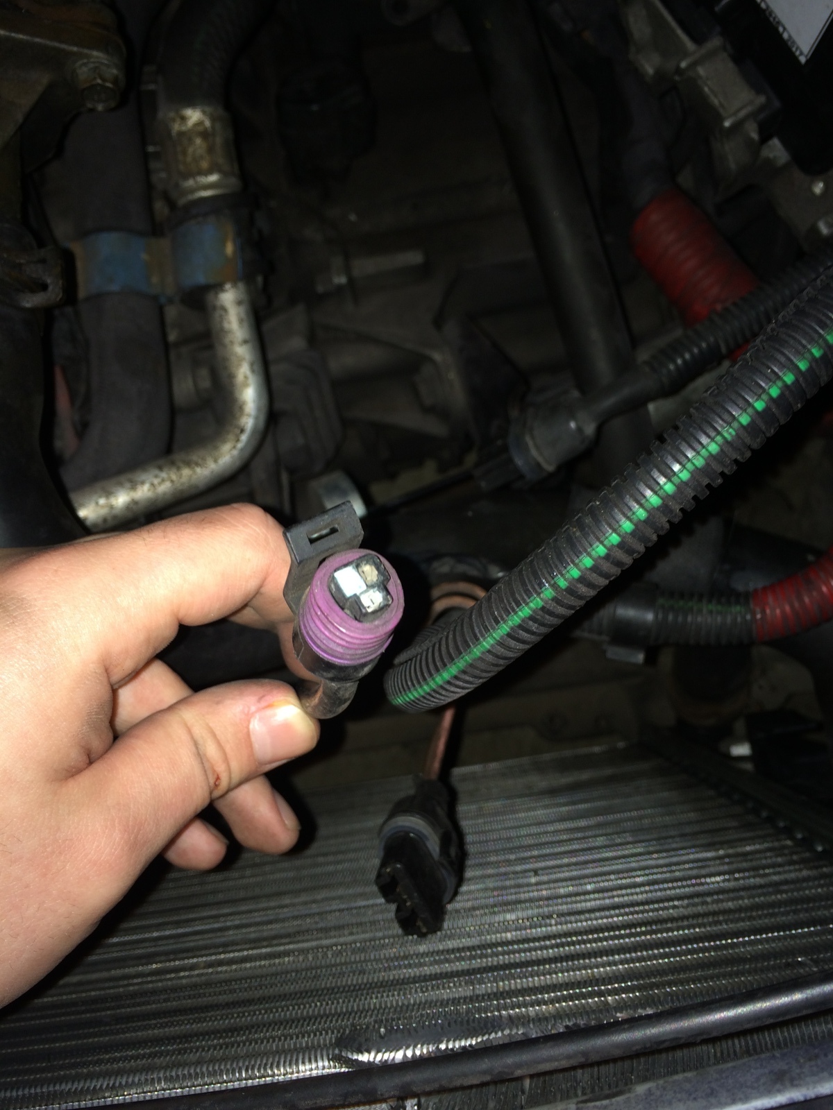

In the engine bay wiring loom there's 3 plugs coming out for the fan etc stuff. 2 of which I can see go into the fan and shroud, the 3rd however I don't know where it goes:

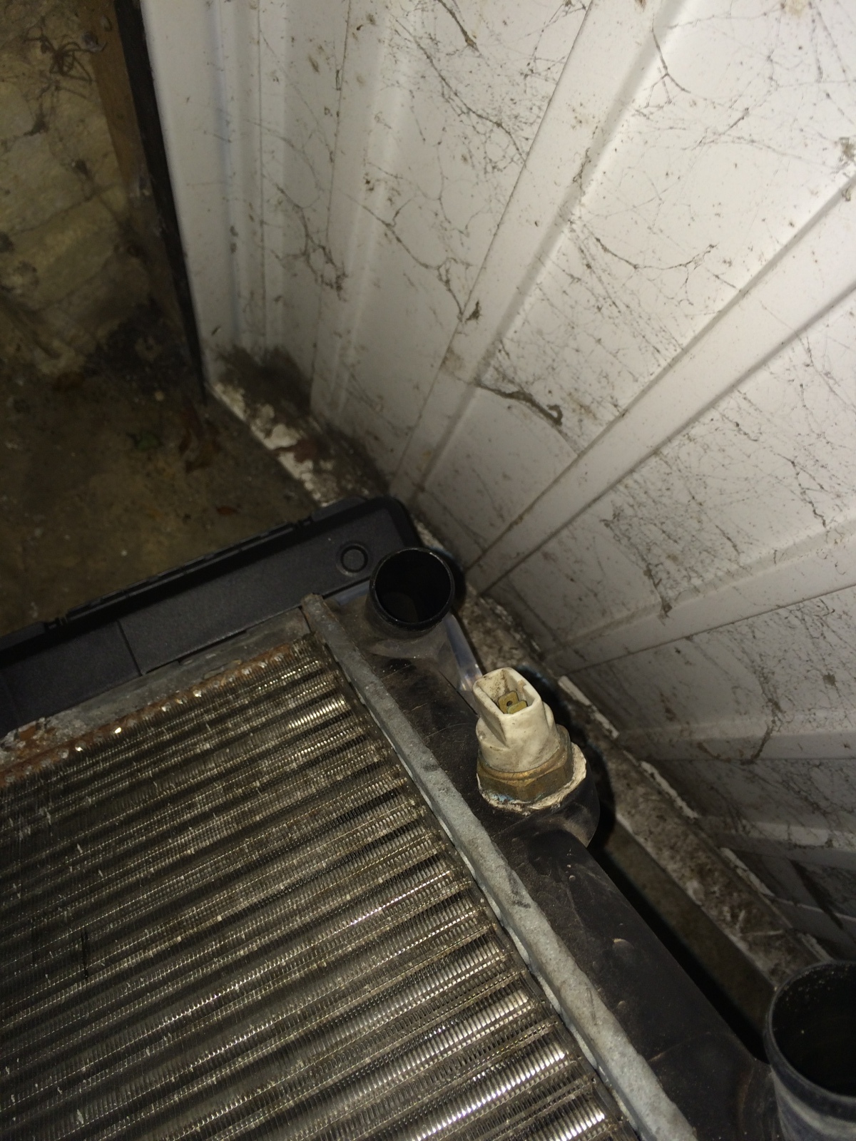

On the replacement rad there's this plug sticking out, but I have no wiring to plug into it?:

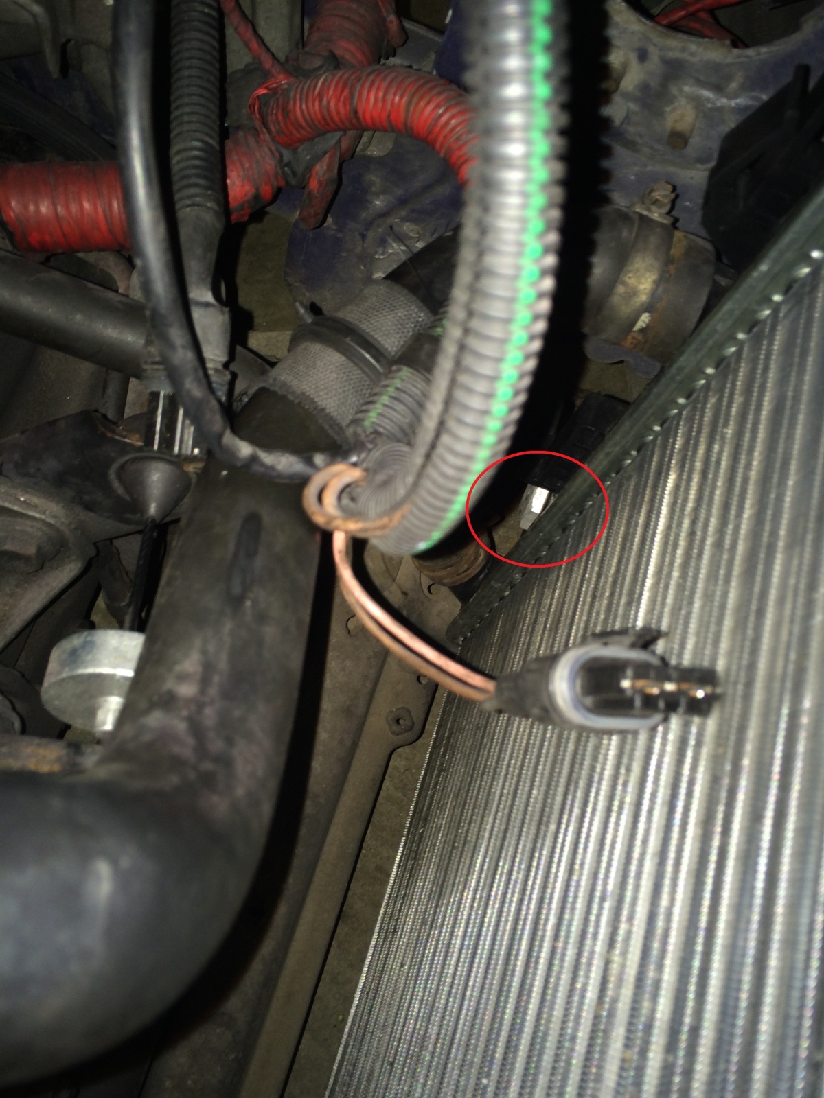

On the rad that's in there that same plug thing is blanked off with a bolt thing:

I imagine the white plug would be a coolant temp sensor, but to be honest I've not looked at the way it's setup, only thing that springs to mind is if ones for ph1 and the other ph2?

Possibly, I know mine's a ph1 non-aircon setup, and I think the car that this one came off of was a ph2 aircon model, if that makes any difference?
Is that sensor needed to tell the fan to come on..?
  Clio 172 Merc ML55
In short yes, but I believe the sports have the sensor on the side of the engine rather than on radiator, hence why yours is blanked off?
  172 Ph1
The 3 pin purple pin would have gone to the air con pressure switch , the 2 pin white connector plugs in to the rad fan motor . There is another 2 pin black connector near the purple one that would be for the resistor to run cooling fan at half speed - that's only for functioning air con system .
The Radiator is probably for different models and it serves others in the range. By the looks of it - other clios with smaller CC engines that ran the early cooling fan set-up. So the blocked off nut would be necessary to seal the system.
