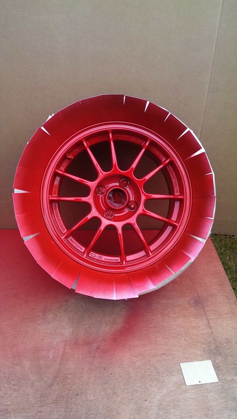

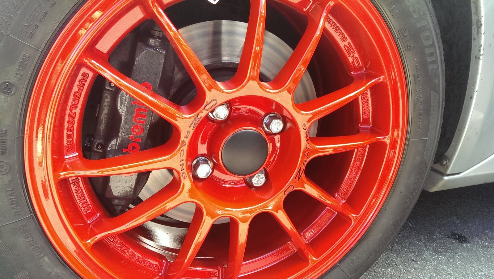

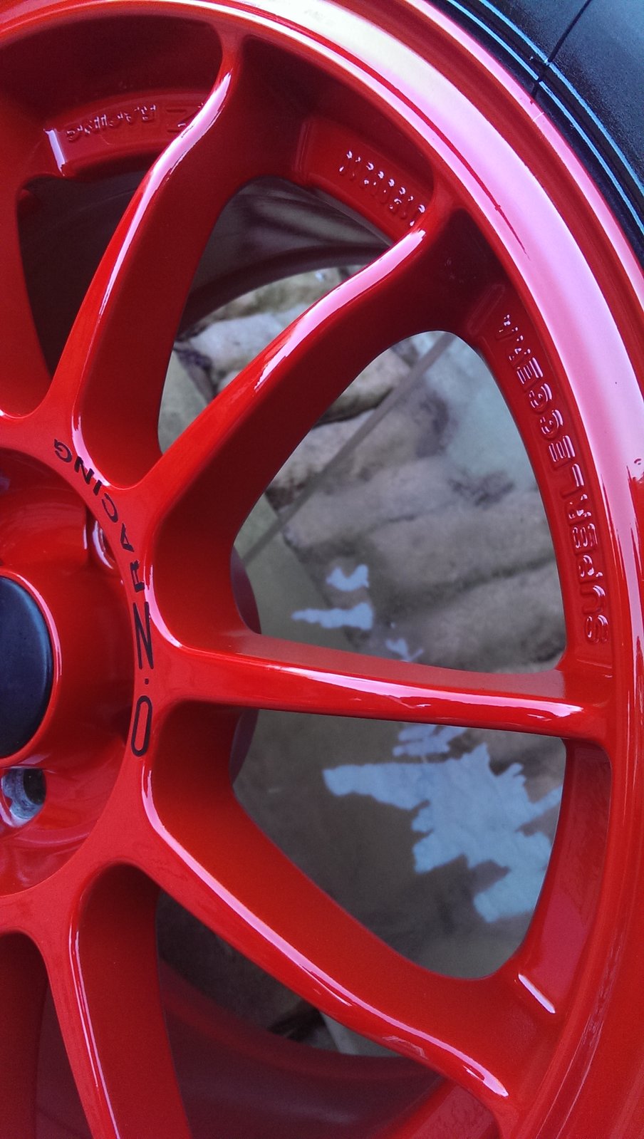

Fancied a colour change (mid life crisis lol) on the superleggeras.
so to help decide on colours i cracked the spray paint out ! Not looking too bad just 3 more to do.

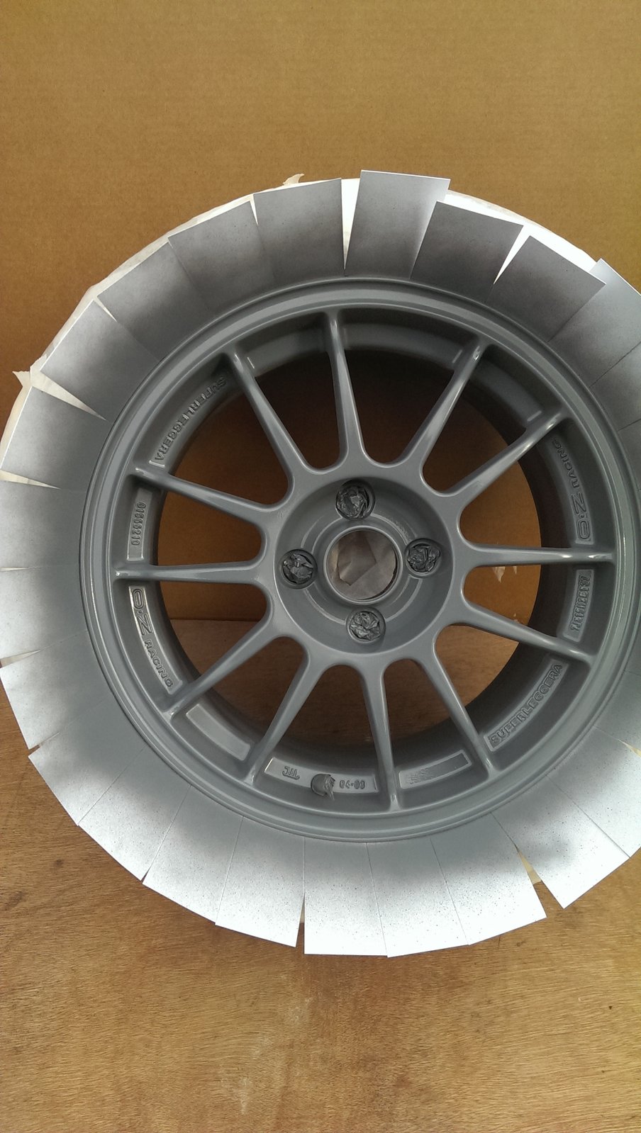

I just flatted them back using 400 grit paper then upto 800 and 1200
Used high build primer and applied around 3 coats with around an hour between each and then whapped it in the shed for 24hrs.

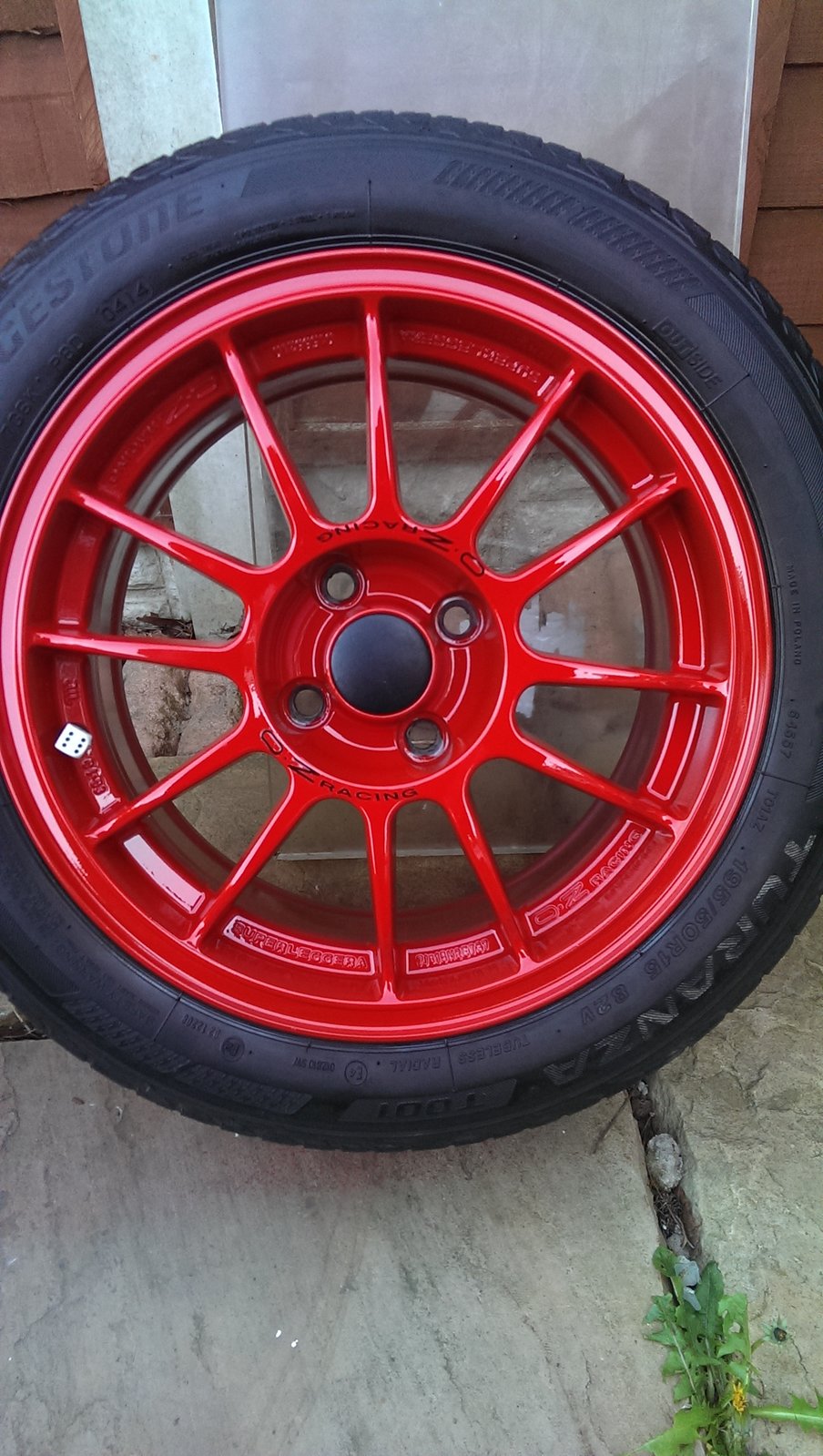

Then put as many coats of colour as i could get out of 500ml can leaving an hour between each and again left 24hrs
Same again with clear lacquer as many as i could get out of a can. Hour between coats and left 48hrs before fitting back to the car.
With prepping its taking around one week per wheel (after work)
Its hard to find that fine line of putting too much paint and lacquer on so it doesnt run and not enough so you have a rough finish.
