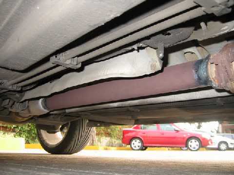

Mine did the same noise, was the middle silencer (next to cat) I went to a shop they remove it ant put a straight pipe, real cheap

You can lay down next to car, be sure that the car (exaust) is not hot, the hit wit you hand the silencer if it sound like something loose inside You can be sure that the silencer is damaged inside, I also heard about something similar with the cat, the porcelain inside sometimes cracked and makes a rattling sound
