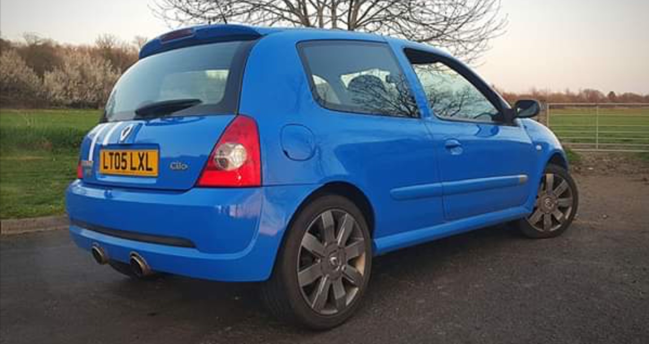

It has been suggested that a project thread on my recently acquired 182 Cup might be well received and would provide me with a reminder of the journey of getting the car back up together...

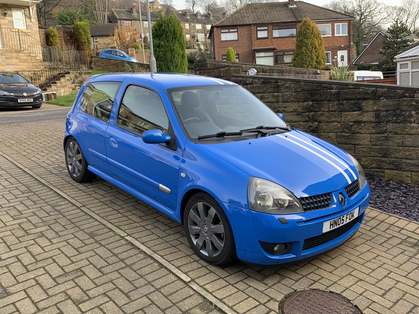

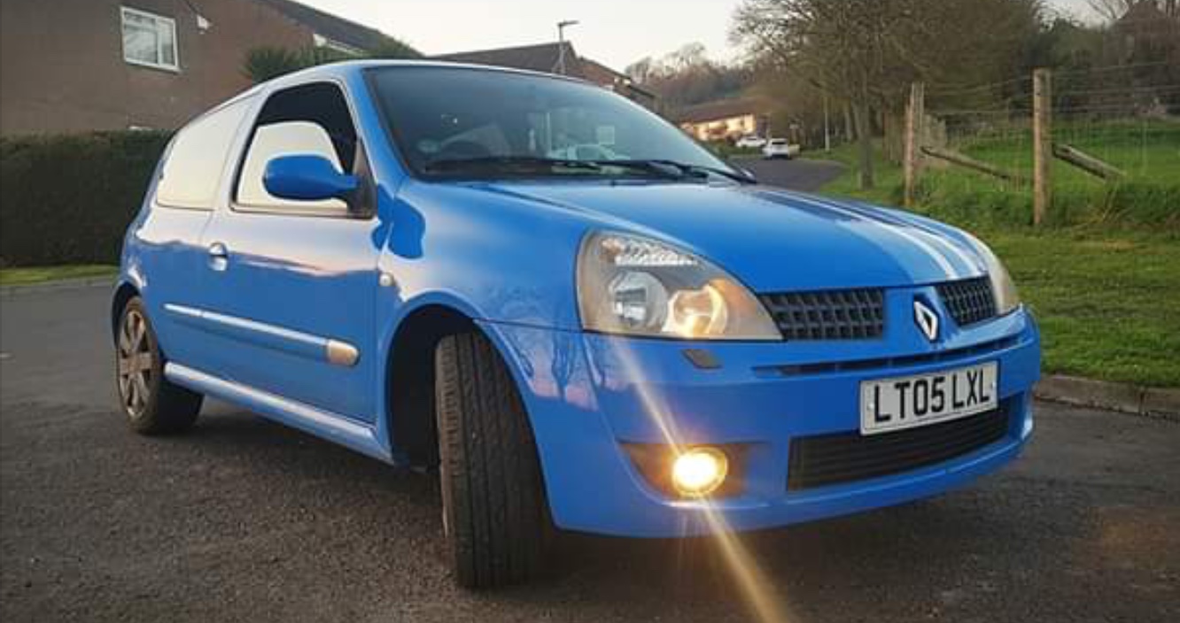

Found on Facebook, I purchased the car from a guy in Glastonbury, nice and local to me. I was looking either for a 172 Cup or 182 Cup in RB for about £2000, to help share the miles I’ve been putting on my 981 Cayman S. Anyway, here are the photos of the car from the advert:

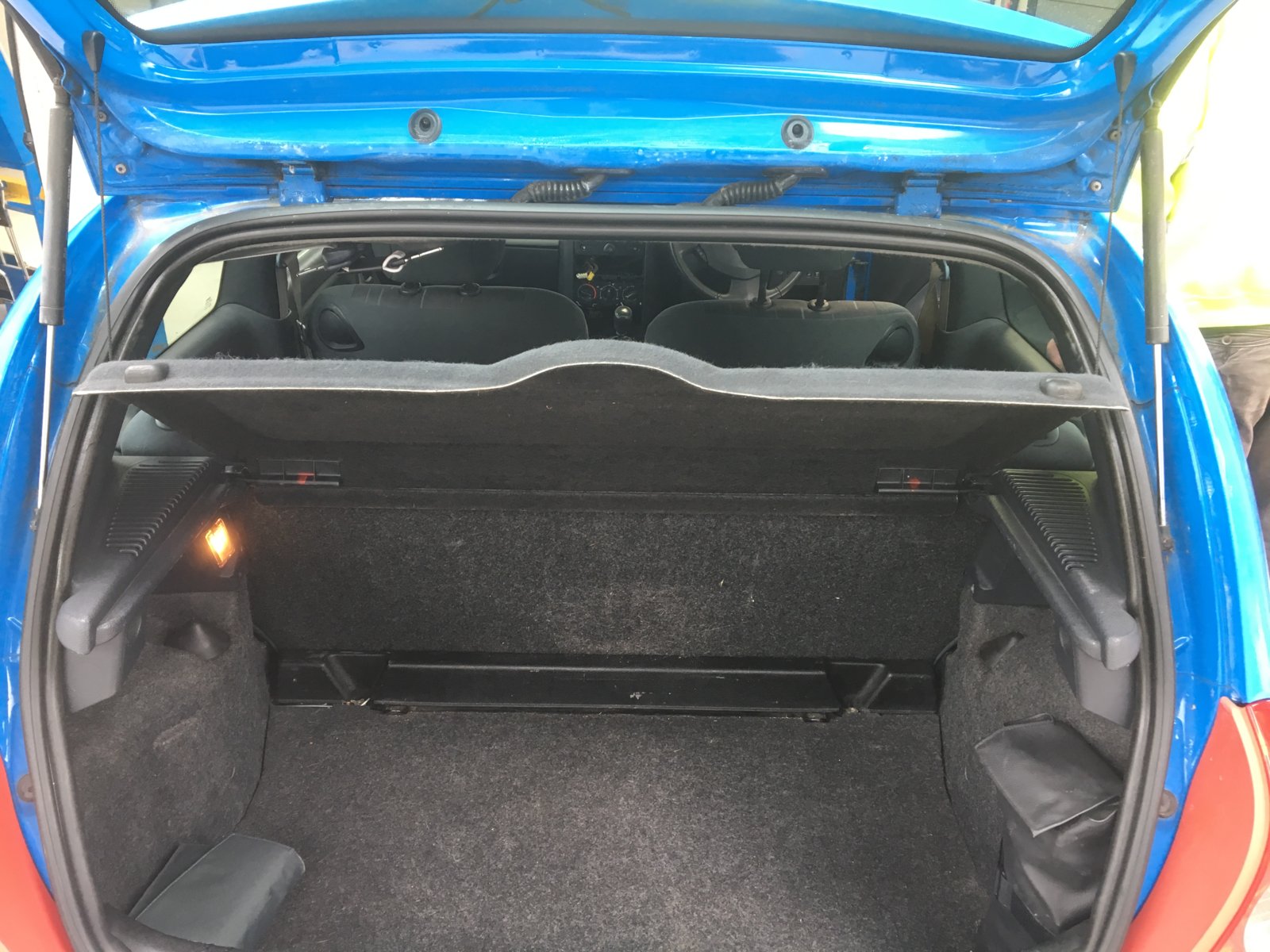

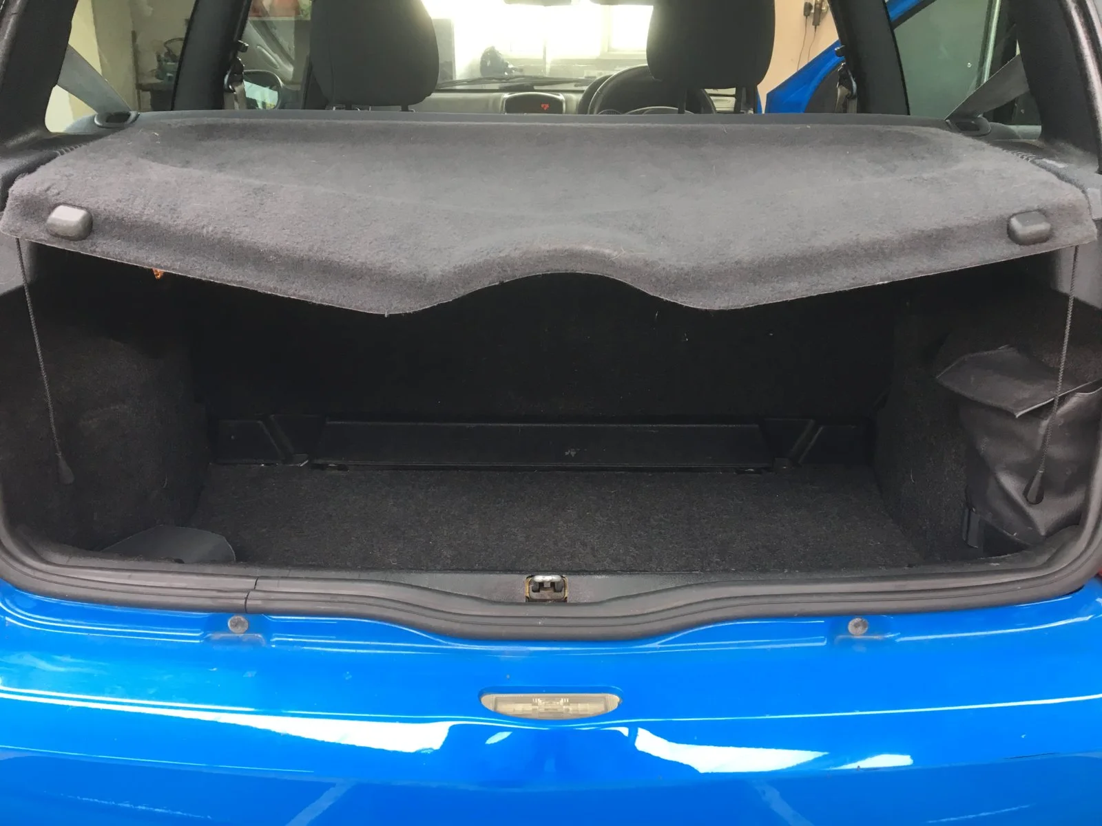

First job to be completed was the parking dents taken out by a painless dent removal guy. Unfortunately I have no photos of this. Next was a replacement parcel shelf:
1414266

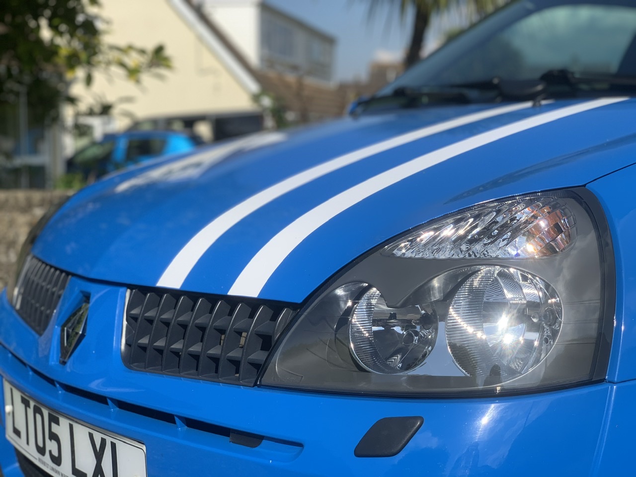

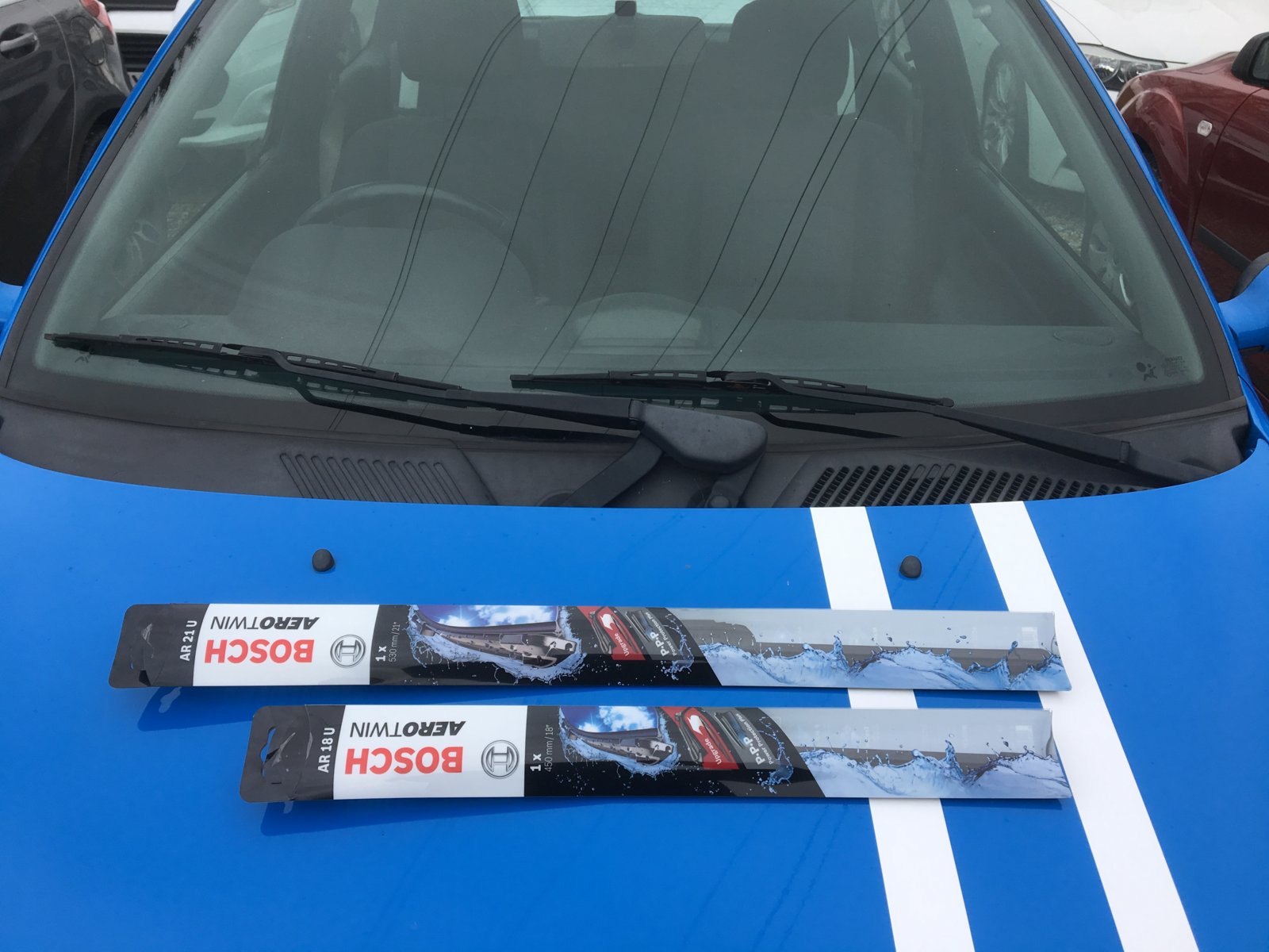

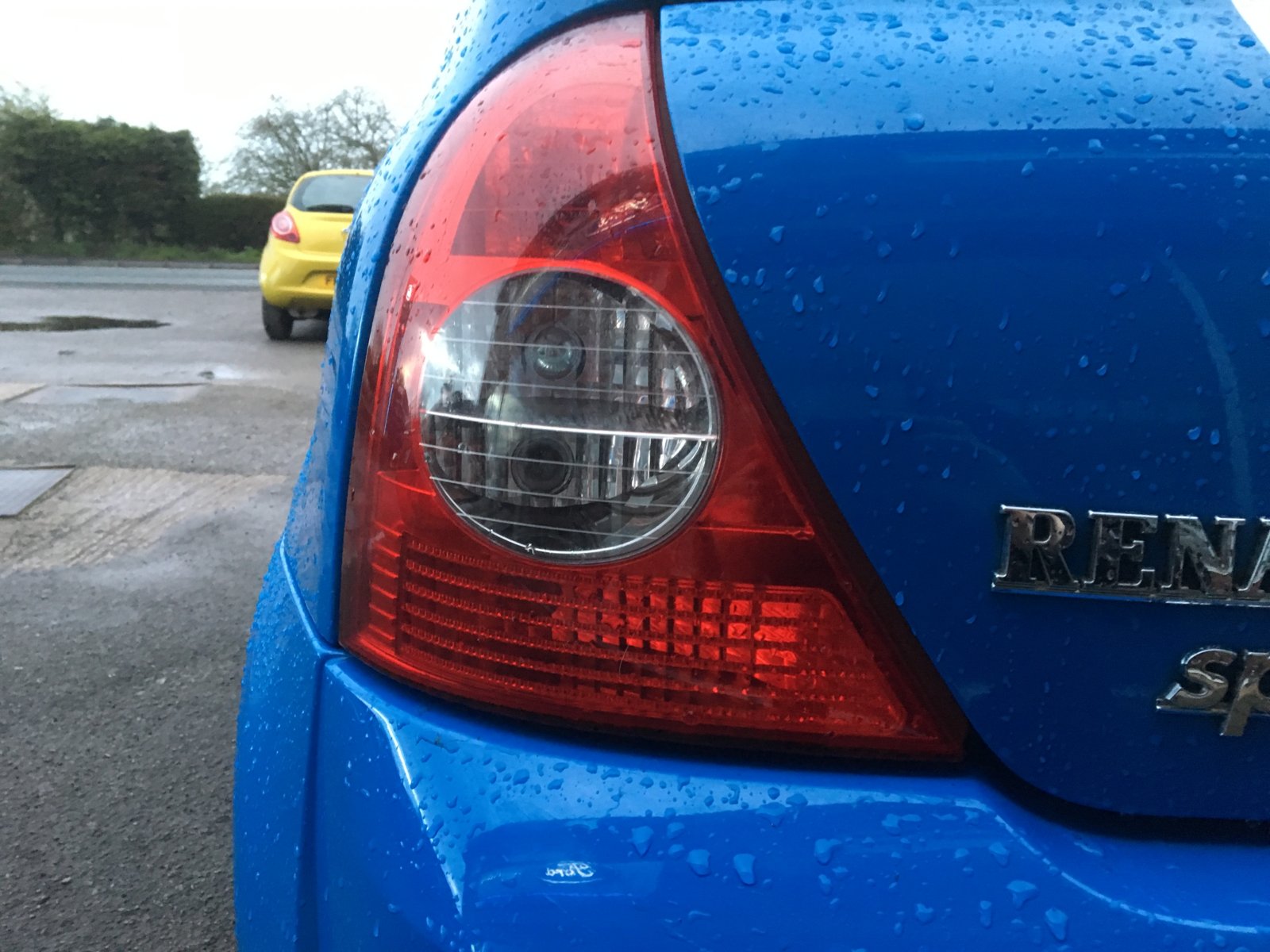

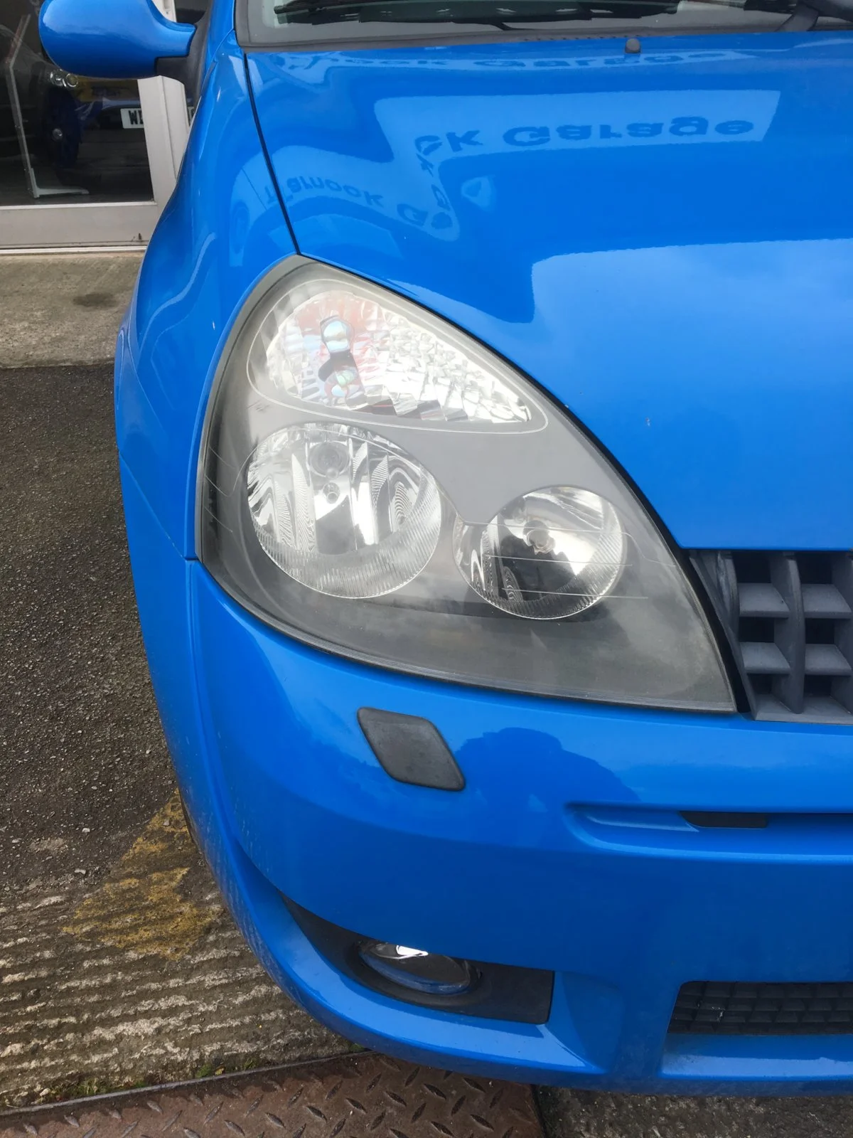

Then, some silvervision bulbs and Bosch aero wiper blades:
1414268
1414269
1414272
1414273

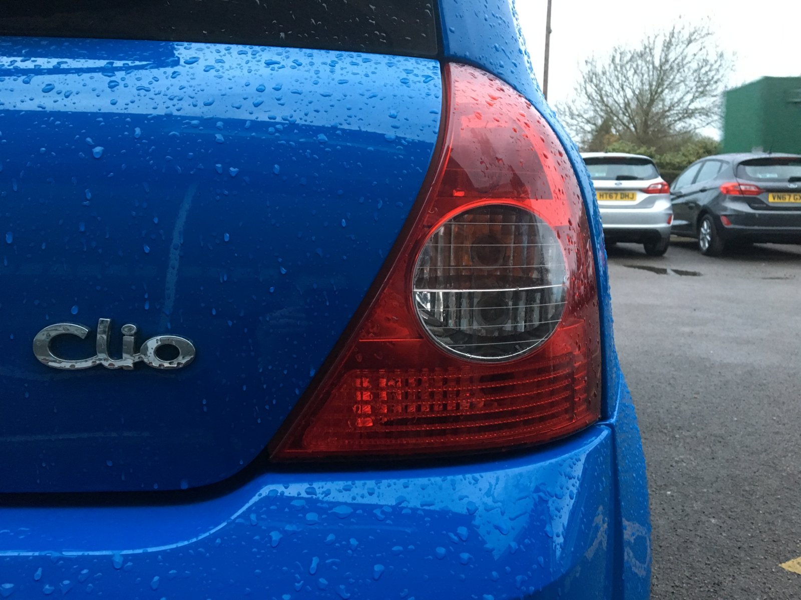

Replacing the rear indicator bulbs turned into a bit of an epic job, due to corrosion in the lamp plugs.

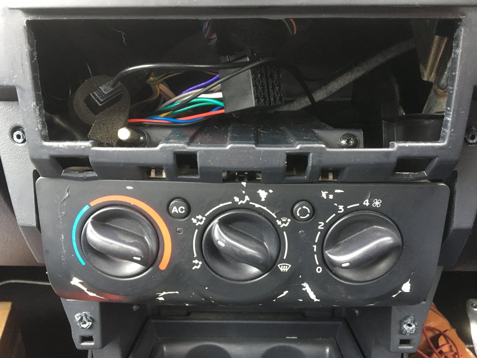

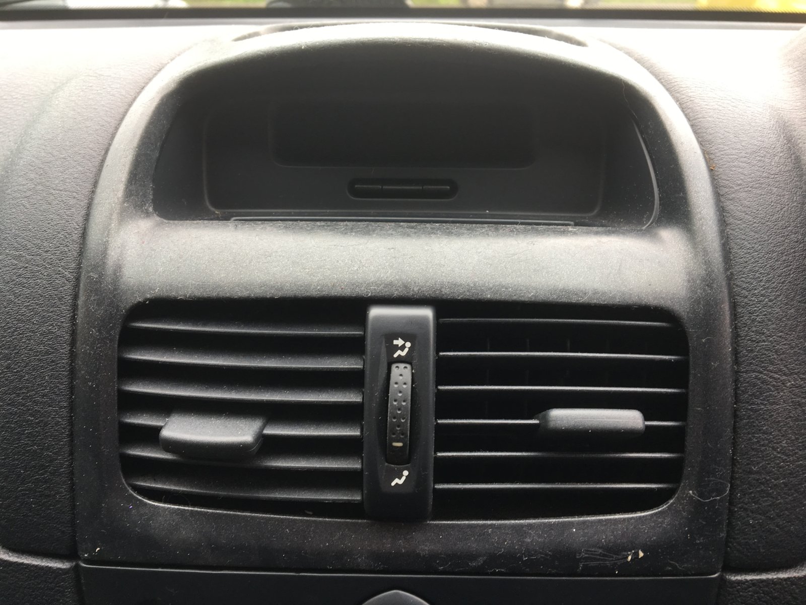

I also followed a suggestion on the forum to soak the radio screen surround in dettol to remove the sticky rubberised coating. Overall it took 2 days of soaking, I stunk the house out, but it worked! I then gave the resultant naked trim a coat of dark grey plastic paint, that is close but slightly lighter than the rest of the interior plastics.
Before:
1414274

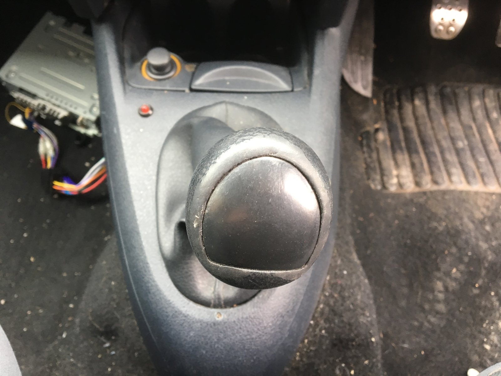

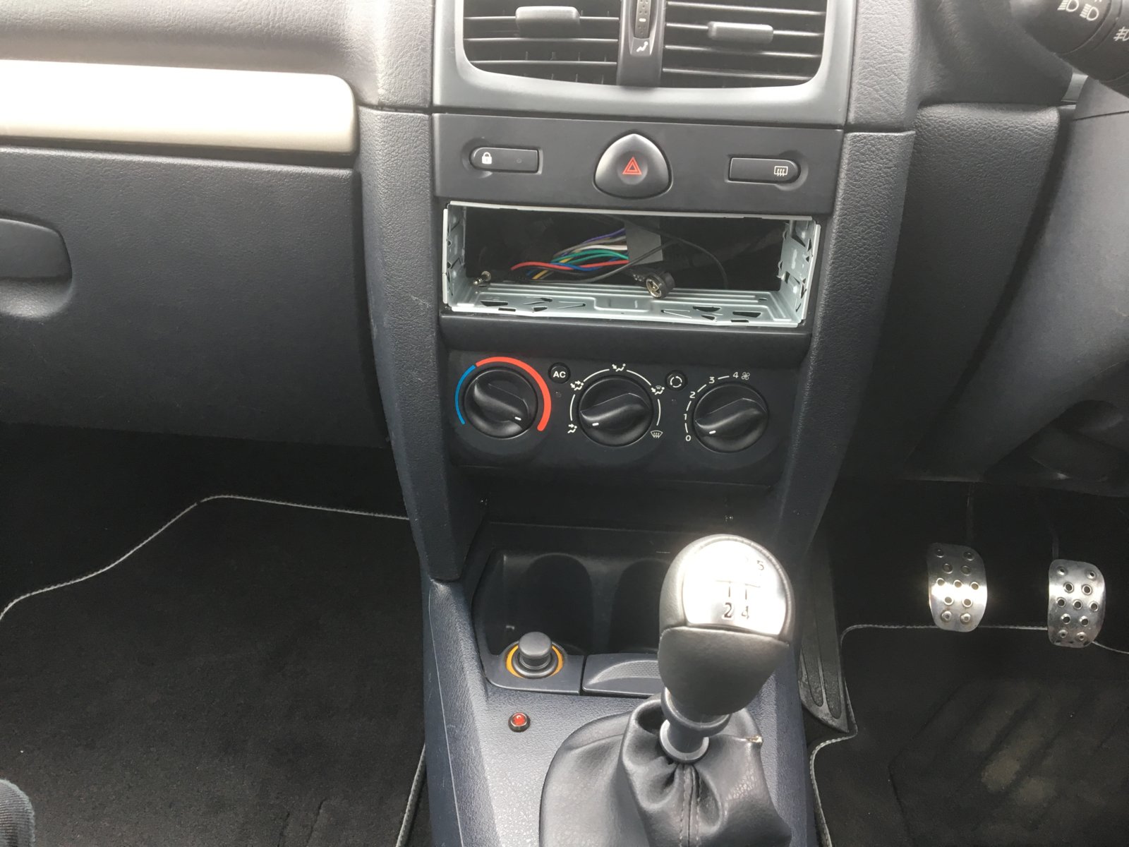

I’ve also replaced the gear knob, heater control panel and fitted the Renault Sport carpet mats:
1414275
1414276
1414277
It’s starting to get to where I want it to be now!

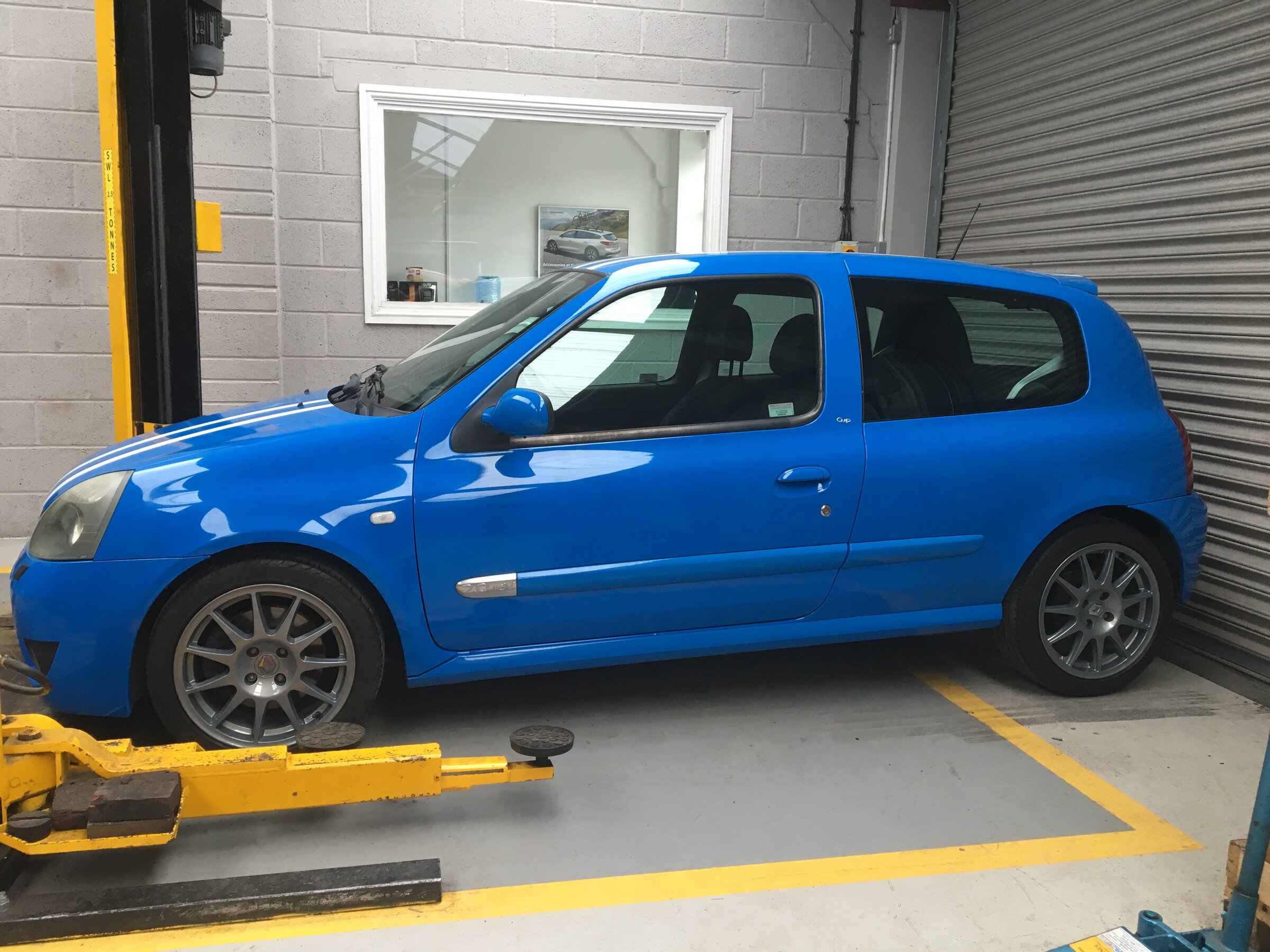

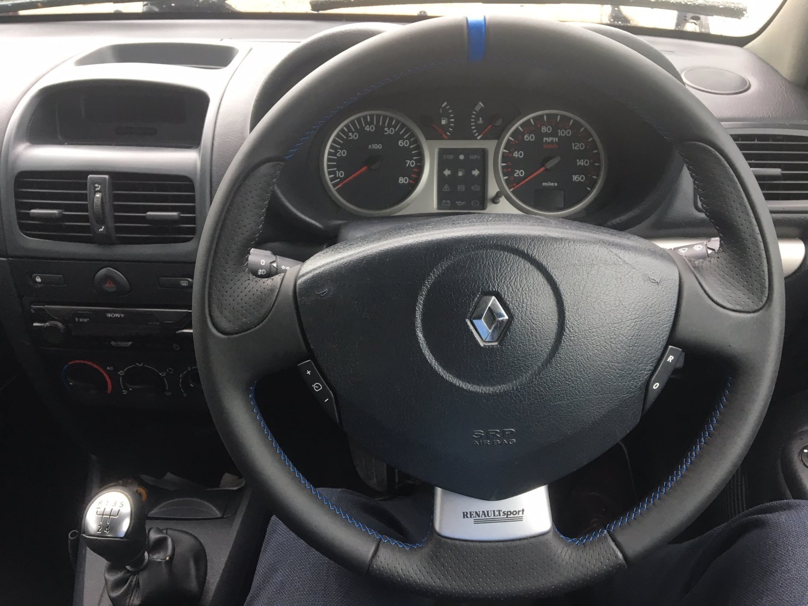

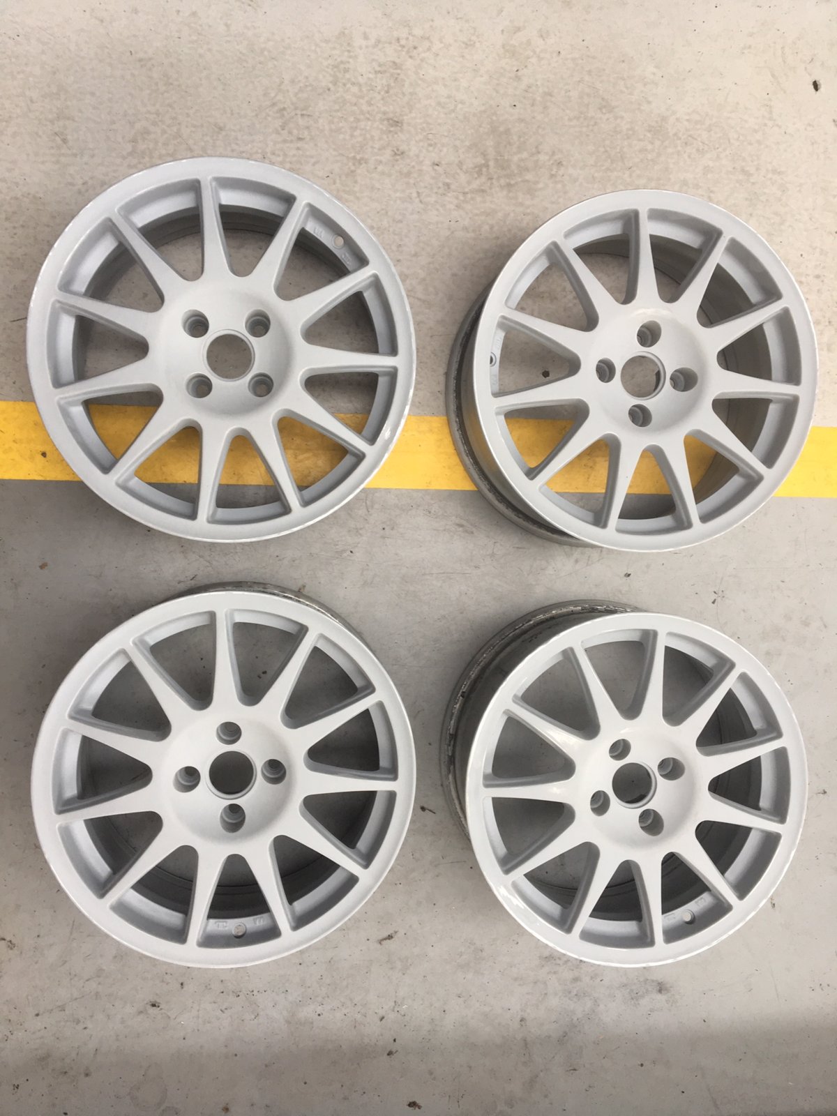

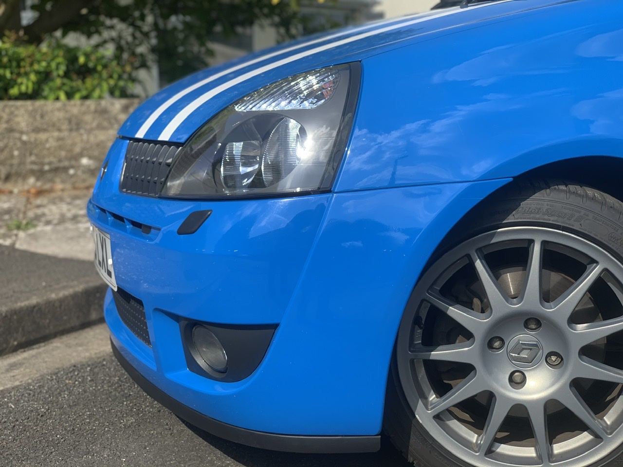

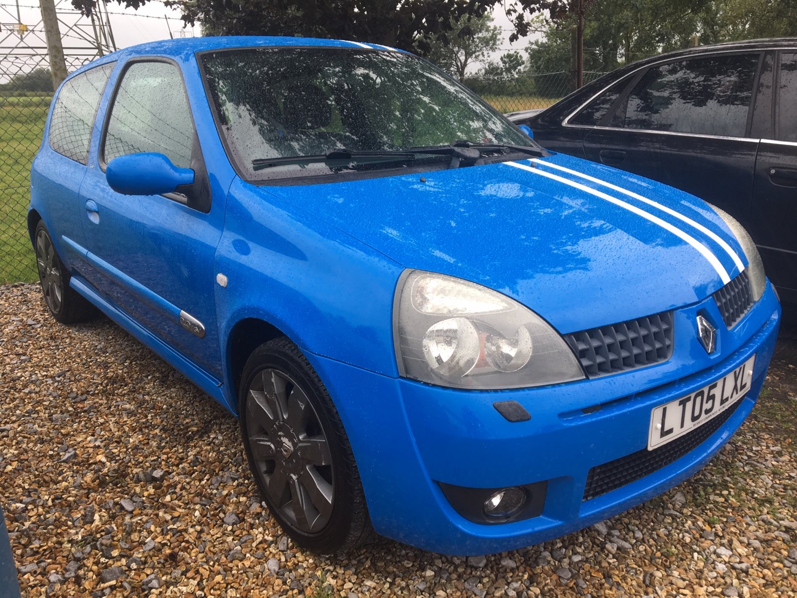

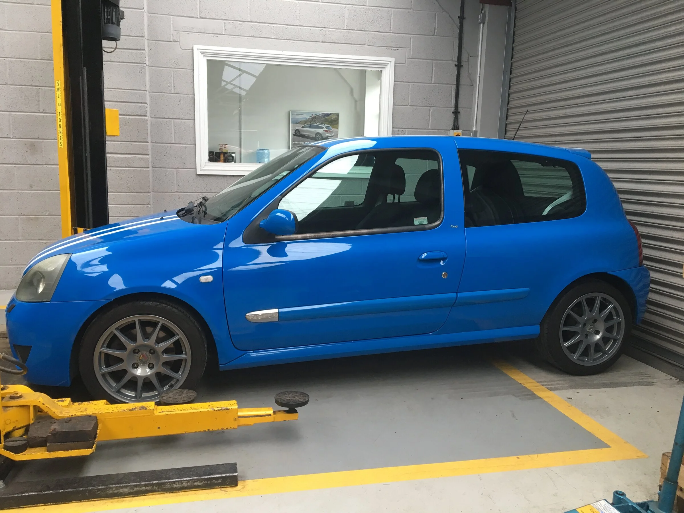

The major service is done, along with front discs and pads and a pair of OE track rod ends. I've also bought a cheap set of Turini's and I'm part way through refurbing them. Going Anthracite, but did consider white. I've also had my steering wheel retrimmed by Snappy, which has made a massive difference. Absolutely love the perforated leather thumb grips and the 12 o'clock band! Oh, and the head unit was replaced ages ago.

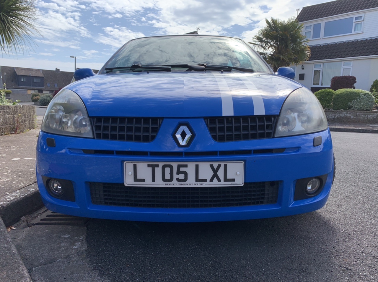

Finally, I've just got the car back from a couple of smart repairs to the front and rear bumper, and had the car machine polished as it looked like it had been cleaned using wire wool and breeze blocks for 14 years!
1430232
1430233
1430234
1430235
Still got the splitter to do, and want to lower it. Cook Sport, Eibach or Apex? ?
Good work there ?. Don't go cooksport springs, they are quite firm. The turini's are coming along well, I really should start to refurb some of the wheels I've got stashed away before they completely rot away?.

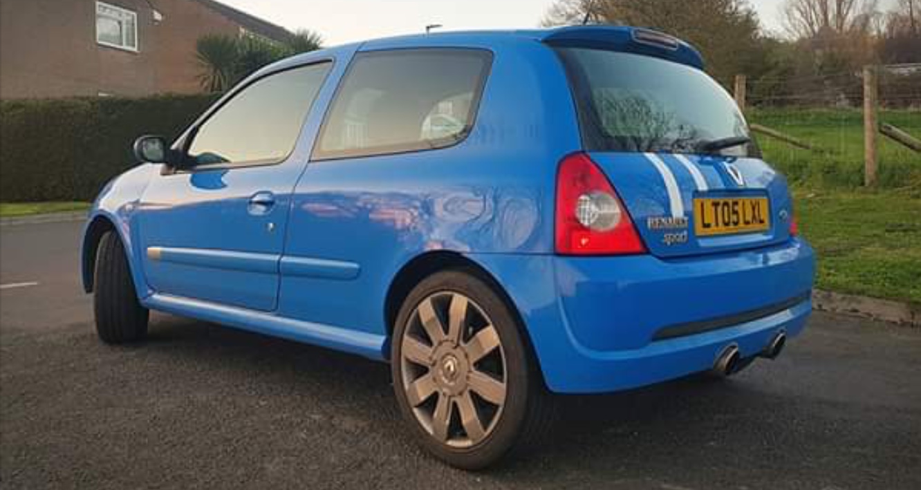

Just found that the first owner was a Clio sport member, and sold it to the second owner who was also on here. Found the advert when the second owner sold it on:
Old Advert

In all honesty the eibach give a slightly better ride so are usually the choice for a more road orientated car. But for me the h&r despite being slightly harsher day to day, sit better, made better and work better for occasional track
Bit of an update on the Cup. I finished the wheels and put the H&Rs on. The car looks much better, but they are right on the limit of harshness for me. I even considered taking them back off before I got used to them. I’ve also fitted a new set of Michelin’s to the wheels, and they helped the harshness too I think. (P-zeros were on it before).

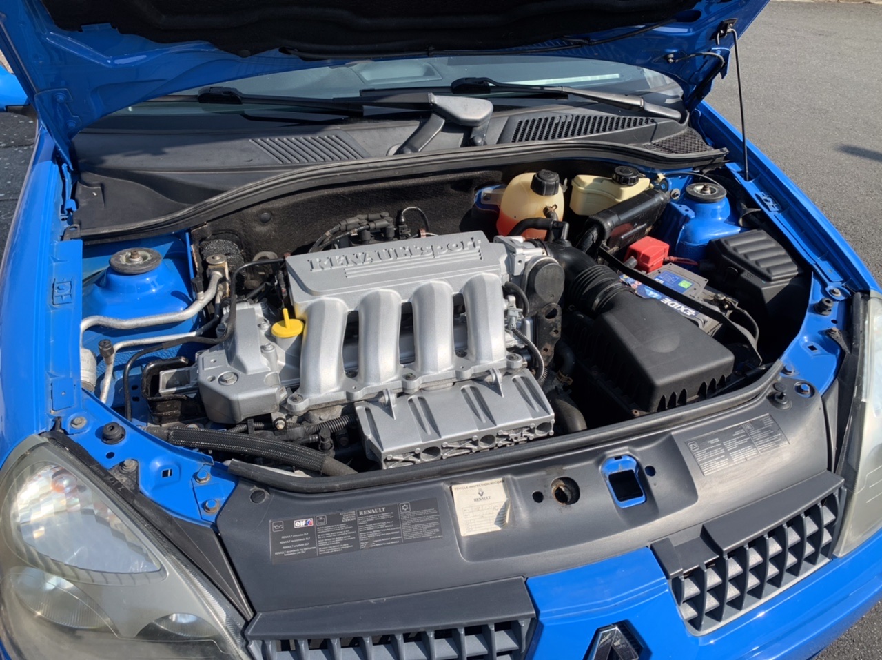

I also used the lockdown to tidy up the engine bay, according to the Clio sport FB page, most other people have been too!
Much better!
yeah as mentioned the eibach definitely provide a better daily experience but the H&R just perform that much better as an all rounder.

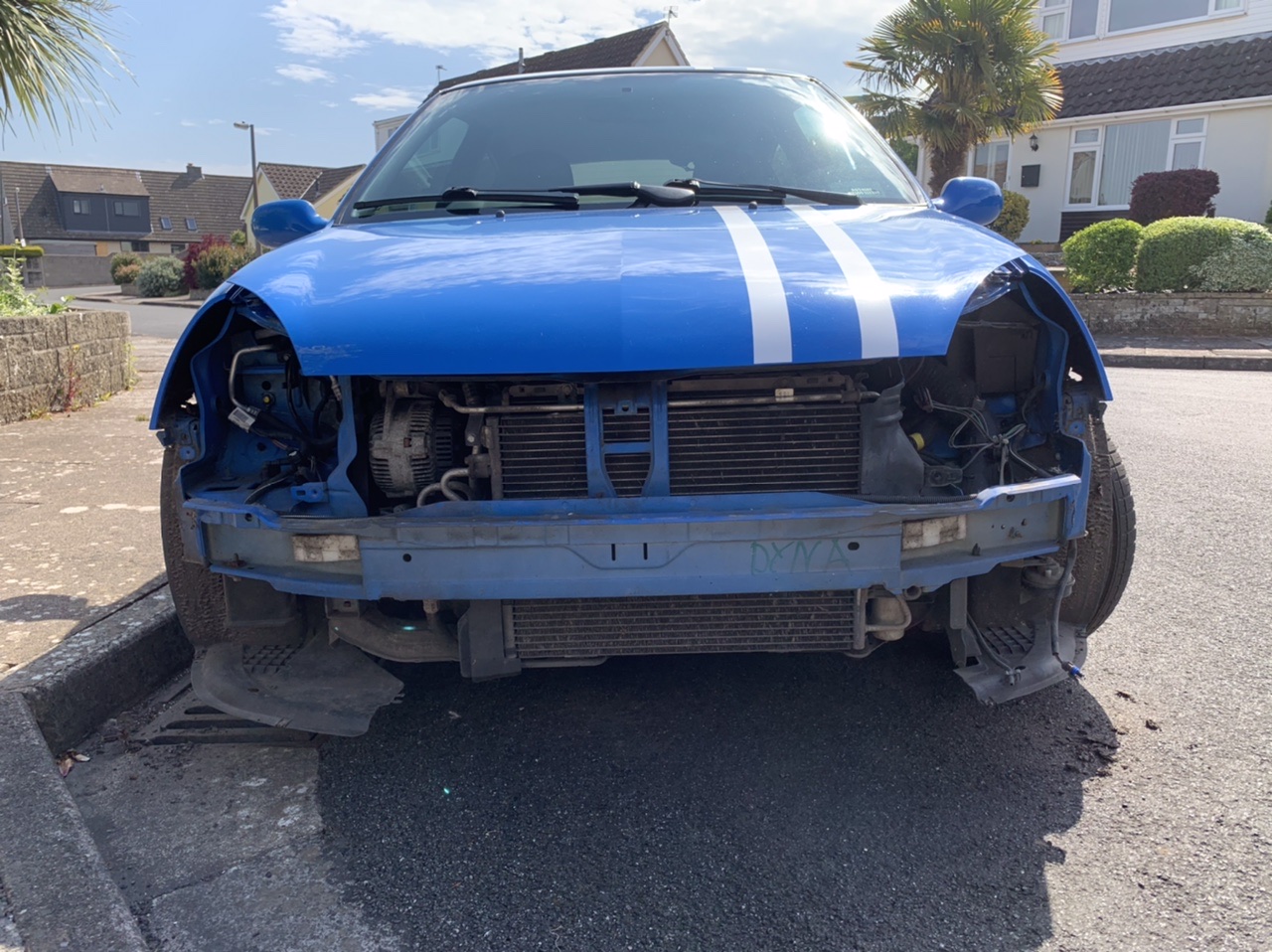

Hi mate I’ve owned a few Renault sports now and just wanted to say your one is now with me as my daily driver. Unfortunately it was involved in a small collision before my ownership but your work is still very much looking 10/10View attachment 1759177
The damage was only a front bumper, headlight, wing & bonnet so only a slow one that they decided to take to the insurance 🤯
