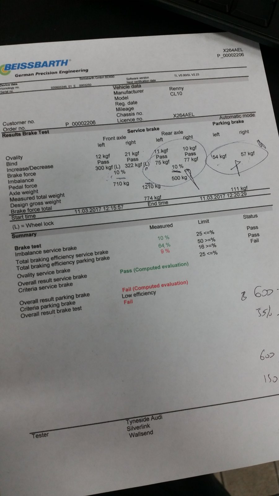

Aren't there MOT centres or similar that can tell you brake efficiency at each corner, or is it just on each axle?

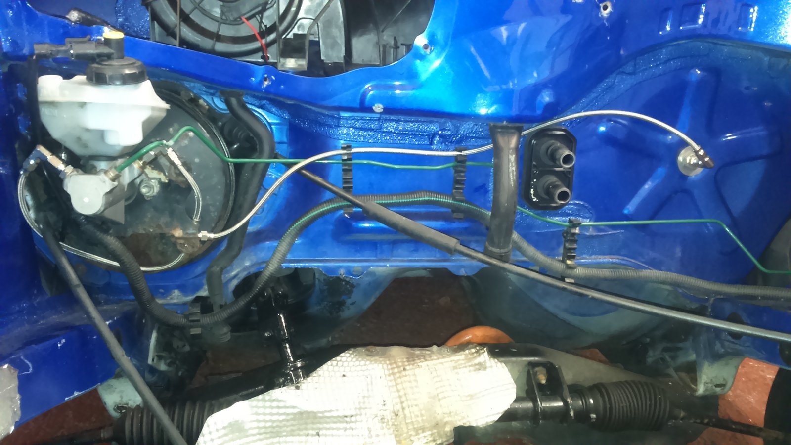

My next plan was to pop it on the brake rollers at my work and see what the forces are. Even if I set the bias valve so it's just the rears locking up the front left will still lock. Does anyone have a diagram as tI which masyercylinder port goes to which caliper?
Cup m/c
Although my rear lines are into a T because of the bios valve and hydraulic handbrake inside the car.
okay so after checking all the lines everything is 100% piped up correctly. The passenger side front caliper still locks up regardless of bias setting and tries to throw me off the road to the left.....any ideas before i have a huge crash at croft on monday lol?

Sounds like a dodgy caliper or you have you lines connected to the wrong ports on the M/C to me.
The pressure is equal from all ports on the cup mc, the rear compensator valve is the only place of pressure reduction
ive checked the lines are correct with a mates 172 cup which has the engine removed so you can clearly see the routing. i did think the caliper might be an issue so i have a spare to try if it comes to it.

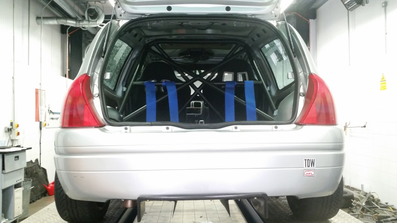

Front suspension was all over the shop to be honest, different amounts of pre load on the springs and massivly unequal length on the front struts. So that's all equalled out and the brake rollers don't suggest there is anything wrong! Time up. I'll mess about on Monday.
They are mate yes and S9C which is a hard compound. Can be difficult to get temp into rears but once warm they were another level of grip and turn in feel at knockhil. I've got road wheels and tyres too....ad08r
Just the rear cage at the moment will be full before long. Its the safety devices rear cage with double X bars, harness bars, B pillar mounts and exhaust tunnel brace.
And suspension wise running BC coilovers with a stiffer spring set up than normal. Rear beam isn't strengthend no
