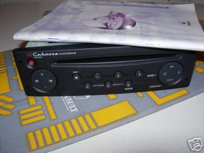

Anyone know if the cabasse tunerlist is the standard headunit for 172's? I presume it fits fine?
should look something like this
this is one from an ff and has more writing, the cup one has an identical layout but is 4x22 watts instead of the higher spec ff's 4x40 watts.
im not certain on the above figures someone can maybe verify/correct
