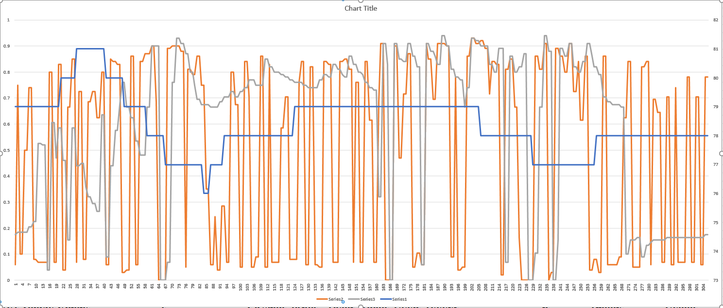

Next, can anyone confirm who has an obd tool and torque or similar, if your downstream cat value moves?
Mine is literally all over the show and i thought that should be fairly static?
Upstream is doing its up/down thing so looks fine but again. i never recall the downstream moving so much. To clarify, once the car was up to temperature (seemingly) I have downstream values ranging from 0.02V to 0.94V
This was towards the end of a 1 hour drive
Blue is the coolant
Orange is the seemingly fine upstream O2
Gray is the downstream O2
As you can see, I am now pursuing the stuck stat, faulty cts and broken cat approach and just wanted to sound the above out
