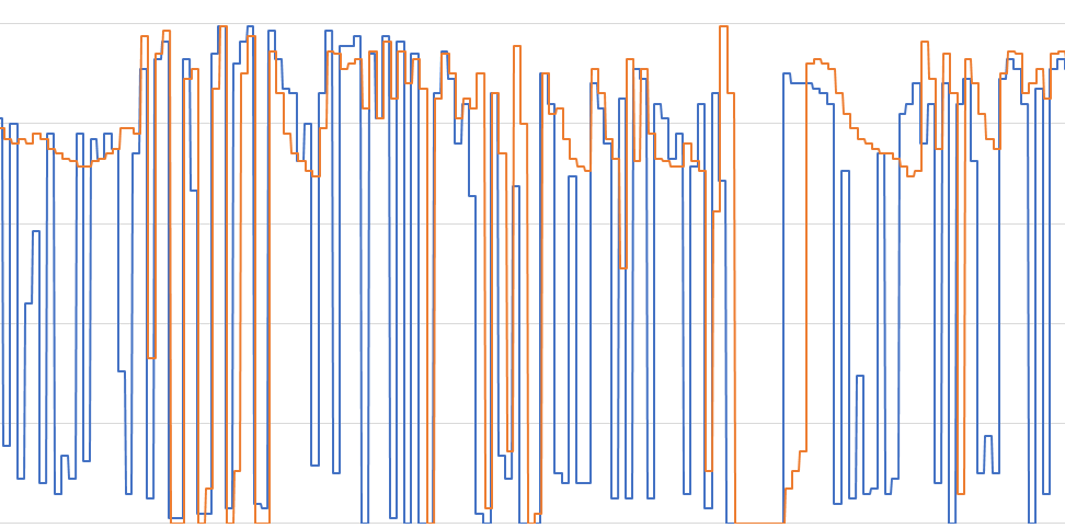

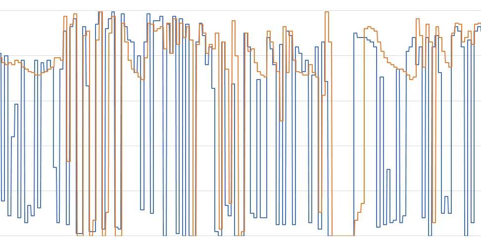

It is bud............while sitting in traffic i threw on my "worlds cheapest piece of turd bluetooth OBD reader" from the glovebox............it does server a purpose sometimes :p
that is where i got the error code from
popped up both O2 outputs in torque (the traffic was BAD) and the rear O2 sensor value was all over the place
I was under the impression that this one was generally a static yes/no kind of affair :/

Yep. That is what I thought. I have a few other O2's at home so will swing one in tonight and see if it changes the light

might try using torque logging these on the way home as i have just realised that it is actually not bad in that regard
with a bit of my finest excel jiggery pokery i have a chart :)

Nipped out while chomping a sammich there and let it run up, grabbed some quick torque O2 logs...............i mean, all looks fine now. Bear in mind it was still sort of coming off cold start.
That rear one was off its crack earlier............

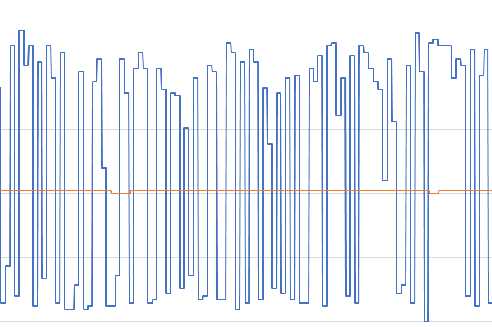

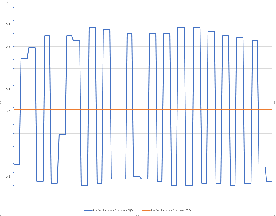

  2003 Clio 172
ok, so here is the plot once the car was warm and I was driving
blue is front o2, oscillating as expected
orange is rear o2, fairly static in and around 0.4 (not sure what scale that is but same scale as blue)
here is the plot towards the end of the journey
No EML light on way home mind you but just reaching out to see if that is normal?
If this is treated as a binary switch to say "yes, the cat is working" then surely this is saying "yes it is, oh, no it isnt, yes it is, oh, no it isnt, yes it is, oh, no it isnt, yes it is, oh, no it isnt..............." etc etc
