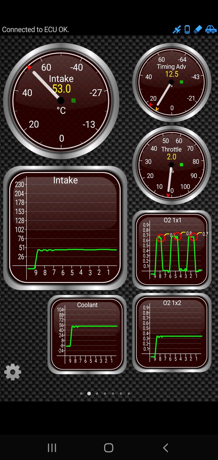

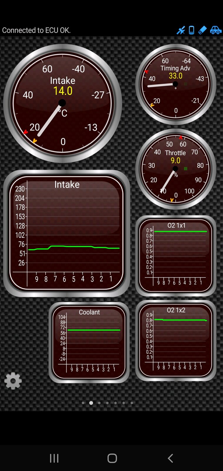

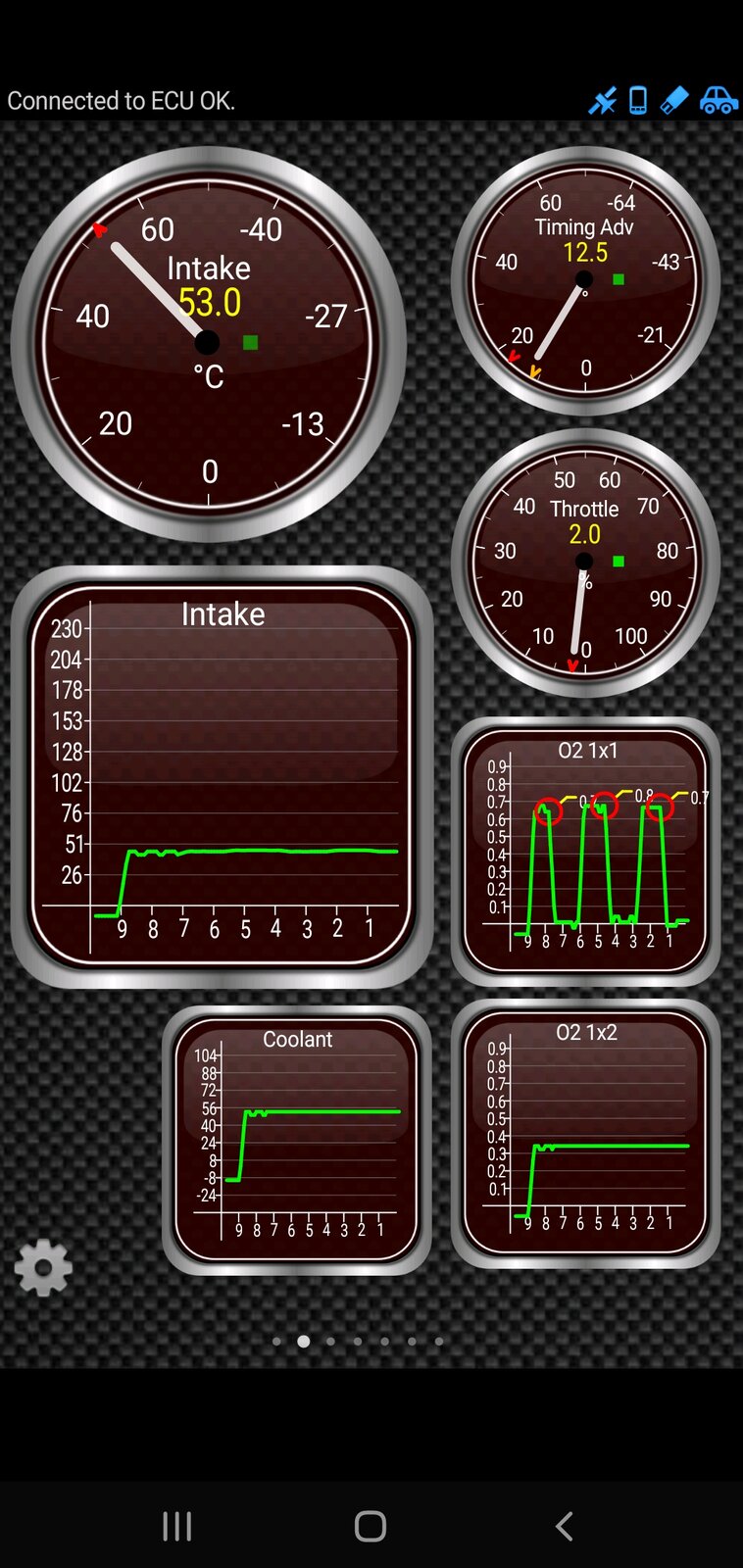

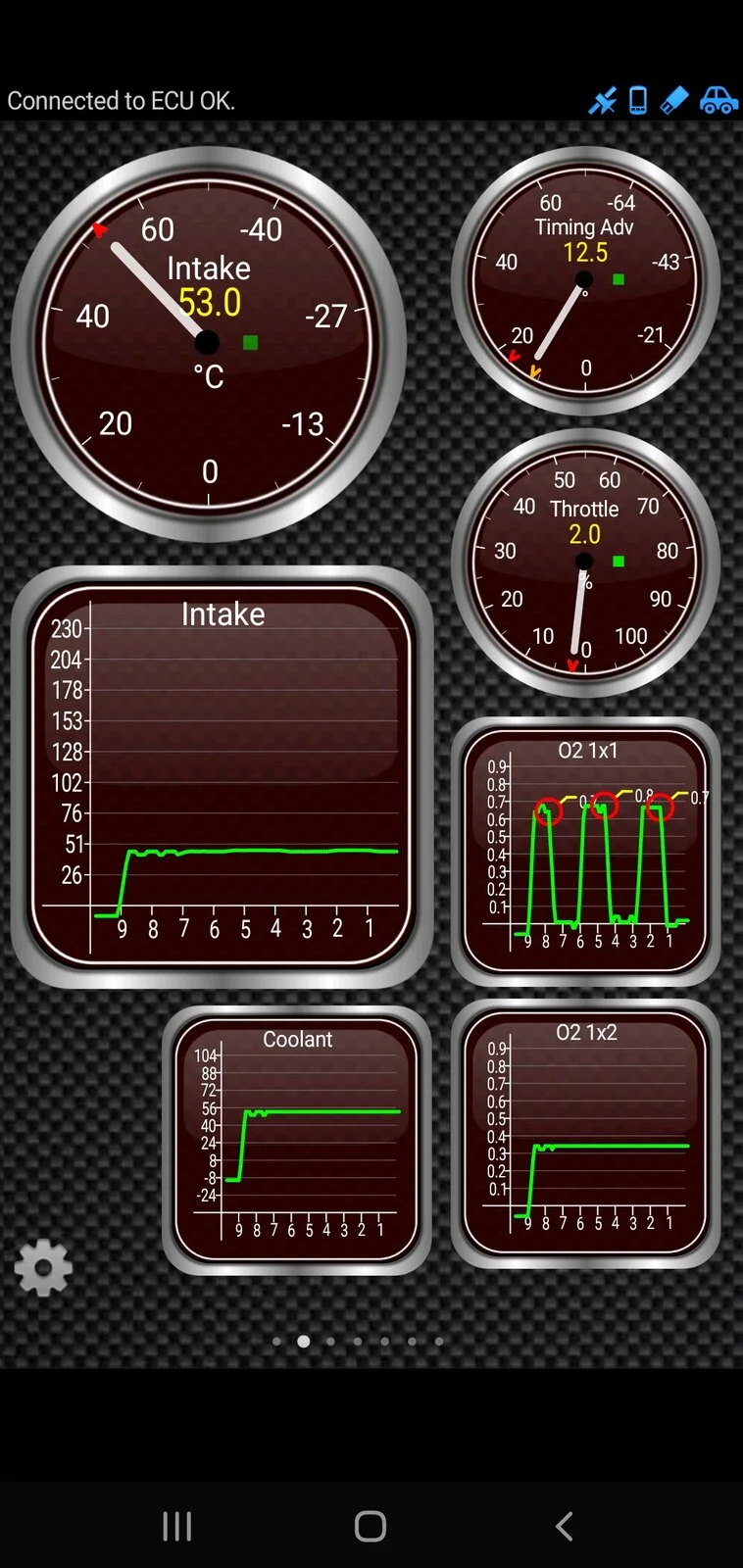

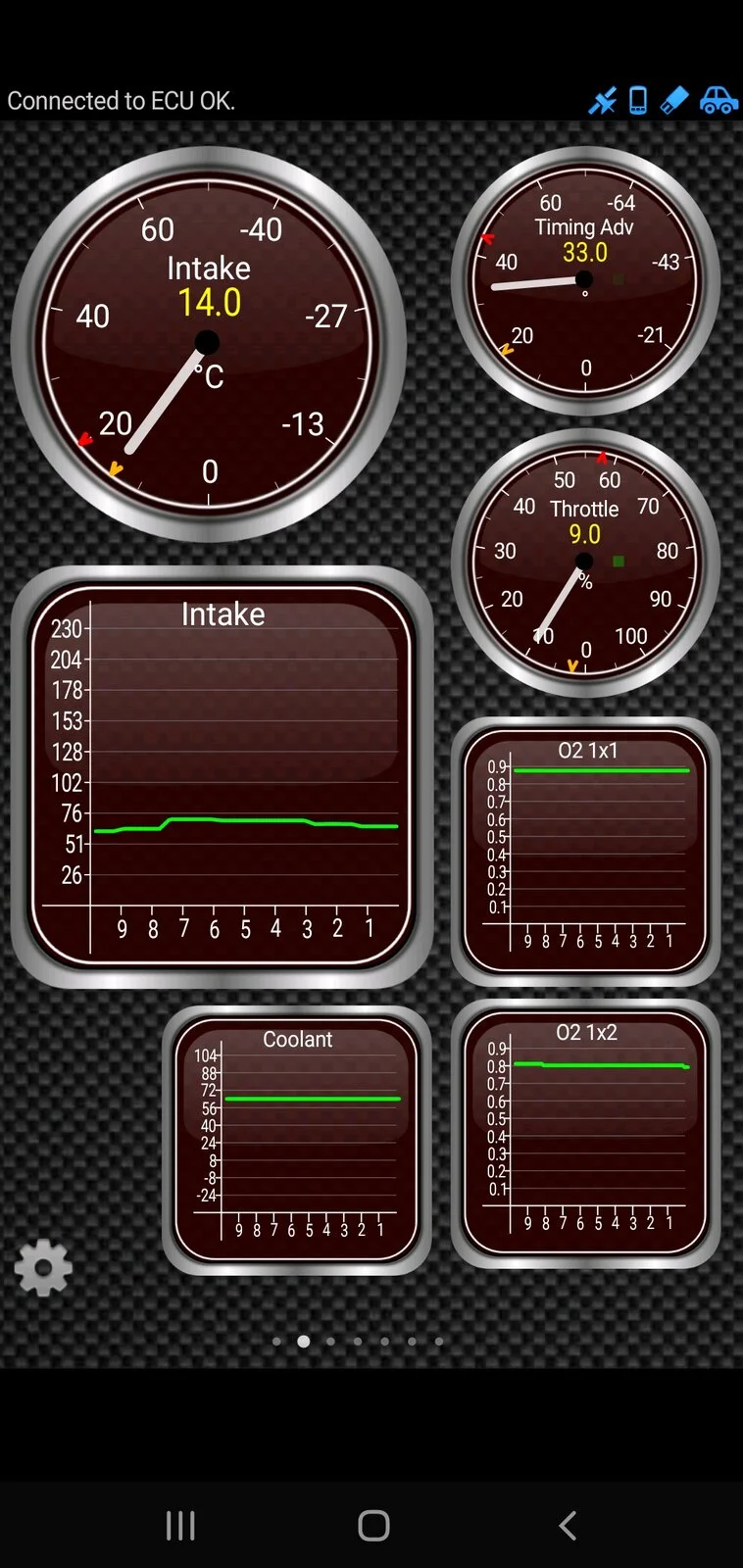

Right...........still suffering this. In fact, it's really starting to bog down quite a bit lately.....p'raps the colder mornings or whatnot but anyway.................could this car really be over fuelling? Or could it just be under igniting?
Do fuel pressure regulators fail on these? Do they have them? I remember my old civic had a mare of an issue that ended up being the fpr but symptoms were not the same

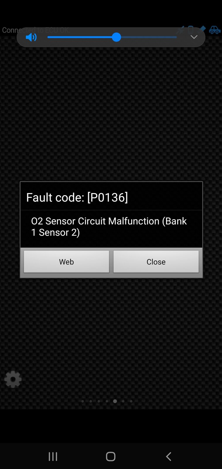

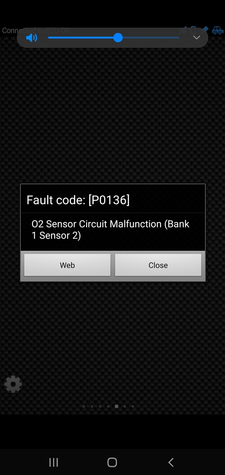

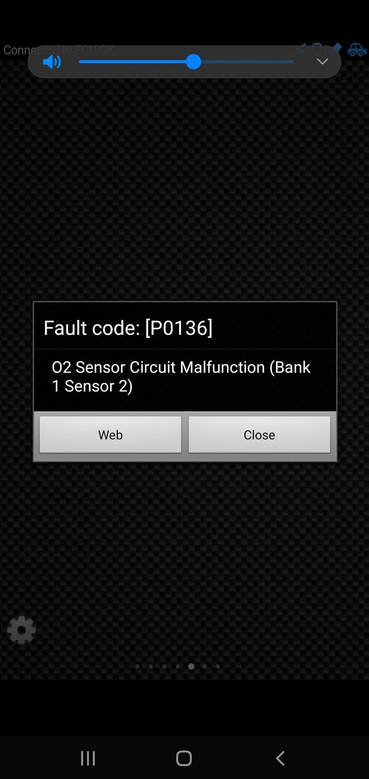

Also, coincidence or not.............i have had to clear the code for what i think is the rear O2 sensor a few times in the past week. O2's were both replaced with new not even a year ago now and I never thought that the rear O2 did much apart from verify that the car had a cat.
Screenshot_20200205-175238_Torque (Lite).webp Screenshot_20200205-175257_Torque (Lite).webp
View attachment 1453221 View attachment 1453220

Popped on Torque with the OBD connector to see if i could capture what might be throwing the rear O2 error that keeps cropping up but sods law, it didn't.
A few odd observations that might (or might not) be relevant.
I was always of the opinion that the rear O2 value should be pretty static however, I did notice it basically tracking the front O2 sensor for large stretches of the journey (particularly at m'way speeds). There are times when it was pinned at the top of its reading and times when it basically sat at 0 (or less)
Appreciate that Torque isn't the best app for this (i mainly just use it for CEL codes) but it was all I keep in the car.
The car still seems super rich mind you.
