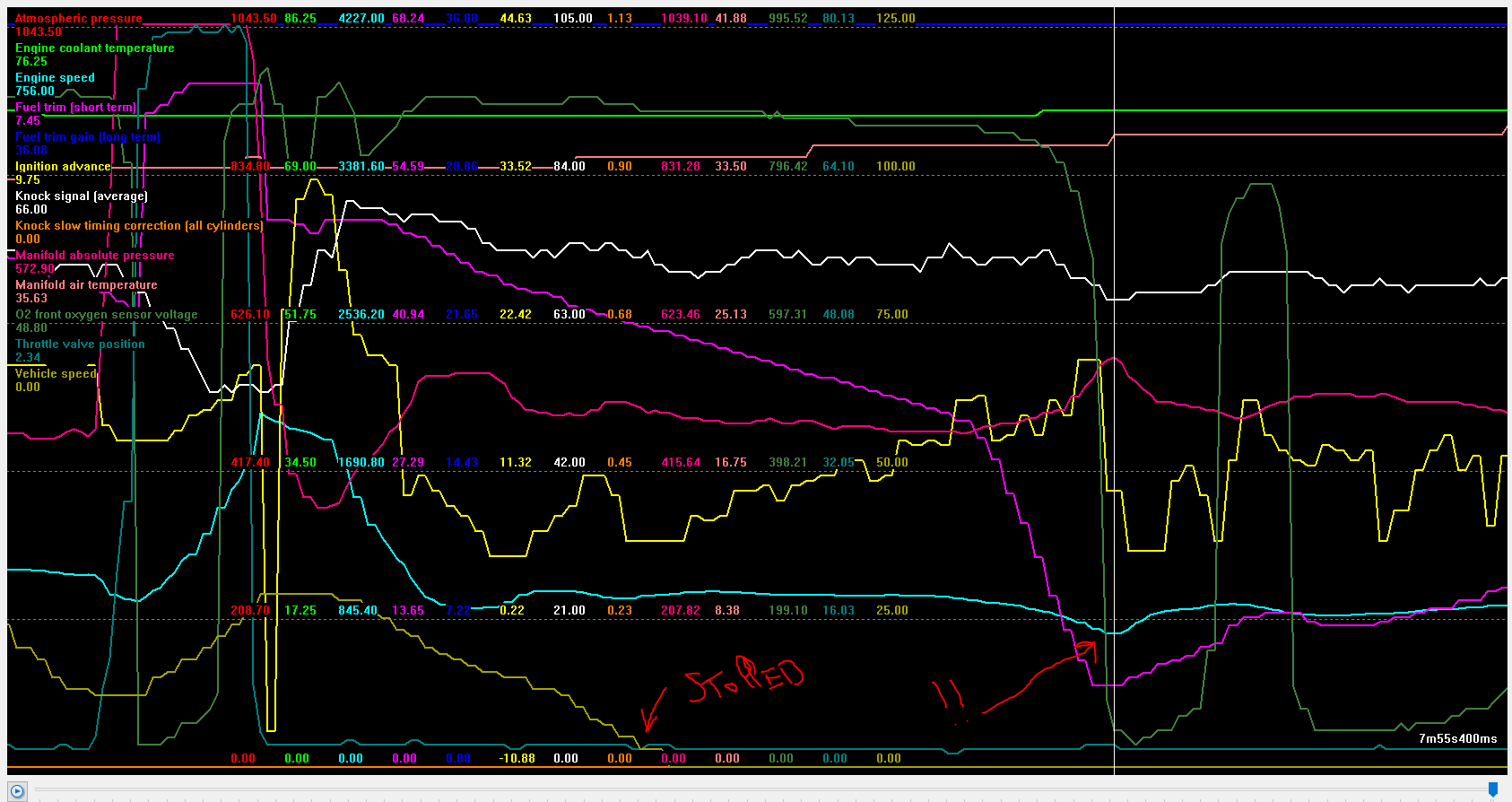

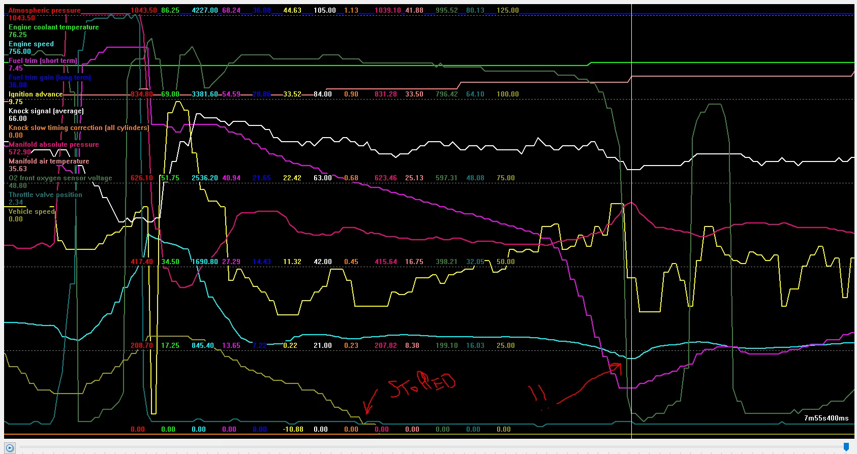

All I have is RSTuner fella. Not ideal I know but it looks to be able to spit out quite a bit of info albeit in a graph format.

So..............of course it is hard to replicate the issue WHEN YOU WANT.....lol
But, it did most certainly do it when I pulled up at the house at the end. Not as severe as say sitting in stop start traffic for a while but exactly the same behaviour only less pronounced.
Drove in, all seems well.............pull up on the drive and you can see the vehicle speed getting to 0. Sits for a few seconds with the rpm at a fairly normal level (this is usually say, 1100 when it is severe) and then the revs drop and then recover.

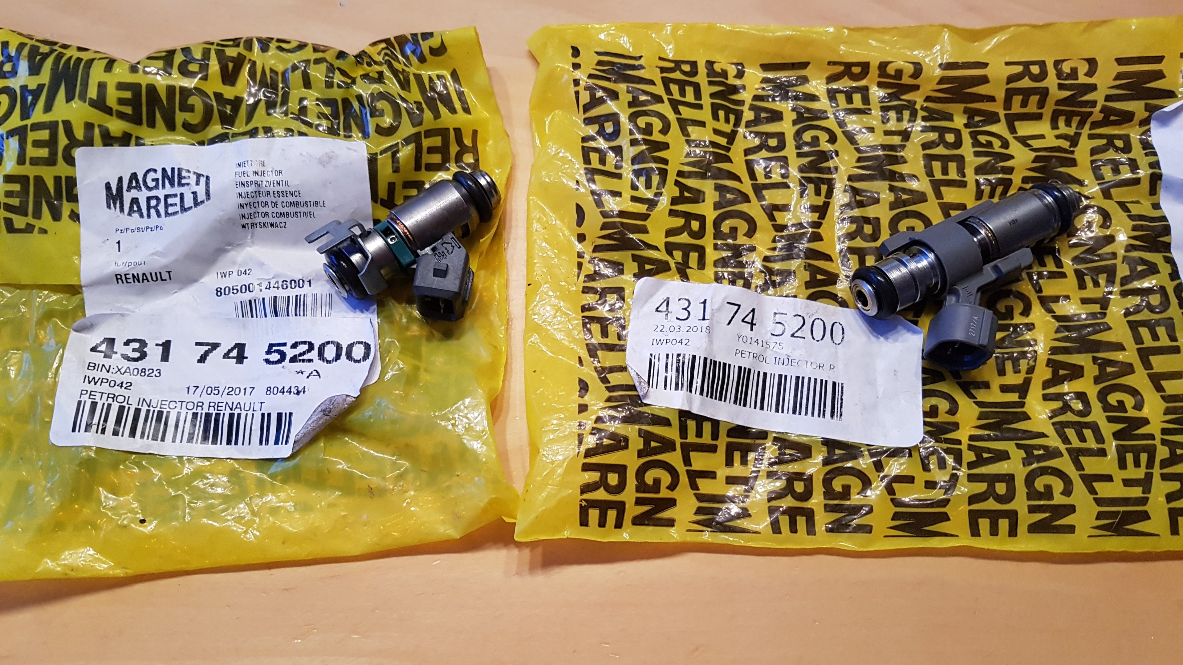

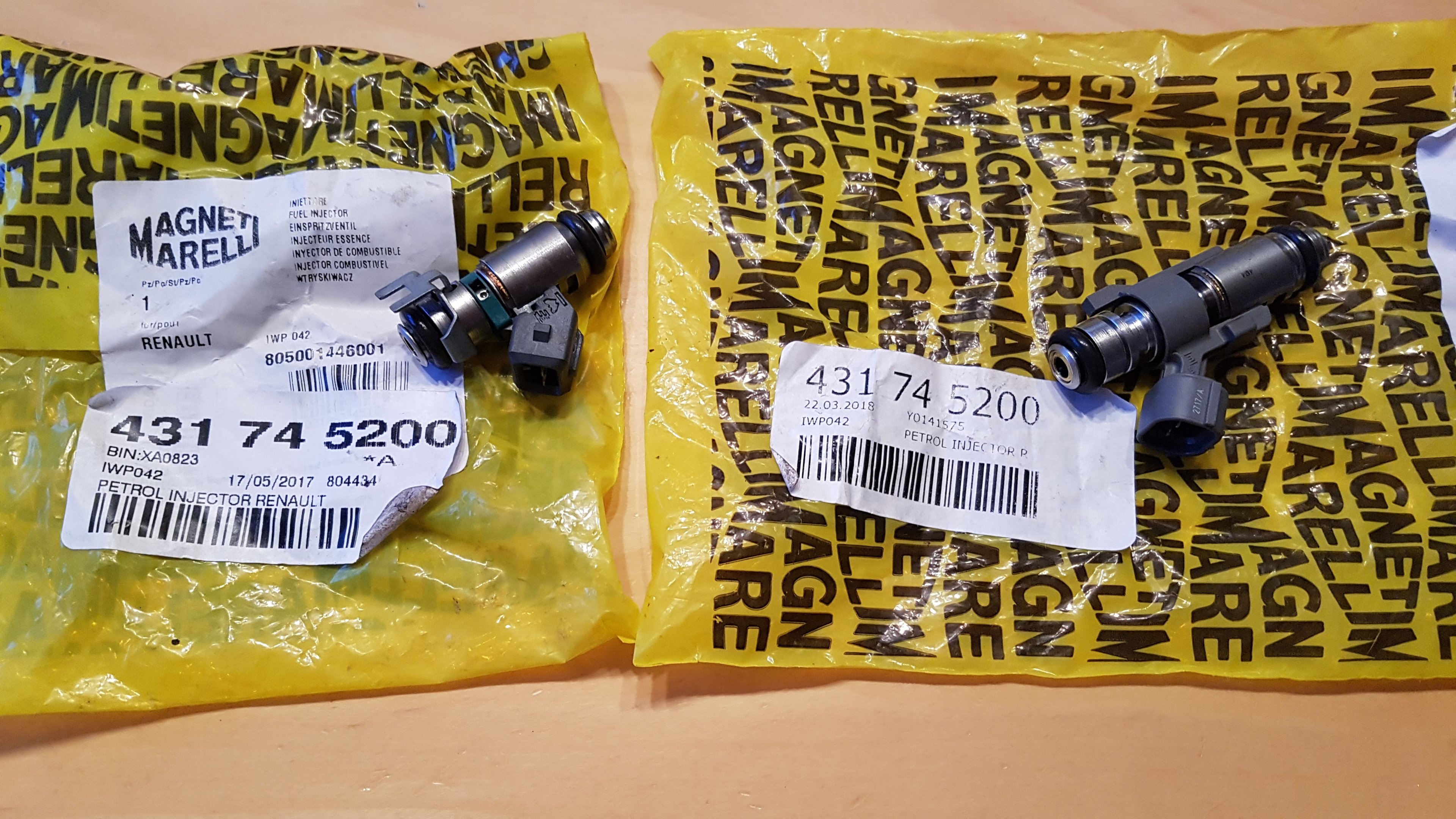

Bought 4 injectors from Renparts.................one of them is COMPLETELY WRONG yet labelled the same.
Correct on left. Wrong on right.

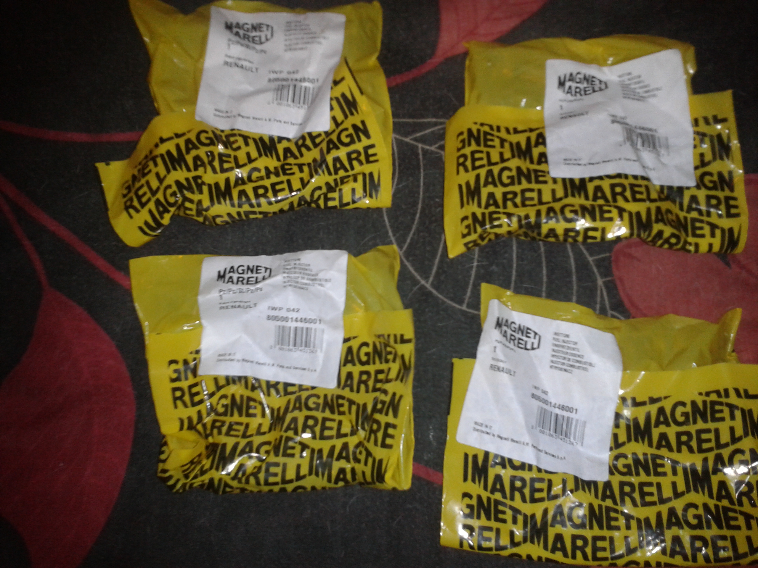

Well.....they were all sealed with the magneti marelli stickers.....No tears. The odd one was sealed too but looking at the info on it.....while yes it is an IWP042.....it does also say PSA on it.....to me that is Peugeot.
Give Renparts a ring, obviously it`s not their error and they will sort it.

Spoke to Renparts earlier and they cannot understand but are arranging to send a replacement.

The one that is incorrect btw..............was actually opened and has been sealed shut with an ECP (IWP042) sticker......I can tell because of the dirt under the ECP sticker........the Marelli sticker underneath says IPM012. It was opened at some stage.
