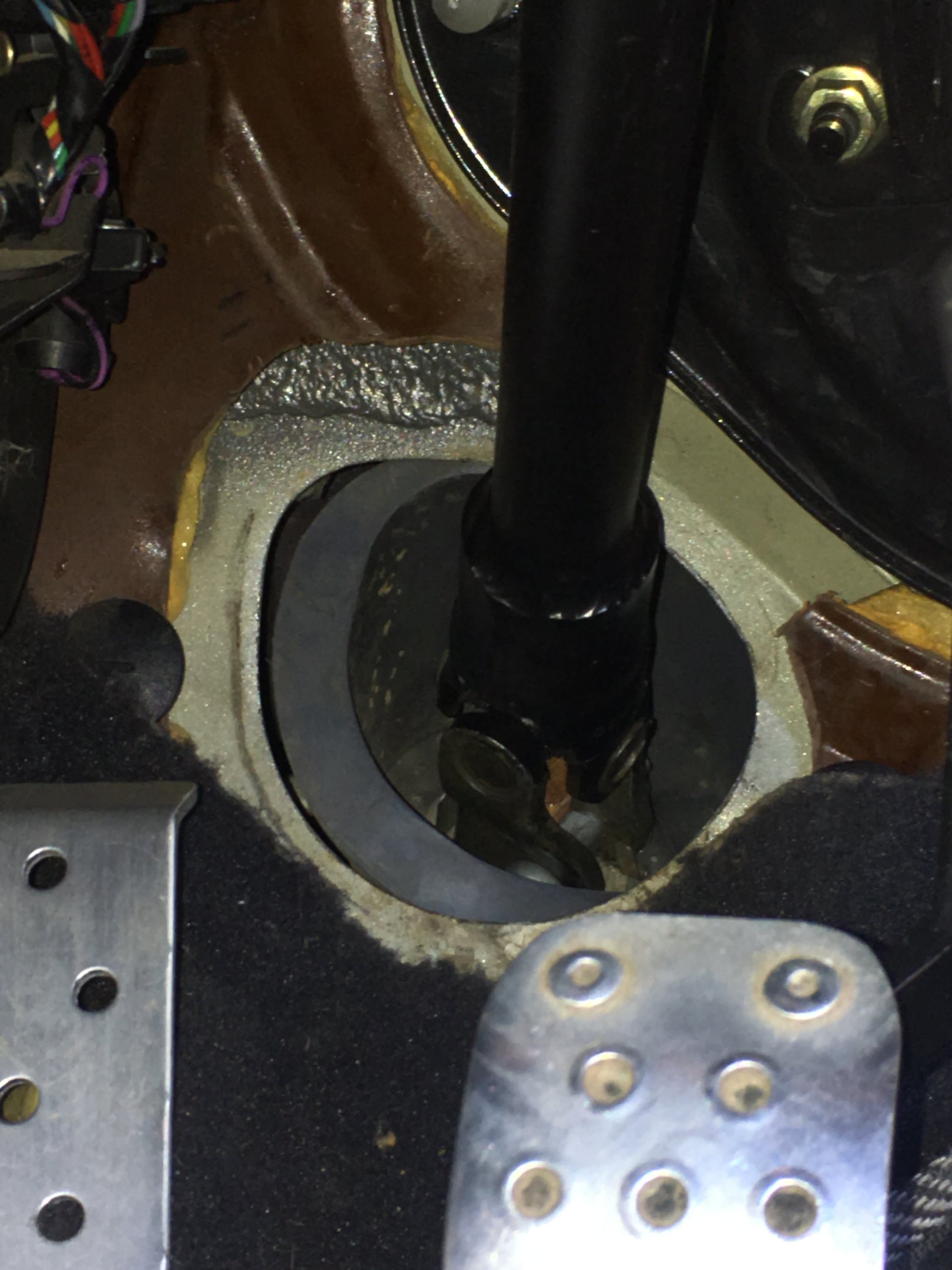

@alexessex_7 Inner tie rods bud. But it could be a few things, old steering rack bushes can really mess up the steering, the steering columns lower uj can cause this as its bushed and has flex and perishes over time.
Would like to add that after this thread I was still on the hunt as I felt it was going again, I got a custom steering column that has a welded lower uj and that was the final piece of the puzzle. Steerings super sharp!

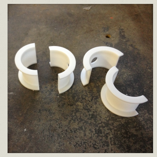

Its back... Got a feeling its the rack bushes or mounts, has to be since I know full well all tie ends are very new and solid. Need to source those nylon one that were used on the old cup racers.
Nothing wrong with genuine Renault there just as stiff as the powerflex ones i put on.
Im looking at these completely solid ones, so wont perish like the rubber ones

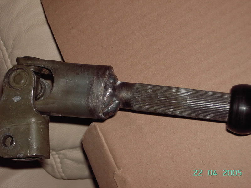

2 things you need's to do, and the steering becomes better then ever.
first, there's very small rubber in the column where the u joint connect to the rack. just weld it, it's take most of the play, and make the steering much more precise.

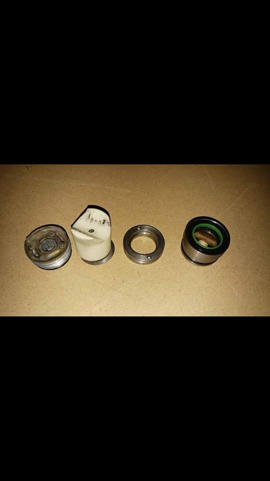

second, get the rack out, and tight up the rack bushing, bit at the time, so when you start feel the rack is getting very hard to turn, then open the screw just abit.
it's suppose to move with some medium friction.

I also have a welded lower uj like you, it was unreal when I first drove the car with it, taking slow corners at 30mph was moving me around in my seat, unlike before when I turned it stayed turning and wouldnt sort of give up in the turn.

as for the rack bushing. once you get the right adjusting, you no longer have that famous knock when turning the steering .
