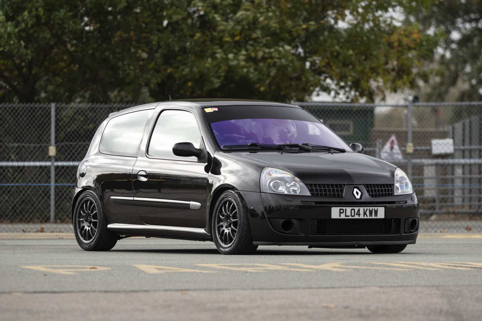

No it doesn't and it sits like this

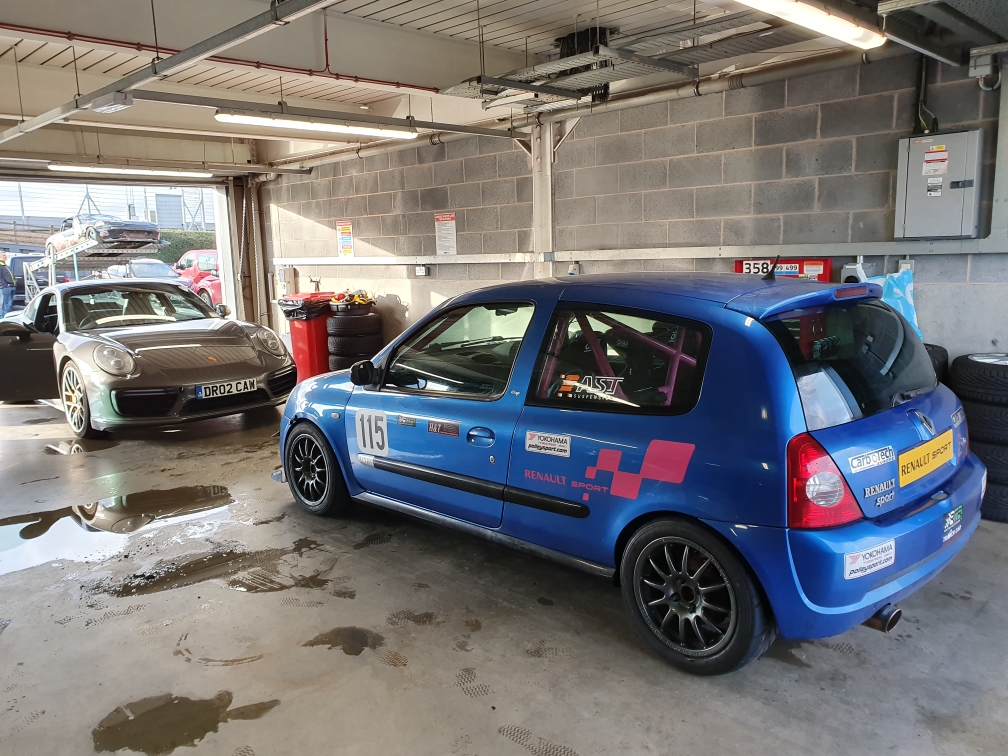

I run 10mm axel spacers, with 2.5 degree neg camber, my wheel centre to arch is 300mm which is pretty low.. I use Turini with RS3 wets, TD 1.2 et35 with Yokohama A048's and Td1.2 et38 with Toyo R888R. My arches haven't been rolled and I've never had any rubbing issues.. oh and my car is only used hard for trackdays.. Also it's running AST5100 on 80nm springs all round..
