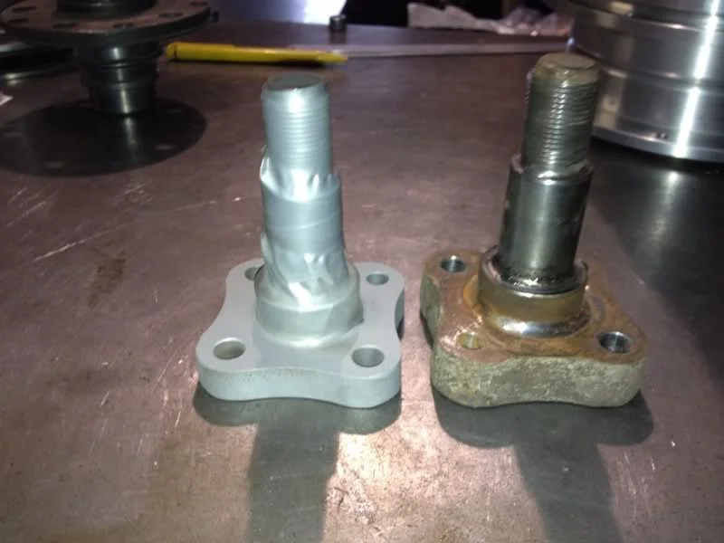

Here is a pic showing the difference
So does anyone know why there is a difference , or what part number the thicker ones are ?

I had a to get some new stub axle's pronto the other month and fit a set from a 172 cup, they are the thinner one's as the wheel's fitted to those cars are of a lower offset. The 182 one's that I removed (Damaged) were 18mm thick at the bottom. Ian have you noticed any other difference with the part other than the thickness at the bottom? I have only had the 172 cup items fitted for Llandow and already have a knackered bearing so I'm wondering if this has anything to do with it! If the one's you are wanting are 18mm thick then they are from a 182, last time I checked they were on backorder. The reg for my car was YD04 PZM if you need a reg for Renault although I know a few people had some for sale on here when I needed them

No apart from the base being thicker they are identical , if they are 182 ones its weird that they were on the bog standard 172 I bought ??

Yes they are the 182 or 182 cup packed ones, we found this out when changing our stuff over the winter, didn't really notice until I put them side by side.

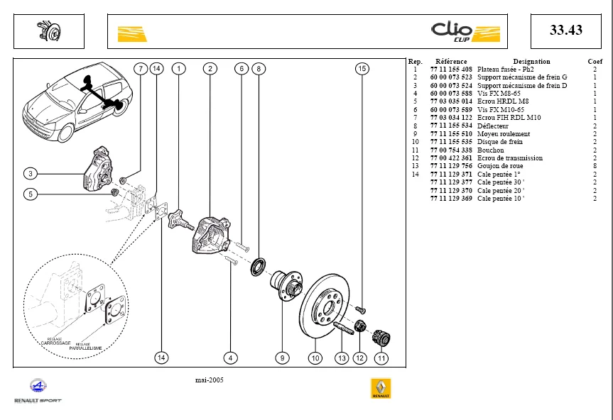

I also have a set of the thinner stubs from a 172 cup. Racers (ph2 at least) as std ran the wider stub.
Could the previous owner have swapped them out if using lesser offset rims than the originally intended 48.5mil to give correct track width?
Unsure if the ph1 parts listing is a different p/n-my ph1 manual has no part refs :(

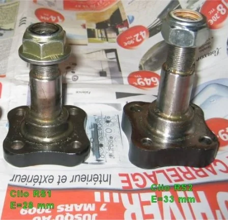

Blast from the past but does anyone happen to know what the thickness of the bases are?
I want to know for a lathe effort of decreasing trackwidth (because of wide wheels with too low offset)
Cheers!
  R5 gtt, R27 F1 team
aha, thanks mate, missed that....
So seeing the last pic the thin ones are 5mm thinner they would be 13mm...

Am i right, the difference between spindle ph1 and 182 is base thinkness? ph1 = 13 mm, 182 = 18 mm?
