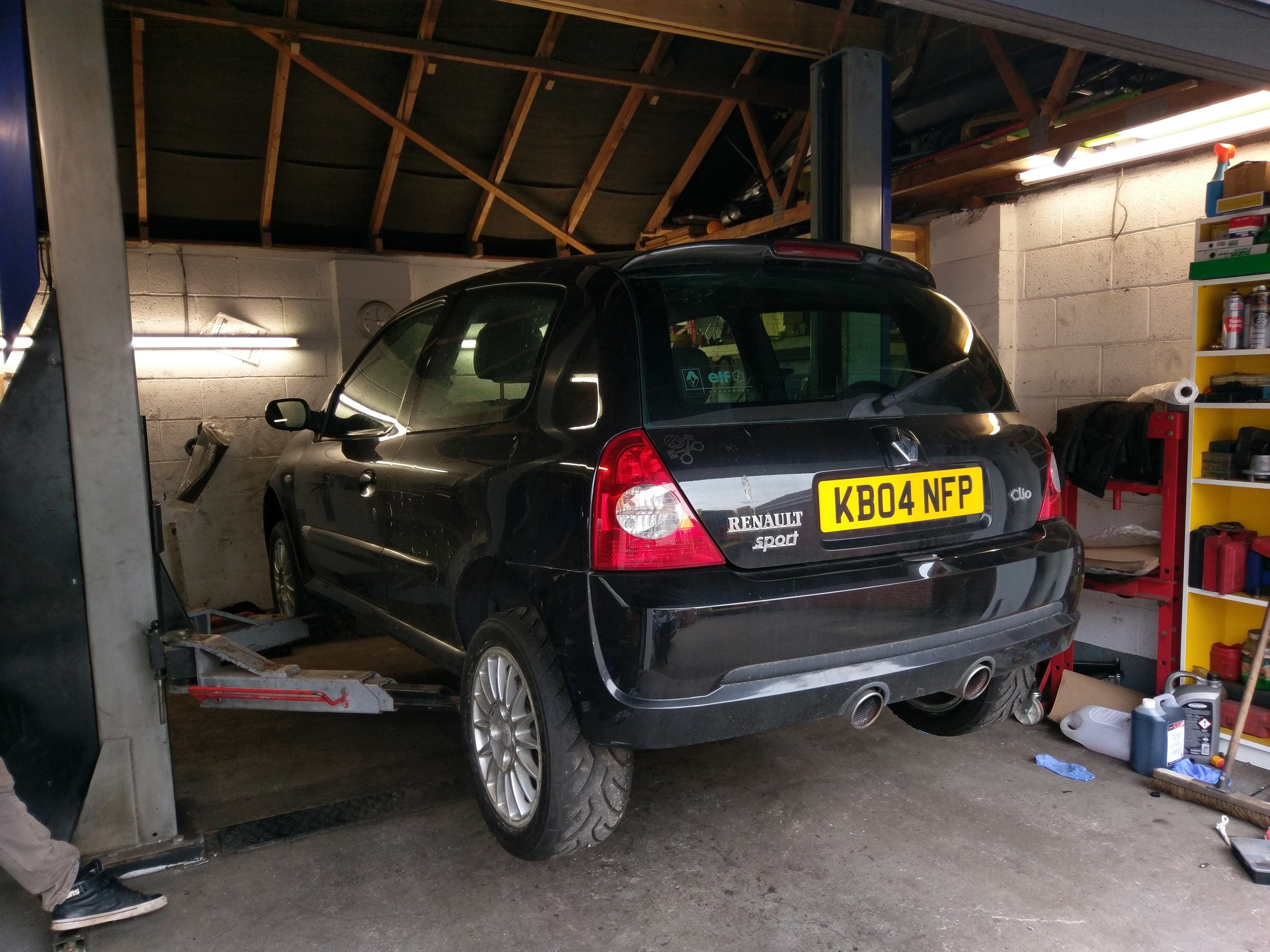

All sorted, also stuck the seat back on for next week at Blyton... with a little help from my mate
