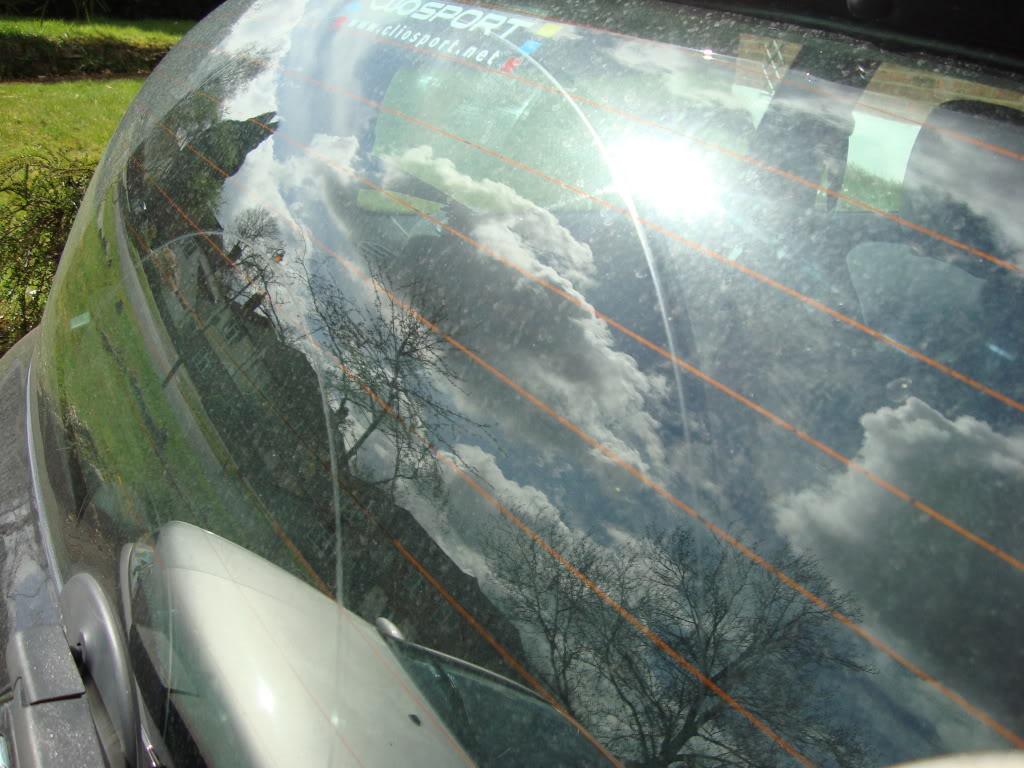

Firstly, the previous owner didn't change the wiper blades when they needed doing and as such the window is rather scratched...:

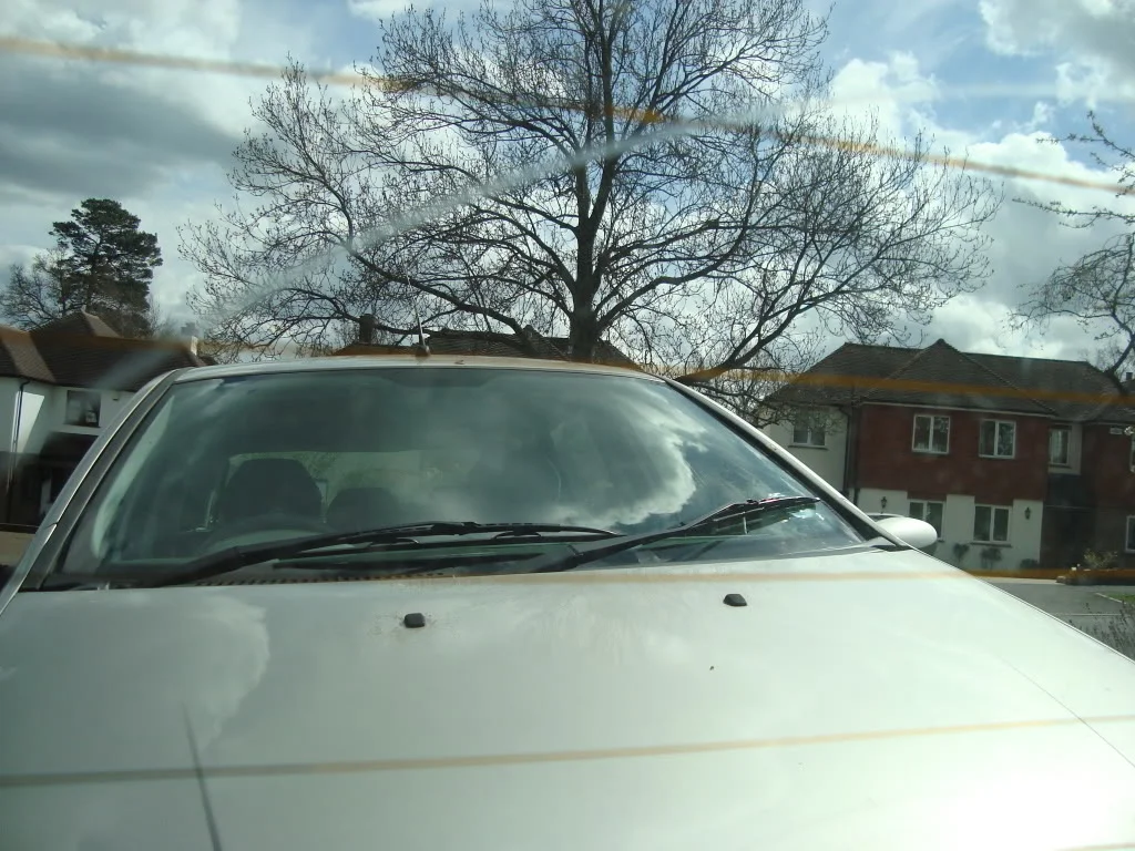

Secondly, in places the lines alternate between yellow and black, doesn't look right to me? You can see it on the first line in this photo:

It will be thicker than the standard printed on circuit. It might work for the longer bits, I think it might be a bit hit and miss if it works though.
I was lucky as mine is only broke on the lower 2 or 3 lines, I have got the upper most line working but not the bottom 2.
The only other way to remedy it would be to purchase a new rear window or second hand tailgate with window.
Yeah. Thanks, I think Im gonna have to start looking into that, would probably be best anyway seeing as how scratched the rear window is anyway.
