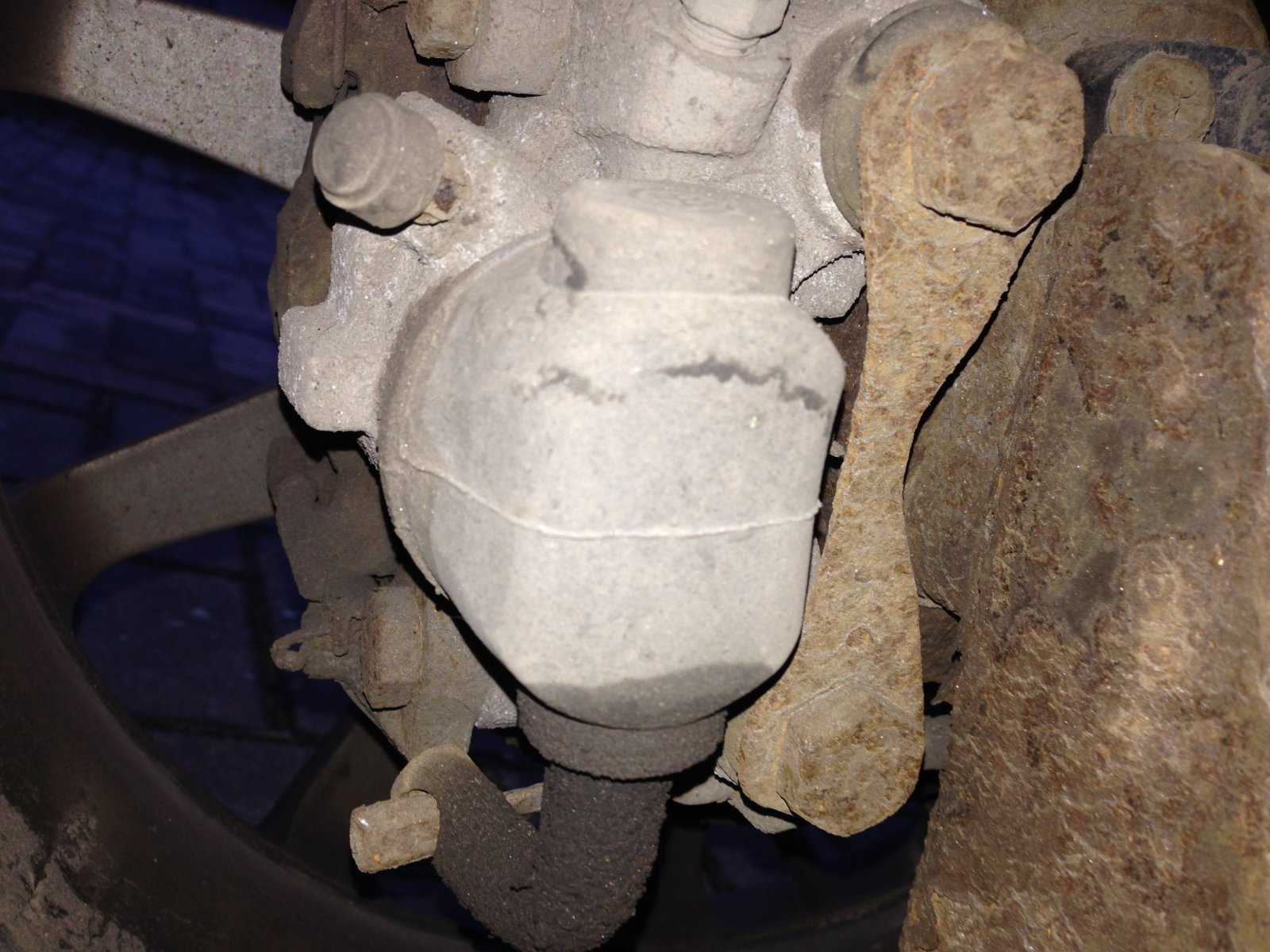

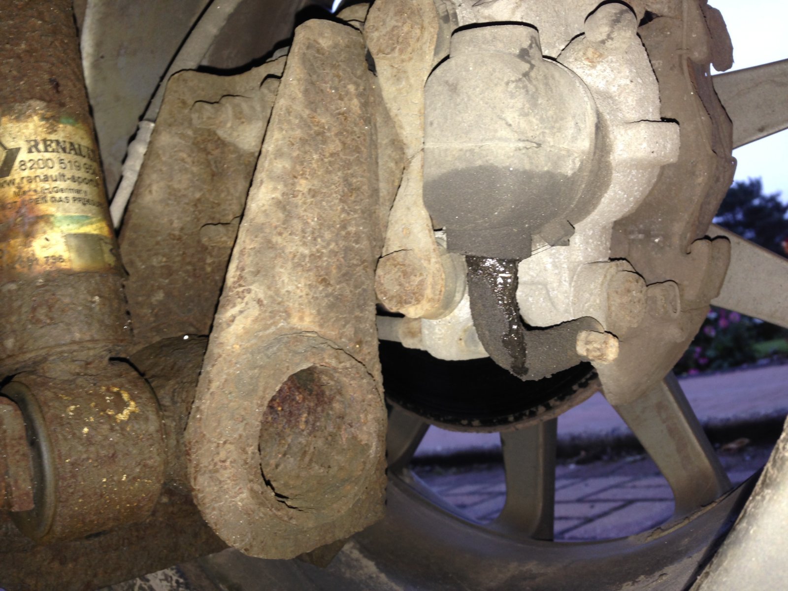

Despite both rear calipers being replaced by the previous owner 2 years ago, my O/S/R brake pad is about half the thickness of the N/S/R and I noticed this yesterday when under the car-
That's just grease, if it's the side that's stick g wouldn't worry about it much. Chances are the pads are stuck in the carrier, if they are just give them a clean and file a bit of the ends so they can move in the carrier a bit.
If not check caliper is moving on sliders, if that's OK check handbrake cable is free.
