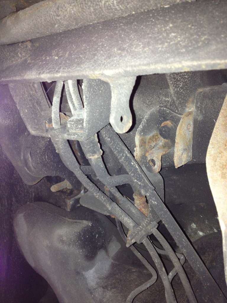

Nope no compensator.. I think its just te 172 cup that had them?
MarkCup
Nope. 172 Cups are the models the don't have them...yours should have one as far as I'm aware.
Lack of valve will explain the issue your having.
Find a 172 Cup owner that's been convinced they need one by a clueless MOT tester and buy it from them!?
  DON'T SEND ME PM'S!!
Find a Cup owner that's been convinced they need one by a clueless MOT tester and buy it from them!?
nope. 172 cup is the only model that DOES have a compensator. It's just fixed in one position rather than with a lever rod on it
