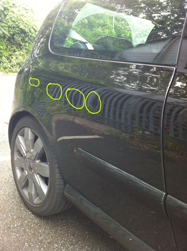

Does anybody know if this part of the shell will be accessible for dent removal?
My iPhone couldn't seem to capture the angle of the dent properly. I have put my hand up the inside arch but cannot reach up towards the dent. I've just had some repairs done recently and I've cocome back from a day out today to find someone has kindly left another dent. Really does put me in a sh!t mood :mad:

This will cheer you up slightly lol, where all there from when i bought the car, just took it into consideration knowing there not that bad and hopefully they will all be taken out, got these 4, there not bad just dings.
Then theres a 5p dent in the drivers B pillar, one small ding on the other side rear which some t**t gave me recently :@, then 3 stone dents on the bonnet... Youve made me pull my finger out and edit the pics so i can send them to a few PDR people and hope for a decent quote. Last time i paid 110 for 5 dents and they wernt really dings they where big dents.

Easy to get out mate :) took my dent man about 5 mins on the rear quarter and 10 minutes on my bonnet when i got the car! £50 for 4 dents i was happy :)

I had one in an identical position, it was removed very easily.
The dent guy removed the rear light cluster and gently worked it out with a very long 'T' bar style tool. Behind the light clusters there are several holes which you can use to access the rear quarter panel without taking out any internal furnishings.

The chap who did the rear quarter on mine also took out one on the roof very easily. He used a resin and a slide hammer which was attached to a hook which he set in the resin. Then just a few light taps with a nylon pencil and it was gone. He also took out the usual dent from the bonnet where people push down on it (not me by the way!).
Cost me £50 to have those three removed, and I would say that it was worth it just to see the chap working his magic. Lights, mirrors and a very strange array of specialist tools. It made for a very interesting afternoon watching someone who loves their job show you how it's done.
