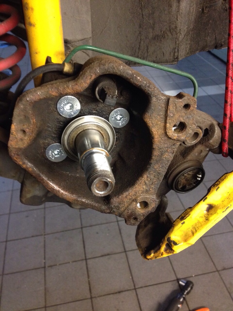

Have taken off my rear disc's and are going to replace them with new but haven't seen any spacers/washers/deflectors (part no 6000073518)
I've attached some photo's to show my dilemma
the only thing that looks like is what I would call a 'dust cover' any advice or help would be appreciated

  clio 182 cup
Yer sorry about the photo's .....but I don't know how to enlarge them (bit of a dinasor when it comes to computers lol lol !)
Like I said they look like dust covers and not spacers as in other threads I've seen on here ?
Are they the 'old type' or am I barking up the wrong tree ?

Would be good if the Renault rear discs actually came with one of those spacers. They are quite pricey for what they are but absolutely essential otherwise like sonny said the bearings wont last very long.
Also make sure you put it the right way round and torque the big 32mm nut to 175nm
