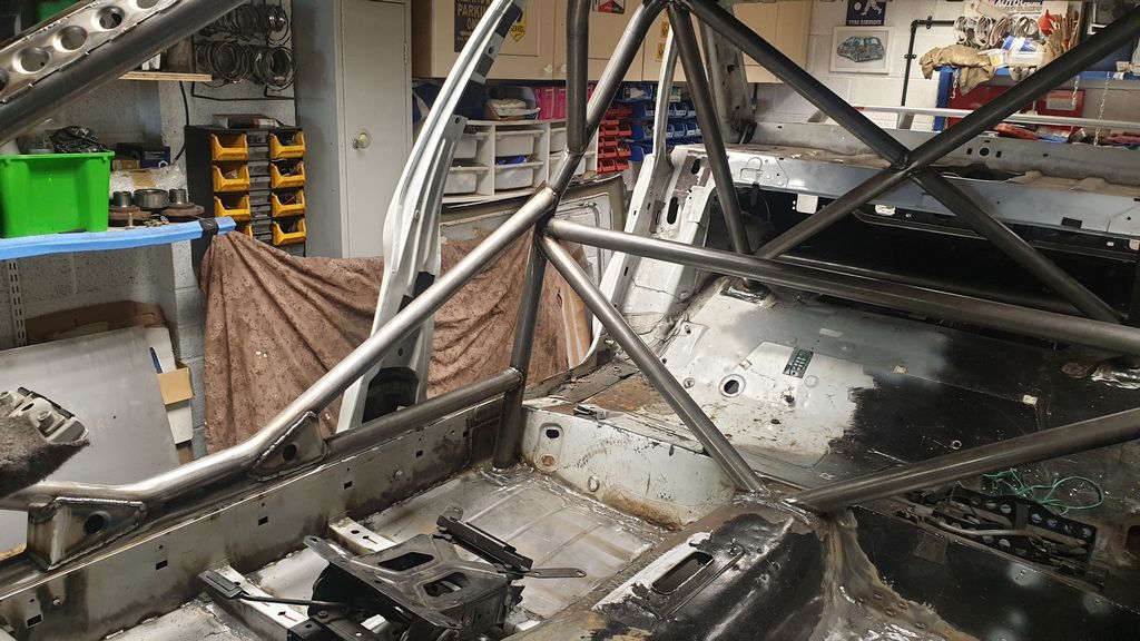

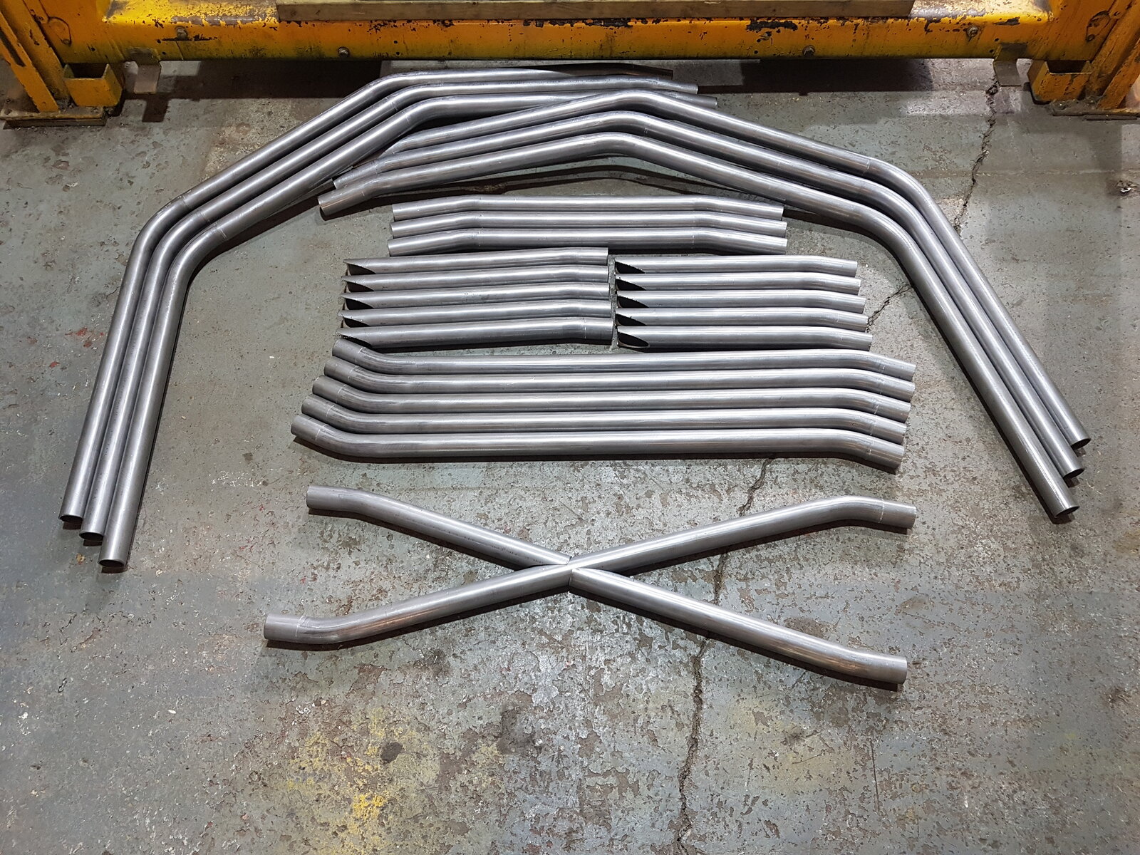

Plenty of cages on the go at the moment 👍

@Tom Johnson, care to drop me a price for a Clio rear cage with harness bar(s).
Be interested in a price for both CDS and the same in T45. 🙂
No problem at all mate 👍🏻

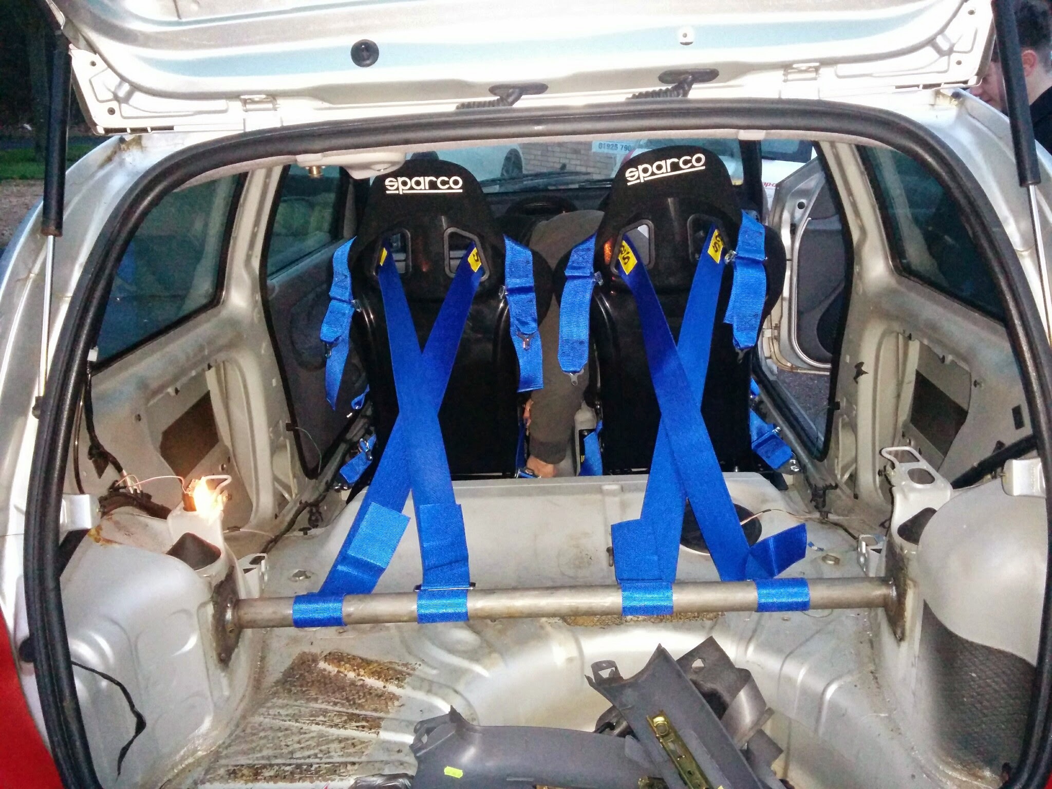

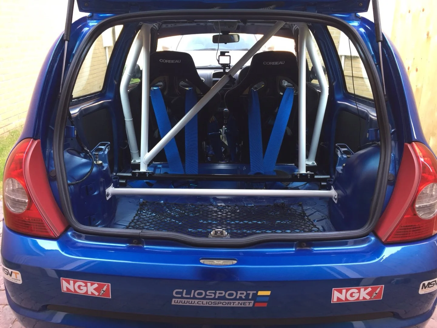

I have a Wiechers rear strut bolted in, certainly wouldn’t mount harnesses to it, although I am mounting mine to the original rear belt holes but I’m sure a lot of others are as well tbh:
Greeny.
  440i + 182
Why would you mount safety harnesses dangerously when you can just get an extra bar welded in to the cage??
Well I was hoping for a thread like this someday so I could post up and get some free abuse... obviously I wasn’t aware of this Daniel 😊 I guess MOT’s don’t care about this then as long as they are ‘secure’ in their eyes?

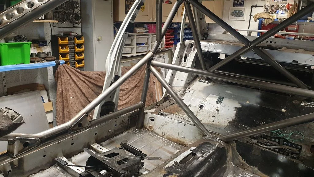

Coated in corrosion, can't get rust on top of rust? ;) 😂
Seem to remember it was etch primed, but never actually painted 🤔

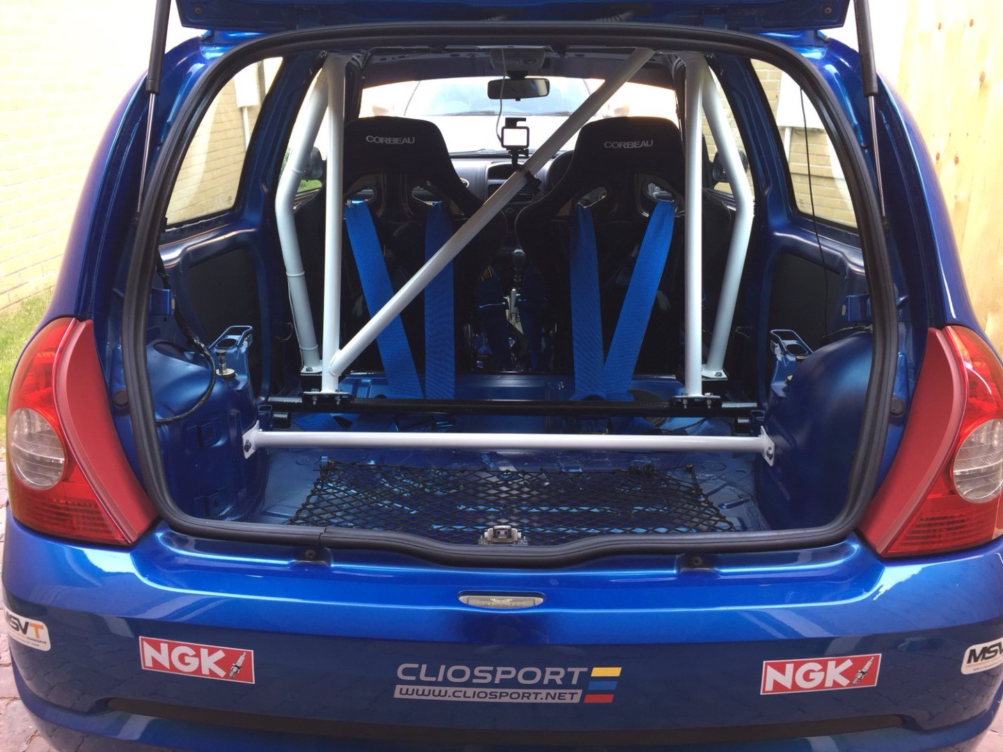

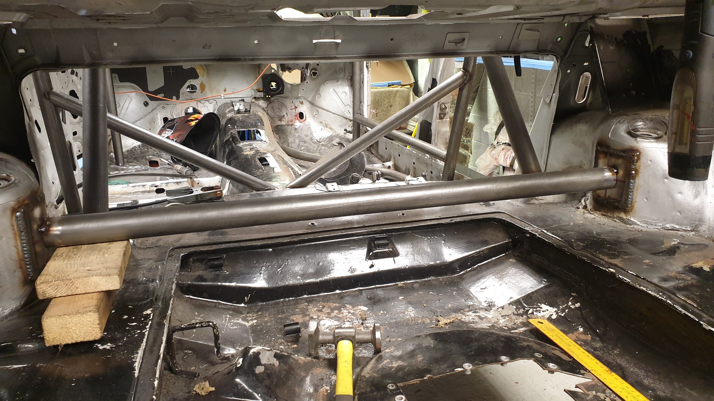

Same. Mine is a saloon car though not a hatch which is why we did it like that. I have harness bars built in to the main cage.
This was the thicker wall roll cage tubing as well. You could have picked the car up with it probably 😂

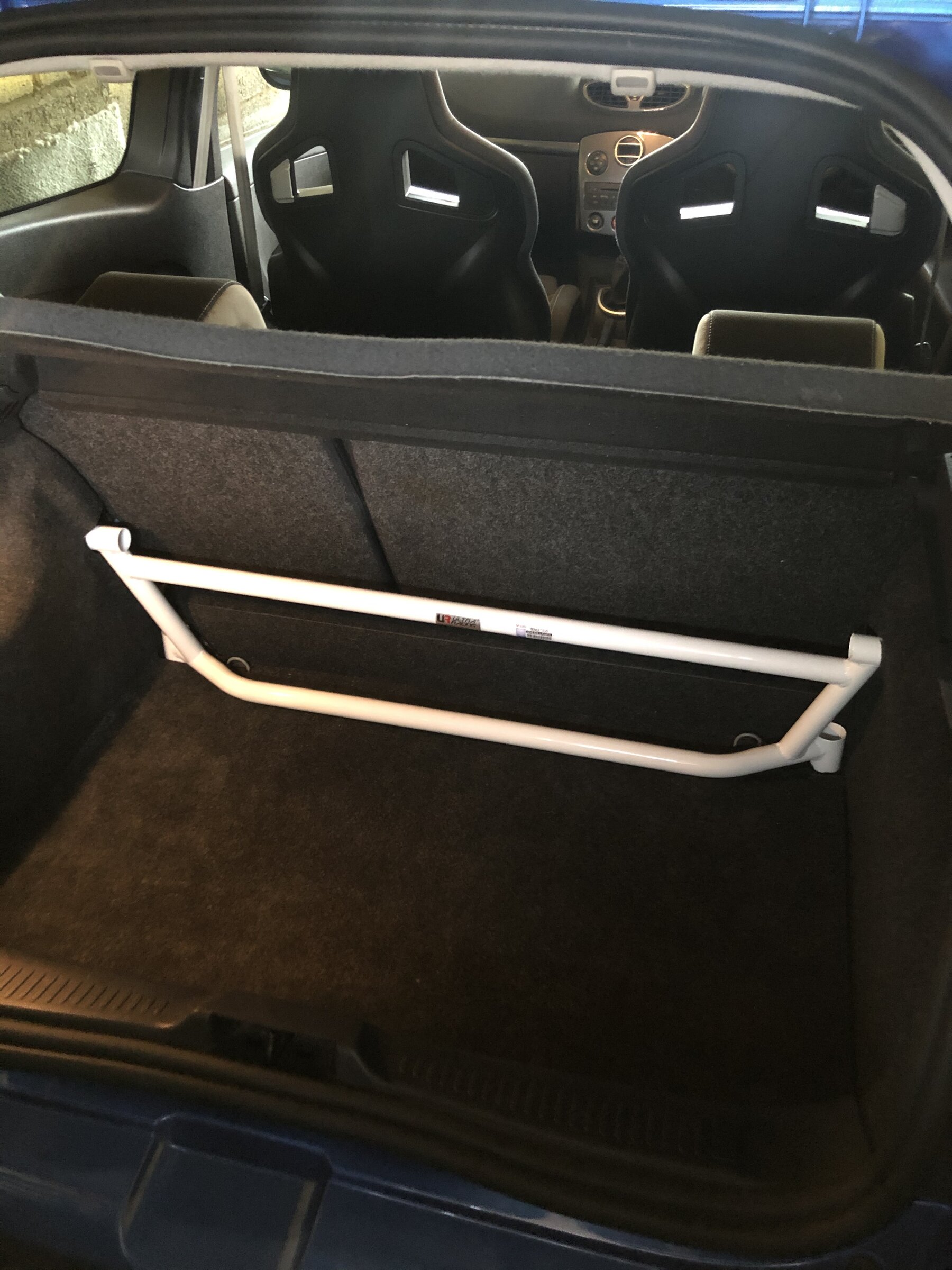

Ok, I haven’t but was hoping I can run a harness off the top part of this brace for track days when I lower the rear seats?
JimF
  Clio 172
I was thinking about something like this because Im not going full cage and dont feel safe without a harness on track. Is this perfectly fine to do?
The issue with harnesses and no cage is that in a rollover, where a 3 point ordinary seatbelt will allow your body to be forced over and towards the centre of the car (the shoulder with no seatbelt over it), harnesses with no cage means you'll be held nicely in your seat while your neck is broken.
That said, I think Clio's are pretty strong in rollovers aren't they? That's the thinking behind it.
Standard seatbelt + no cage = fine
Standard seatbelt + cage = death
Correctly mounted harness + cage = fine
Correctly mounted harness + no cage = death
Incorrectly mounted harness + anything = death
