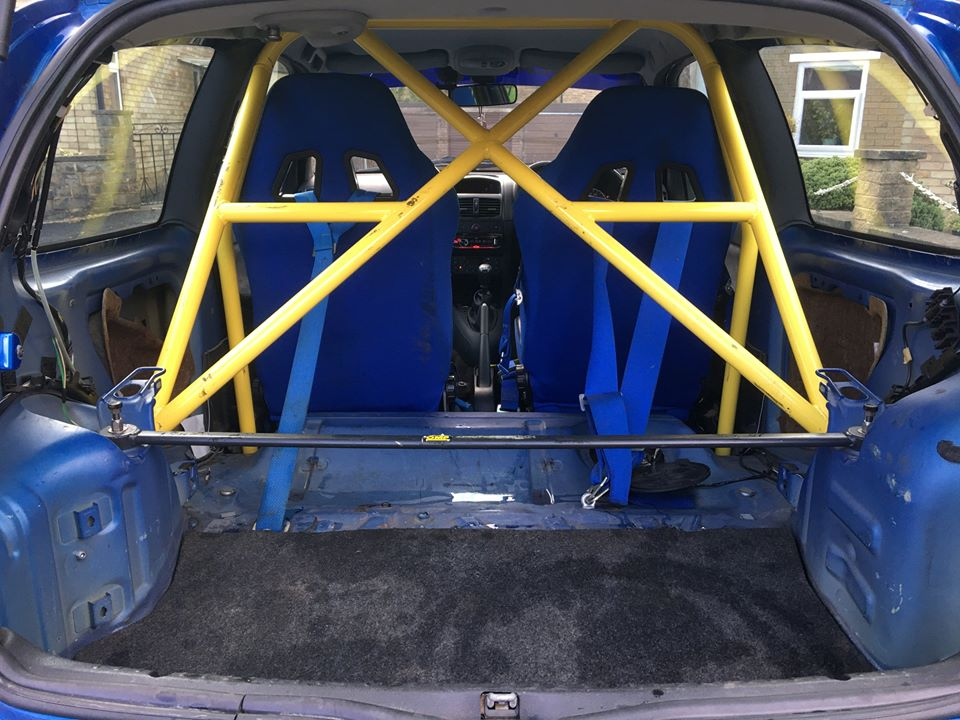

Rear Strut Braces
The issue with harnesses and no cage is that in a rollover, where a 3 point ordinary seatbelt will allow your body to be forced over and towards the centre of the car (the shoulder with no seatbelt over it), harnesses with no cage means you'll be held nicely in your seat while your neck is broken.
That said, I think Clio's are pretty strong in rollovers aren't they? That's the thinking behind it.
Standard seatbelt + no cage = fine
Standard seatbelt + cage = death
Correctly mounted harness + cage = fine
Correctly mounted harness + no cage = death
Incorrectly mounted harness + anything = death
Correctly mounted harness, cage & Covid 19 = death
What about correctly mounted harness + neck brace + no cage ?

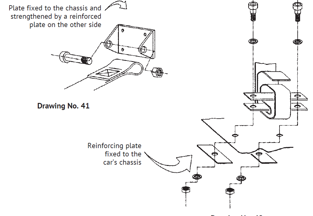

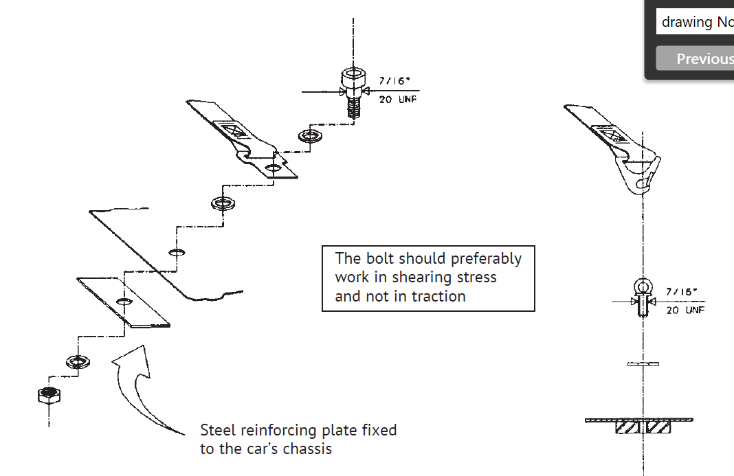

Some info from the 'blue book'
1.1.13. Harness Bar. A transverse tubular member attached
across either the main hoop or backstays to accept harness
mountings.
1.3.9. Harness Bars. Minimum dimensions 38mm x 2.5mm or
40mm x 2.0mm. Cold Drawn Seamless Carbon Steel with
minimum tensile strength of 350N/mm2. Harness straps may
be attached by looping around the tube or by threaded fixings
using inserts as drawing No. 44 welded into the tubes(s).
hope this helps...

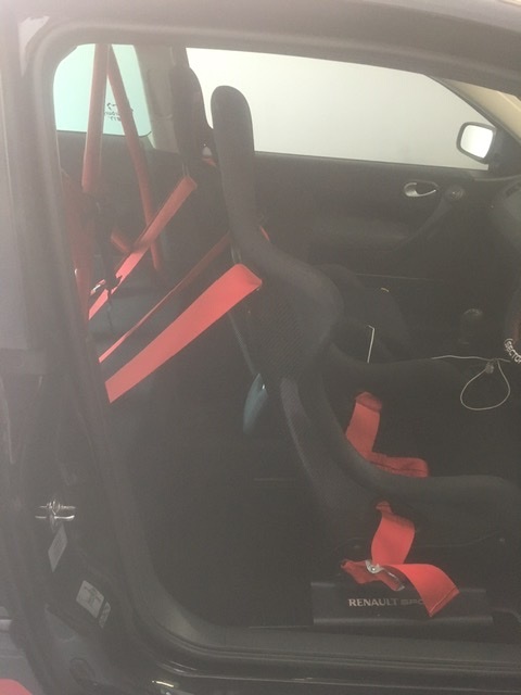

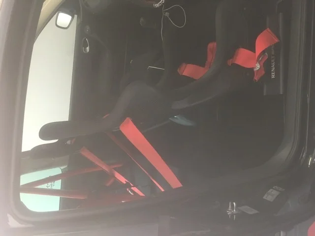

Thought I’d share this pic given the debate over R26.R harnesses. Sorry for photo orientation but there doesn't seem to be a simple way to change it.
