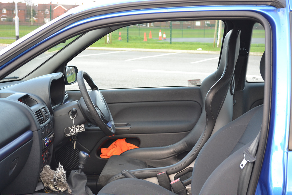

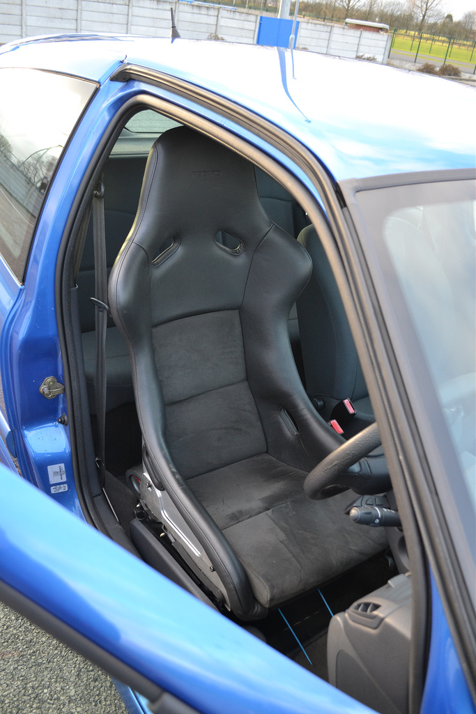

Recaro pole positions (and the like) with standard seat belts.
Fixed bucket with normal seatbelt is very dangerous. It gives no restraint over your hips so you submarine and in an accident you'd never walk again if you were lucky enough to live.
Hmmm, the discussions I have read on this forum suggest otherwise.

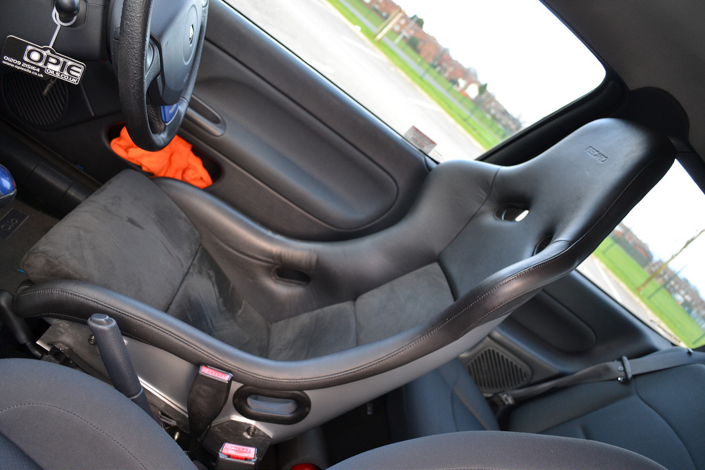

Surely if 'lap' part of the standard belt is fed through the side holes in the seat you would have the same hip/lap support as you would on a regular seat?

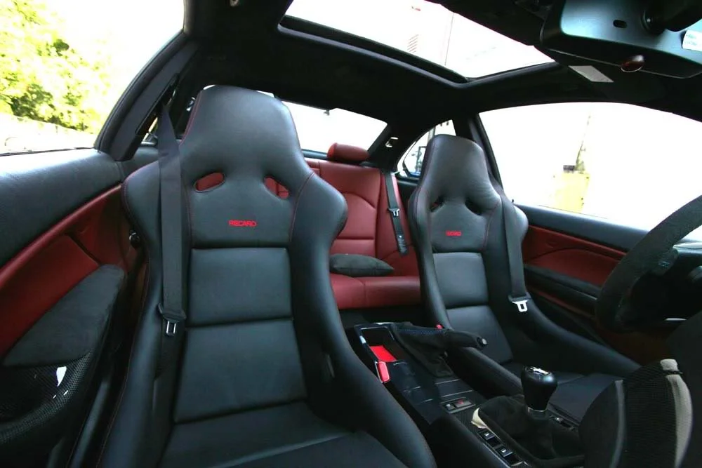

What about the v6 TT and M3's which had them as standard?
Just fit the standard belt like this
There's buckets designed to be used with seatbelts, pole positions being one.
Speak to capital seating for an 'E' marked solution.
